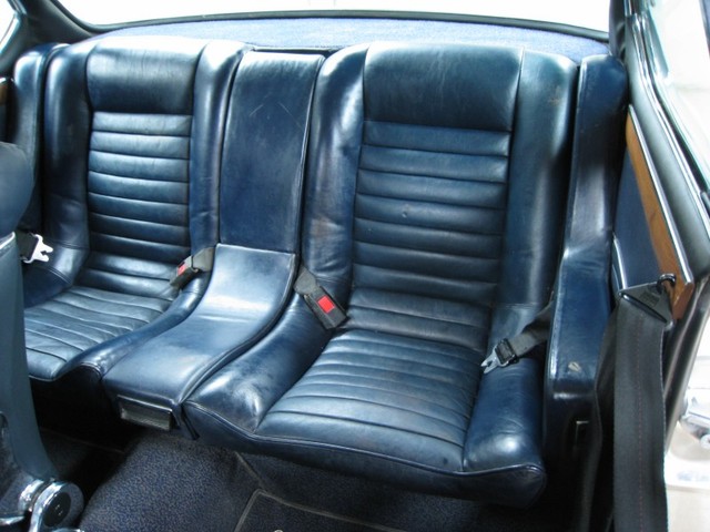

Unrelated: does anyone know how the front seatbelts are attached to the rear passenger wood strips? If you can take a picture, i'd appreciate it. Gary forgot to attach and need details. Found this image, but can't tell precisely what is used to attach?
