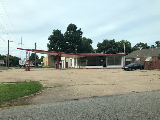

Not actually that wild. This was the real target. It’s now a mess, and trying to move it would damage more, rendering it highly uneconomical. But all of these style shops with the rooflines & tile will be gone soon, and this one is 3 miles away, so it nags at me.

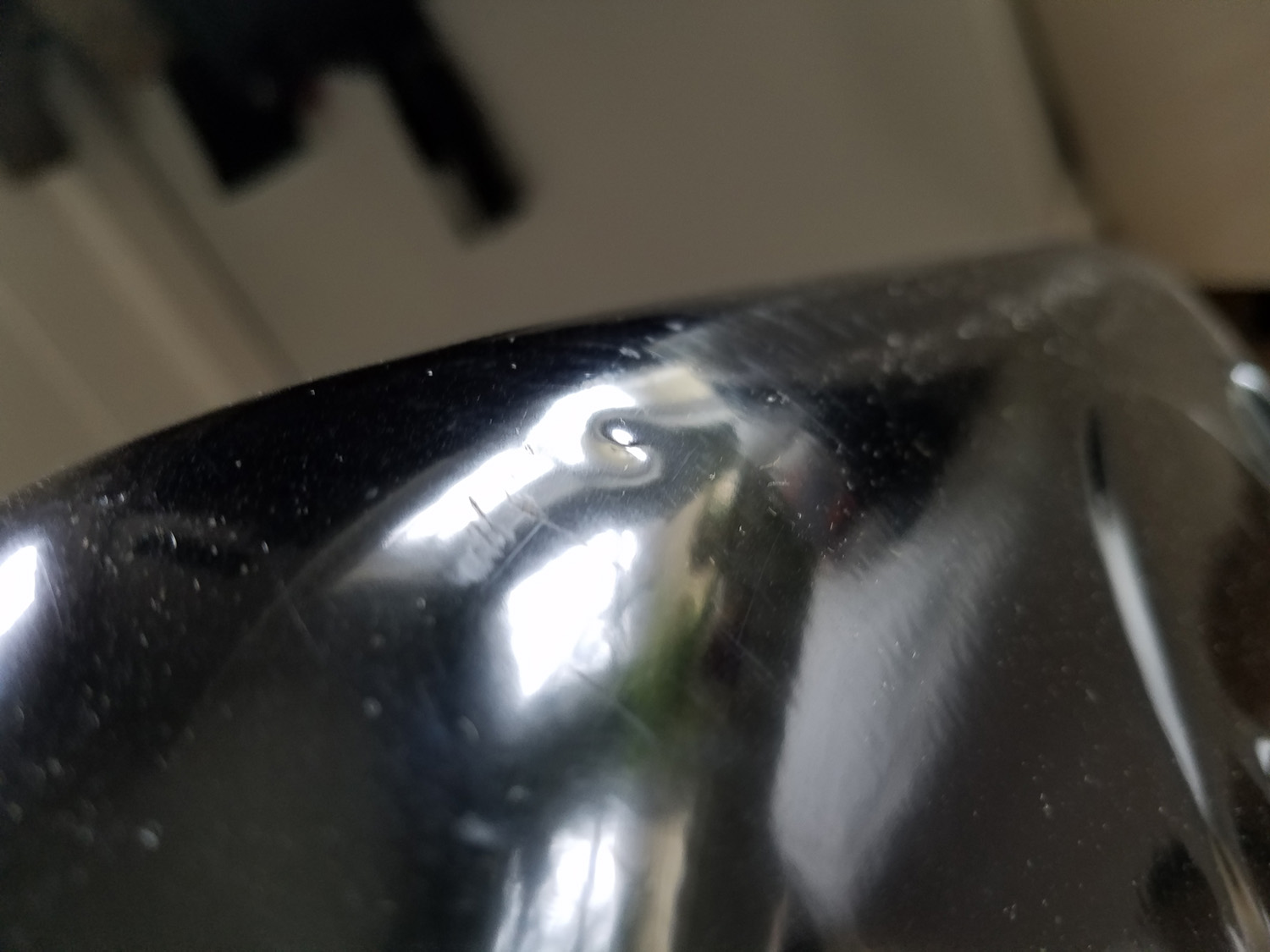

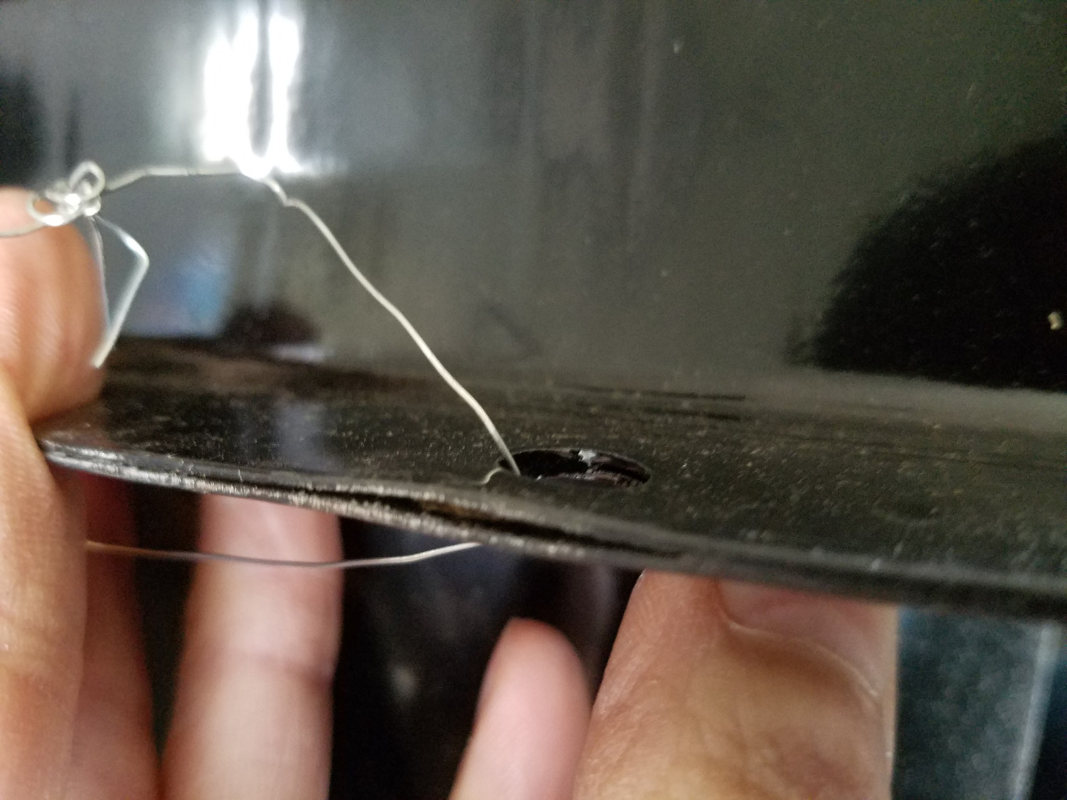

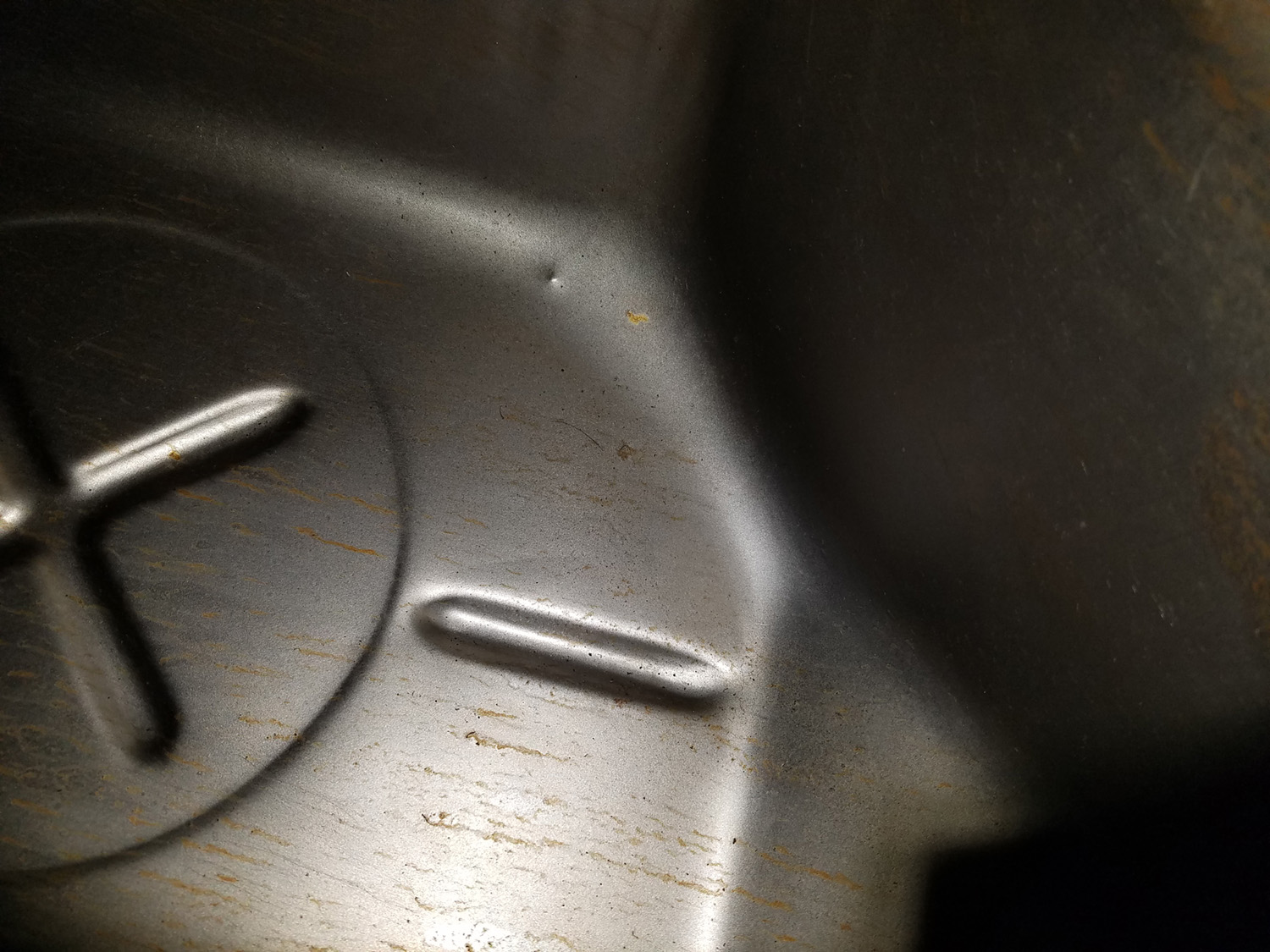

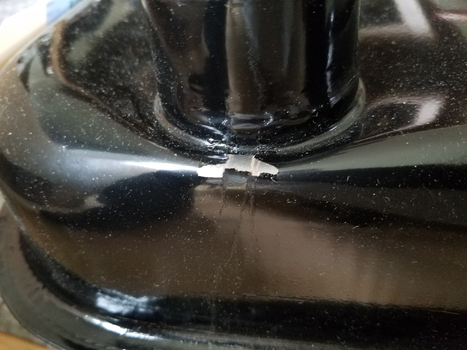

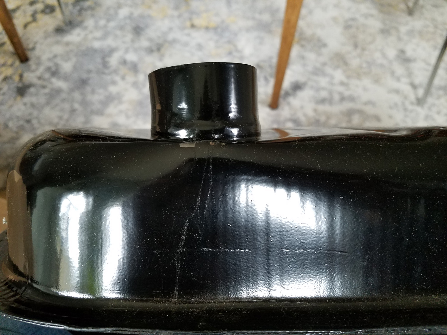

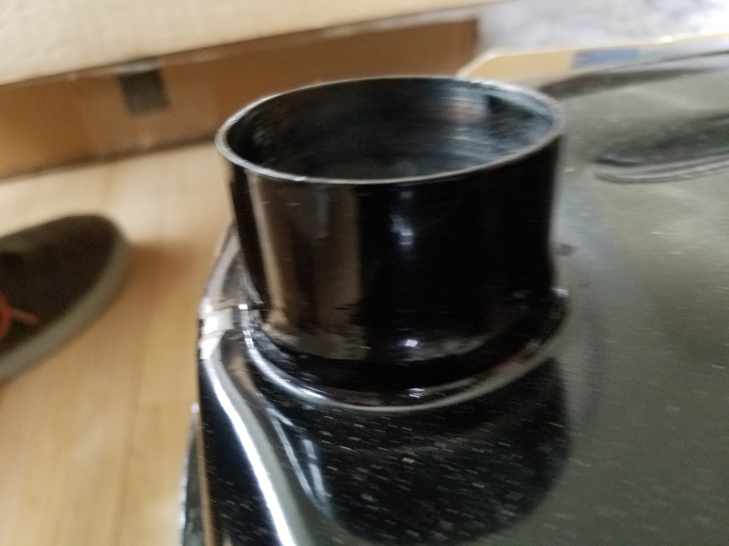

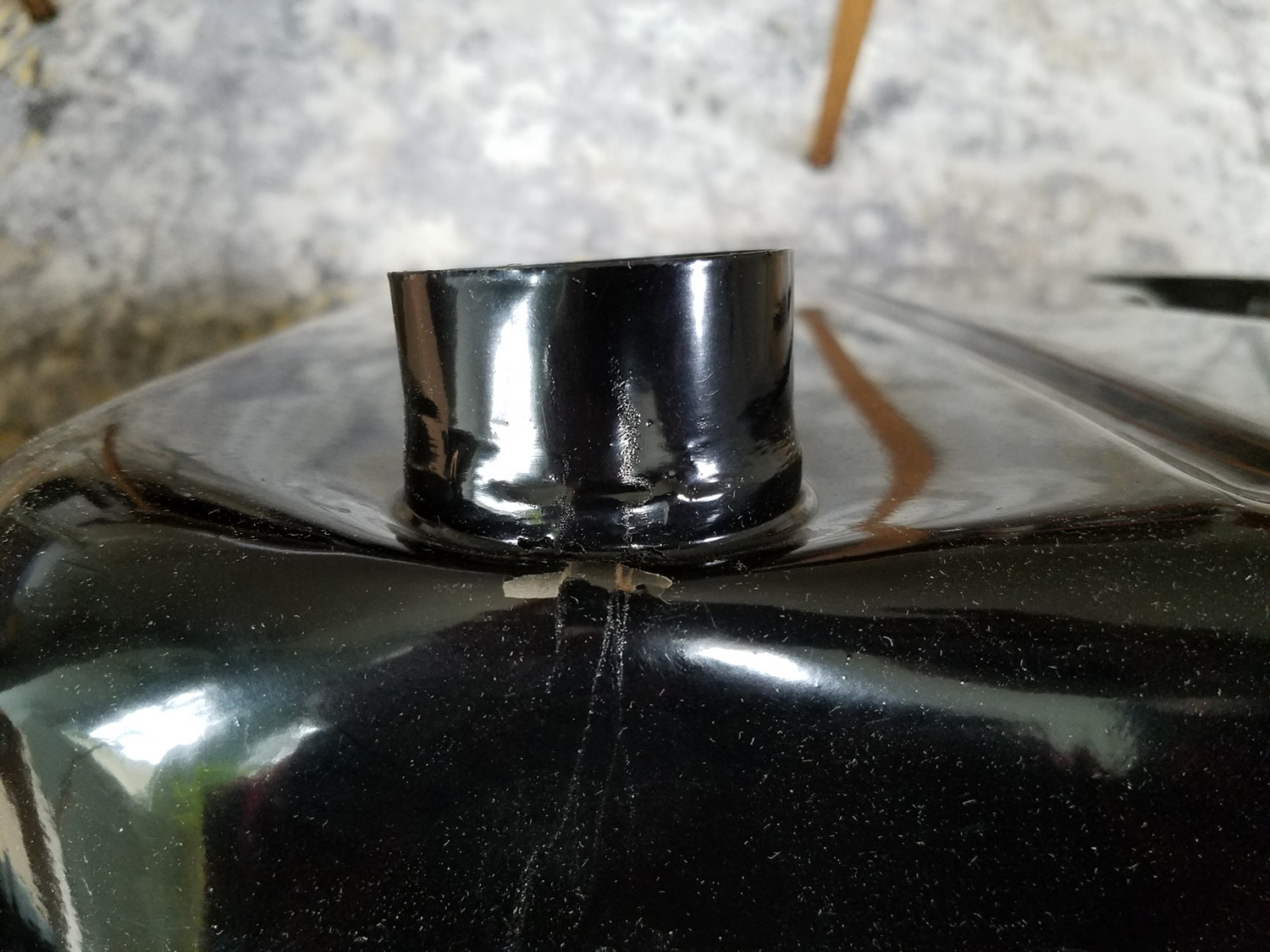

Today went from elation to disappointment. Am I overreacting?
Today, by brand new BMW fuel tank arrived for The Raven. I ordered it from BMW of South Atlanta as they seemed to have the best price with shipping. It took many weeks to arrive as I believe it was shipped from Germany, although it may have come from a BMW NA warehouse in Florida. Either way, the box arrived today. Damaged.

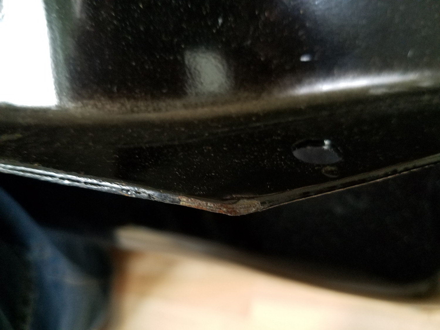

I found three obvious areas with damage. The most significant, I think, is that the filler neck has been pushed in. This deformed the top of the tank and has kinked the side a bit. There is also a small but sharp ding in the bottom of the tank. And there is some edge damage where the two halves come together. Rust is already present so this didn't just happen in a FedEx truck. There is also a hint of surface flash rust on the inside, which is probably normal.?. I have sent a message to BMW of South Atlanta, and need to wait for their reply. So again, am I overreacting, or should I expect a better piece? This was not cheap - currently the most expensive single part I've ordered for the car.
Filler neck area:
20200331-filler neck-01.jpg20200331-filler neck-02.jpg20200331-filler neck-03.jpg20200331-filler neck-04.jpg
Edge damage:
Ding and interior of tank:
Filler neck area:
View attachment 89154View attachment 89155View attachment 89156View attachment 89157
Edge damage:
View attachment 89158View attachment 89159
View attachment 89160View attachment 89161
You are NOT overreacting!!! That tank is worthless. Who knows what other damage there is that you can't see. My opinion, the tank is seriously compromised. You ordered and paid for expensive new. Demand new and spit polished perfect. Take nothing less. Surface rust on the inside is not normal. The tank is not coupe.
Assume you put the tank on plastic. You are covered. If Atlanta does not make it right, immediately go the the credit card company. I did this recently with an $800. piece of furniture from Crate and Barrel. Visa did everything with the info I supplied. Credit appeared on next statement. Confirmed on the following statement.
I received a reply from Michael Bennett of BMW of South Atlanta this morning. He writes that they will order another tank from Germany, and apologized for this first experience. It was a very welcomed response, and I will keep you all up to date on the progress of this. I hope that, in the end, I end up with a nice, new, undamaged tank.
Sounds like a good resolution is on the way. Apart from the extra wasted time of course.
I have to say I have always had good customer service from South Atlanta.
