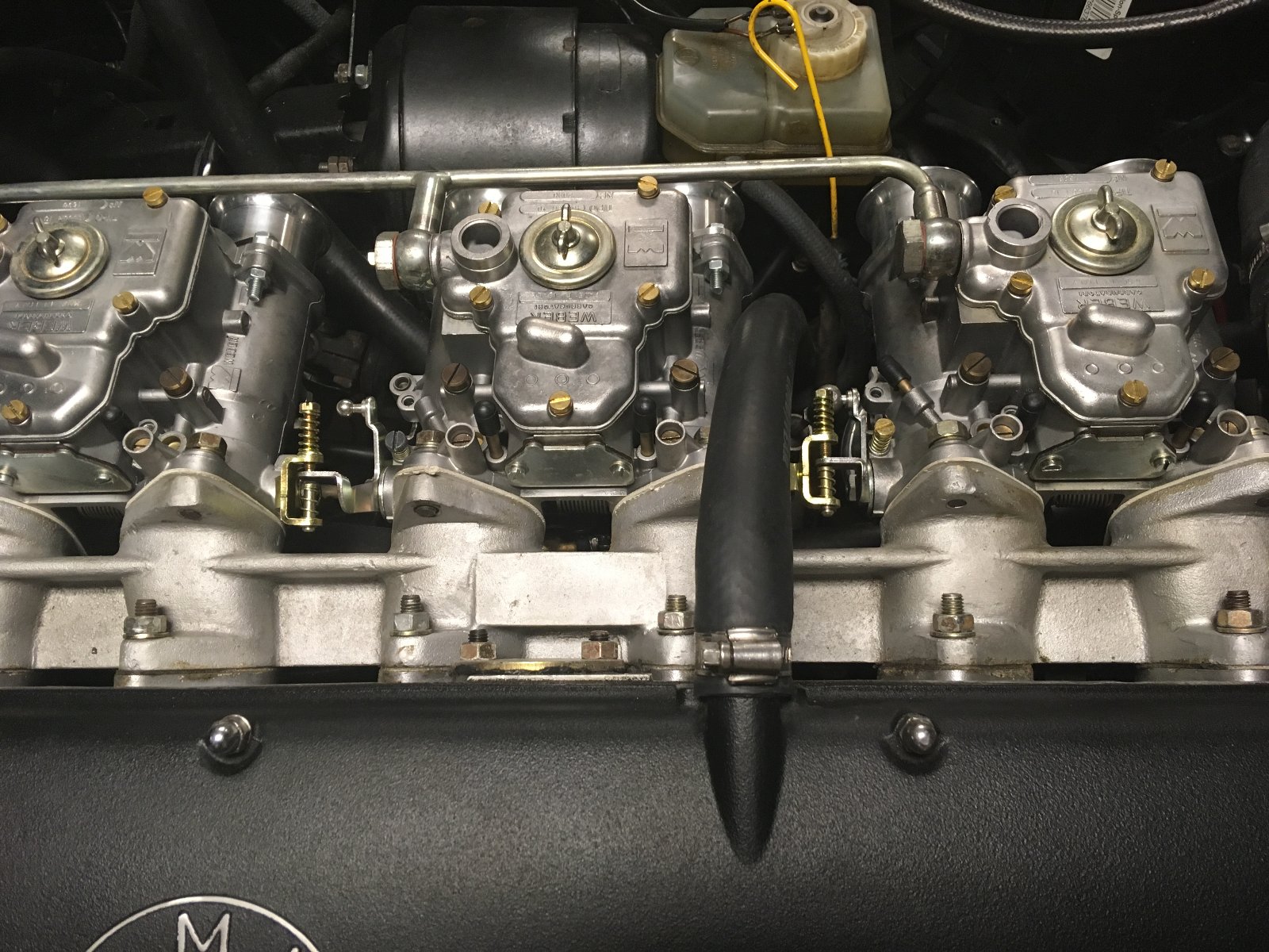

The pic of the coolant lines is great. First I have seen without the carbs blocking the view. Ill scope out the e24 diagrams some more. @boonies lead me down this path recently as well.

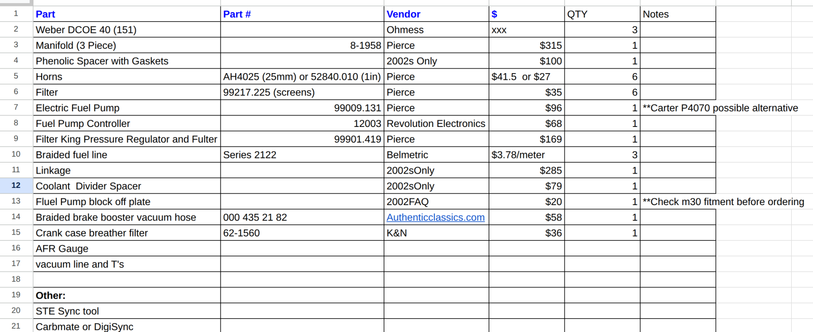

Hey! While I wait for my new Webers to arrive by snail mail, I have been assembling my parts list and feel like I have most of the essentials mapped out. Keen to get your thoughts and feedback.
One other thing I have been trying to figure out is how to re-plumb the coolant lines for the triple Webers. Attached are some photos of my DGAV setup and the lines that will need to be sorted (marked with red Xs) Any advice? What have others done?
I have to reroute
* The ~8mm running from the rear bottom of the block up to the rear manifold.
Can this one just to capped off at the block?
* The line running through the firewall to the manifold. Then connecting the two manifolds together and from the front manifold to the T-stat housing
Can this one be looped to complete the circuit? Is so, any parts recommendation?

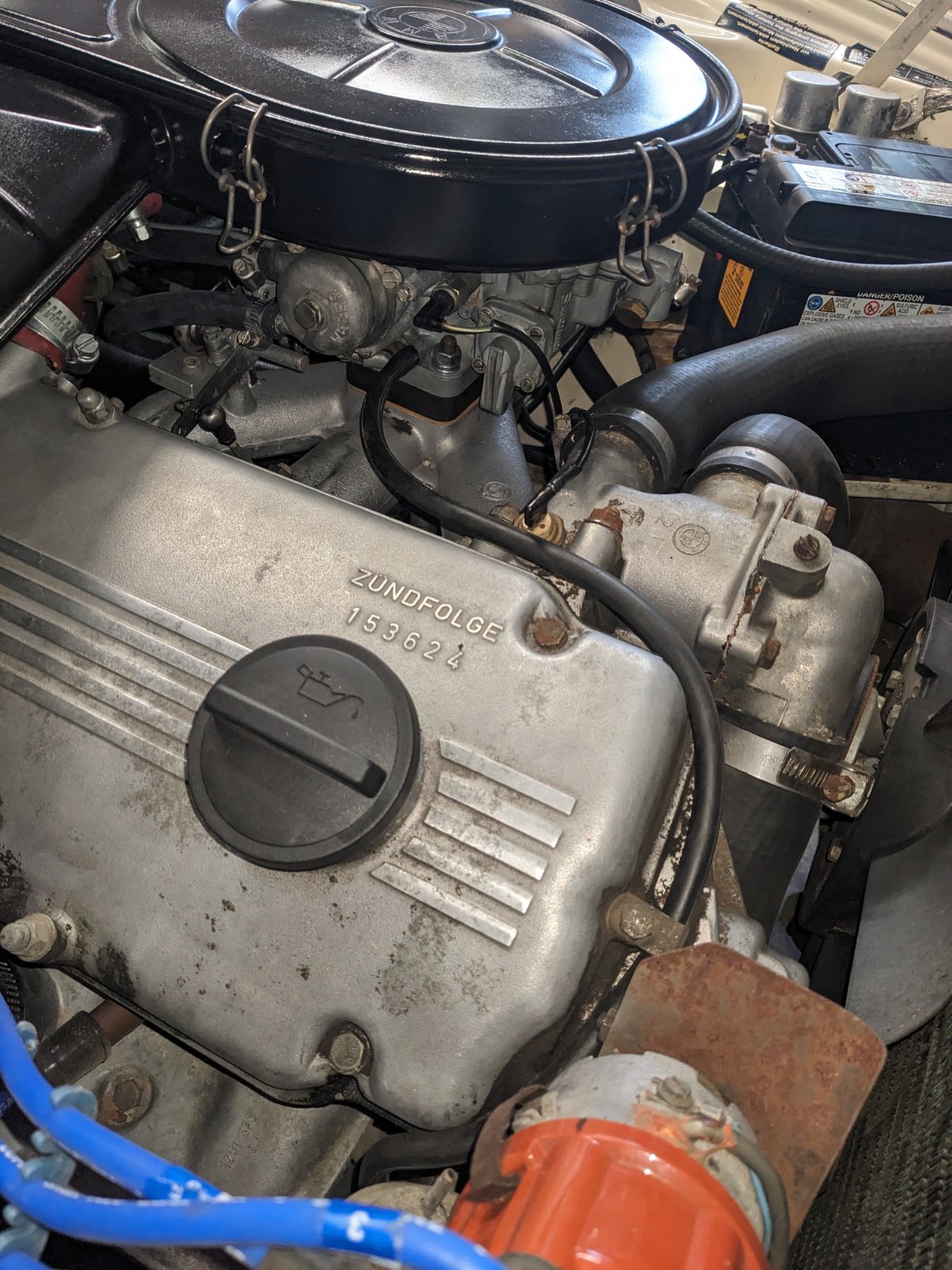

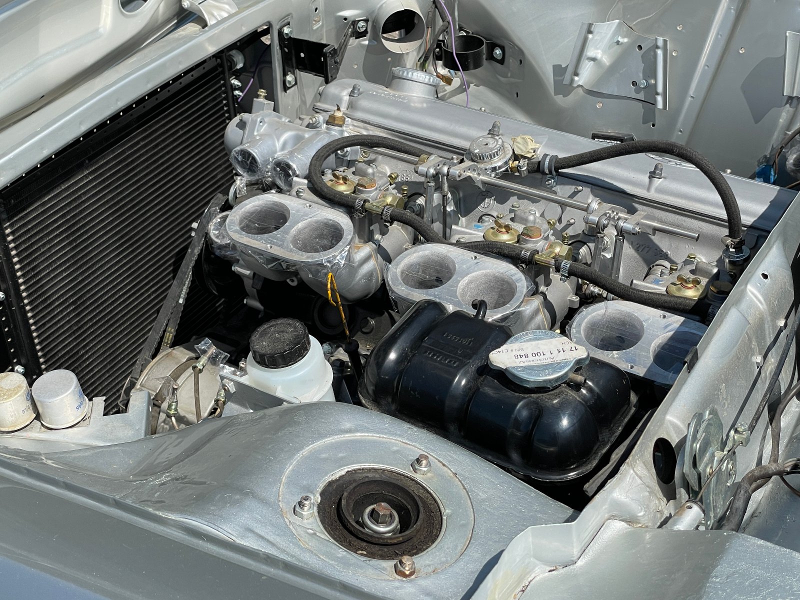

@mark99 : I see right angle intake headers on your engine photo. Are you planning to use the Alpina intake ?

Crank case breather hose - what are the dimensions needed? From my research I found 19mm I.D. x 20MM O.D. Is this correct? I found some black braided type in this approx size available online -
Aeroquip StartLite Aramid Braided Racing Hose - Size 12
There is no stress on that hose at all. I'm using a generic cooling system hose. I think its 19mm.
