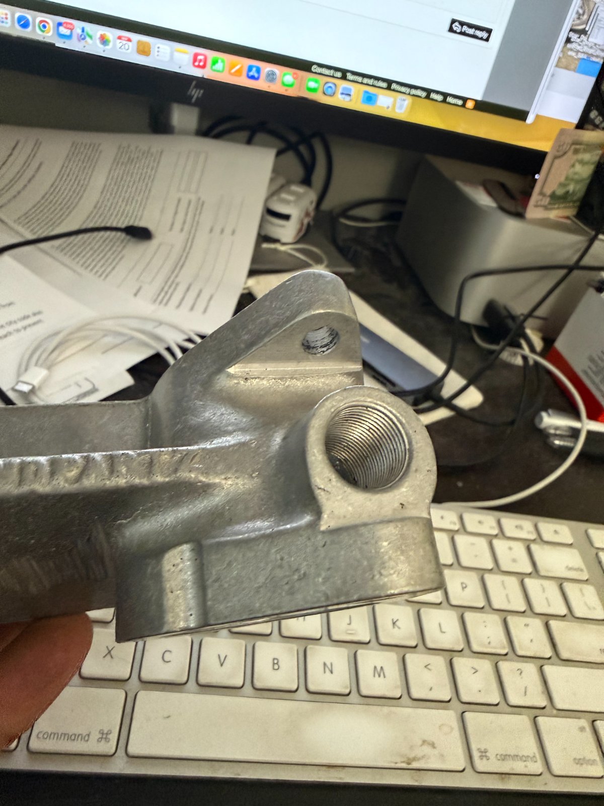

Yes, knew about brake booster vacuum but wanted to know if I should keep vacuum advance in place for the distributor. Sounds like I do. Anyhow, does anyone know if the Pierce manifold comes with a vacuum port off the front manifold section, or will I need to install a fitting?
One of the three manifold will have a larger threaded hole. This will be for your booster vacuum. I will be threading this into that hole. My carbs have a vacuum port that I will use for my 123 distributor.
Yes , the Pierce has a threaded opening for vacuum.

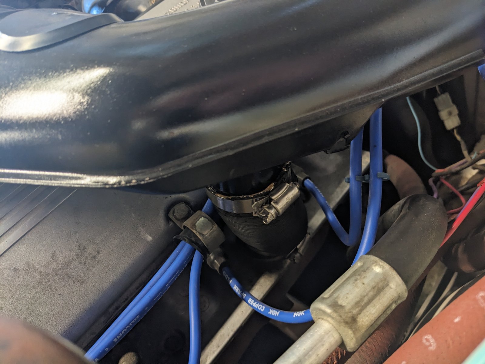

What's the recommendation to do with this air intake hose running form the snorkle to the exhaust manifold? I know it'll need to be removed but what are those doing about the hole after converting to triples?
Are you referring to the vent on the valve cover? I was thinking I would connect a hose to a catch can for that
My car came with a cover on that exhaust manifold cover which I believe was done when the prior owner converted to the DGAVs. Alas, I sold that long ago.
