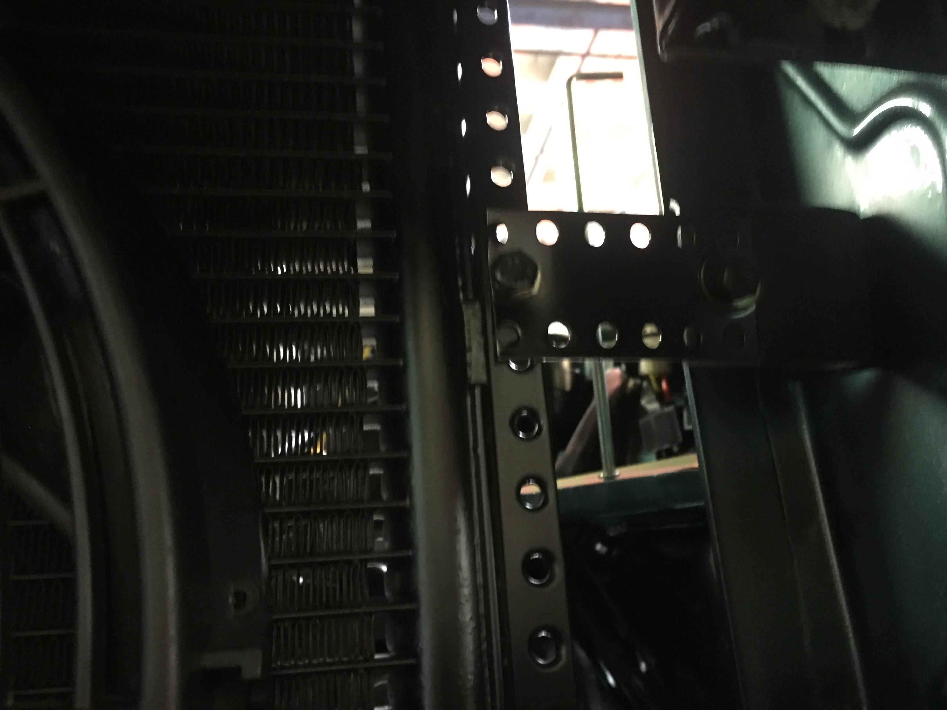

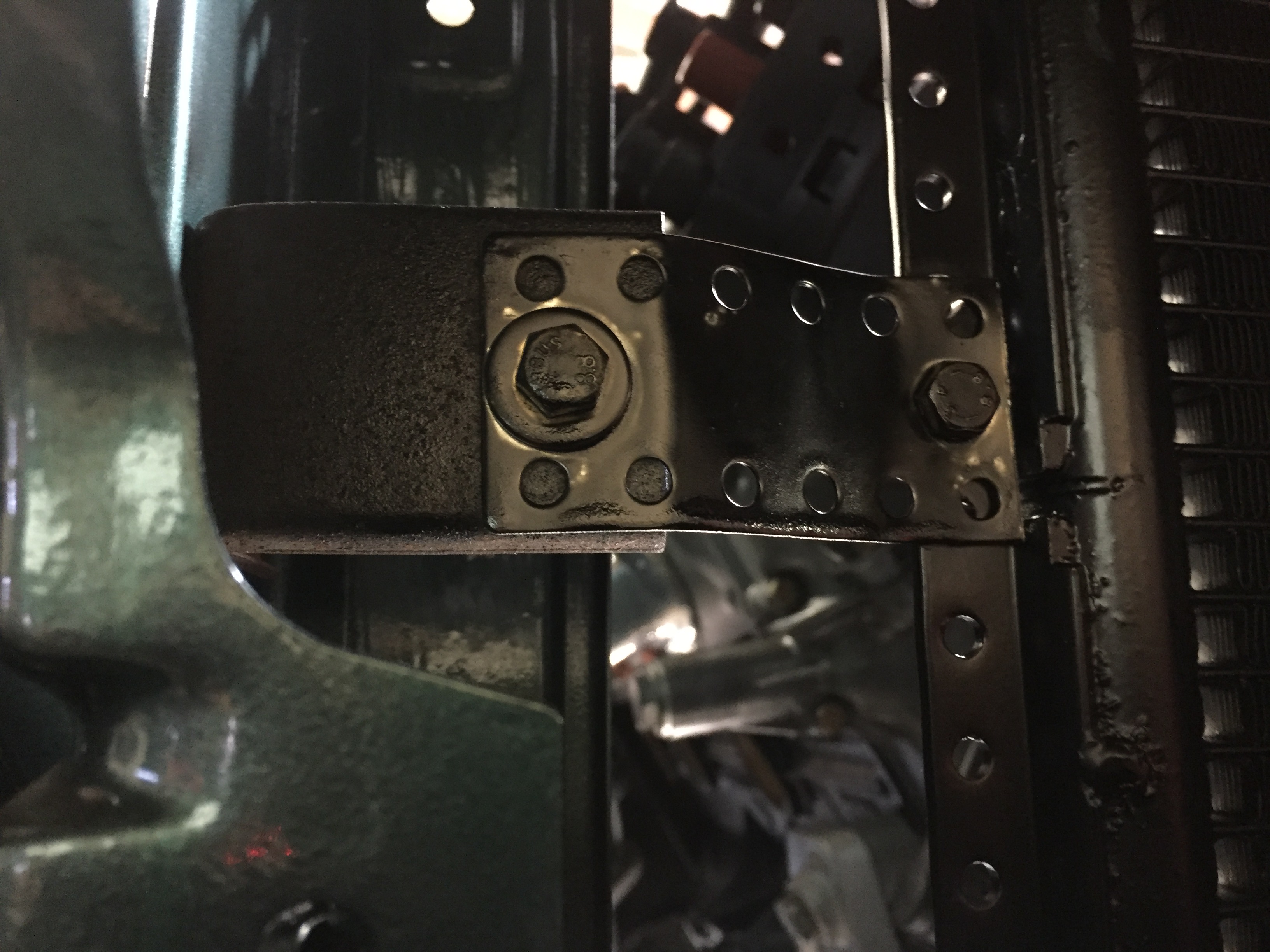

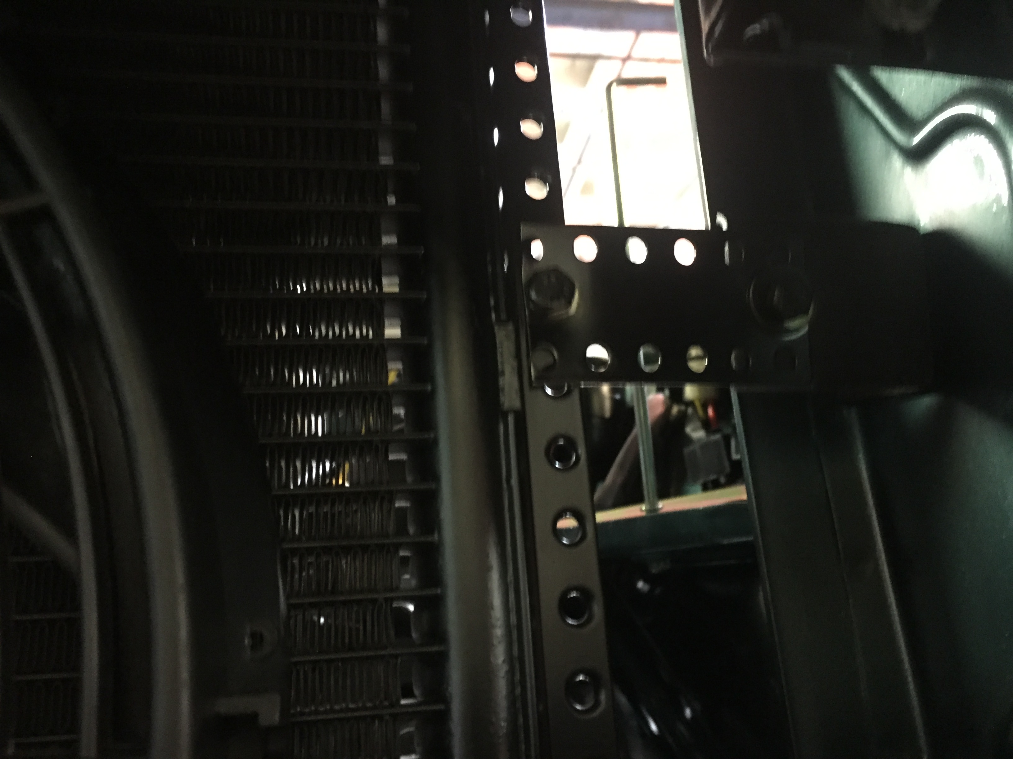

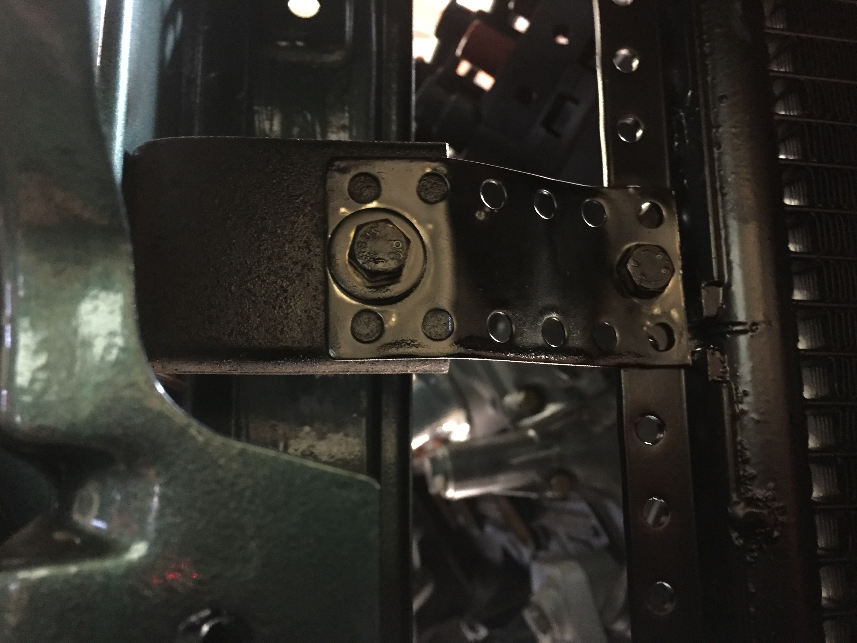

as far as mounting a fan, that is a concept in the drawing I posted, but should have label / explained it better
I was thinking 2 beams, on above and one below the fan that connect to the condenser
The beam would be cut from sheet stock, straight then a portion of a circle and then straight
at each end would be a stand off that the bolt passes through

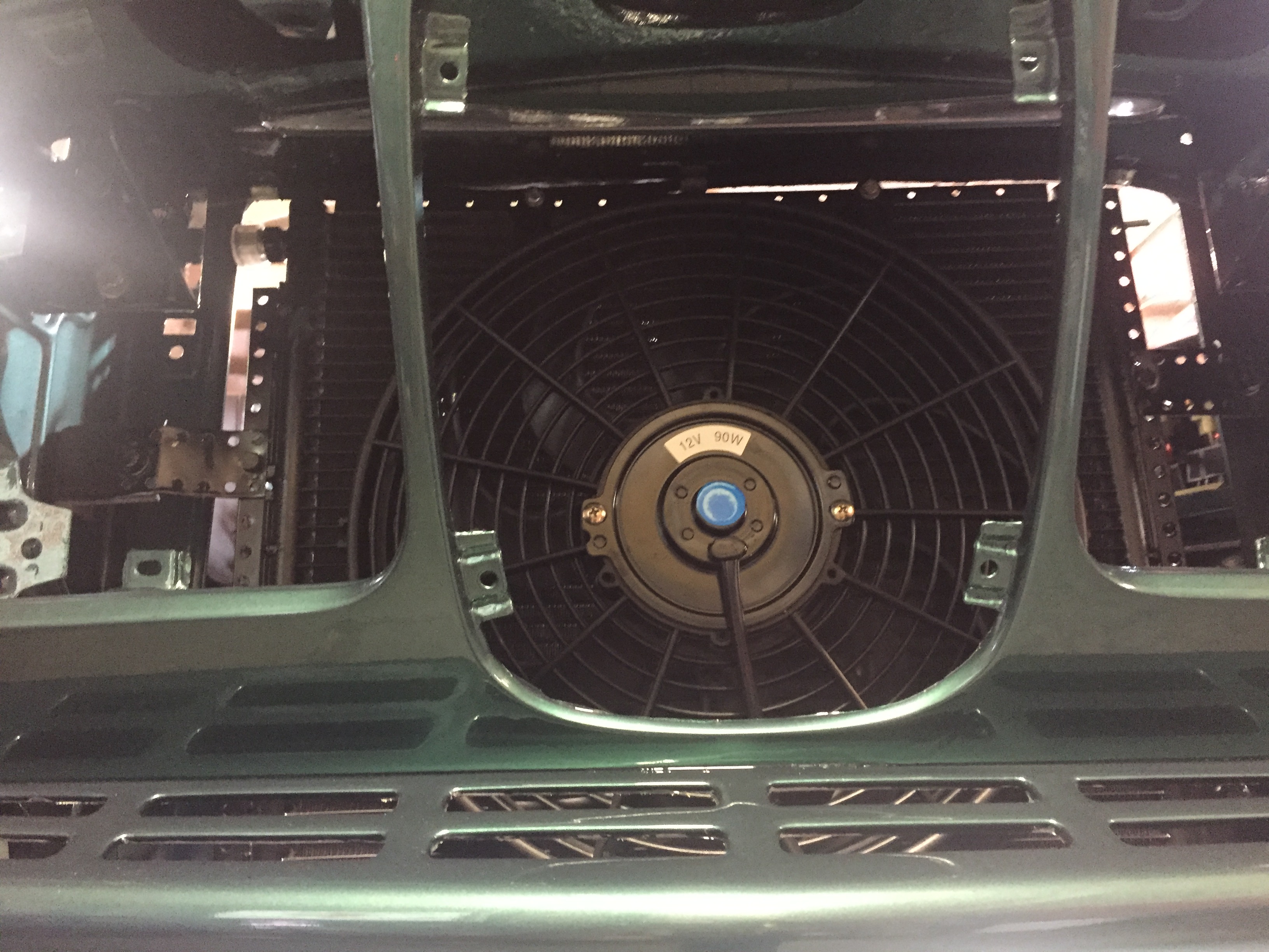

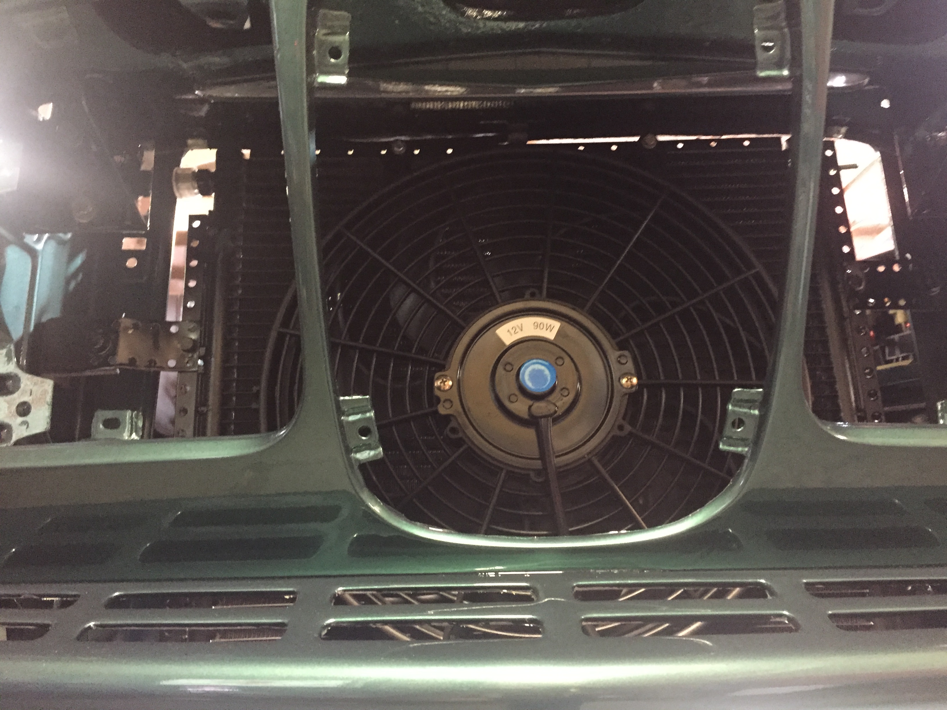

it looks like the fan is attached to the upper flange of the condenser. i don't see a lower flange with holes ... so i presume it is only mounted at the top. the fan looks a little different than the one in your previous pic ... so CK must have sourced it elsewhere.
Nothing wrong with attaching the fan through the cooling fins of the condenser (or radiator). BMW does that with sensors on some models and it could be argued that it works better for air flow since you know its completely up against the surface.
I just checked, I bought a SPAL 0517 for $90, it pushes a ton of air but is noisy, not on the freeway but at idle or at a traffic light. I just used the plastic mounts, no issues.
now for the novice question ... i guess the only way to get these things in there is to remove the radiator and come in from the back side. too difficult to try to get it in thru the grille slots and get it turned?
I suppose that may be possible but doing so then securing it and installing the hoses with the radiator in place would be a much more pita than just removing the radiator and having free access.
blue service book shows removing stock aux fan through grill opening, but that one is only 10 inches in diameter. Wait till you are doing your next coolant flush, or garage floor repaint. Then pull rad. ;)
