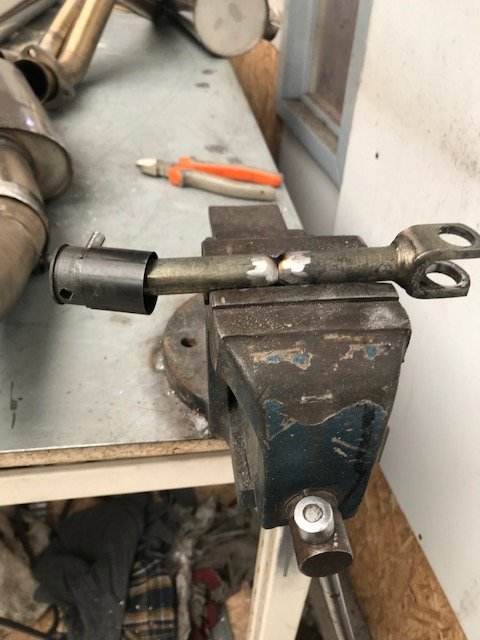

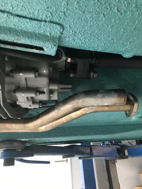

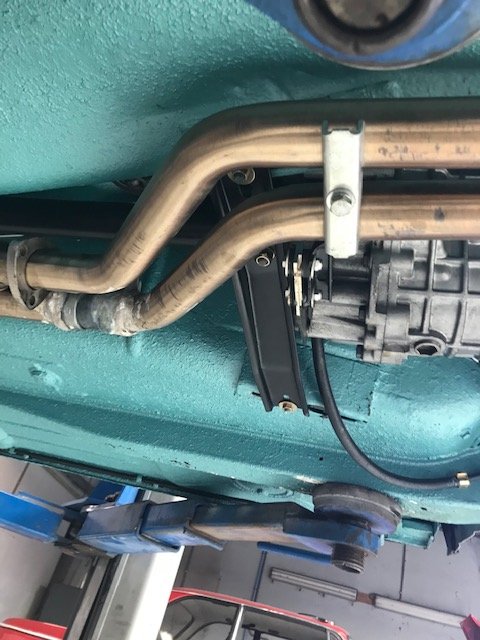

We started on Monday morning around 10:00 and were done with this by Wednesday afternoon around 5:00pm. That included cutting and modifying my linkage for the shorter E12 shifter mount,
and fabricating a new mount for the exhaust after the downpipe. Michael came up with a clever mount using a big transmission mount from a 2002, so it's better than before! Fortunately, Oldenzaal's exhaust fabricator uses a pattern that anticipates a 5-speed, so no modification of the pipes was necessary.
But with the added 5th gear, that original mounting point moves 10cm rearward to the curved part so Michael cut/used the bracket and mounted it to the forked tranny mount location at the end of the tranny:
