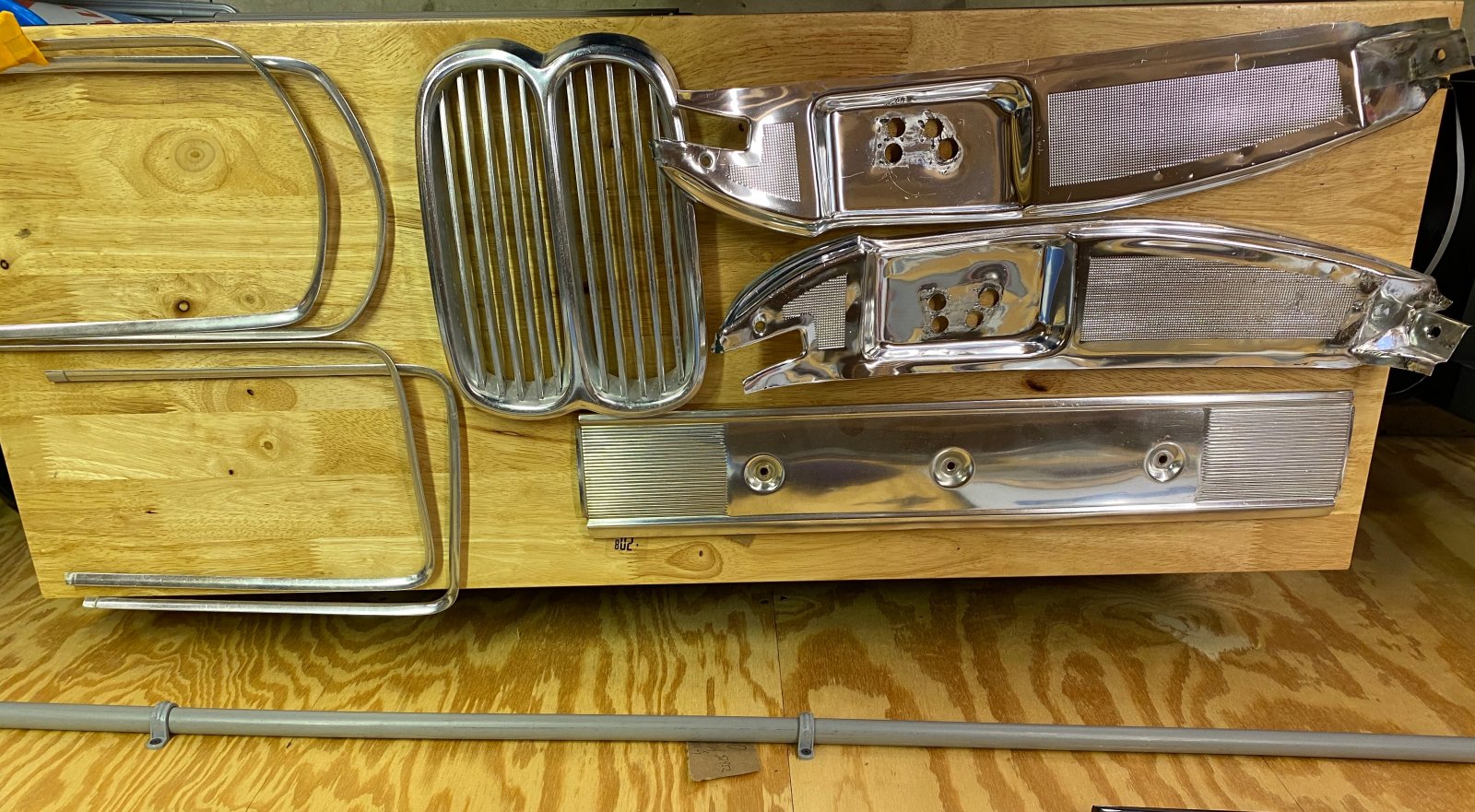

I'm not sure what you mean by the metal strips. Are you talking about the strips that hold the rubber on?
yes. I bought those metal strips from W&N. After seeing the old ones completely rusted away, I painted both sides with POR15 (Paint over rust). Now it looks like you have to rivet one end to start and then line up the bumper holes to drill holes in the metal strip before riveting the strip to the bumper.
I am using the SS bumpers from Blunt Tech. The strip comes welded to the bumpers.
