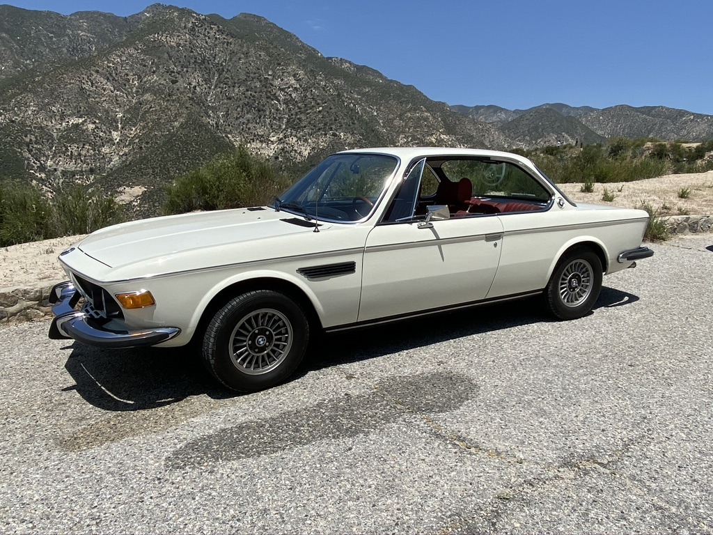

Took it for a drive today--had to get out of the house. Big Tujunga Canyon → Angeles Forest Highway → Angeles Crest Highway. Beautiful day in the Angeles National Forest.

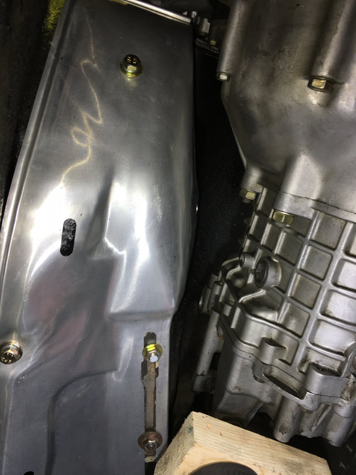

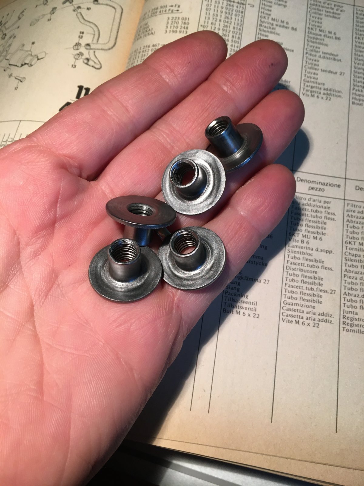

The heat shield project. Thanks for the inspiration from all of those here who documented it. Stole a page from Erik Netherlands and welded on a couple of weld nuts; bulletproof.
...and if anyone is serious about doing this project, I have about 40 weld nuts (M8 x 1.25) left that I can send free (small donation to forum...?) if anyone needs them. Search "heat shield" for Stevehose and Eriknetherlands threads.
My coupe's twin!
@Luis did you need to remove the headers (or down pipes) to get this on?
I have headers on my coupe, have had the heat shield forever but not installed.
Stan, definitely need to remove the downpipes to do the placement of the nuts and priming/schmutz application afterwards. I don’t know if the shield would fit in w/o removing the pipes; I didn’t try. Maybe some of the old threads would shed light on that.
