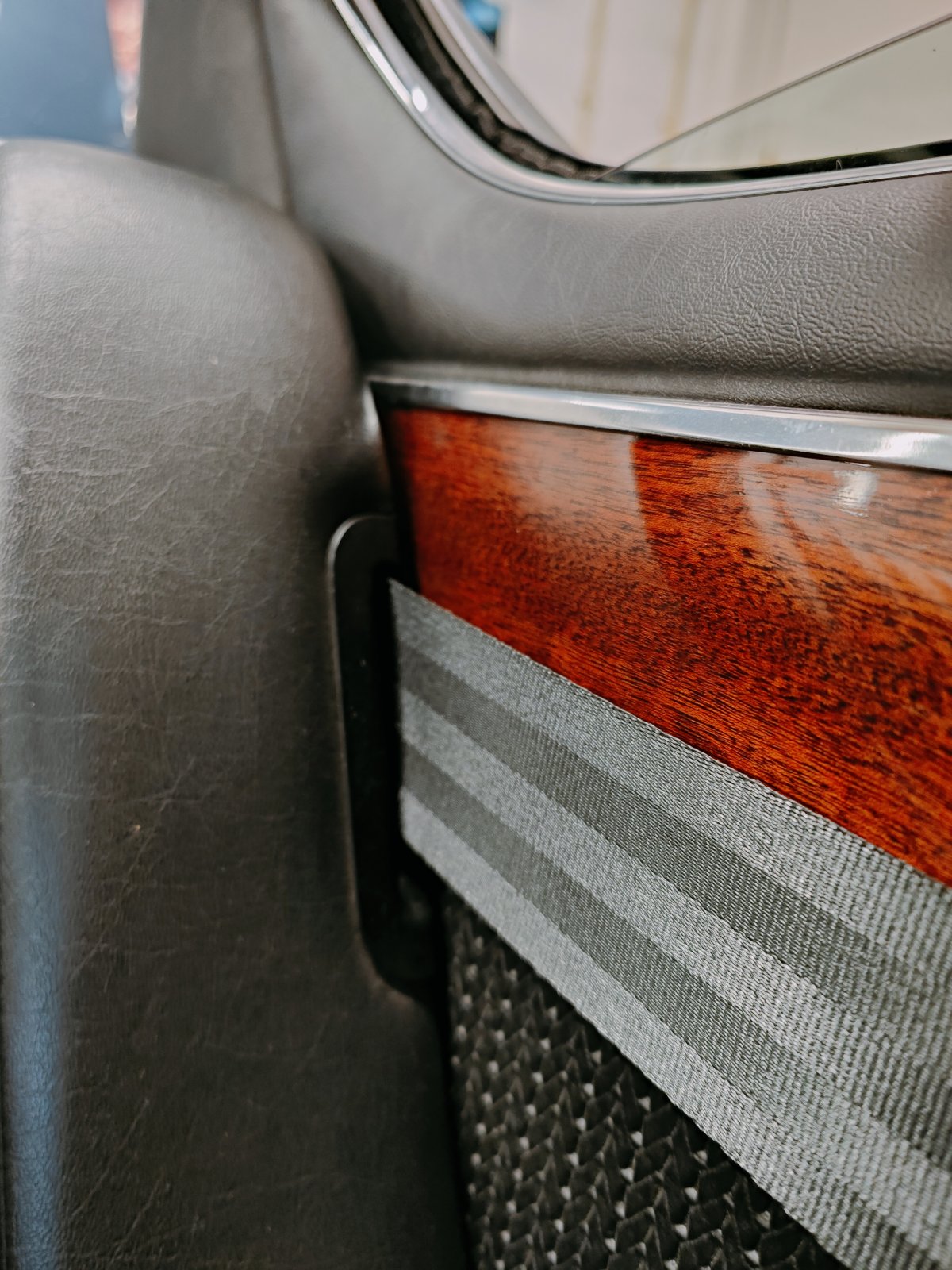

I started to tackle the front seatbelts. The previous owner had installed some seatbelts but in a very unsafe way. I descided to go for the setup that installs behind the back seats since I already had the cutouts in the seat bolsters.

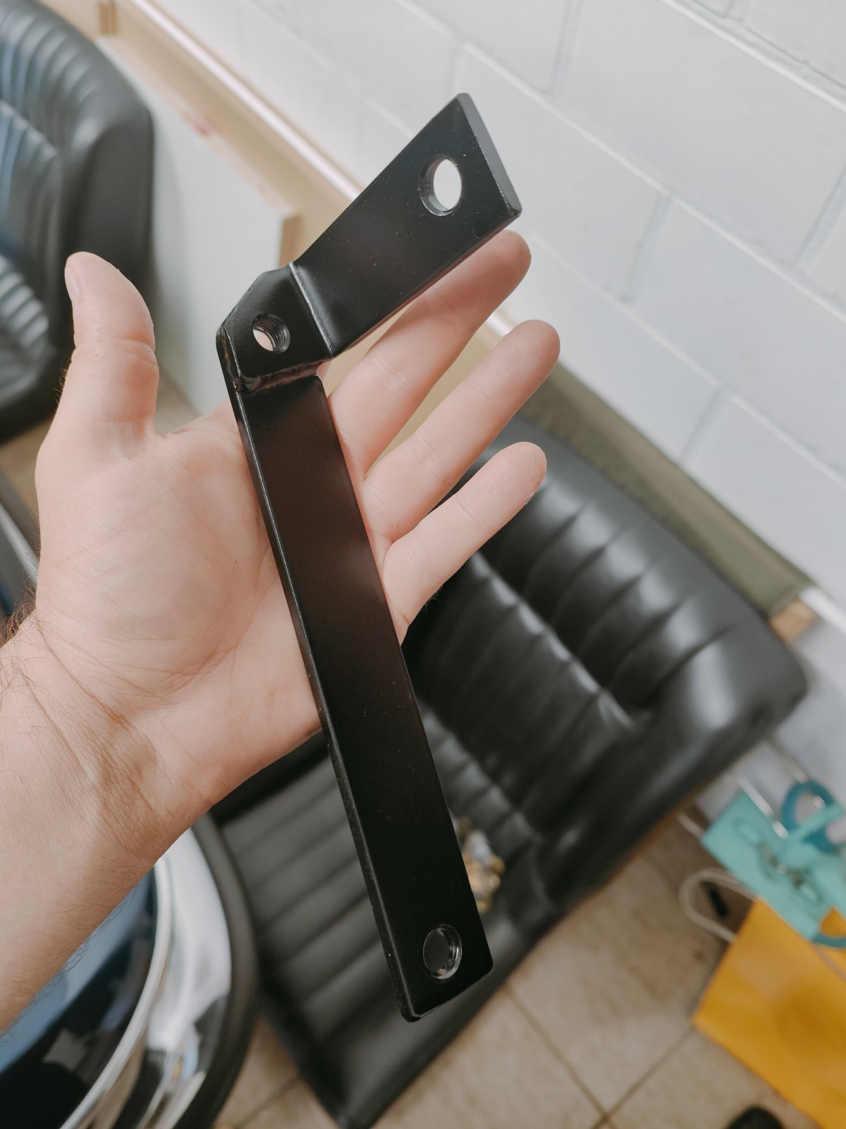

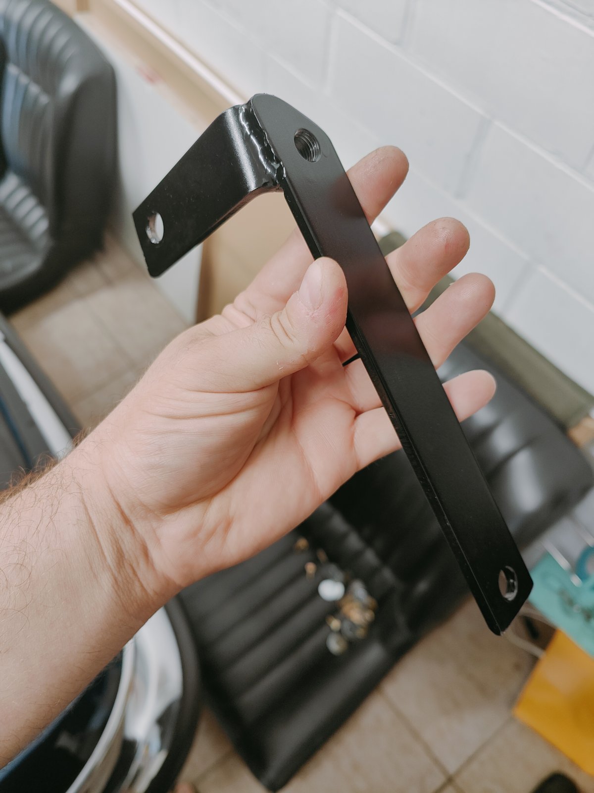

Since the factory holes are positioned way too low to install the belt retractor and have the belt come out where it should, I descided to fabricate a bracket out of stainless that bolts in at 2 points and has a threaded hole to install the restractor.
Just a word of advice (although you probably have already take it into account). I'd place a similar kind of metal plate behind that bolt through the rear vertical seat back. Even a washer gets pulled through the steel plate easily, as it's just 0.8mm. you need to spread the forces preferably into panels around it with different orientations; just like you did for the front bracket.
I regularly watch crash tests of cars in my job, and I've swept up enough bits after the bang in my lifetime.
For example; a standard M10 bolt in a matching nut it's normal strength class is not strong enough by itself. I've seen bolts being pulled out of welded-in nuts even.
The amount of force on a seatbelt reel is massive. Do not underestimate it; in a serious crash, (the one where you need the belt to keep you alive), the force on the upper belt point is about half your mass multiplied by 20, 30 or even up to 50 times if you hit a tree with just a small front overlap.
Imagine pulling on the reel with that force in a jolt; will it hold?
Just a word of advice (although you have already take it into account). I'd place a similar kind of metal plate behind that bolt through the rear vertical seat back. Even a washer gets pulled through the steel plate easily, as it's just 0.8mm. you need to spread the forces preferably into panels around it with different orientations; just like you did for the front bracket.
I have put a threaded stainless 2x5mm plate on the other side of the seat backplate. Replaced the bolts with 7/16 UNF 12.9...

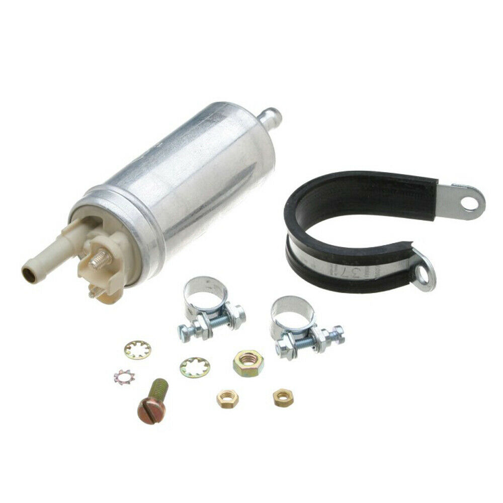

Chris are you running a Pierburg? I just read the insert closely and they state the pump should be in parallel if used as a supplementary pump and that each line should have a one way valve to inhibit return. I gotta find a schematic of this thing. I was wondering what resistance it would have to the mechanical pump when not operating if placed in series. Dan said he cannot blow air in the direction of flow so I think we got an answer. Wonder if the Carter pump poses the same issues.

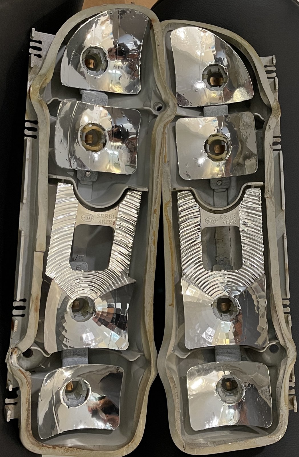

I did the taillight chrome tape project. This and the LED’s ought to be quite an improvement. Also cleaned and de-oxed all connectors and re-tensioned the bulb contacts. I used a wrap from Amazon that has an adhesive on the back and a clear vinyl film on front. Once you have the piece in place and all bubbles out, then you remove the vinyl which protects the shiny part. I did the reflectors in 2-3 strips each, it makes applying onto the deep curves much easier.

I have a one way valve in line just after the fuel filter that I thought would help my issue before I did the pump. It was of ZERO help. I just cannot fathom that it is causing any issue. This is what I have Pierburg 721440510
