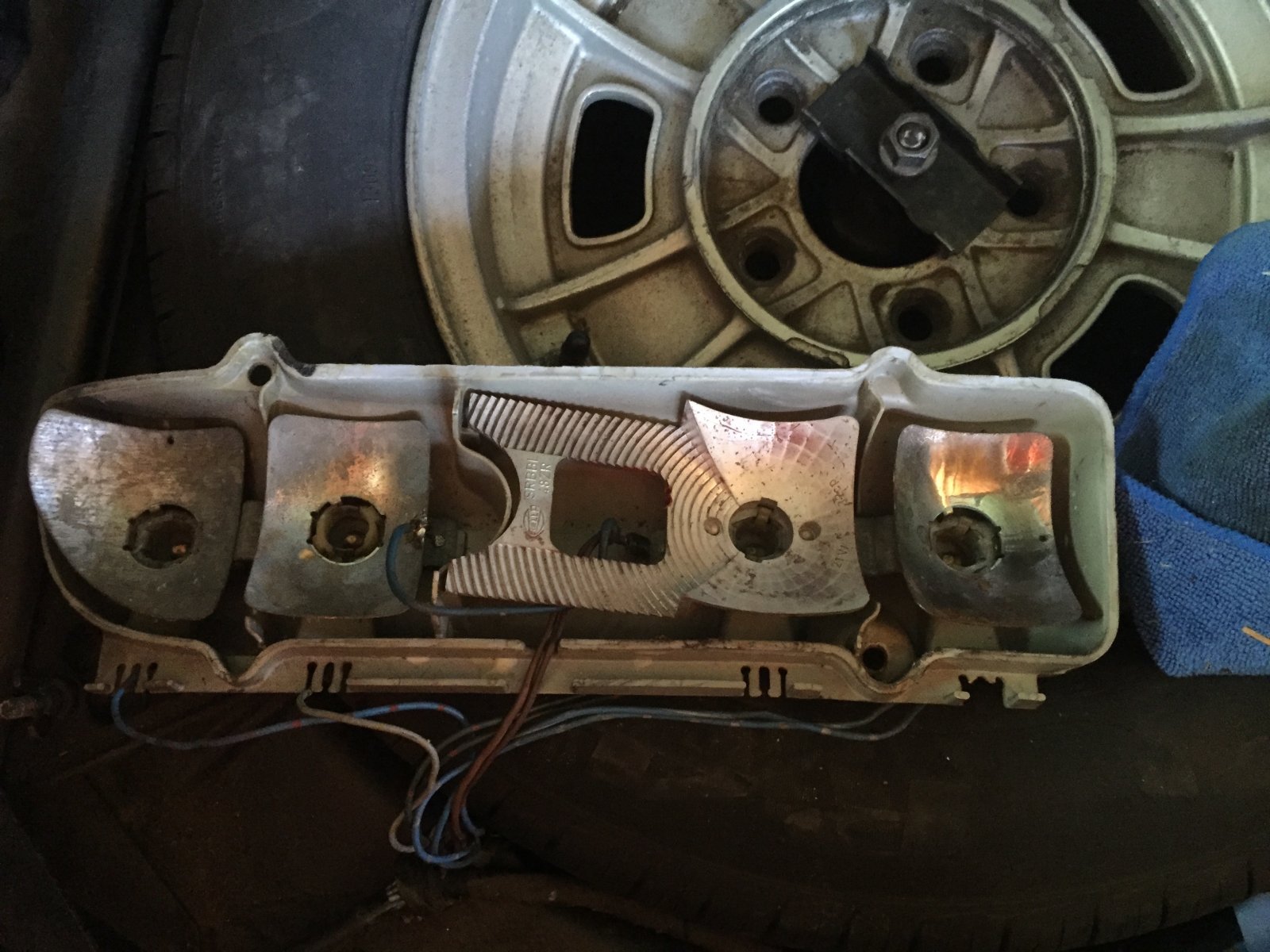

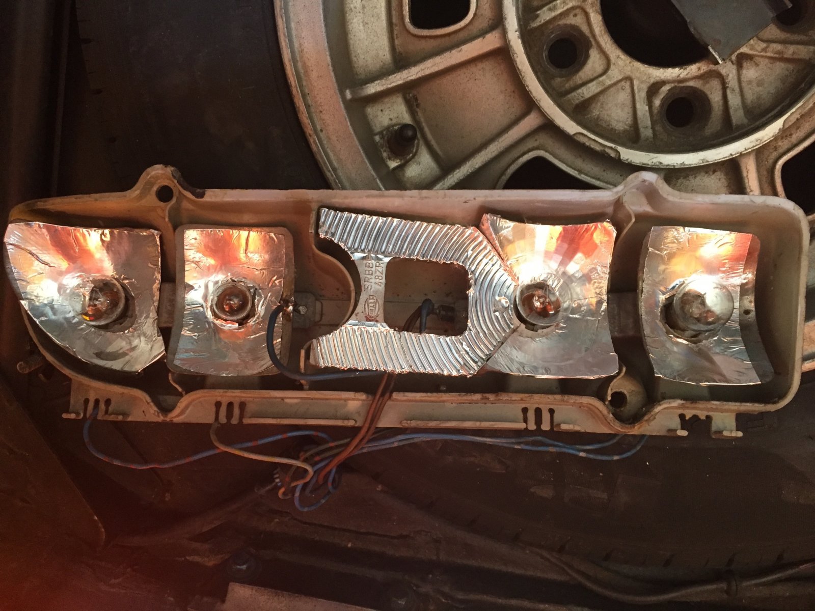

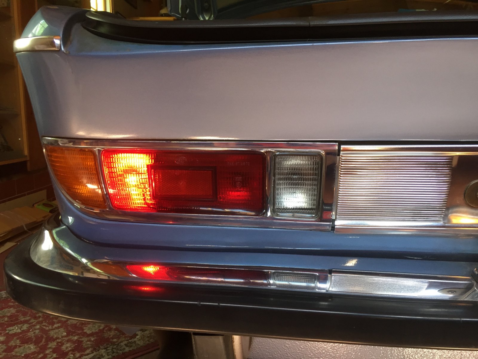

I did the taillight chrome tape project. This and the LED’s ought to be quite an improvement. Also cleaned and de-oxed all connectors and re-tensioned the bulb contacts. I used a wrap from Amazon that has an adhesive on the back and a clear vinyl film on front. Once you have the piece in place and all bubbles out, then you remove the vinyl which protects the shiny part. I did the reflectors in 2-3 strips each, it makes applying onto the deep curves much easier.
Before:
After:
Nicely done! I did that a few years go now with aluminum tape & it made huge difference with incandescents.

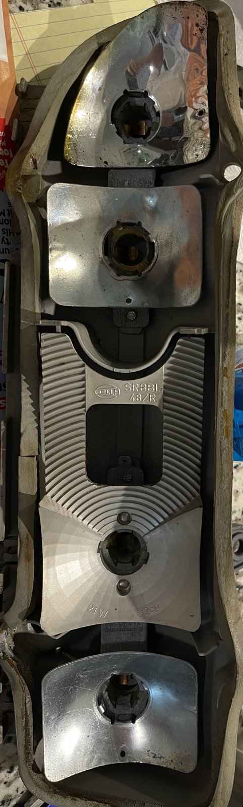

View attachment 148157View attachment 148155View attachment 148159

I’ve decided to keep the warm glow incandescent bulbs for the interior overhead light and try LED’s for the trunk and engine compartment lights for added brightness there. I will experiment with the license plate ones, if they look too weird with LED’s I’ll keep them old school as well.
I installed the LED white bulbs in the glove compartment, trunk, and engine bay for better lighting in a dark environment. The rest of the bulbs are like yours--OG incandescent.

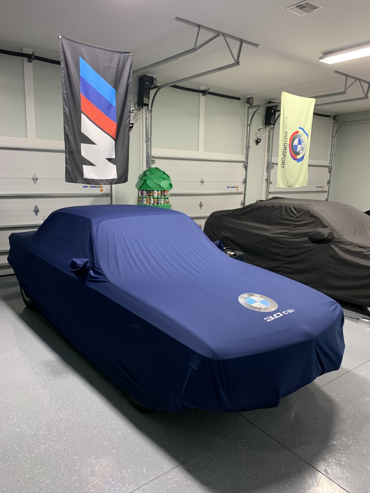

Taking a small liberty, yesterday we took our 72CSi on roughly hour drive to and back from wonderful Sunday brunch, then today I detailed it and tucked it away. Since getting it back from an 11 month mechanical refresh about a year ago, it’s been an absolute dream. AC in particular manages to keep us cool even in the Florida September heat. View attachment 148729
Beautiful car cover, where did you buy it?
Very nice car cover where did you buy this from
Dan special ordered these with the logos etc as a favor to the forum. He has said they come from the Cover Company, I bought a plain one last year from them and they are excellent quality. They have different options available, mine does not have the mirror pockets but still fits perfectly. It is the "Fitted BMW Car Cover - Indoor Silver Range"
And I got the logos added to mine, at no additional cost. It was a few years ago but they were something like $275 including shipping.
Next post is correct, I found it through a post by Dan Mooney a few years ago. They’re from cover company and I believe they’re made in Spain. I also had one made for my M Coupe and my Porsche Boxster. They’re beautiful and I’m extremely happy with them.
is it carcover.com ?
