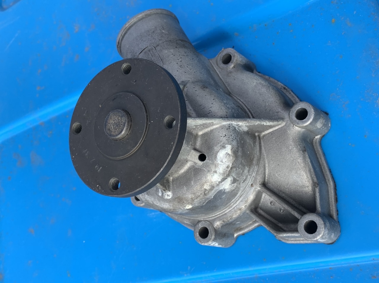

I actually had 2 pumps fail. The first pump was 2 years old and had a little over 1,000 miles. That pump was a Graf. The second pump was a Hepu. The one I installed yesterday is a BMW pump; so we will see how that goes…

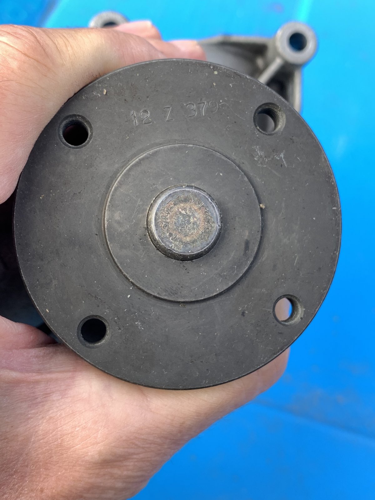

Here is mine. Failed after 1500 miles. No name that I can see. Only some numbers…. Replaced with a real BMW one. Knock on wood.
View attachment 149456View attachment 149457
That is a Graf. I used Grafs for years, then Saleris, but then had a bunch of Saleri failures within a year to 18 months, so switched back to Graf. Hepu was only recently available then I wasn't able to get one in time so I used a Graf. I'd like to know who makes the BMW pump, but it probably doesn't matter and is Uro Parts just like everything else they offer these days.
