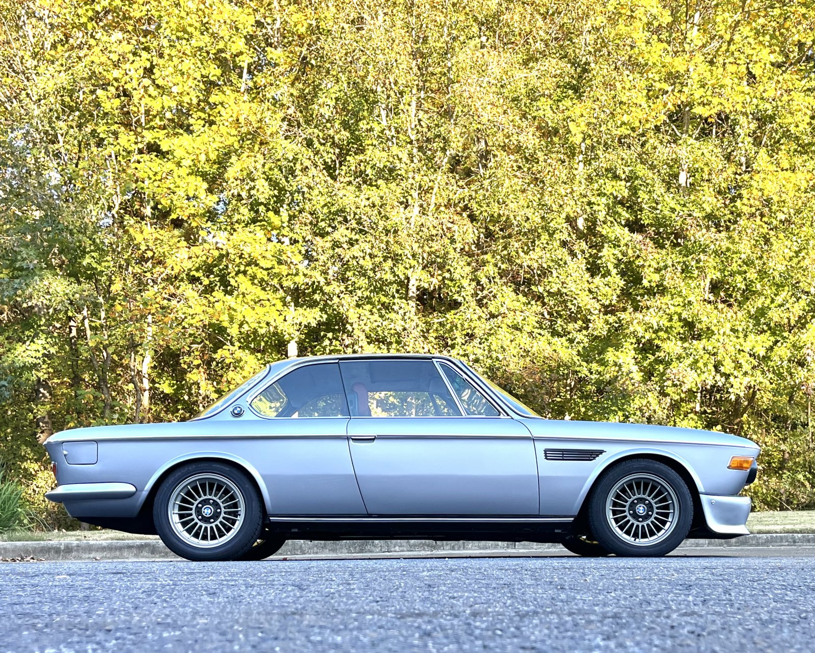

Drove the car for about one hour and then captured the fall colors in the backdrop of the parking lot.

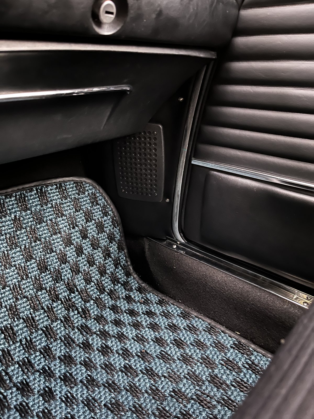

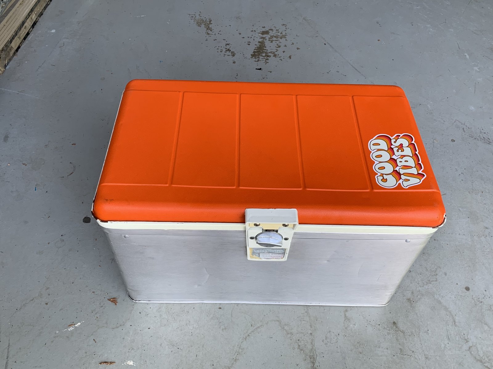

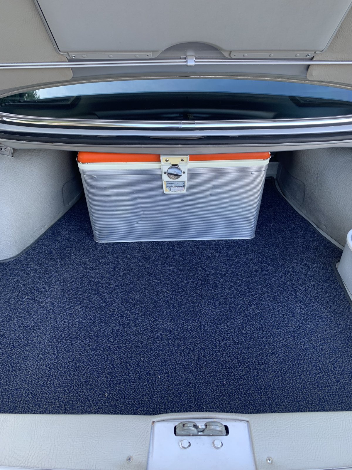

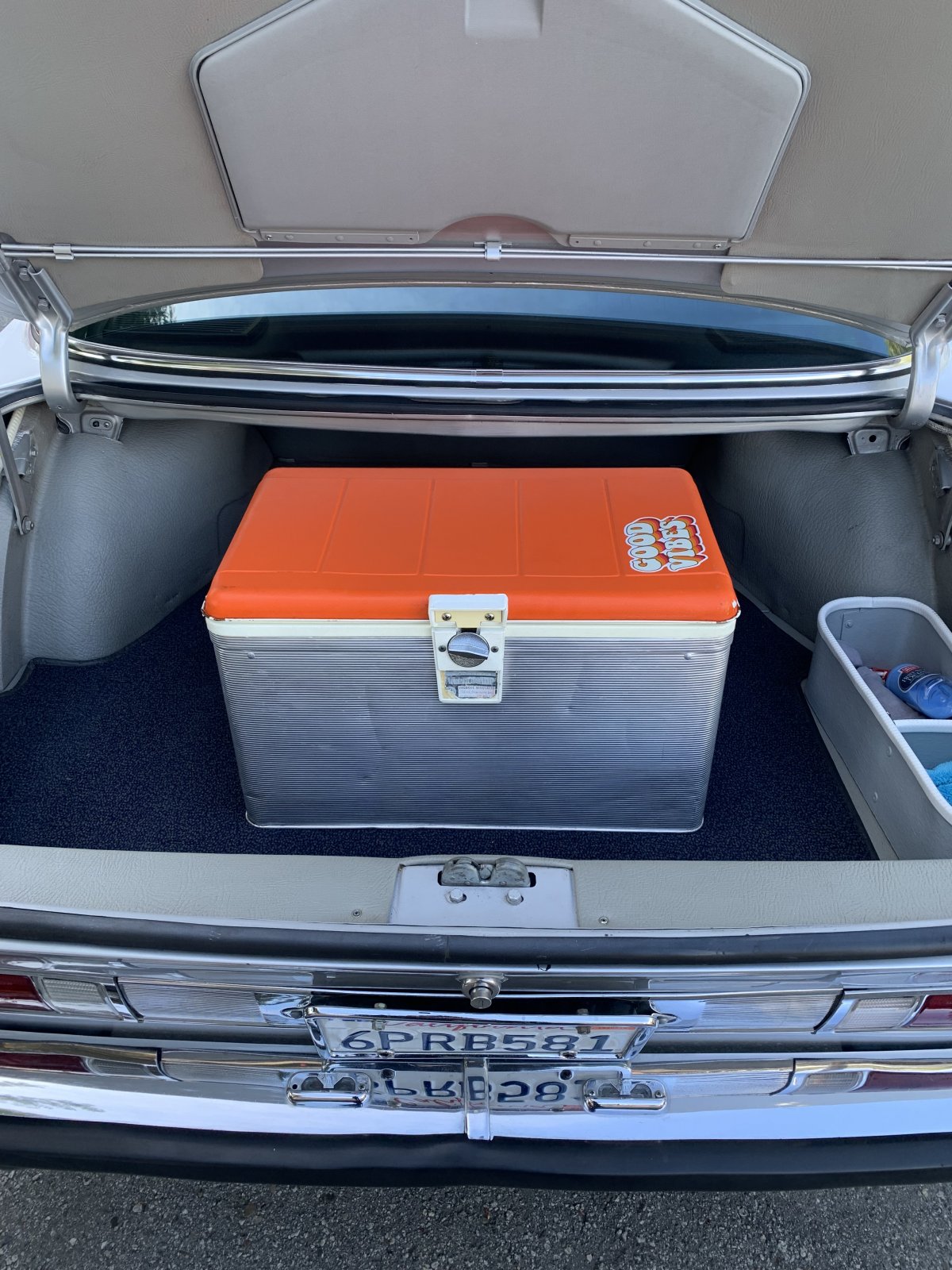

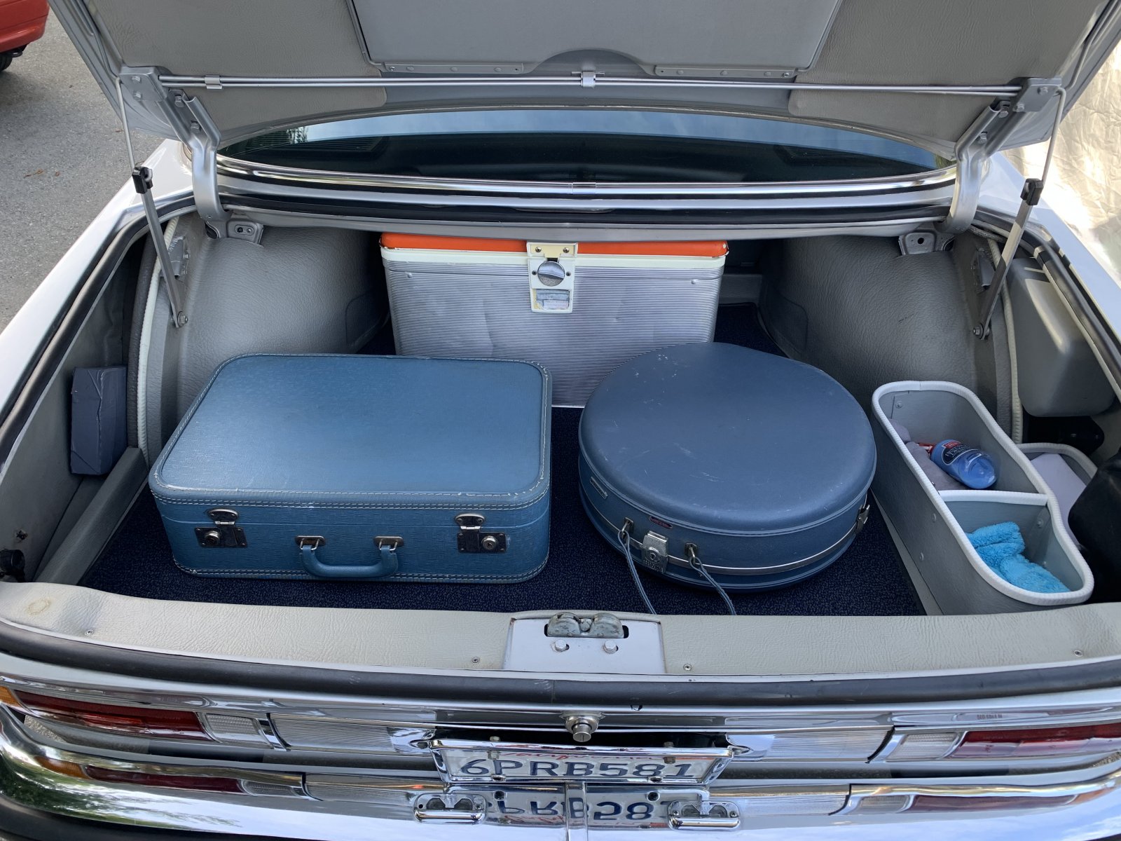

Got some nice accessories.

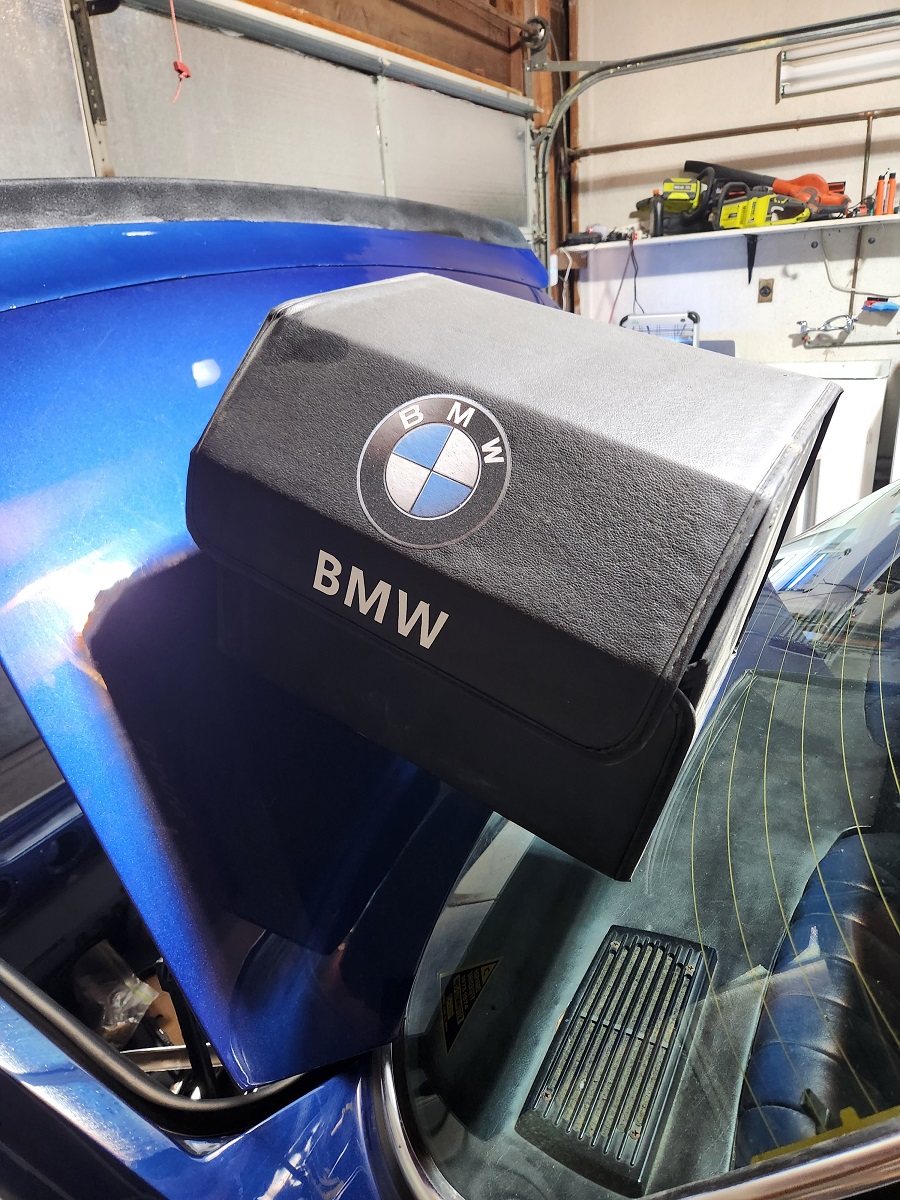

it is very nice, it is really nice touch, how would think about that, but I have this box in my trunk check the picture, but I will copy you

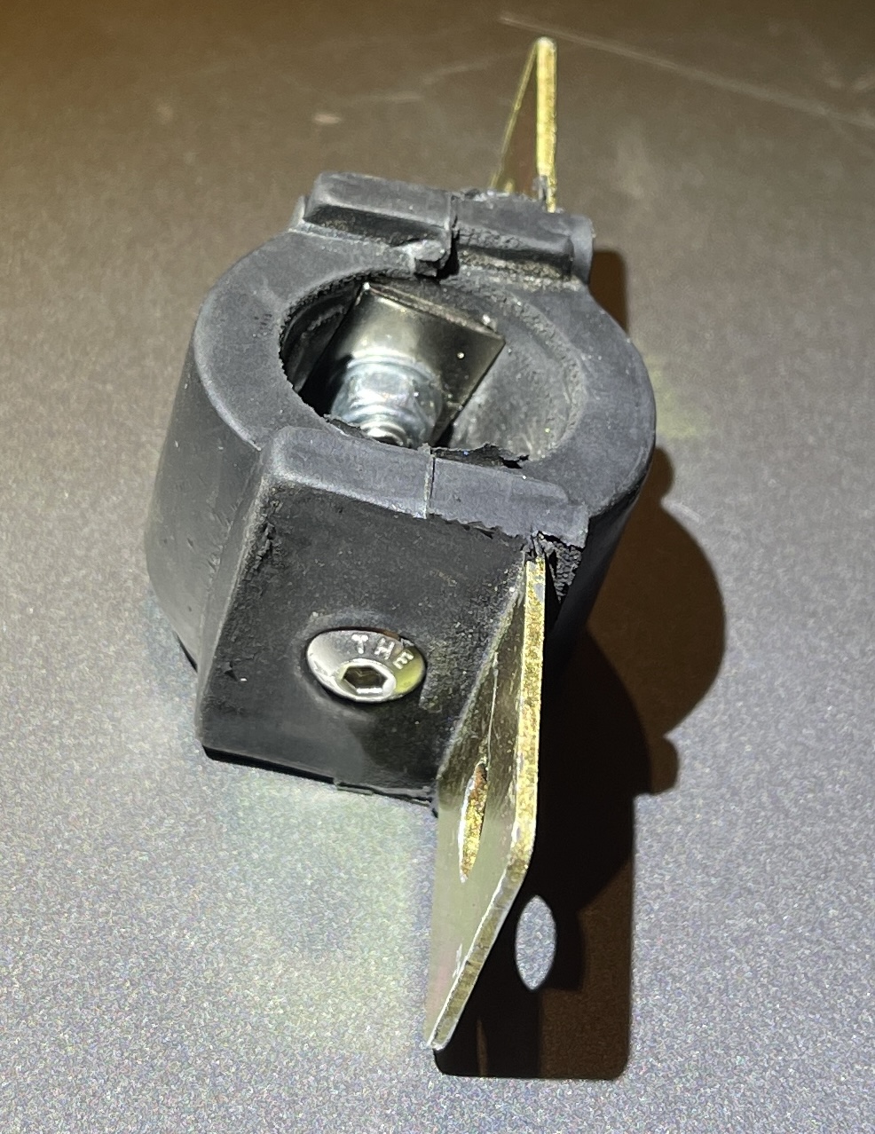

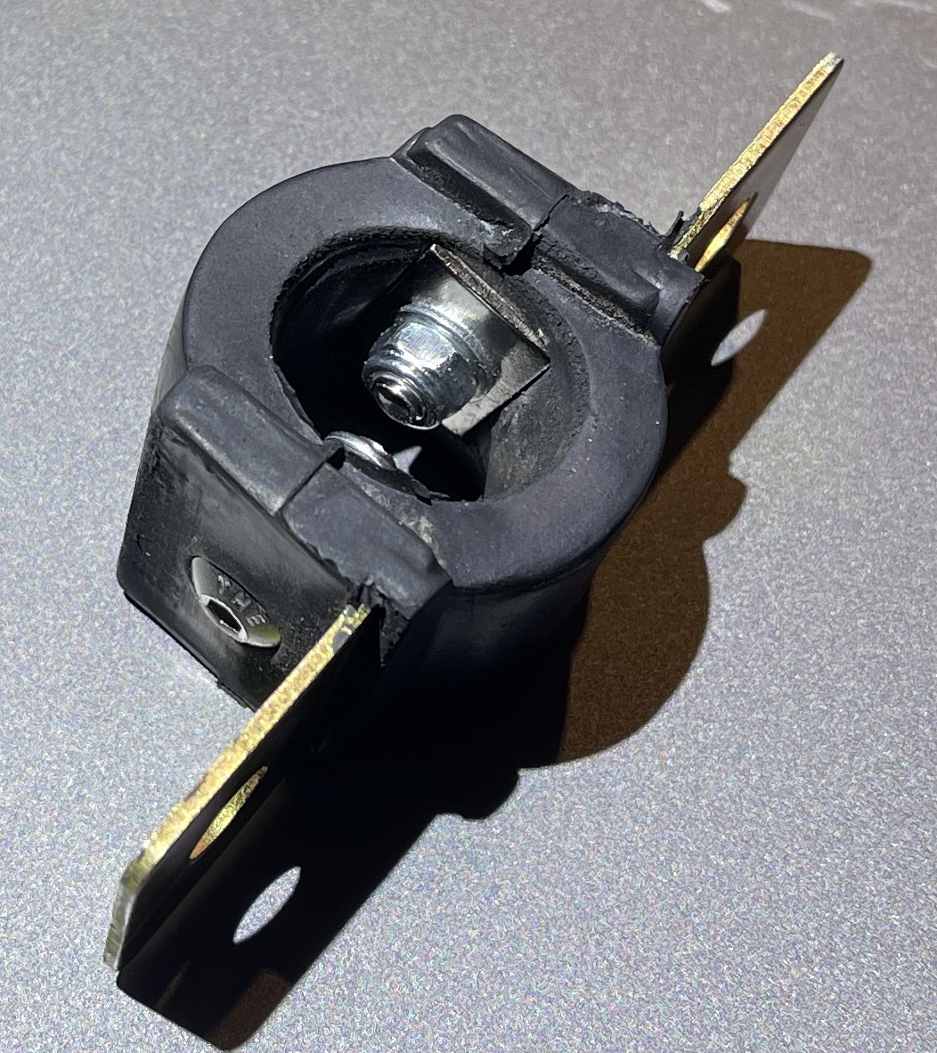

Finished 2 more exhaust mount reinforcements, as discussed previously the ones from BMW are shite and separate within days of enlistment. Each one has 2 hex screws, reinforcement plates for the rubber sides, washers, and lock nuts. Still room inside for the rubber to compress from bumps.
i knew the ones from W+N were crap, but i didn't think they were actual BMW. i used ones from BMW when we put the new exhaust on ... might be circling back to this thread before too long

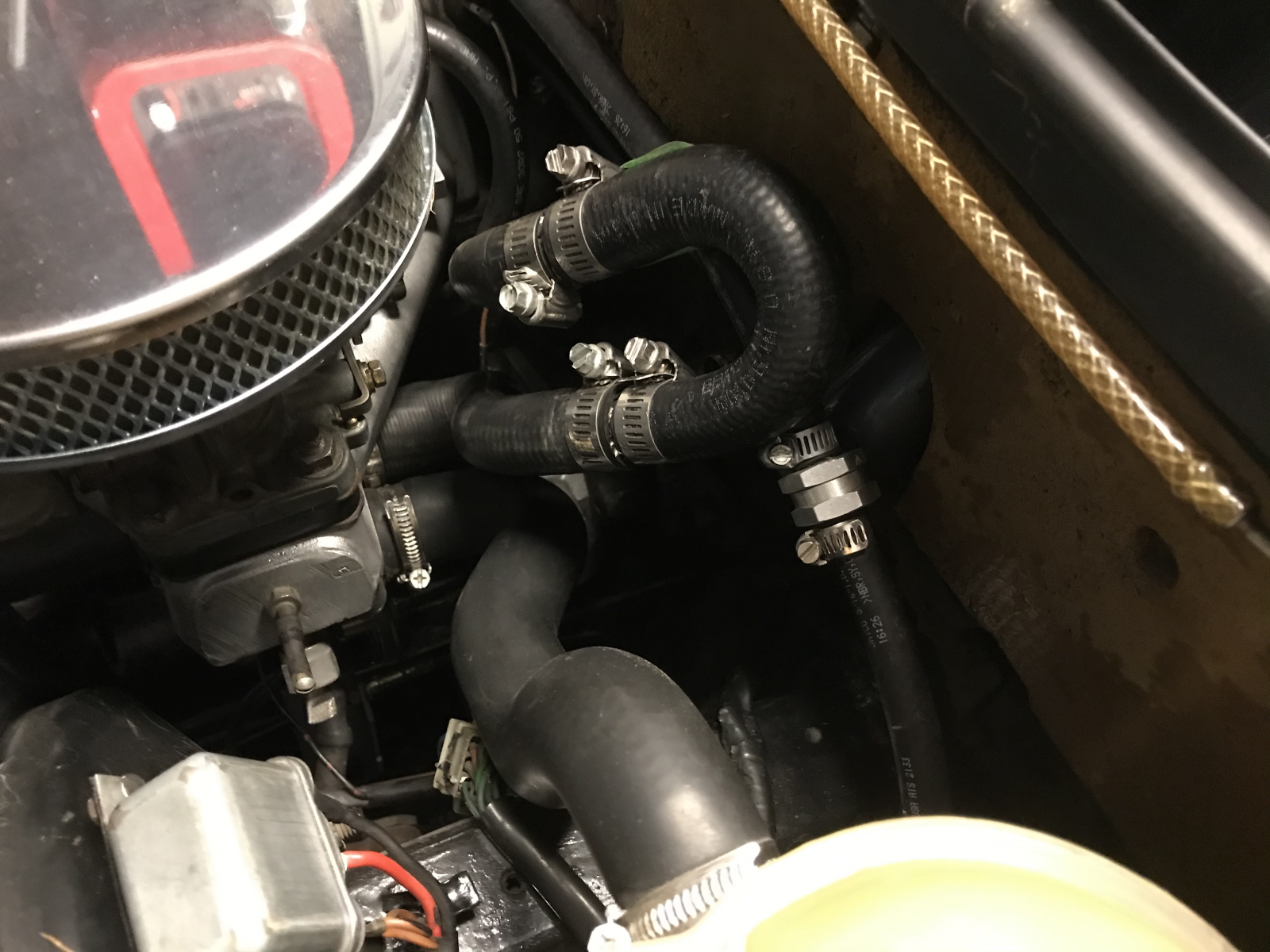

Today I re-introduced my heater to my cooling system. Had been disconnected about a year while I had the unit out and rebuilt it, new Bowden cables, new foam on all flaps, rebuilt heater core, new seals, and so on. Then, I installed my heater delete hose to keep the extra heat out of the cabin during summer. Now that days are 5C, really missed heat. Re-connection took 10 minutes, all sliders and cables function as new! Toasty toes again! ;)

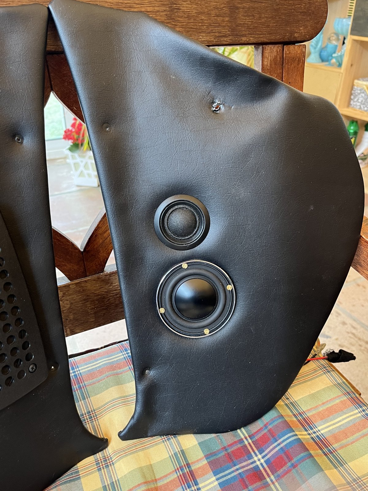

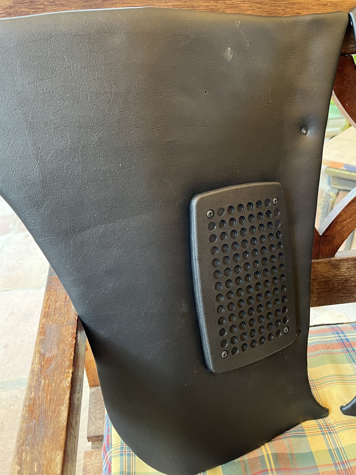

Looks awesome. Just for shits and giggles, remember tweeters are directional, hence their placement up in the a-pillar region on most modern cars. If your not happy with the high frequency results, they do make some generic a pillar tweeter mounts... Just a thought.
