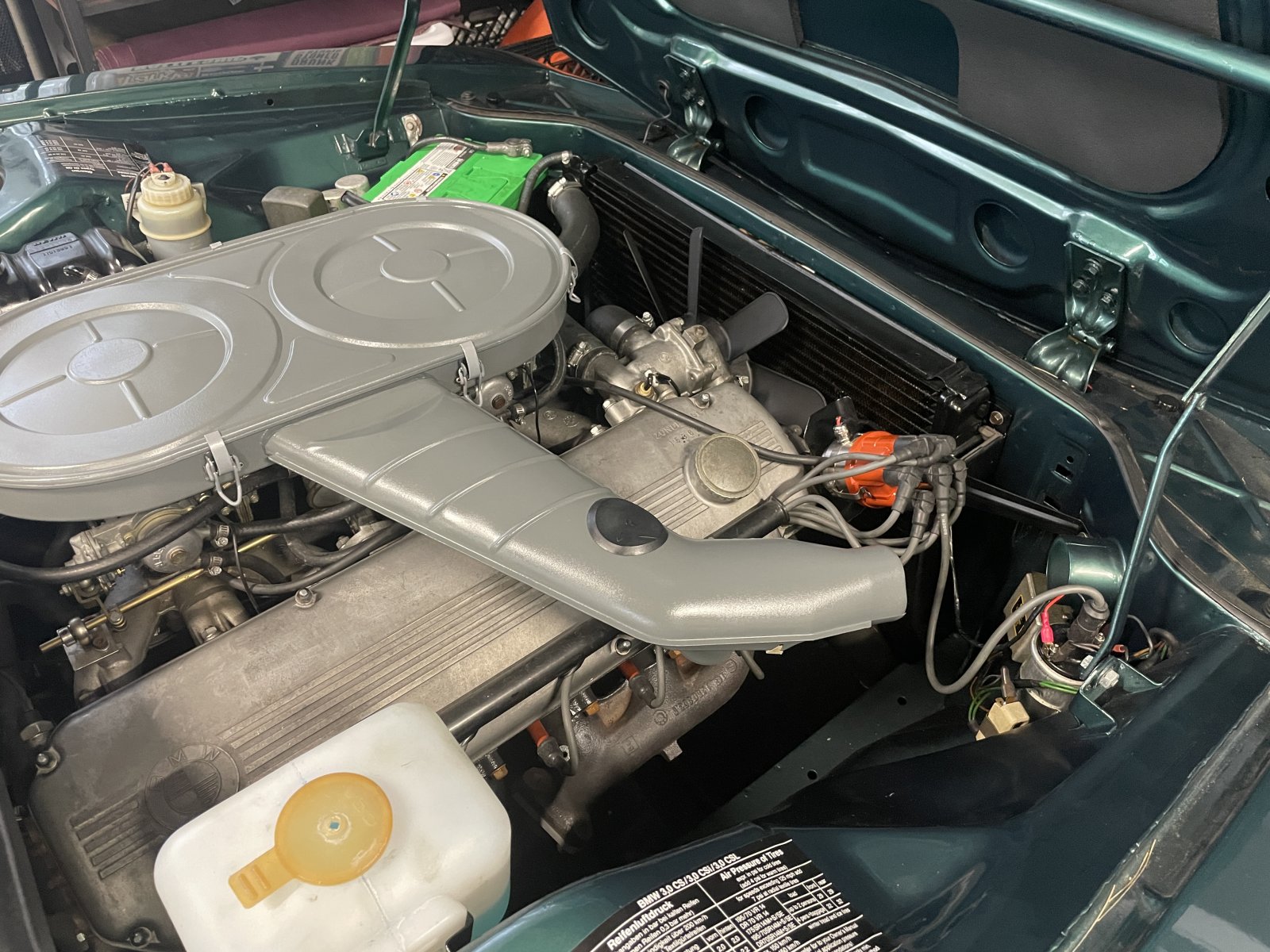

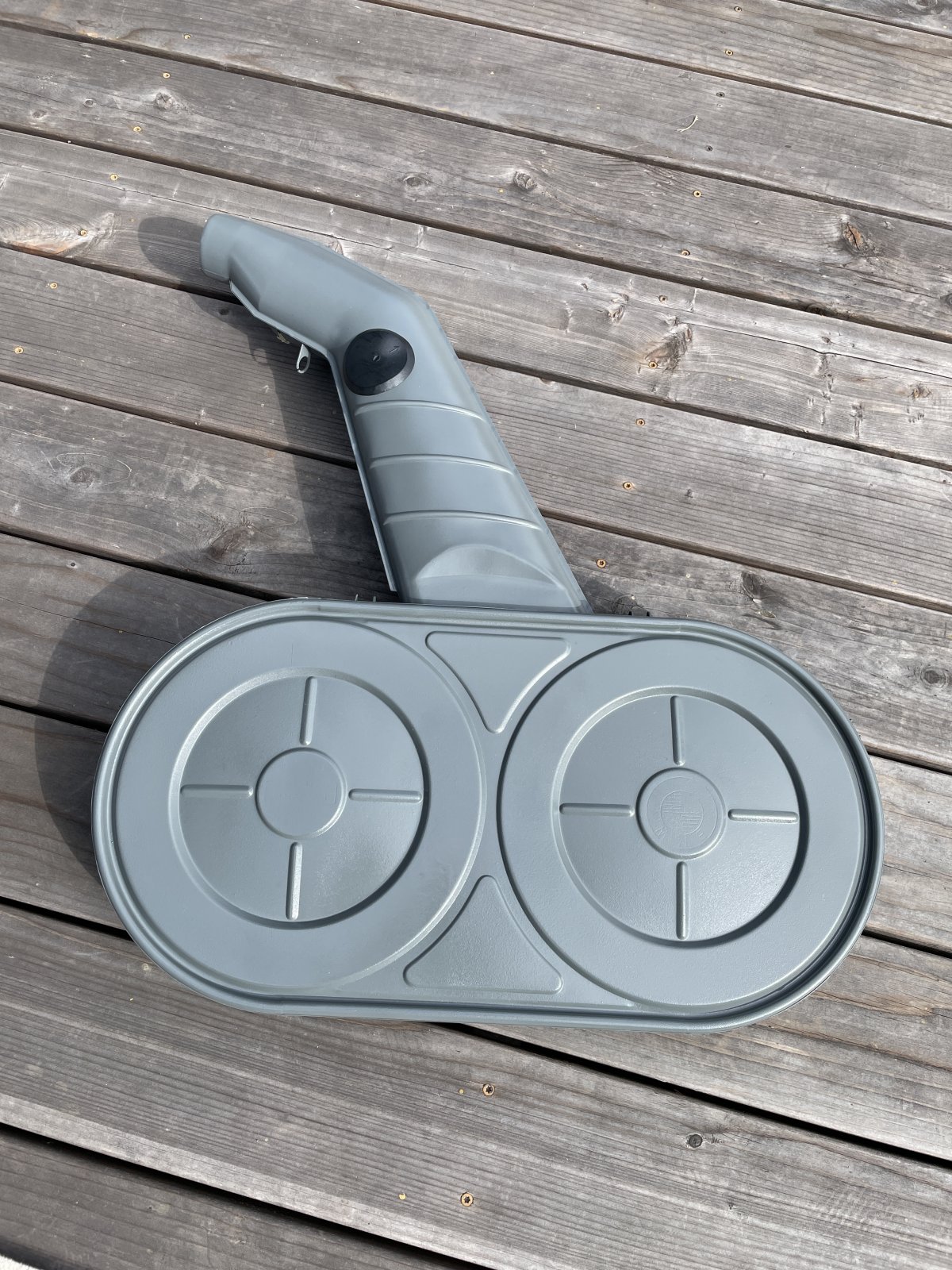

Decided to remove the K&N filters and put the stock air filter that came with the car on.

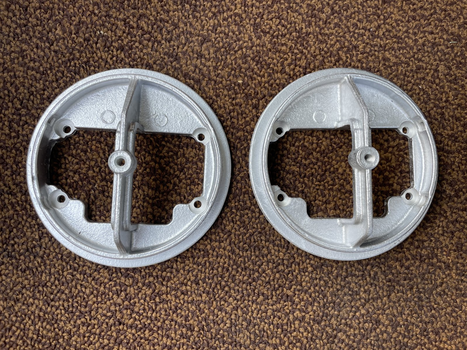

But first I needed to refinish the air filter and put in the Weber adapters.
Only driven it a bit, but pretty happy with it so far.

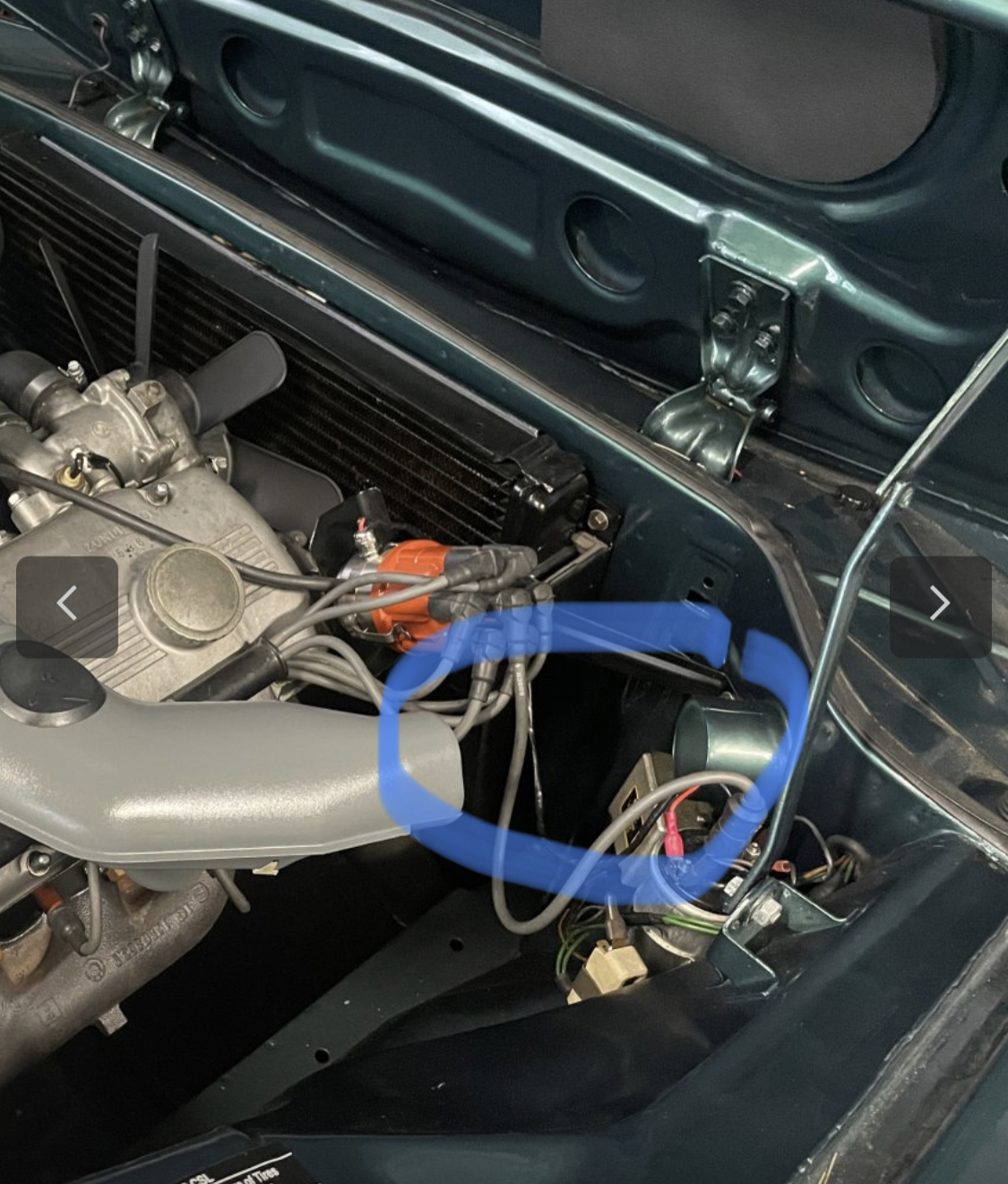

Anyone have strong feelings about important is the hose that connects the air filter to the vent?
And of course keeping the K&N filters so I can put them back on if I want.

You will get a bit cooler air which is usually good. Still available I think.
It is totally unimportant to the running of the car. Some run a hose down to the bottom of the engine bay. Iv’e kept mine connected to the filter housing. The only thing I would not recommend is putting a mini filter on the. c, as over time the crank case emissions will dirty up your engine bay.

Get a new hose, they are made of paper. Please don’t use plastic dryer hose! :cool:
I'm curious, mainly because I think that paper "hose" is the jankiest part on the entire car, but what is it about the plastic dryer hose that you object to?
While I agree that a plastic dryer hose is not the best replacement, is it the engine heat, or some other condition in the engine bay (or is it the overall jankiness of the dryer hose...}?
The original hose a reinforced corrugated paper and will last quite a long time. Every time I see dryer hose it does not fit well and just looks cheap to me anyway.

Another possibility instead of the correct air cleaner hose, use the '02 accordion style rubber air cleaner hose.
