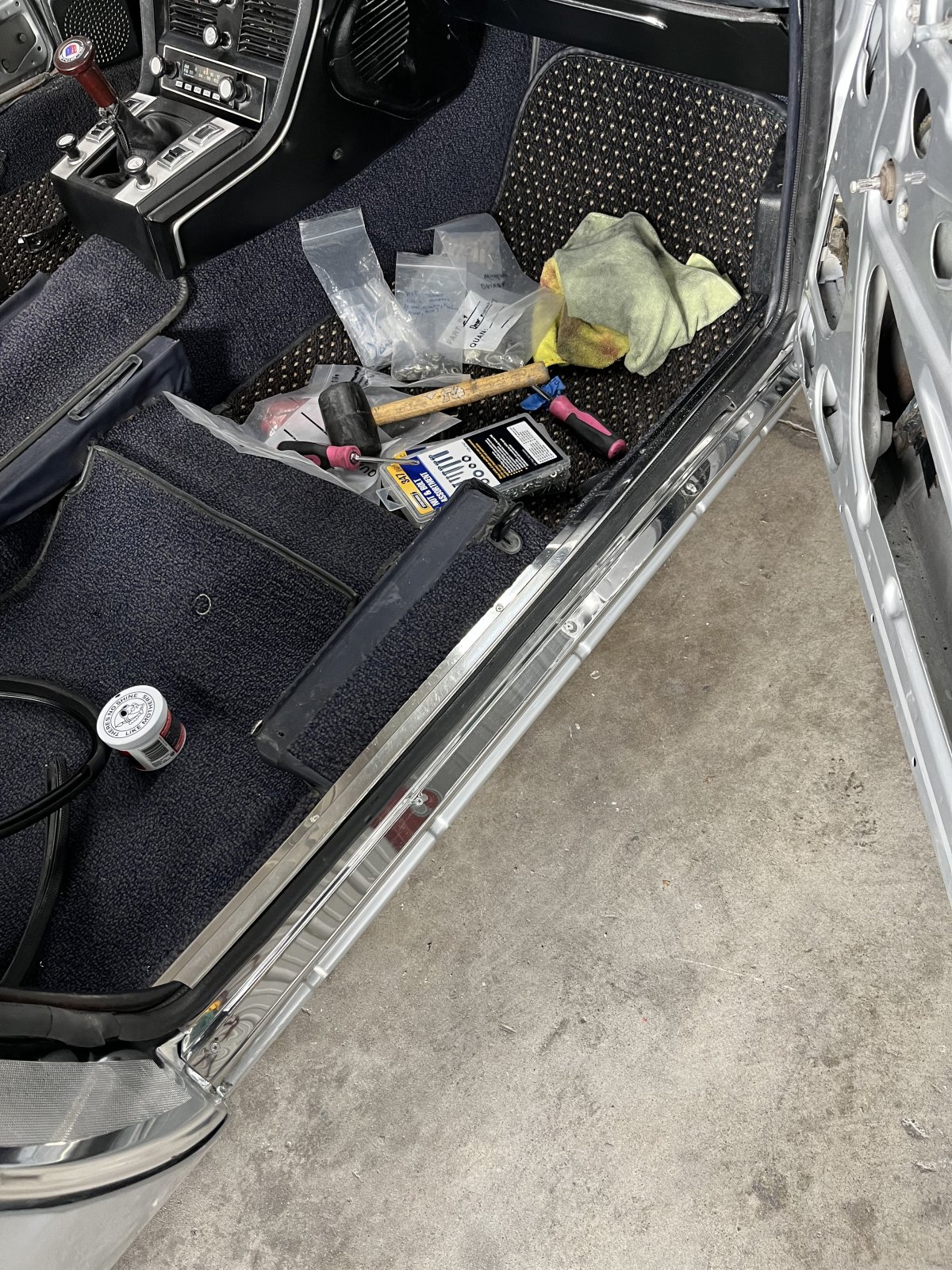

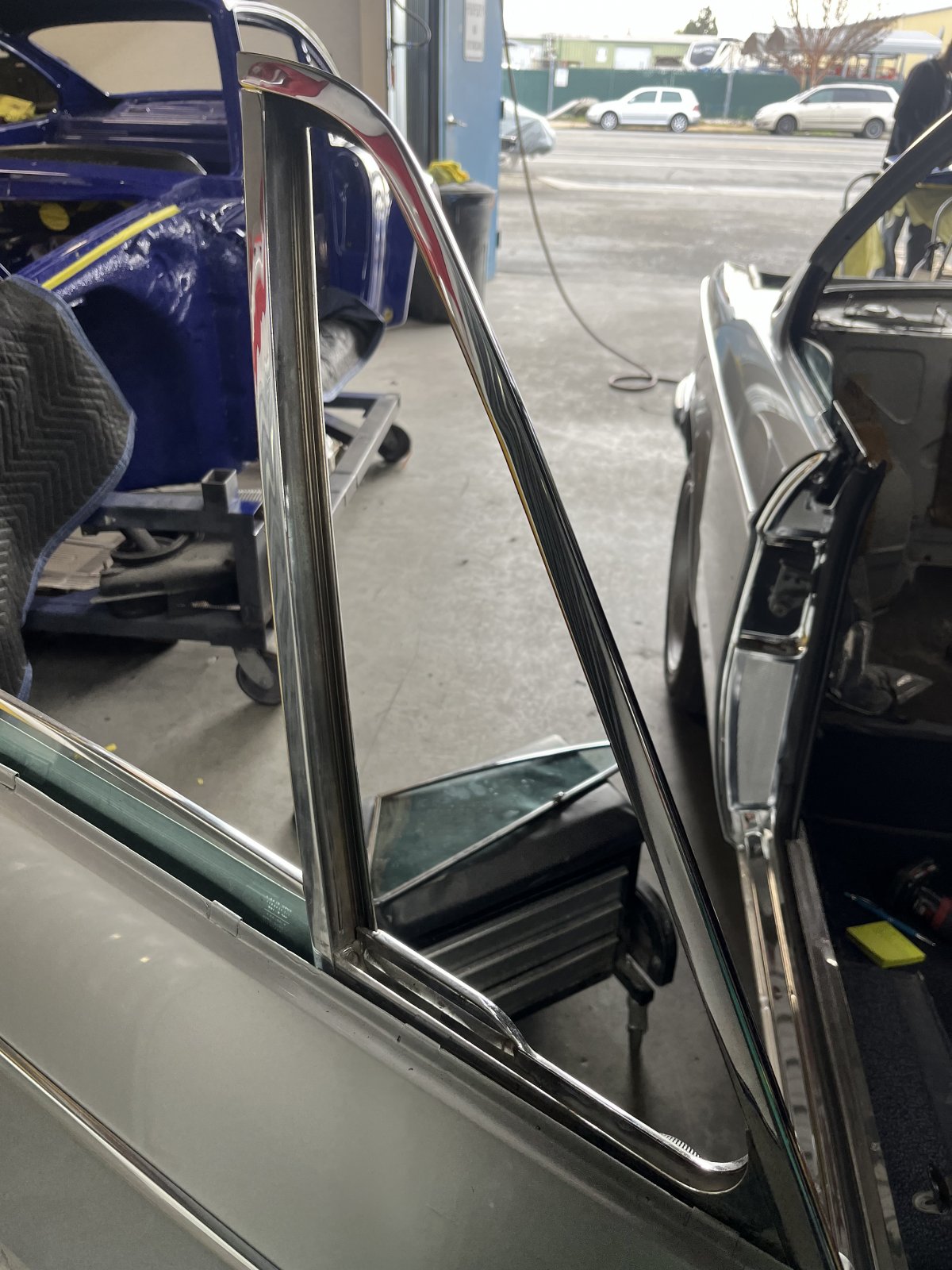

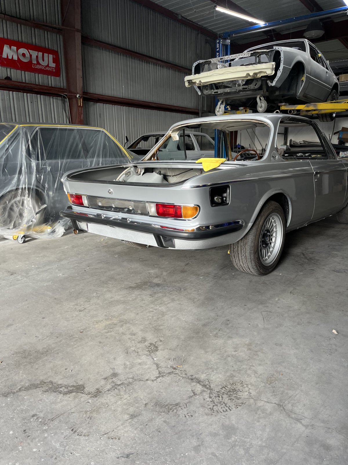

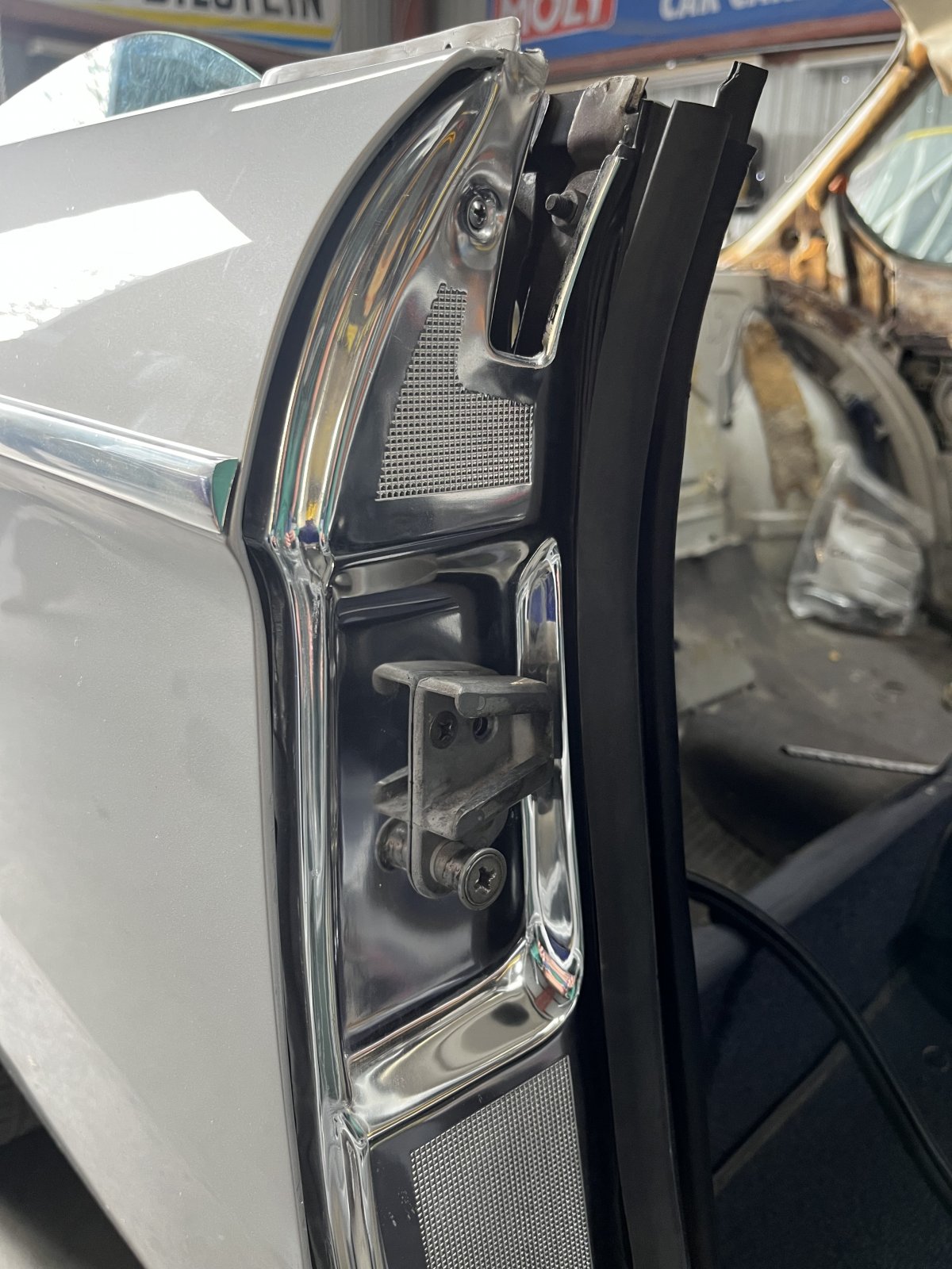

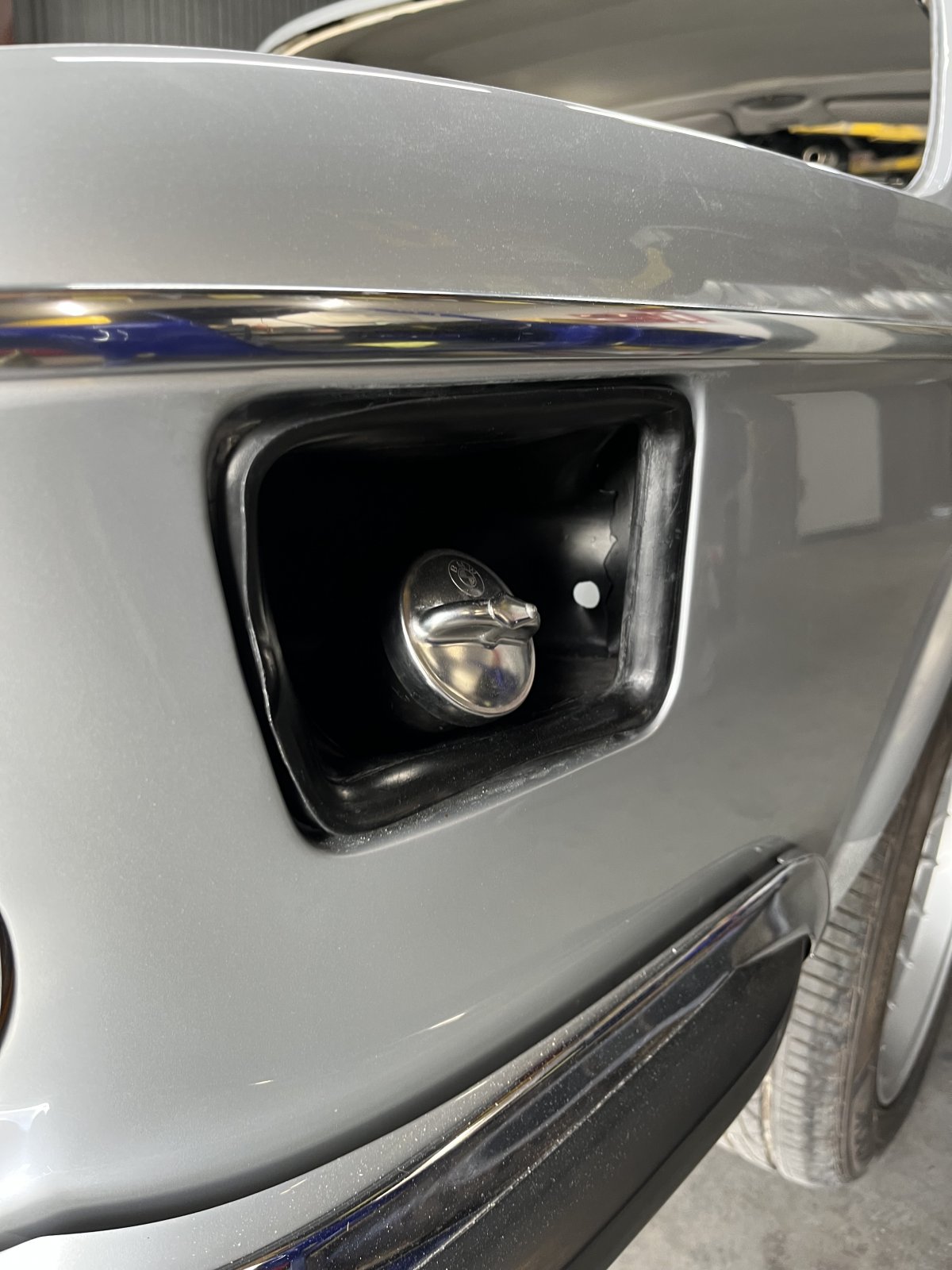

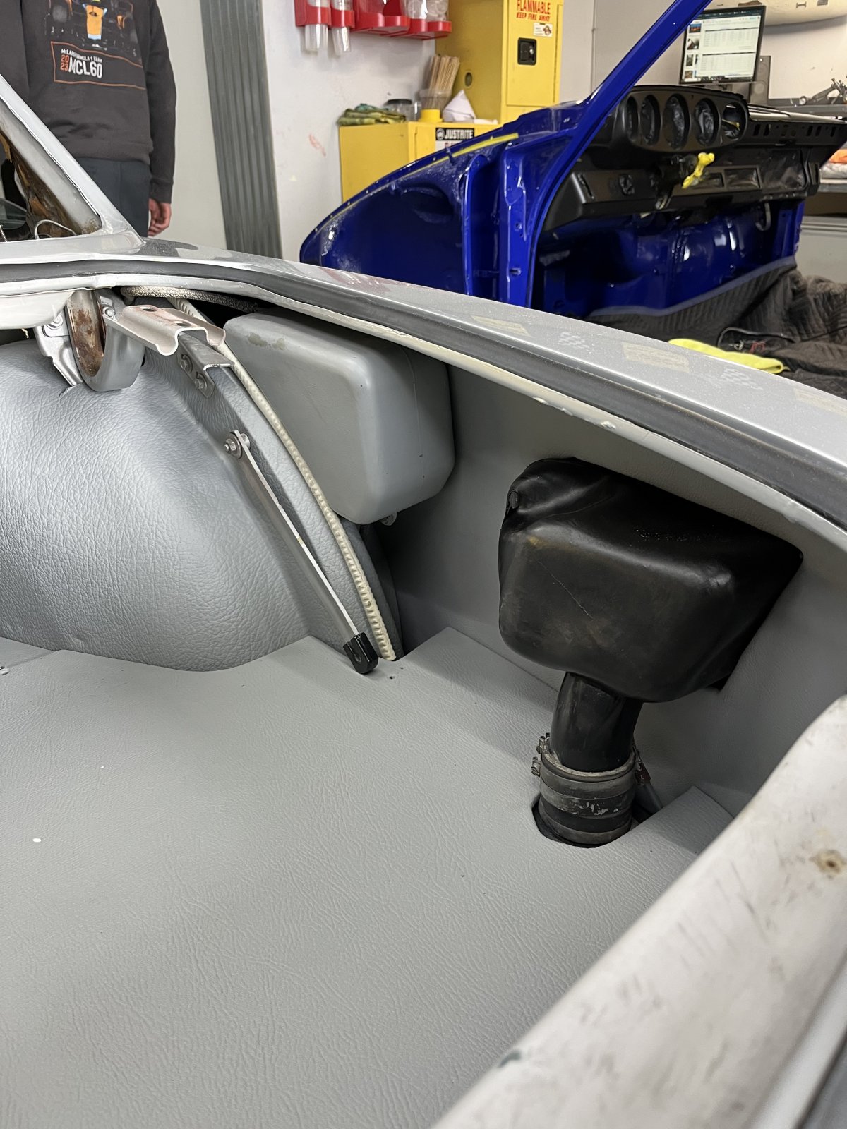

Rear bumper installed, front and rear chip guard painted with Wurth undercoat. Trunk liners in, door jams being put on

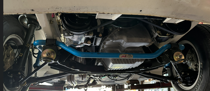

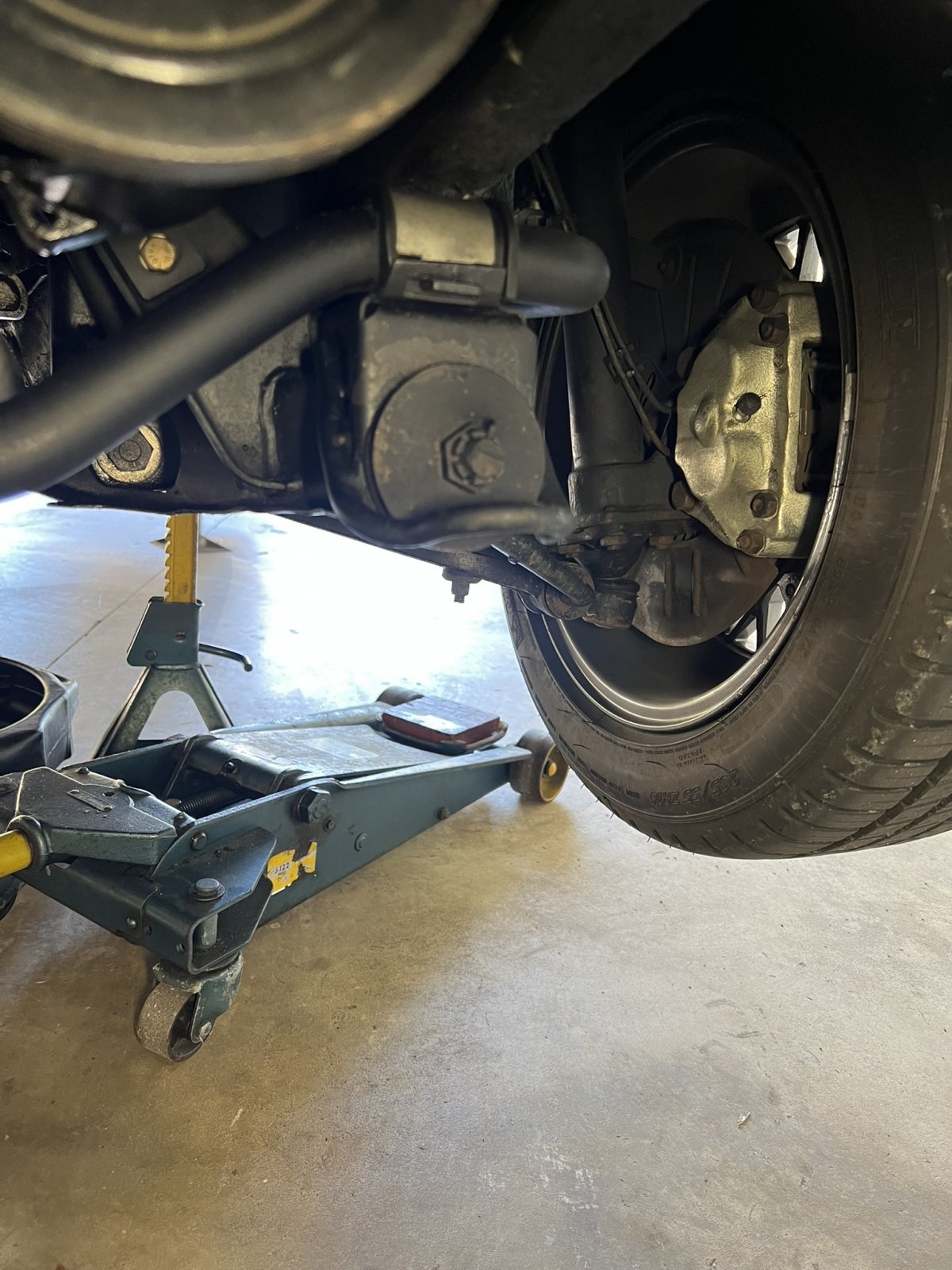

My Coupe joined the yellow washer club last Saturday. Almost all of the resto cars on BaT have the yellow washers,and I needed to add a couple of Euros to my W&N order to get their discount.

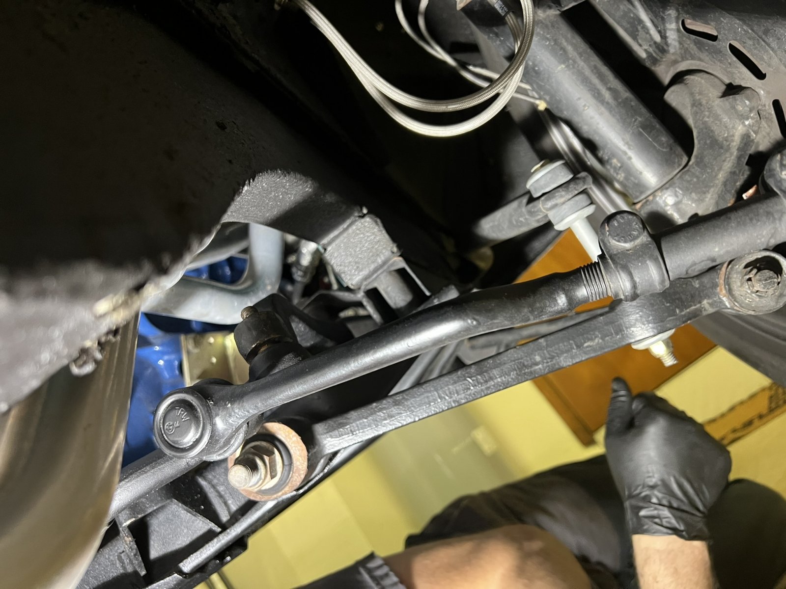

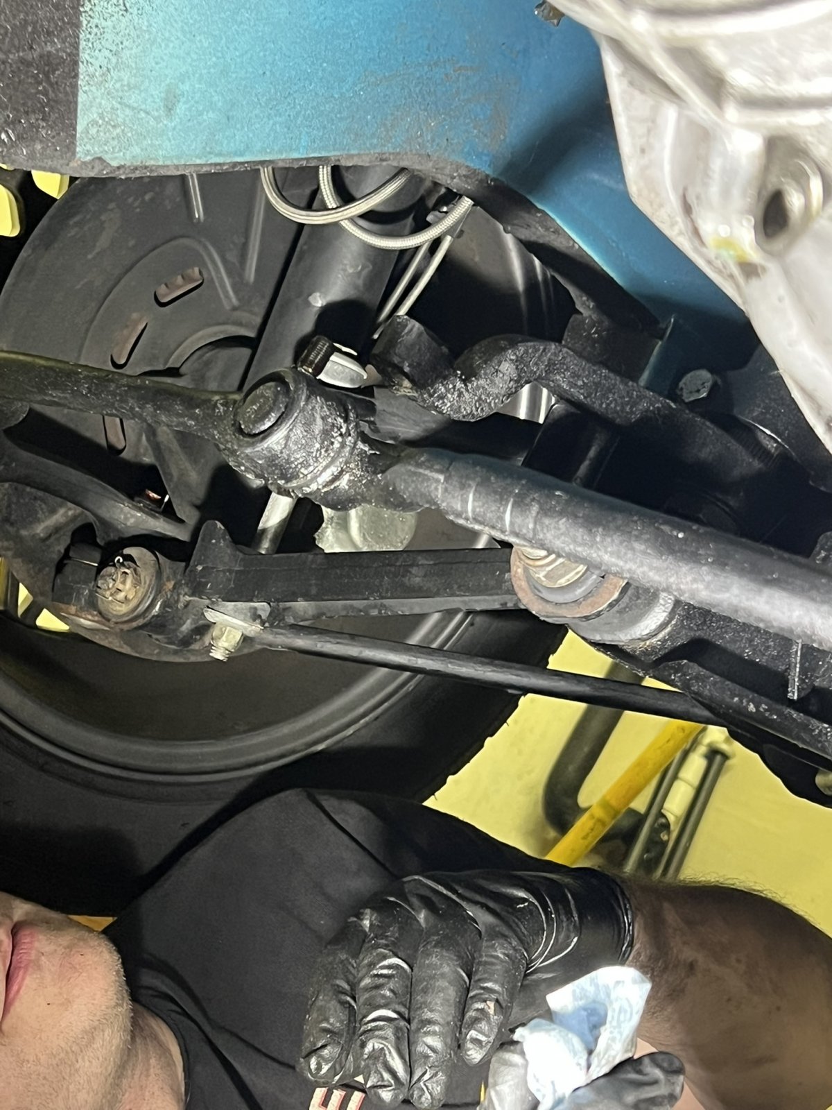

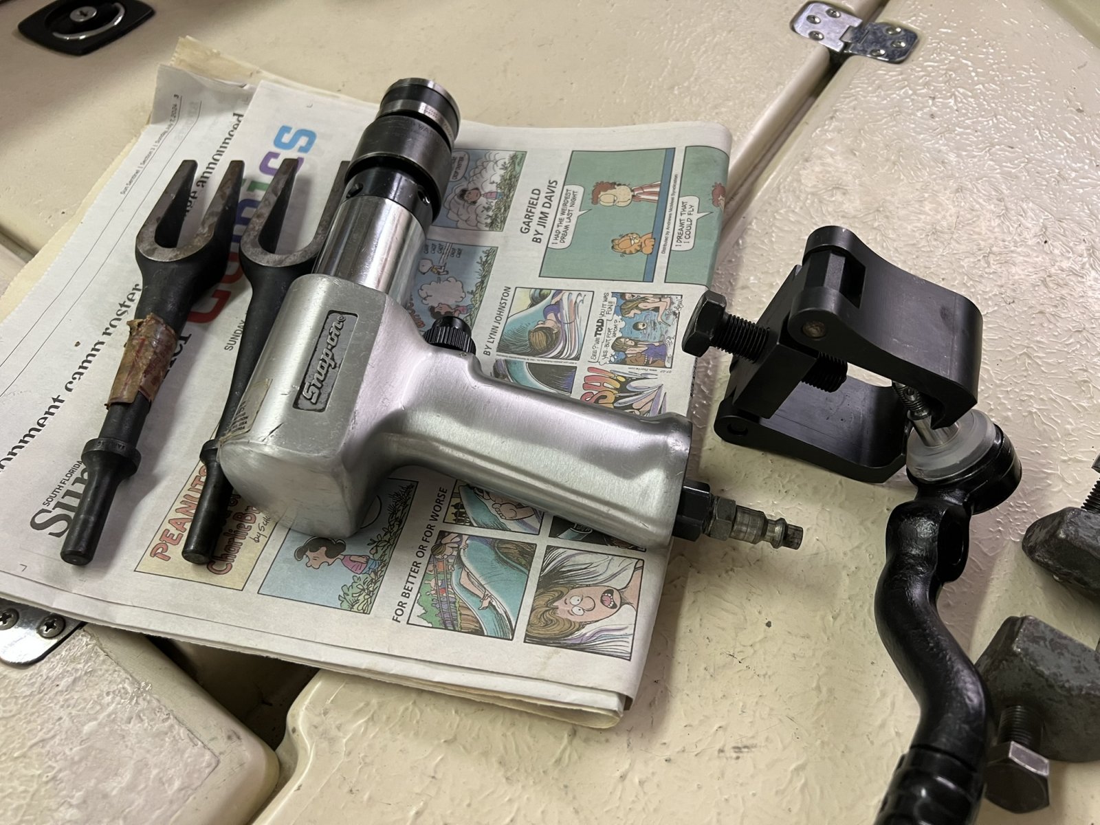

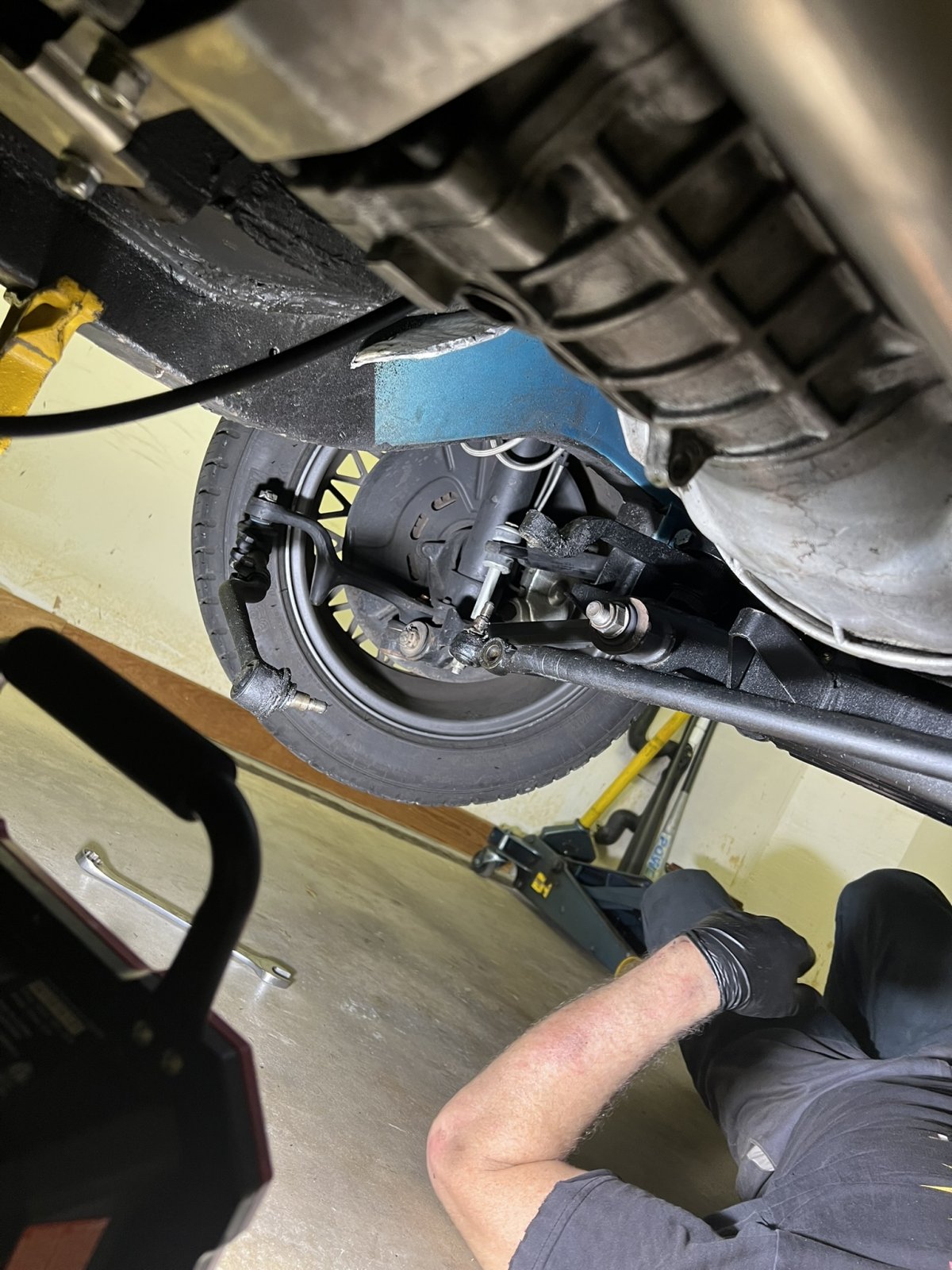

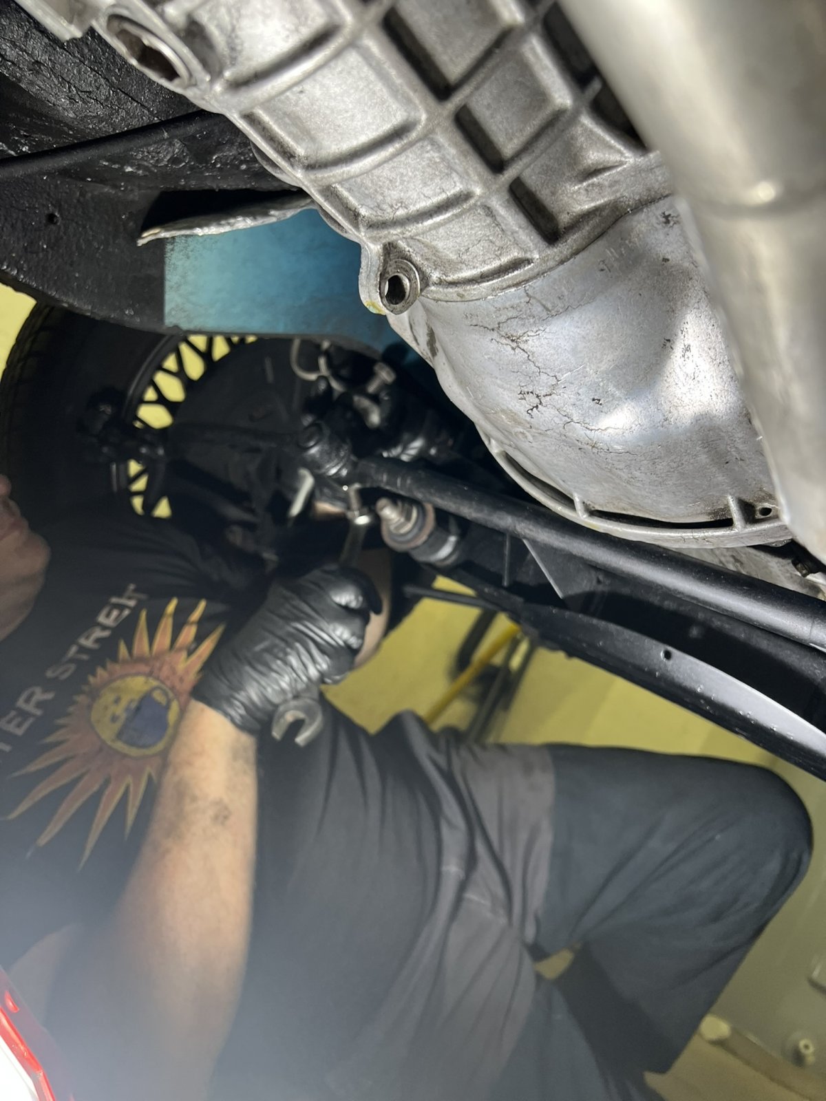

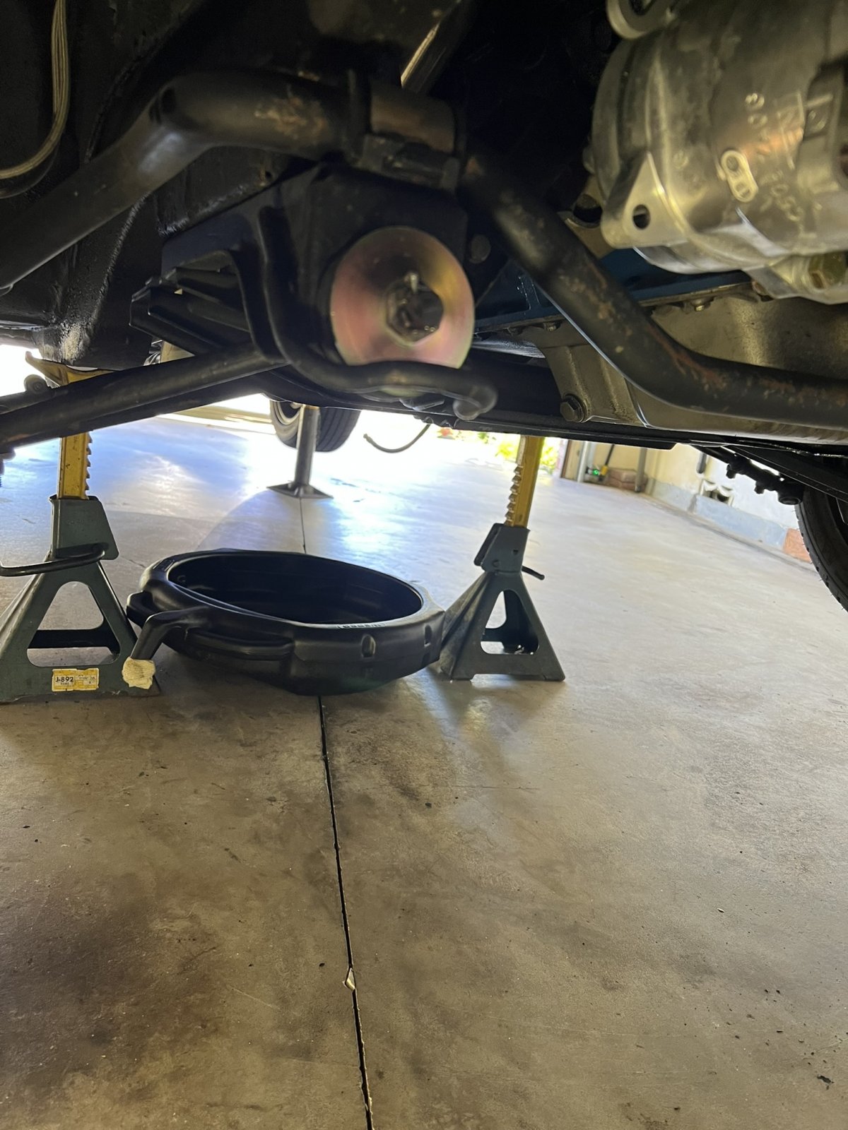

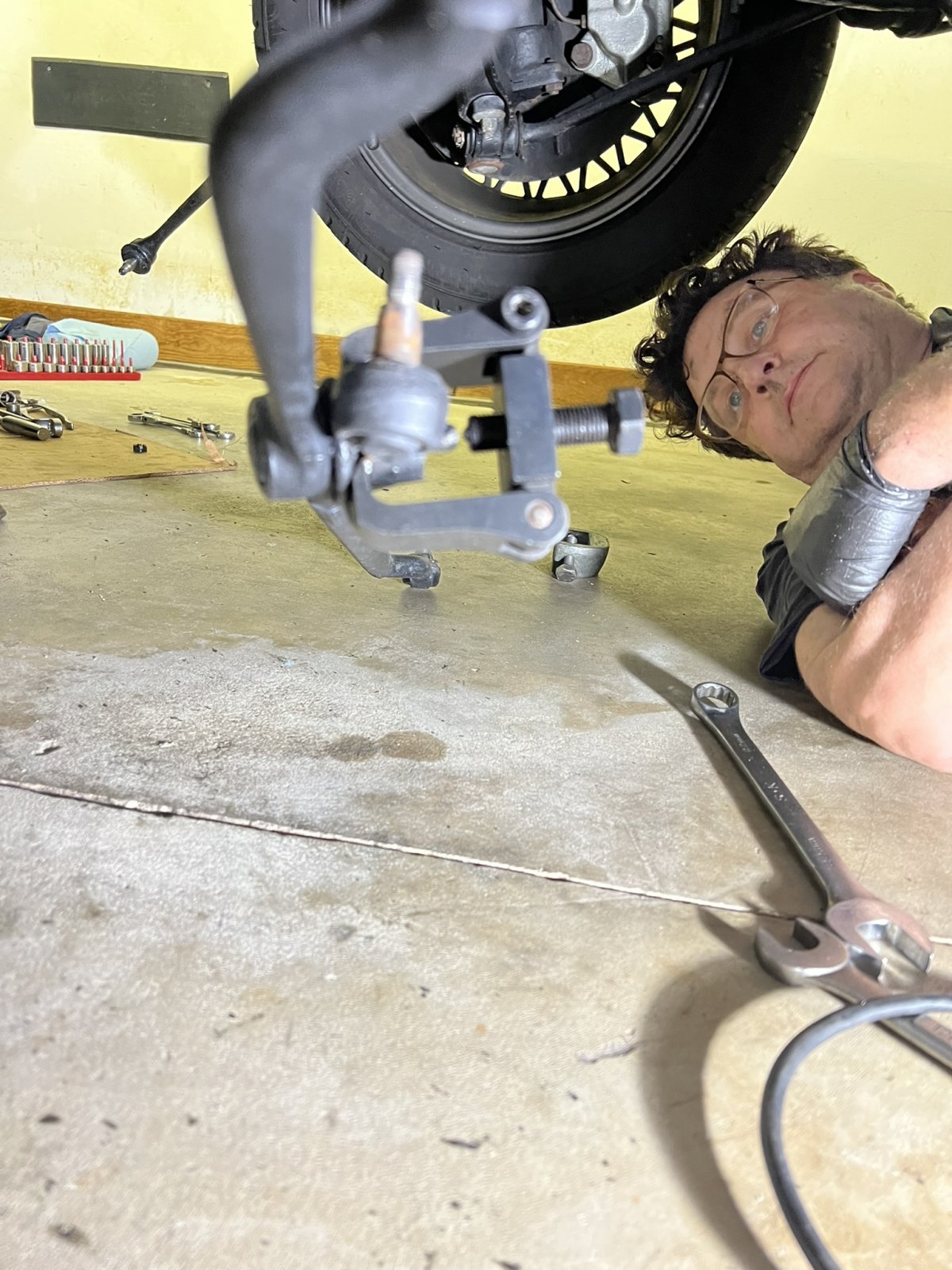

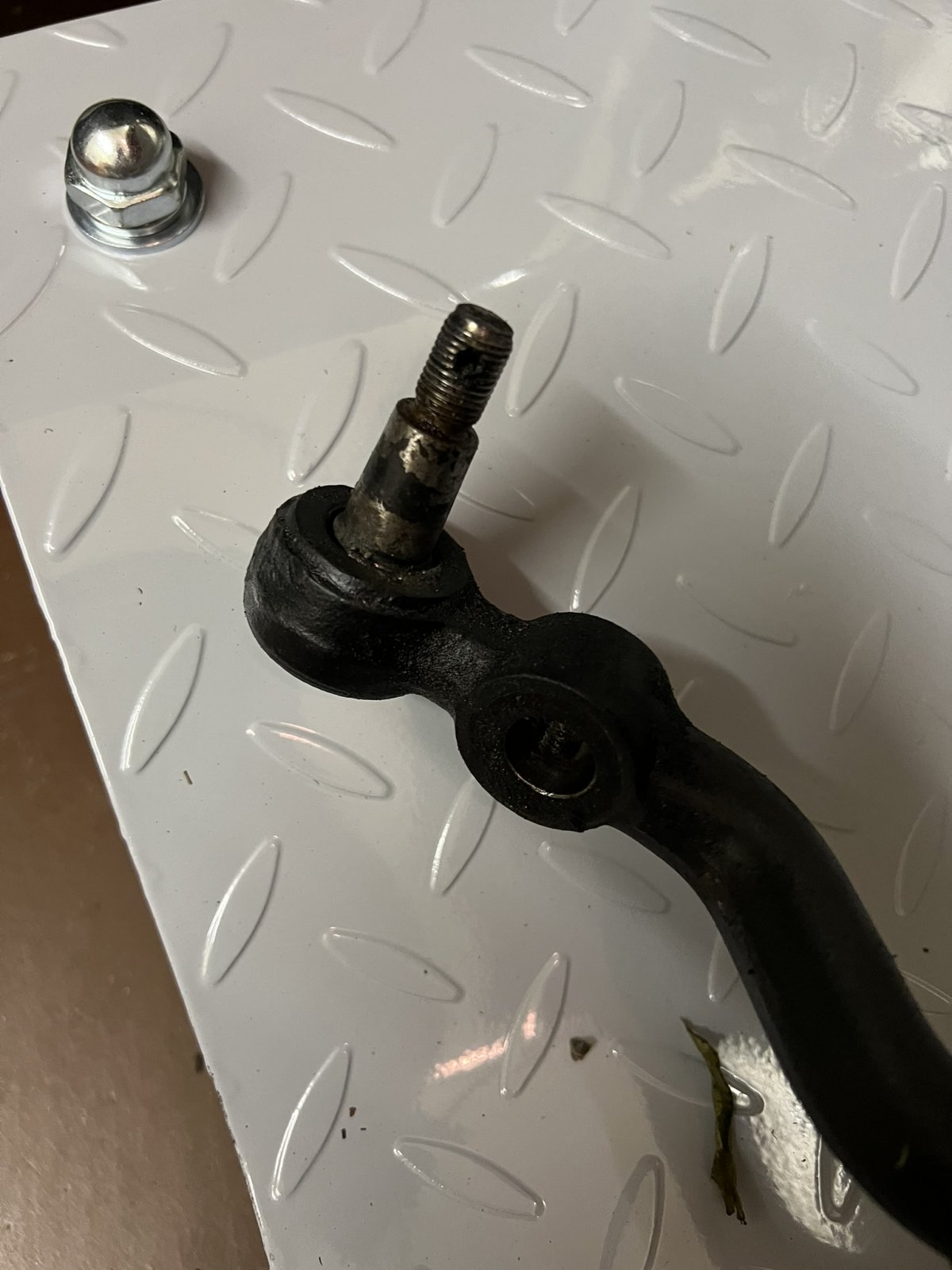

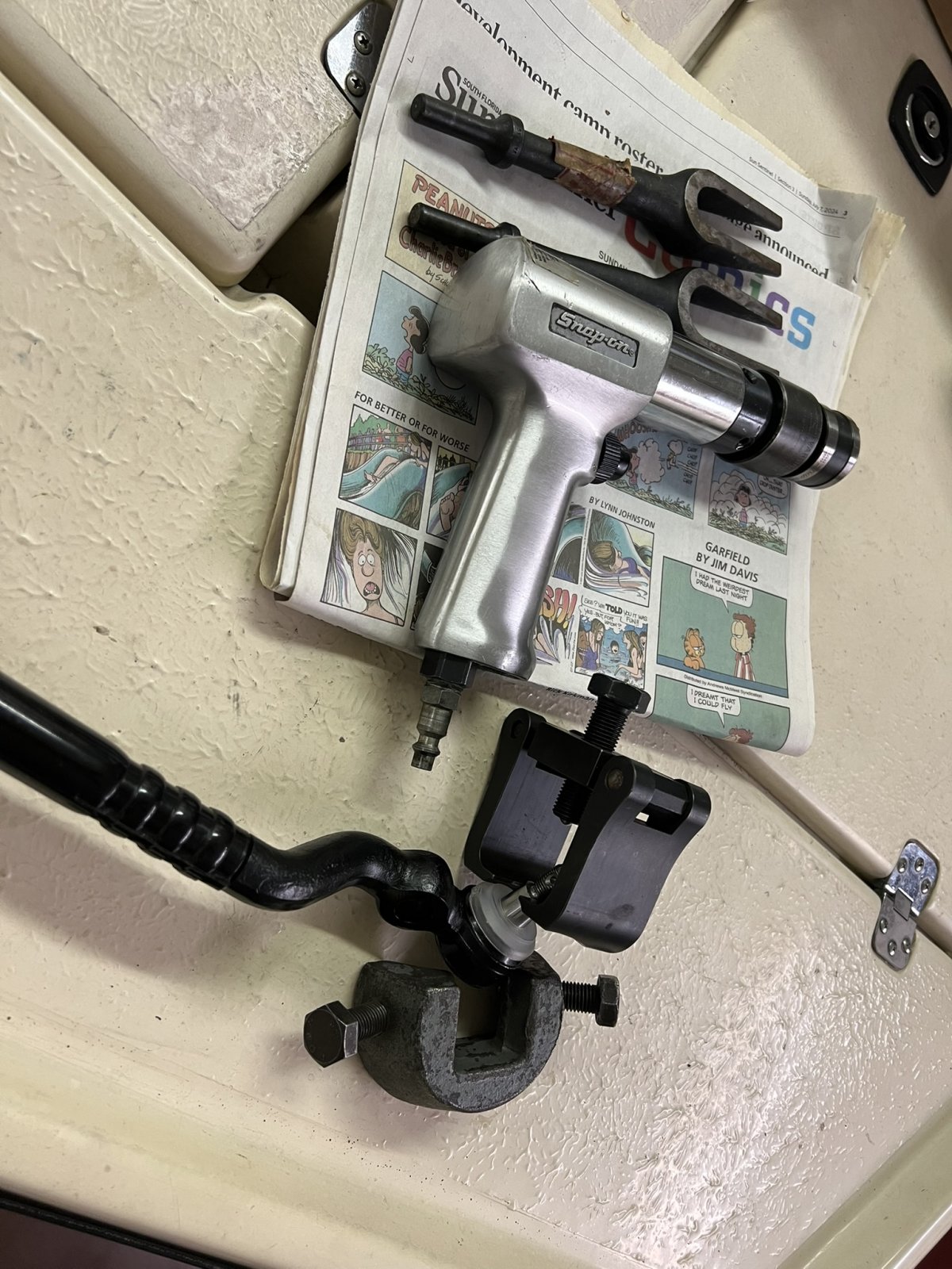

The W&N order was for the center tie rod (AKA drag link),flex disc( AKA Guibo), and center support bearing. The left vertical part of the tie rod was loose and caused a clunking feel and sound when the steering wheel was turned to the right at driveway speed. I was ready to use a pickle fork to separate the center from the end links. Then I found out that method would probably damage the rubber covers on the end links. But my mechanic,David Masi, said he has the BMW tools to do the job w/o end link damage. The pics show the puller-type tools. They worked! Steering links completed w/o use of the forks.

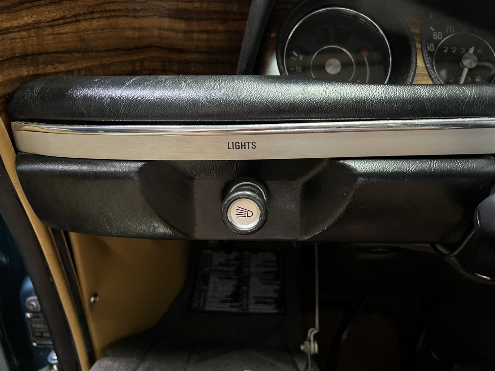

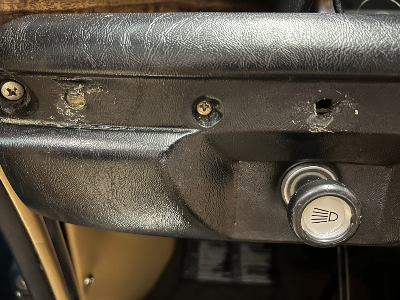

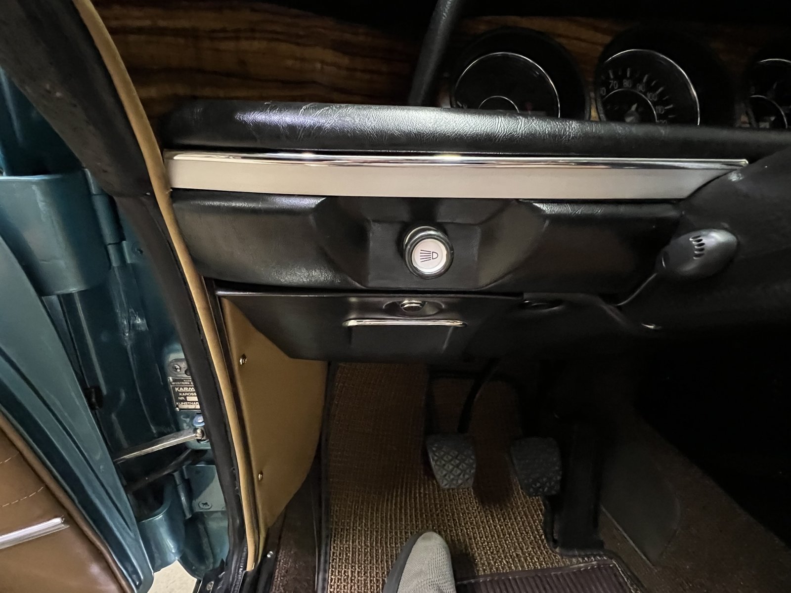

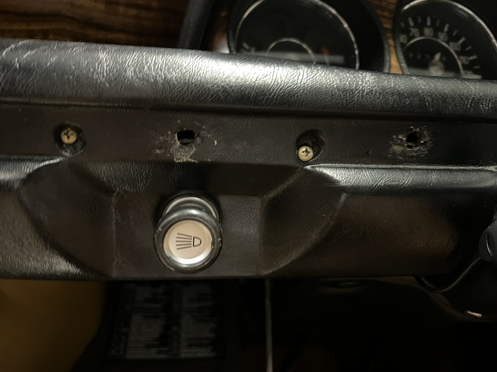

Dash trim replacement--My USA car has all of the knobs labeled in English words like "Lights" on the aluminum dash trim to the left of the steering wheel. I had already replaced the knobs on the center A/C console with the symbols that tell you "fan" and "cooler", and the light button symbol.
I guess the Germans knew their words for Light, fan, cooler, etc. were all about 27 letters long and wouldn't fit on the knobs anyway.....
Thanks to Tom and Tim, I was able to replace the dash trim with the blank euro piece.

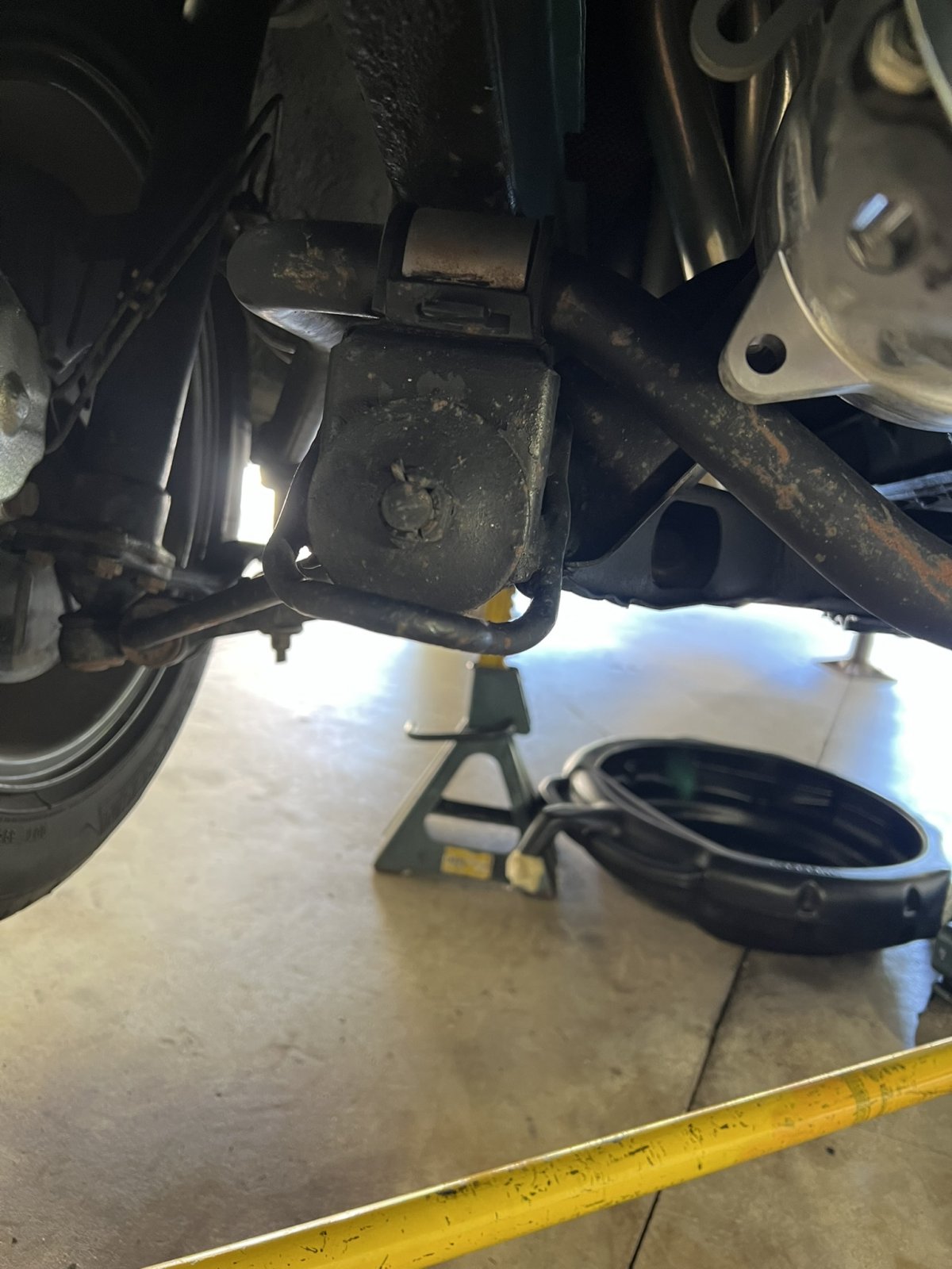

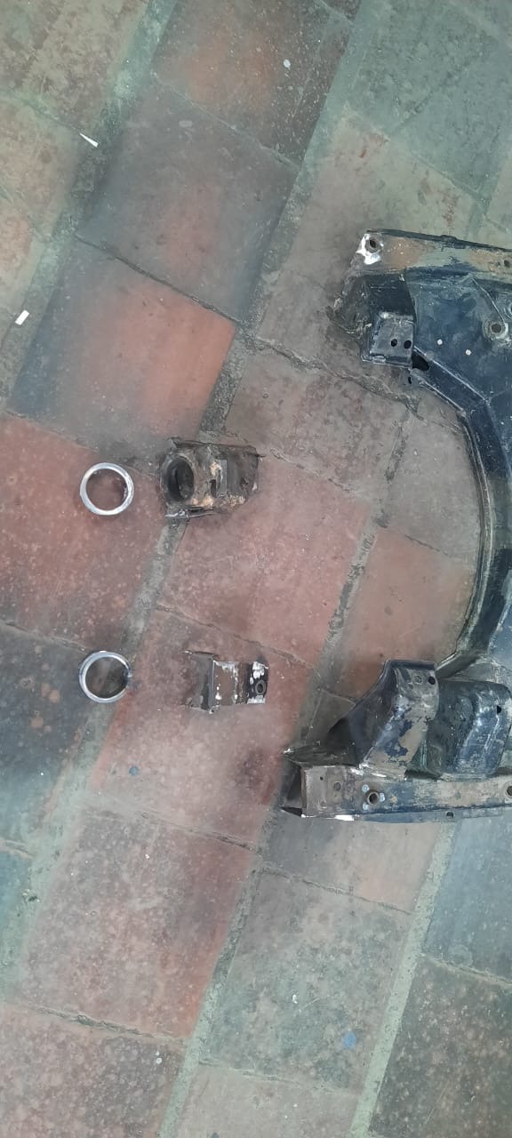

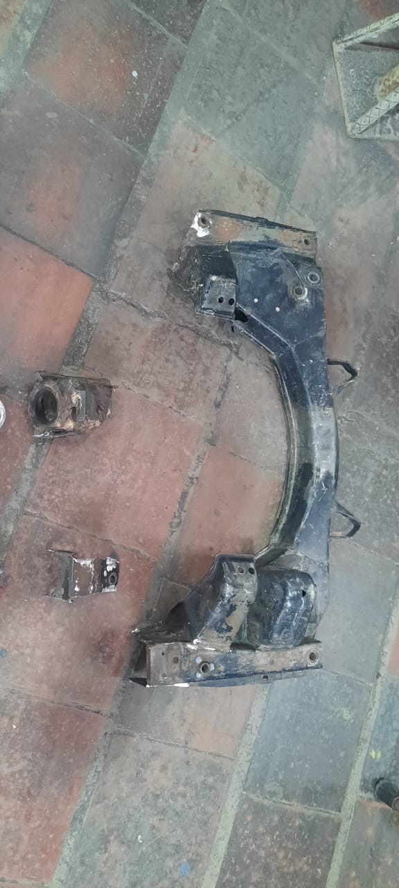

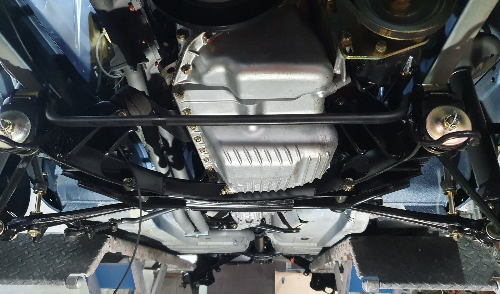

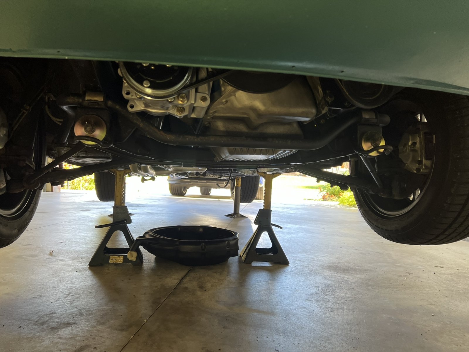

Starting to restore my front axle support
I need to join this club. Have a W&N order in the cart, can you let me know the part number?
Hey, a club I can be in too!!
No Lance--You are the founding member of the yellow washer/blue anti-swaybar club.... My 1.25" Suspension Techniques bar is just the common black,so I can't join you.But we both can root for the "Eggles" while eating a real cheesesteak not from Pat's or Gino's. I grew up near Chester (Folcroft) and went to Drexel....

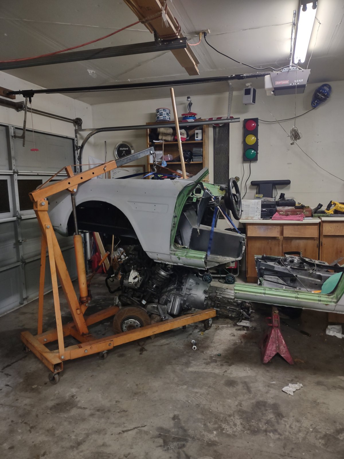

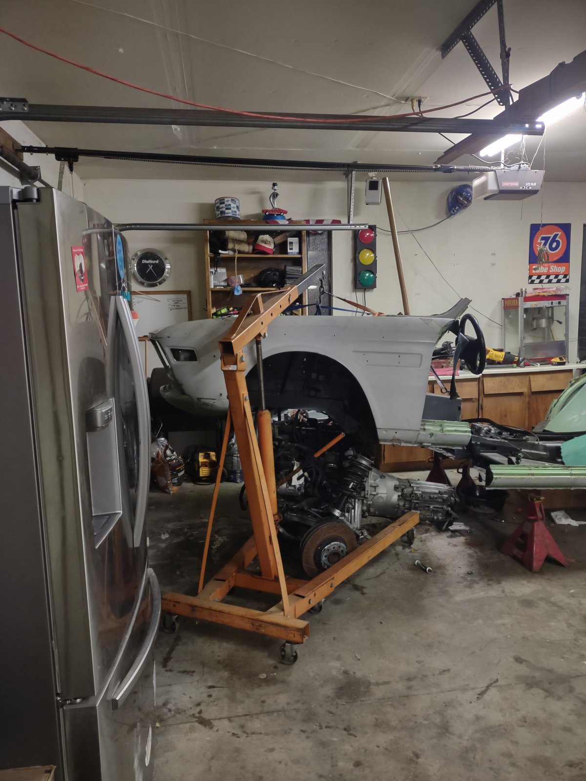

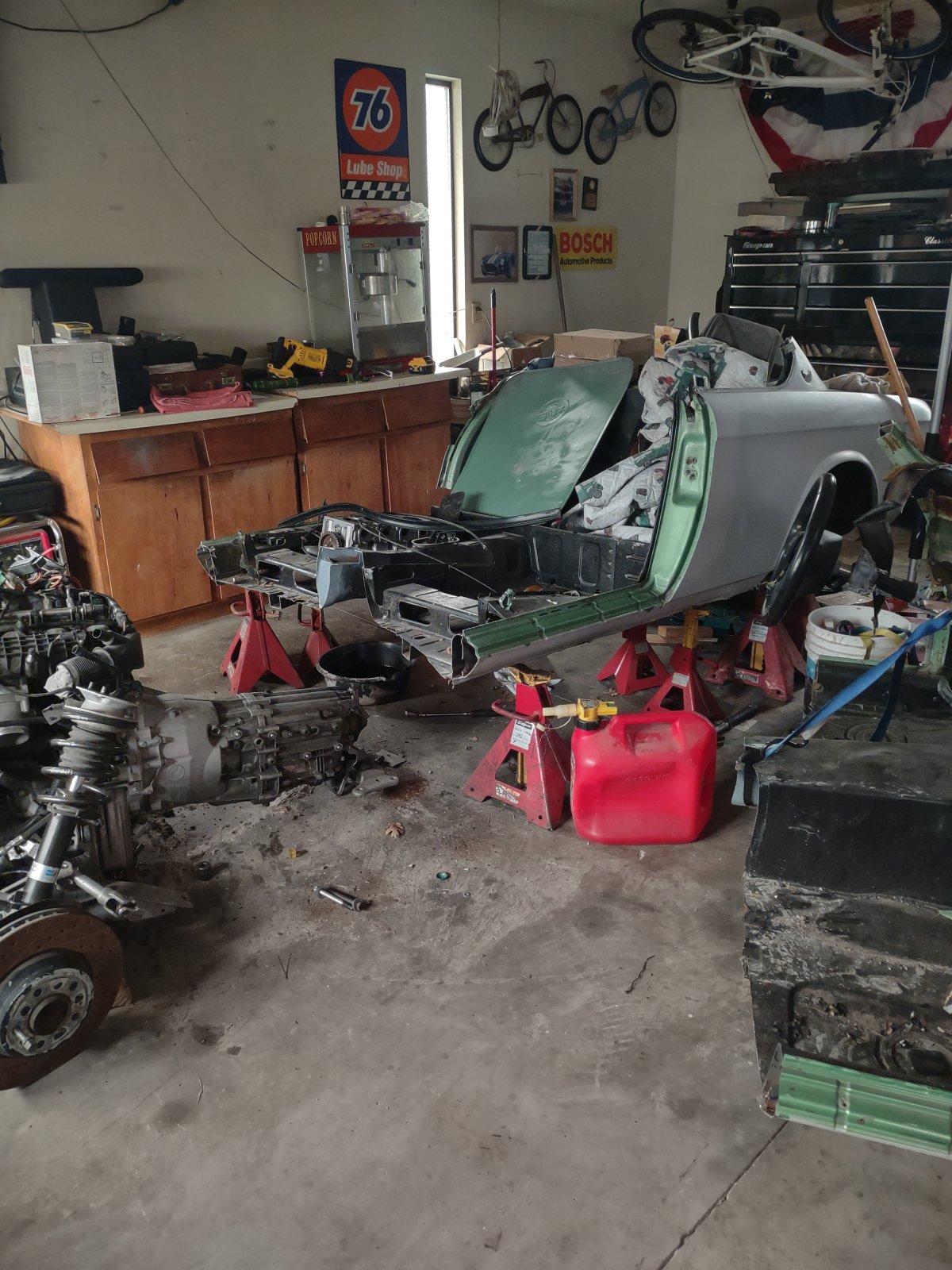

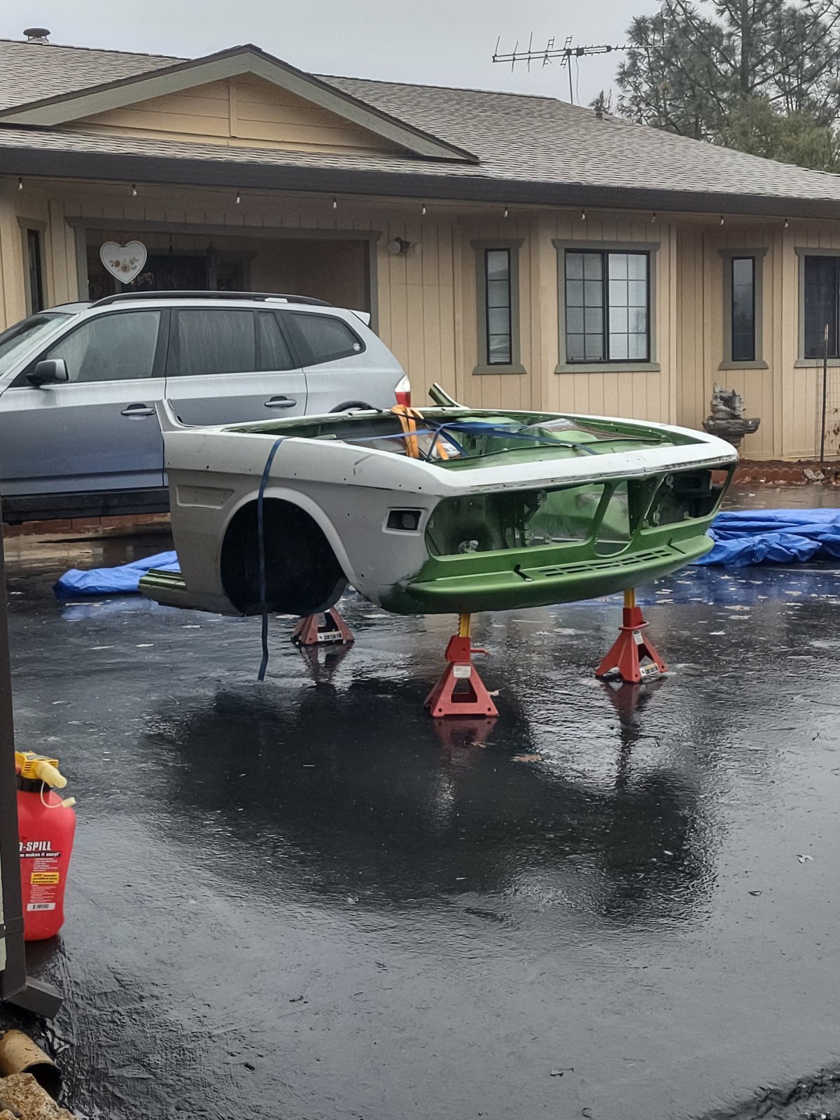

I cut the front clip off my 73 taiga csi parts car. It's going to a fellow forum member.
