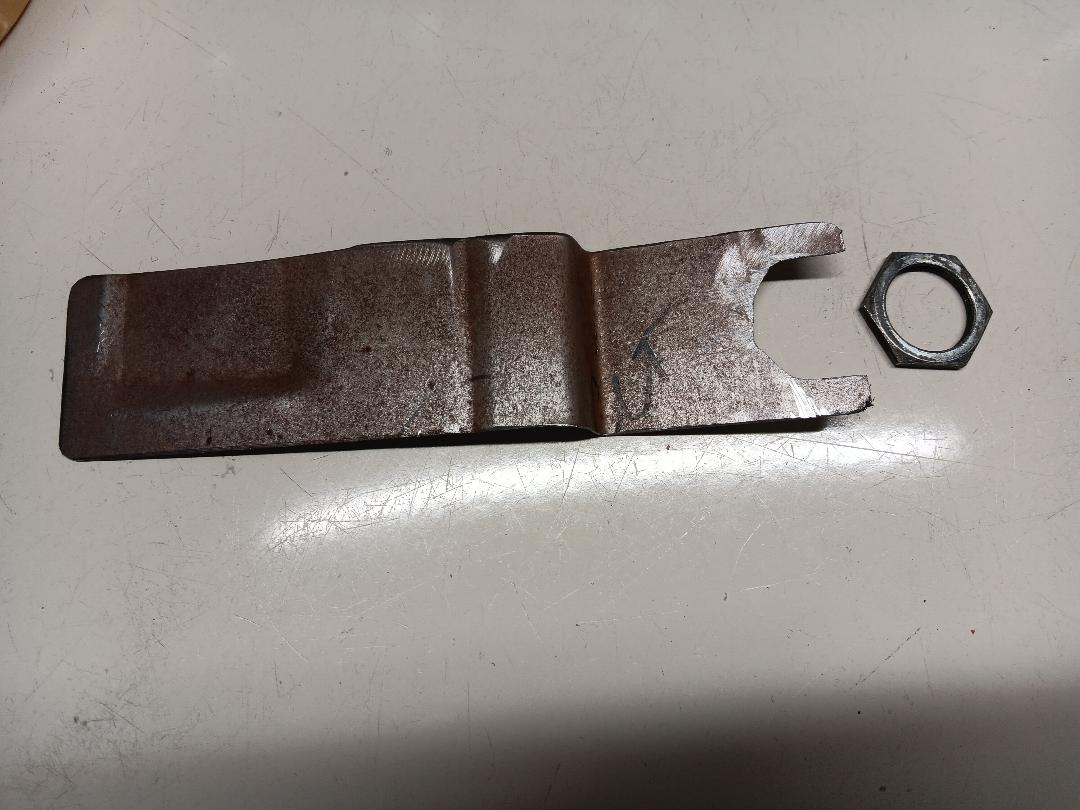

I am not sure if you need to remove some of the internal door components; I think in my build thread I documented last year that with flex fingers and a make-it-yourself tool: a 3 mm thick flat spanner for the ~24mm nut on the inside of the doorskin)
Erik,
I have the lock cylinder out of the car, but you're correct, it's a tight squeeze in there, so I had to make my own 24mm wrench from some left-over sheetmetal. The wrench worked well.
I was thinking of giving it a shot on my kitchen table, but I'm worried that I'll just make things worse. So, I've contacted the locksmith recommended by Mike and I'll see what they have to say first. If they can't fix it, then I'll give it a try myself.

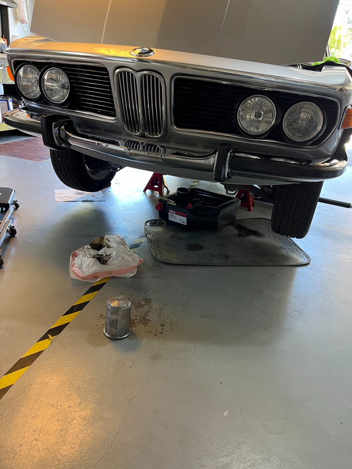

Noticed the coupe has lost a little break fluid, put it up on the lift and found one of the “new” seventeen thousand miles ago front brake calibers were leaking… change that out for a spare, and then notice that the driveshaft giubo was cracked…changed that as well.
Barney… did you replace the giubo with a like kind or did you have to change the bolts etc? facing this eventually.
Replaced with the exact same I had on the shelf, the bolts and giubo were new when we installed a five speed 18 months ago…I ordered one for the shelf from W&N…took about 3.5 hours to change out…

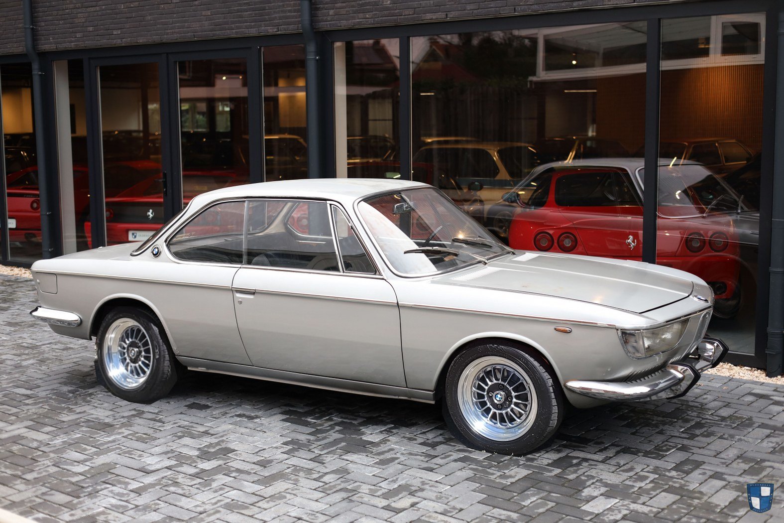

Just bought a 1967 2000CS. It's still in transit. I have some really cool 3 piece 15 inch Hardy& Beck wheels, that will go on the car. For now I photoshopped them on, and like it a lot.
I will report back once I have the car in possession.
Nice job on the photoshop! Those H&Bs are going to change the look of the car.
