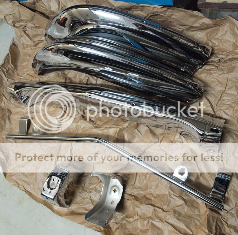

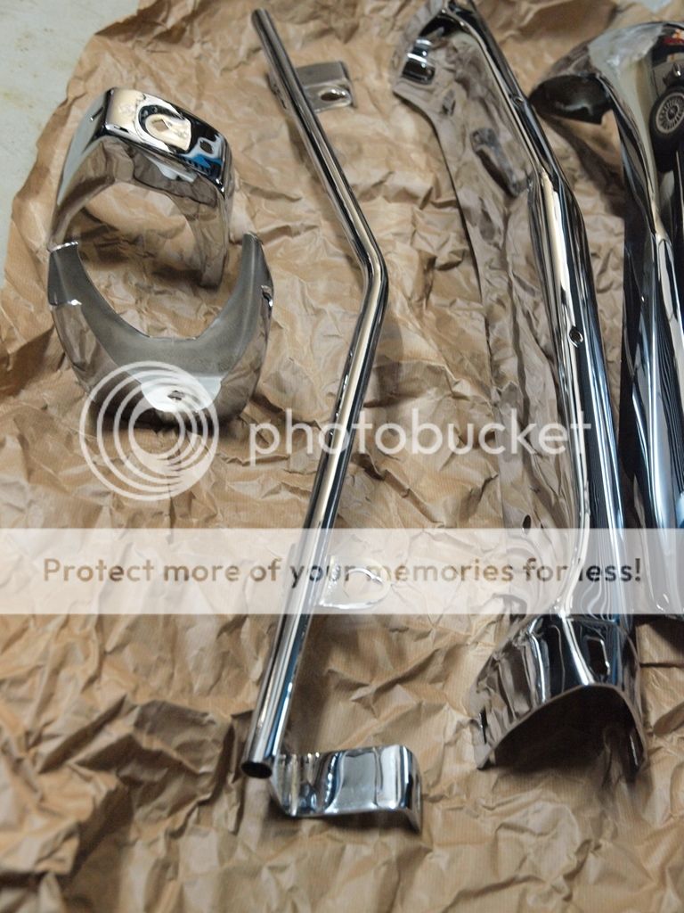

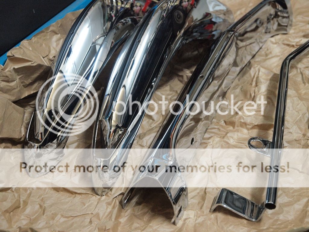

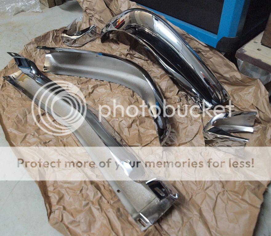

today I received the re-chromed front bumper parts,....
once out of the box I needed sunglasses
they repaired a loose support, and closed two imperfect holes and drilled new holes before chroming process
re-chroming process has been complete: back to bare Steel, copper, nickel, chrome flash
unlike original parts (that are painted) these were nickel applied in the inner face too
special thanks to J.
DeQ, even from the far side of the planet those look gorgeous. I wonder how the shop was able to nickel plate both sides, but only chrome the outside. Stunning work, whatever the secret.
