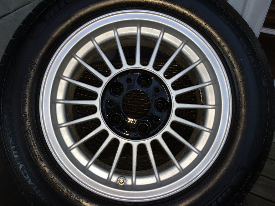

And of course, finished re-painting the wheels on the kitchen table ;)
BT_3_YEJWgw-r_i2ouMhheqs9MKGf5ad_gFAdBNJcdzcZpXMN2pP08ZOYlpmIivWIvb59pMsn7EV05ga-sfw2Ac0UlsZDROlihNfNqxXqpvTypuEotiSCY9eGJu1v65kkhcdsiHvAh-zz7GlXswjeqhJpUImUdNkXwYym5qW6xmFlqg5LDx0opxwK4tiQFH0AQ1EFzl4-45iacUBmAUM6PXi66usZk231Iku3GSXIdW6YuIfaMHFsZY4-anniCexnq41li5HRjnyxBk-3u2UTo2JJLgANX4Yp53s84cSx7rs1pG97mSI2PGx5nH3uCp8KwRh5KZl9CslJhK8RMWkjkzSwaLZoqe5ns-V6UEKnV-4L9elWdxOVKioJ2EvxDmB4jn-hDxz7IAAagkZL0--8nmjn6KQmGvaLrk-2Dy3WekVBqEg5Xo4d98KpYQtSJ1-TfFY34tXSWo-FYEcuVUhyZYmU9yDPgdCSJWGbjjizls5ByCoWg8v4SnO6OyFYMSIyZkAio08cNZUIGrEe4L8pgKk0Vwa31PSCp0g4ycaE0GI_SqOLJPKJGtVaWHgkyanBkWq=w879-h659-no
mlsD1v77BFzAQ10n62KBfHJq_ojRqIDc-Hs3xGvpp9Y_wgf-6Ak6nv8pDzOoliqeuACjWS92layPQkvCQYSGqoNjJAWPBEsYENTKXq1yHsCisFNXZkGXAJozwtRNm9y096aP64xJ-vvh93A8i7WrZVsWWAbQRxYmnbxJsIohUyXRFHZNwoJdNYfYWqQWA5_DVQDy9rBl880HACQs7KQ8Xmf1Etaw6s5PNGxQNiMwnw6GGv57UjDn7PCz0may1qpIm4AlUdI7peTXULopQ5kWtX3kcm59xLA02gzoff3bOfbYph9x-OSaNrllnO0aR0cMRjg1FJes3rb00FQKH-1tCJqrYU4ci7xvS5uxsJQvdzquVQv3CFlkcNt1CGb_RydkfbYe9LVFrU_1C-RfewUbcrpl-dr8bWnMAzAUt0Tlm7qHxDqJtwgtQuJNnZXVGoXZOAwZJbPRlce0YitdmQBGMYtpgx2sM-0ABNYFgKDI88x2rEmfLD_ppwfIBoVNb5CYvVlFAzYmGKzB4uTTmBlYYcEFw7rPMI8yTFrxkWWDSpQnyHaDk9OJfQZeCRIbLtw2arBR=w879-h659-no
Wurth silver and clear, Rustoleum black satin for the centers which goes on and looks great but requires patience to work with, you need to either clear coat within an hour or wait longer than the 48 hours they suggest. If not it will wrinkle. I painted centers first after masking off the spokes. Then I cut pieces to fit the centers and masked them and tires then did the spokes. Took all week. Also filled dings with JB Weld. A repaint like this needs 2 cans of silver and clear for 4 wheels. Double that if starting from scratch.
The Wurth stuff goes on great, a nice fine mist and no runs. I have a lazy susan and a box fan in the basement window to draw the fumes to outside and dry ac air in from upstairs. The old ping pong table that nobody uses anymore-makes the perfect paint bench :smile:
Steve,
those wheels look great, so what type of paint did you use?
