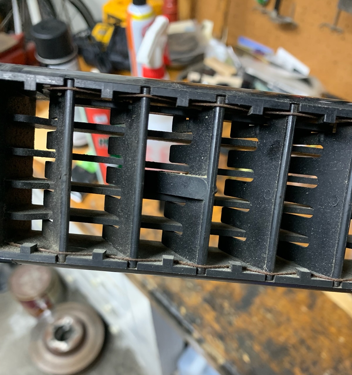

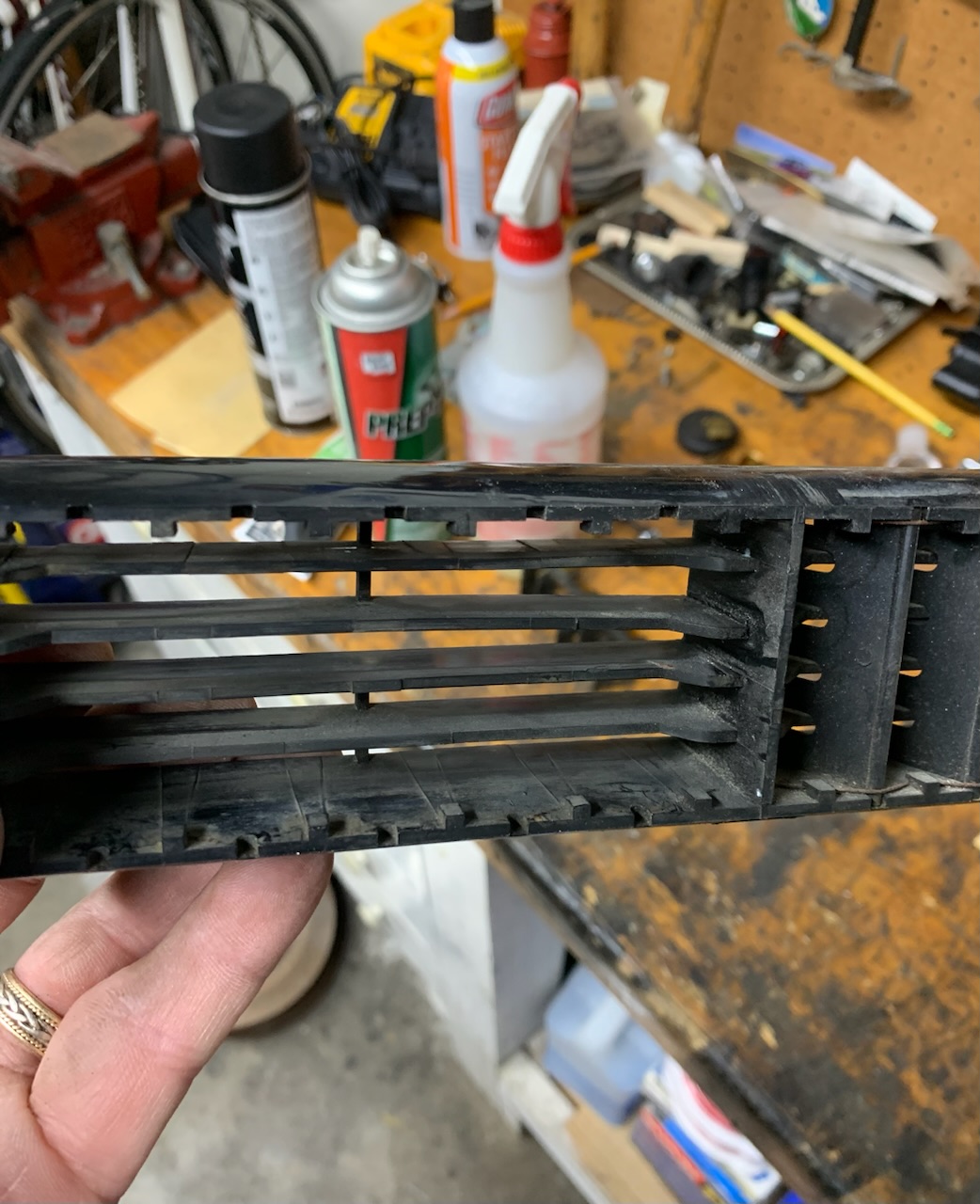

It is the simple things that sometimes take the most time. No way I was going to skimp on this and just clean it in place.

Chris - is that a repaint or just a really good cleaning? And if a repaint, what paint did you use?
HB Chris
19,418
8,759
Huntington Beach, CA

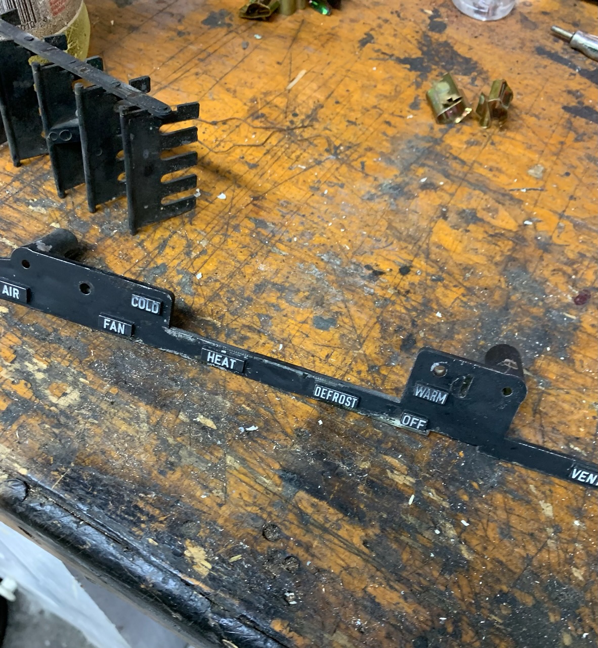

I always use SEM Satin Ultra Black, I did not paint the blinds I just disassembled and scrubbed, I did paint just inside that is visible and face of the grille (top and bottom of movable housing are rounded and might scratch) plus the faceplate. My 73 has the illuminated controls which are removed from the backside.
