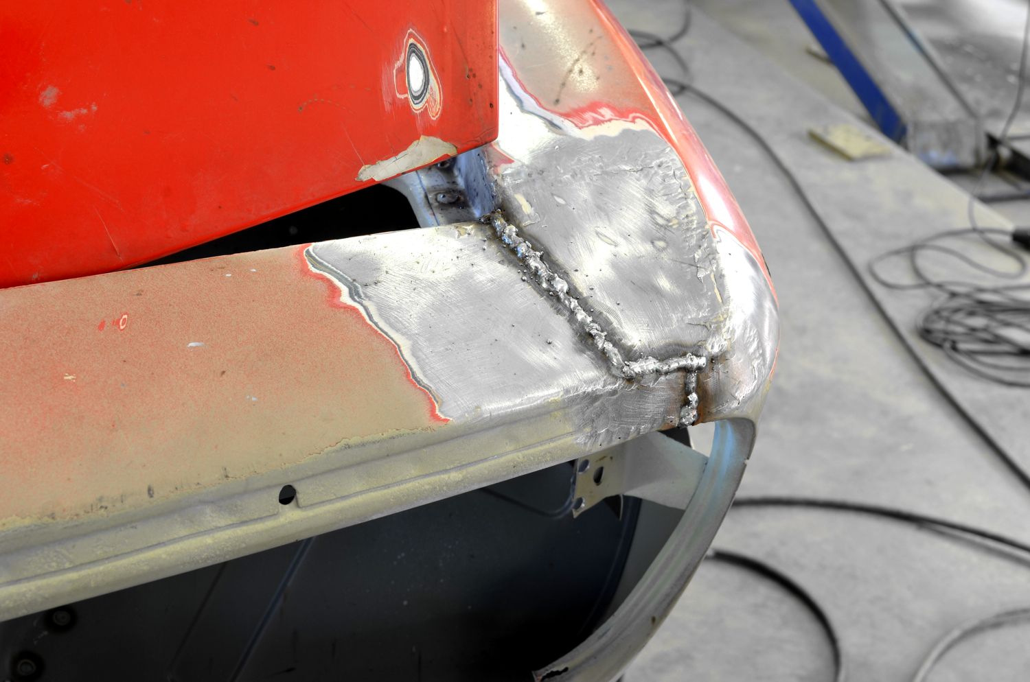

Now the car has been sand blasted, fixed in many points and then primed (I'll post some photos tomorrow).
There is something that I don't understand: sand blasted cars have a kind of step on the front edge, where front fenders link with the upper nose. However, I can't spot it on finished cars. Should it be molded with metal?
Some more rust...
BTW, I've seen some CSi with the black kidneys and some other in bare aluminium: did they changed color in some year? What's the correct color for 1973?

front nose/ fender detail
Hi FGS
like Chris mentioned, indeed fill the gaps.
This pic is from an E9 body that was on display during the 2012 Essen Motor show on the BMW stand itself.
sorry for the cellphone pics. If i had known then how often I would look at these pics as a reference for my own body work, i would have brought a proper camera....
Erik.
Hi FGS
Erik.
Thank you, actually that's quite clear even by the cell photos what you're talking about. The bodyman must do a very nice job as the car will be black.
