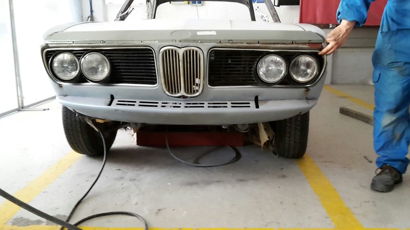

Welding time
That's some serious work!
One question; how do you manage that the relative position of the wings & strut mounting points don't change compared to the original position?
Do you use a jig prior to position the panels prior to tac welding?
Or do you use measurements?
Or do you just your your expert eye perhaps?
Thing is that, besides having an endless interest in learning how to do this, I suspect that my e9 body is also in need of this....
Erik.
Erik,
that work is actually being performed by my bodyman so I am not able to go deep in details but, what I have seen is that he first jigged all the panels in position, then he checked the gaps with the fenders, doors and bonnet then he began to make welding points.
I'm pretty sure that any E9 needs (more or less) this kind of work after 40 years. What I've seen though is that the body of these these cars are badly designed: you can't use 30 different metal sheets to build a front end.
The bodyman is doing a "dry assembly" of the front end: he's told me that actually the gaps between the bonnet and wings are 7mm. The same for the bonnet and the nose.
Are those correct?
Has anyone ever measured the gaps on the front end?

Front end almost finished. A lot of weldings!
