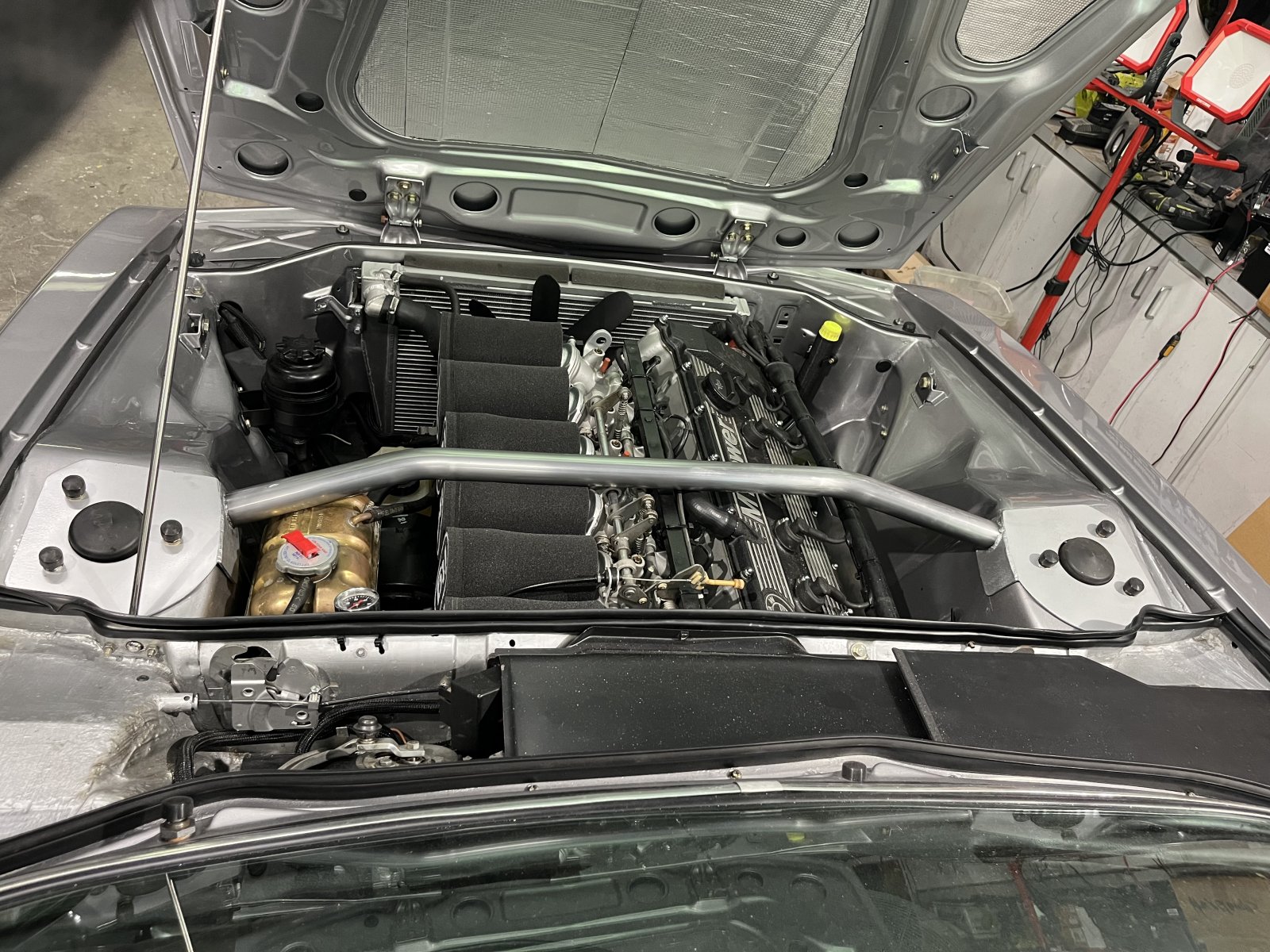

1974 3.0 CS With M88 Engine (3.5 CSM)

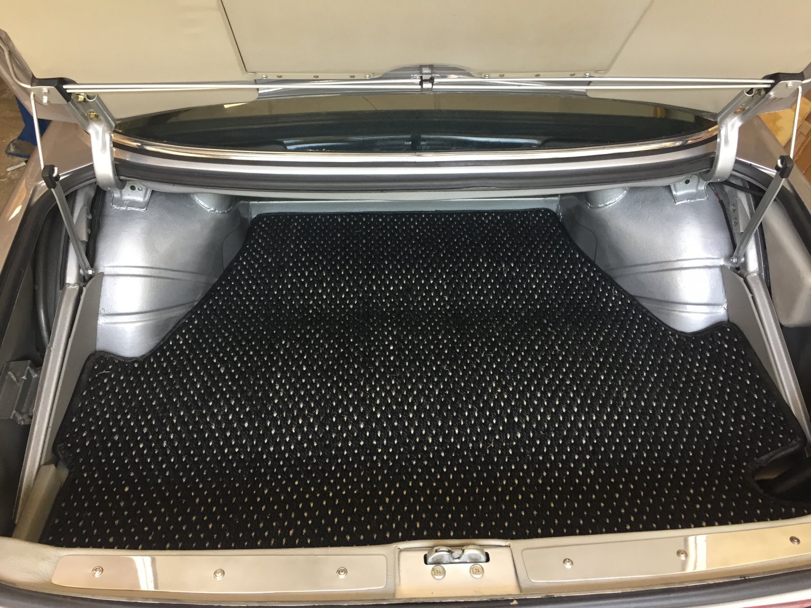

Coco mat to cover the factory panels.

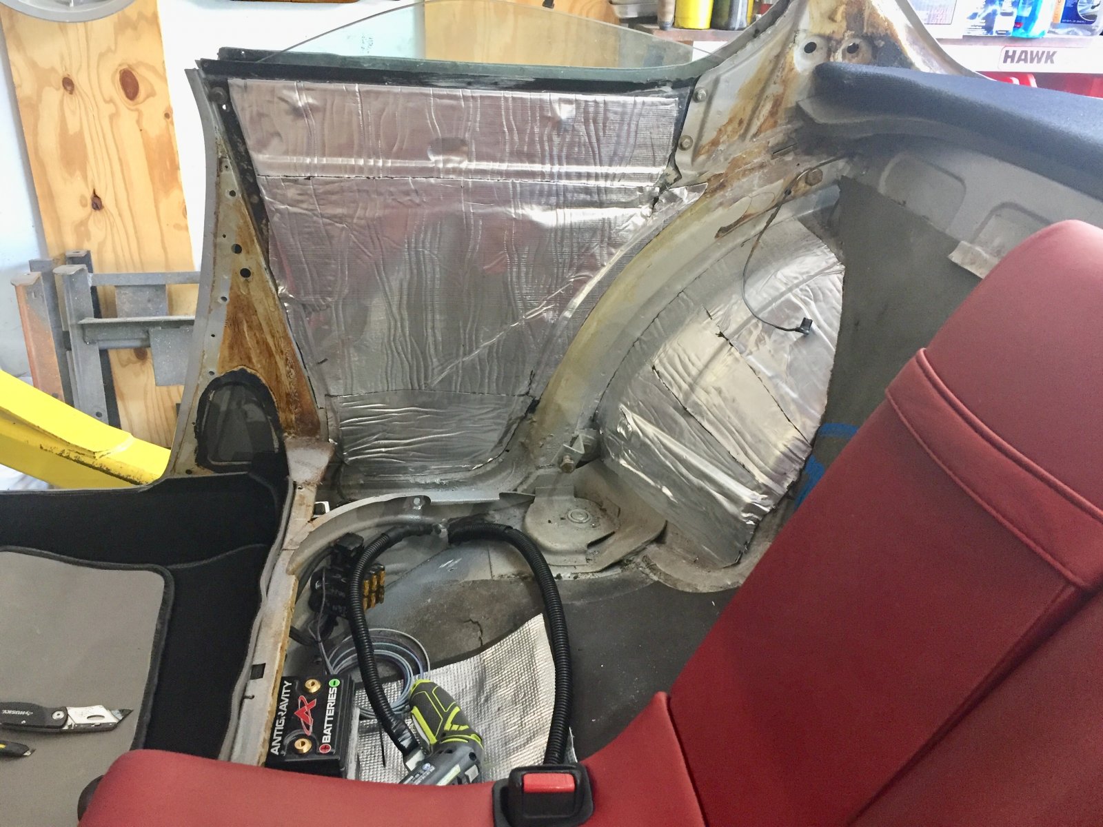

Forgot ’bout his one: sound deadening stuff and Antigravity battery under the rear seat.

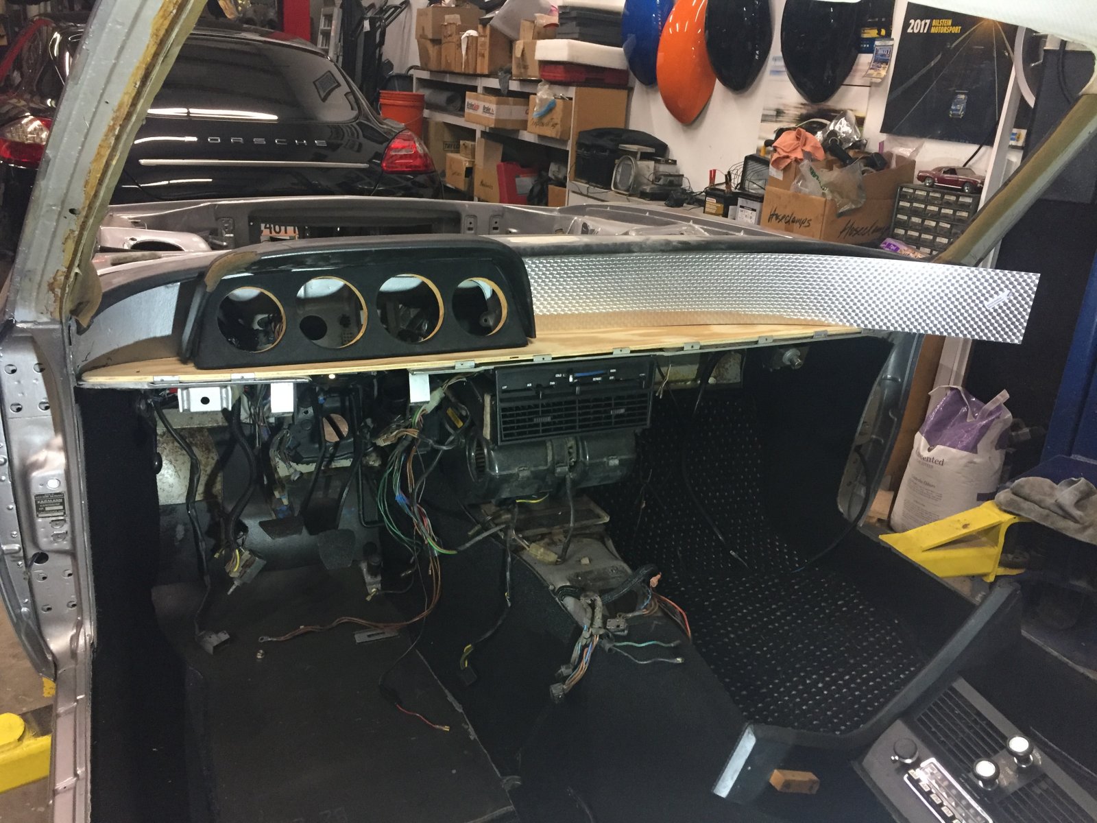

Engine-turned metal was used instead of the wood trim. It was so easy to form into place.

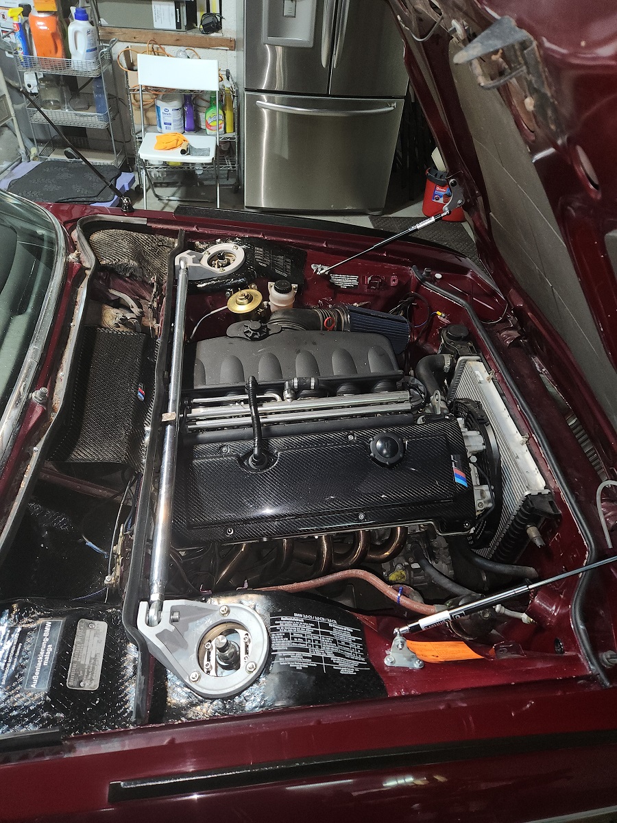

Thx, that is interesting, I did the same but was not able to put the original style radiator in. Is it correct that you have a slightly adjusted radiator compared with the original? The center core looks a bit thinner then original? Interesting to check whether the M88 is slightly smaller in length then the S38b36. It looks like you have comparable clearance between your firewall and engine like mine has, while I didn't had to modify the firewall.
Does the M88 have different options/locations to attach the engine brackets in terms of the screw holes on the engine? I thought that the M30/M88/S38 are all almost equal to eachother regarding this what I read?

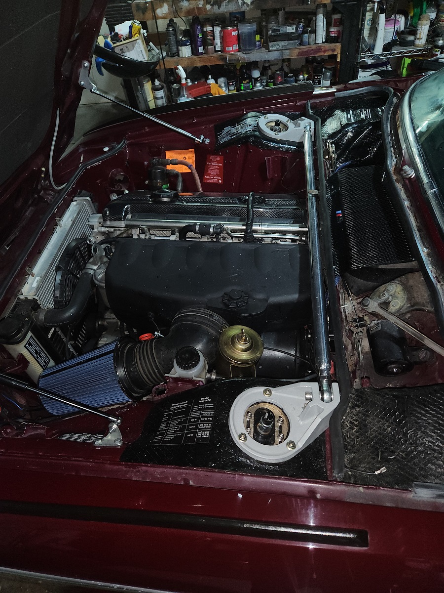

Hello, have you seen my E9 with M3 engine? there is the picture.

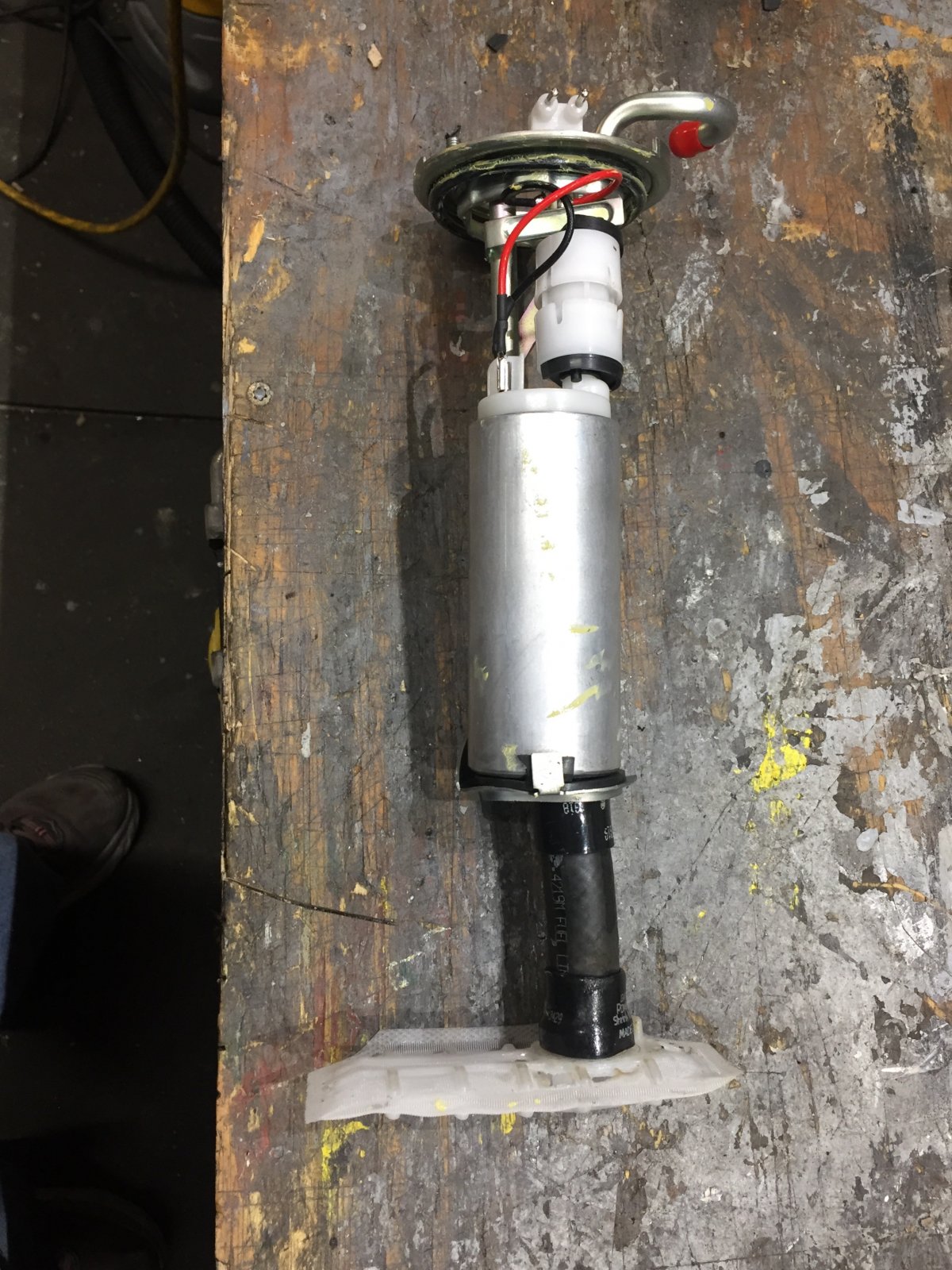

No problems with E30 electric fuel pump

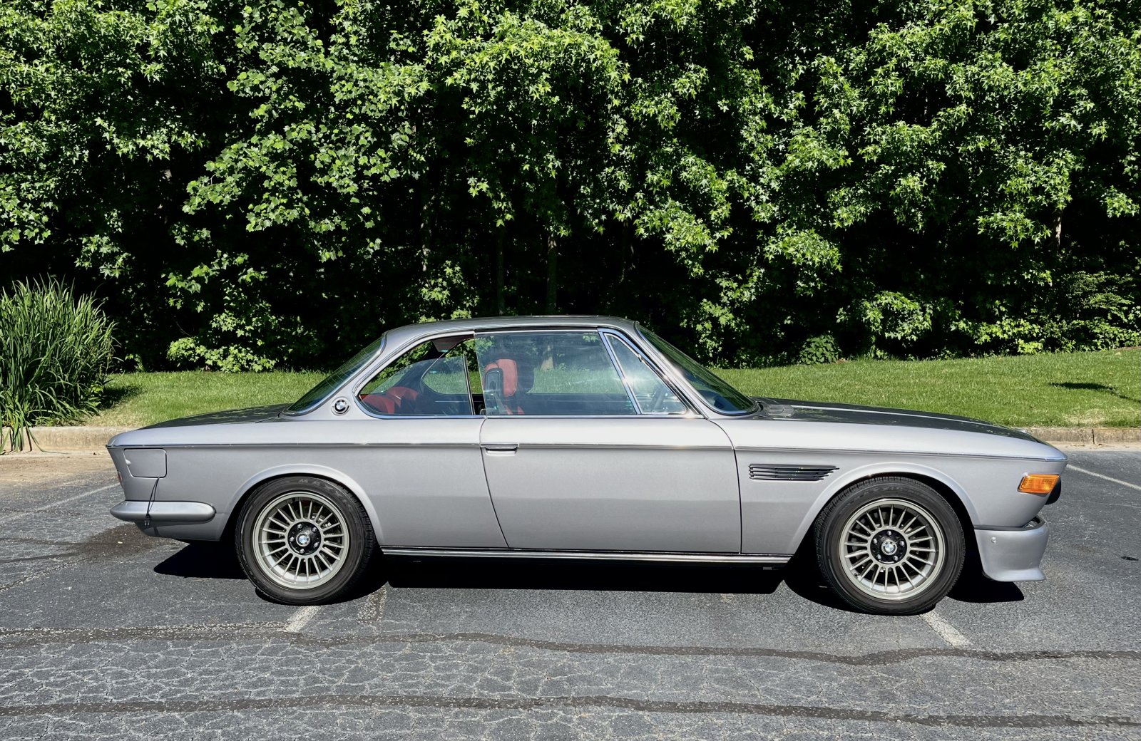

Pushed the car outside to take a photograph.
I should’ve rolled the rear window up and hidden the battery charger cable.
