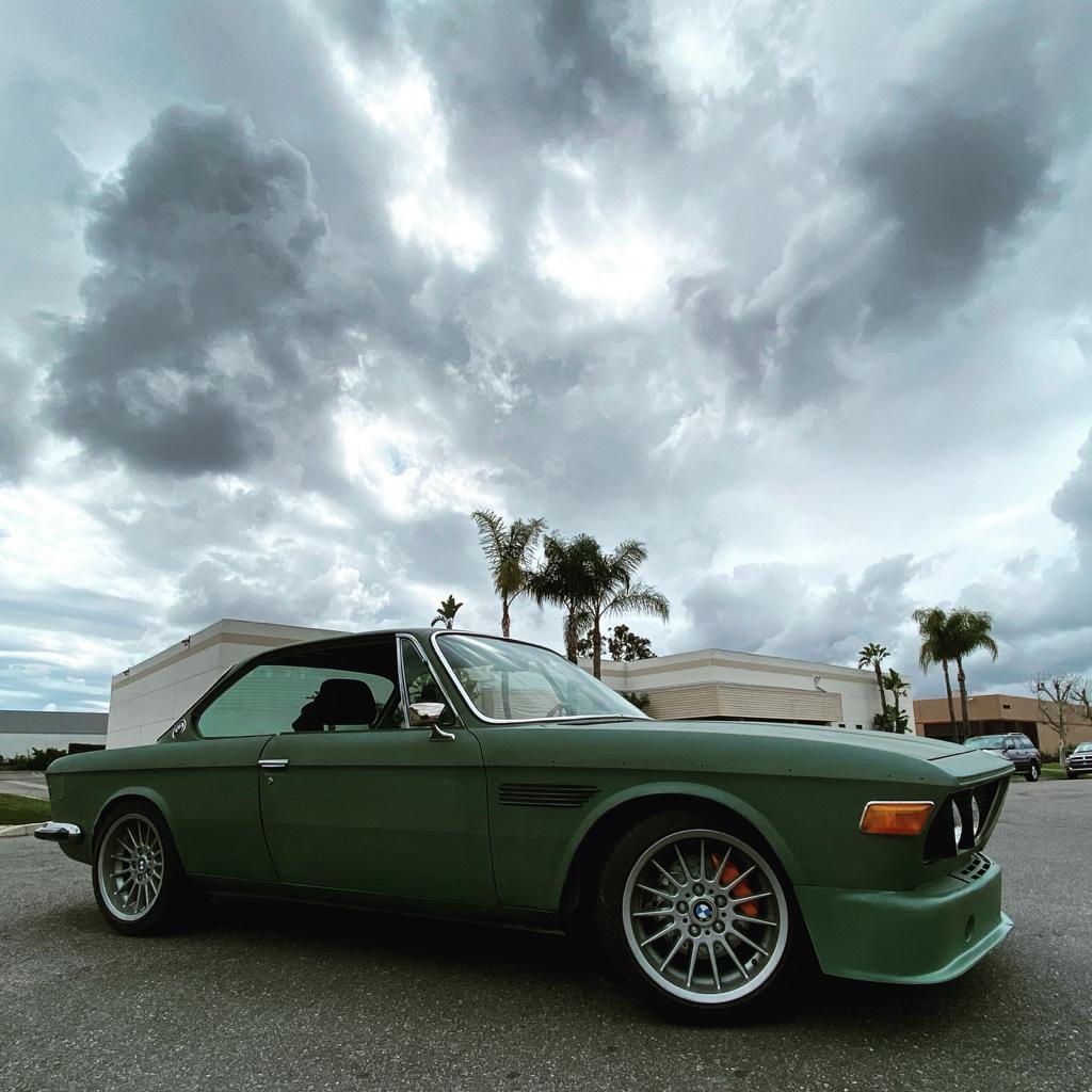

Another fun session with the Tesla-powered Coupe today! Got the air dam on (which came with a free crack on the front which opened up as soon as it was screwed on). We temporarily fixed it and will have to do a proper repair when the car goes to paint.
She’s looking better and better every day!
We took her on our furthest run yet and got into some twisty turns at speed. The steering and the front weight felt good, But I’m looking for much more testing there. I’ll take her to a track to discover the limits. She’s a daily driver but I do want to know exactly where I stand with her after all the modifications. That’s what I did with my first 911 so that I could find out exactly when I should expect to be going backwards:)
It’s pretty intoxicating behind the wheel, that’s for sure.

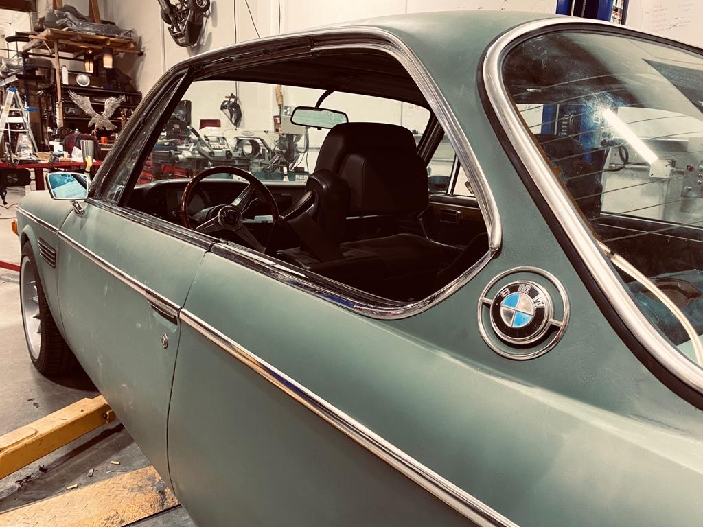

Amid the world ending, I’ve been able to make some nice progress on the coupe. Even though we are only prepping it for a couple months of testing and refine the Tesla, steering and brake modifications (then take her back apart to paint) we couldn’t help ourselves but to put the complete trim on the exterior. Most of the trim was in rough shape (surprise) but we got it all on. Really glad we did too because we kept discovering body issues along the way that we worked out.
It sure is nice to see her looking good- and it’s fun that there isn’t a drop of bondo on this car right now. Just clean straight metal.
Been driving her a bit more too and she sure is a pleasure.

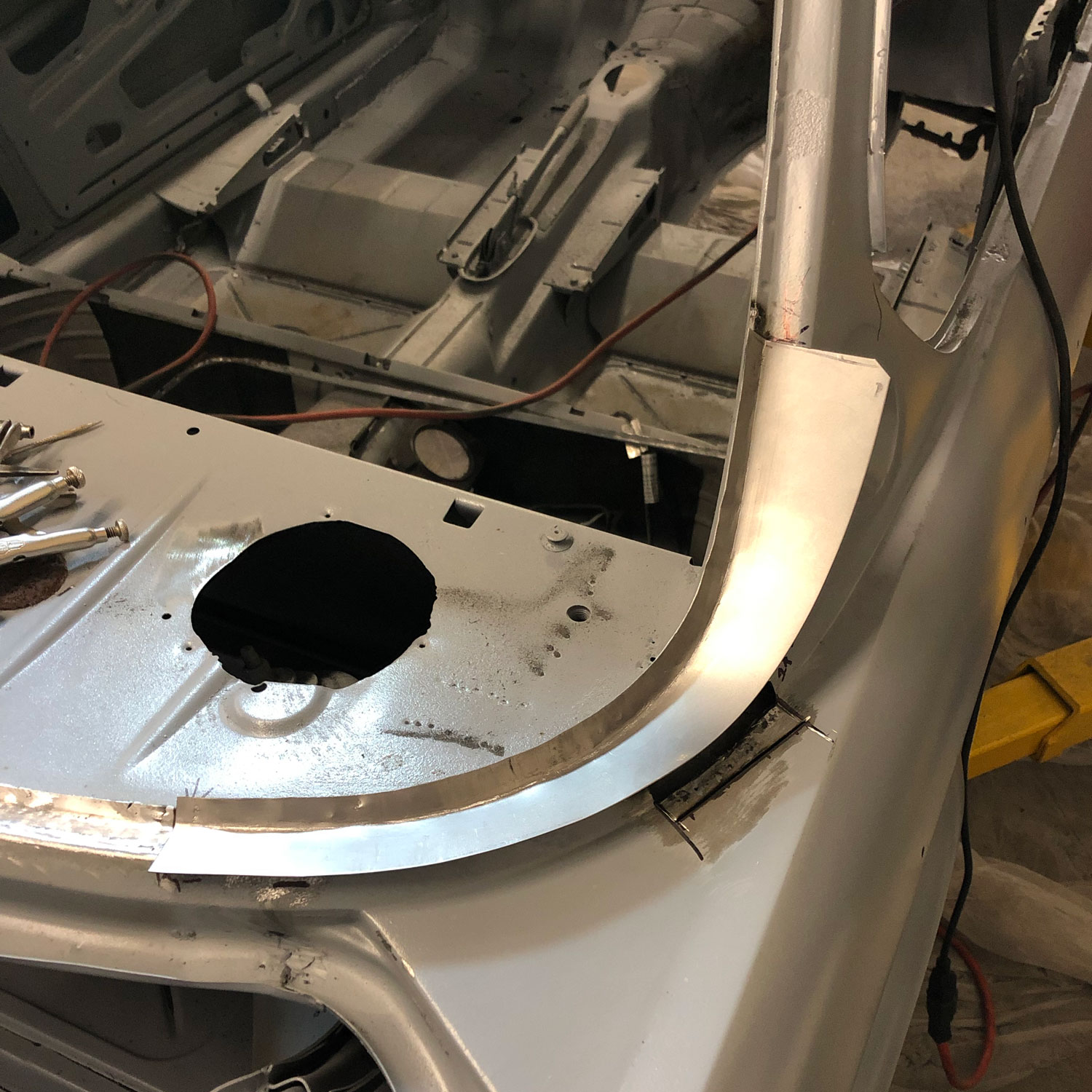

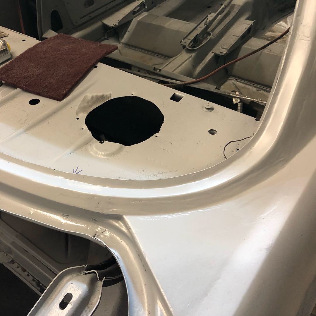

what tools did you do to achieve these curves? I'm not much of a metal worker but am preparing for this stage soon.
Yeah that was my buddy Tyler’s brilliance. It was a combination of a Rotary machine, stretcher/shrinker, and hammer and dolly work. I’ll look for some photos of that work. The tools are inexpensive but using them is another matter, so I stayed out of it personally :)

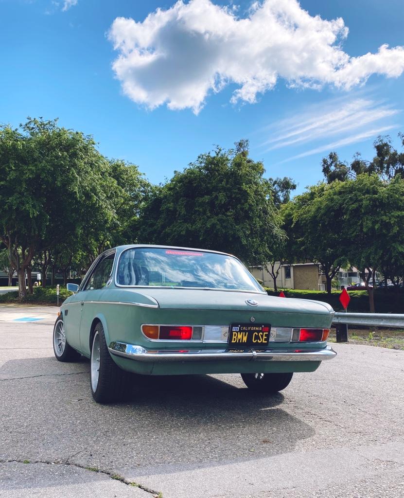

Had a terrific pleasure cruise in the sun yesterday. Now that’s she’s fully licensed and insured I am venturing into traffic situations (and yes. California still has plenty of traffic even during the crisis. Lucky for me I was self-isolating inside the coupe).
All of the outside trim is now in place along with brakes and turn signals. I put in a 3rd brake light in so I could tell my wife that the car has modern safety features. I do appreciate my modern seats and seatbelts. They aren’t harnesses but I do feel very confident in them.
The biggest addition is the new bumper. Like everything else that came on this car my original bumper was beyond bringing back. When they federalized the car in 1993 they had a four-year-old weld the steel section and center mount support in place. Gobs of weld were everywhere. But even aside from that the bumper would’ve cost a year of college tuition to have straightened and re-chromed.
Lucky for me there’s a guy who bought an early bumper then straightened and re-chromed it to put it on his 2002. When he then found that it won’t fit his 2002 he sold it to me :-)

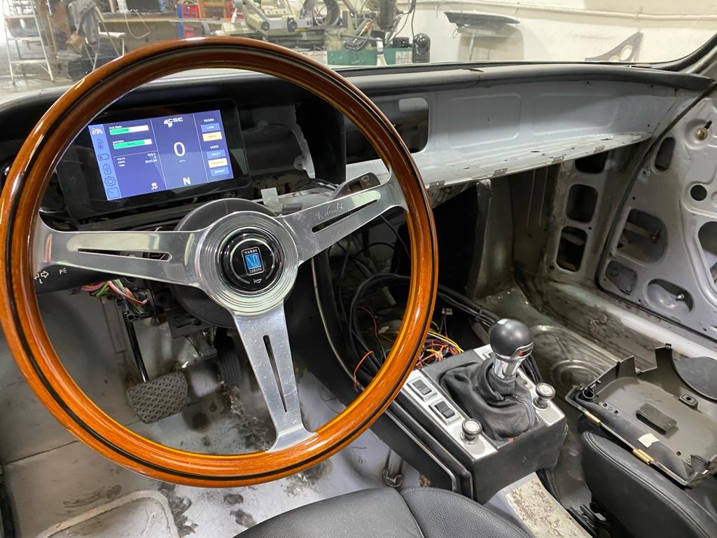

Last week I got some work done on the digital display that we will be fitting into the old Tach position. I want to leave the vintage look of the wood instrument cluster, and I intend to use the speedo, temp (for hottest temp of battery or drive unit) fuel gauge (for battery life) and clock. But the RPMs is the only thing that has no value to us. So I am fitting a display into that position.
Jeff has been doing amazing work getting the Raspberry Pi to talk to the Tesla unit and show us this information (as you've seen in previous posts while we drive the car). But that rectangular display was just temporary.
I learned the art of 3D printing and created some mounts for the unit and have her installed. I still have to install a video driver board behind the display- those are being printed as we speak.
