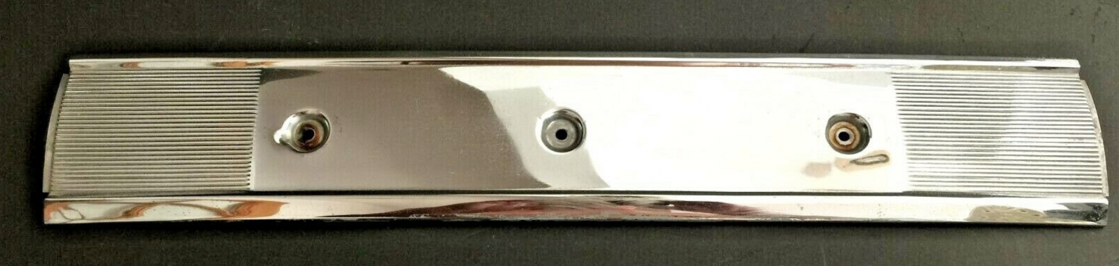

Well, I got the bug so I picked this up yesterday. It isn't perfect, but it's close enough to make the car look clean. Then perhaps eventually I will have it restored properly.
Now I have to make a license plate mounting adaptor and have it chromed so that the visible end bits look like they belong.
Thanks guys for the steering on this.
Paul
Paul
That's beautiful, congrats. I believe this chrome panel is the proper piece to connect the chrome tail lights - as the designers intended.
Paul
