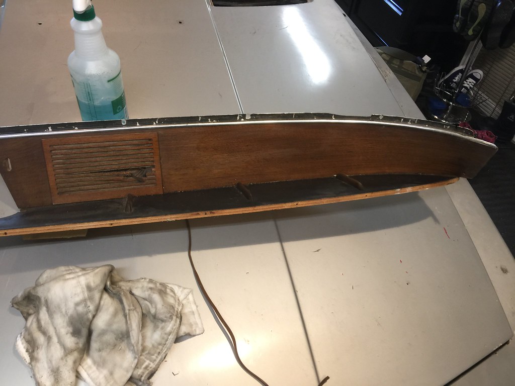

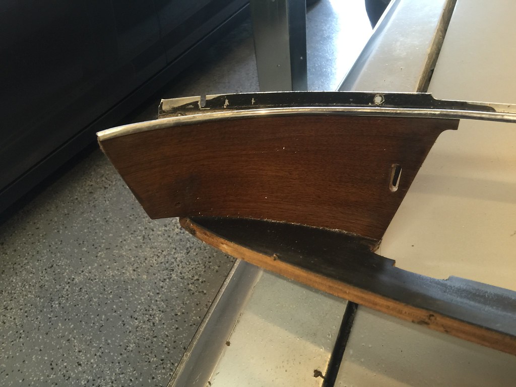

Spare Dash - This will go on Ebay with my now extra door wood. The dash is clean enough to run without refinishing, but the door wood will need to be redone.

I intend to auction - Spare Dashboard that I do not need. The driver's side piece is actually in better shape than my donor car. Needs cleaning though...

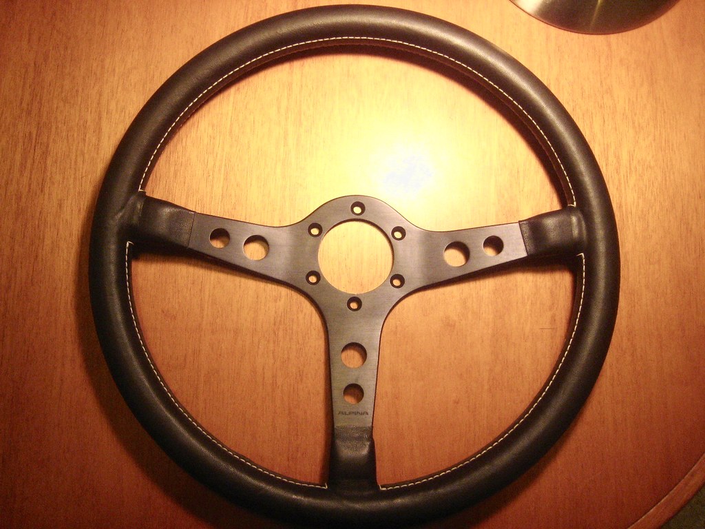

With that said - I picked up this 380mm CSL Alpina Wheel for $364 shipped. It was on Ebay with a buy it now of $350 and 20 people watching (anyone here?). The wheel has been recovered. It is thematically correct but the wheel spoke transitions aren't glued down like the original prototipo. Also the Momo stitching is nearly impossible to replicate, so I have learned. I've had a few long coversations with Chris, the steering wheel guy in TX that Bert recommended. He's willing to take a stab at it.

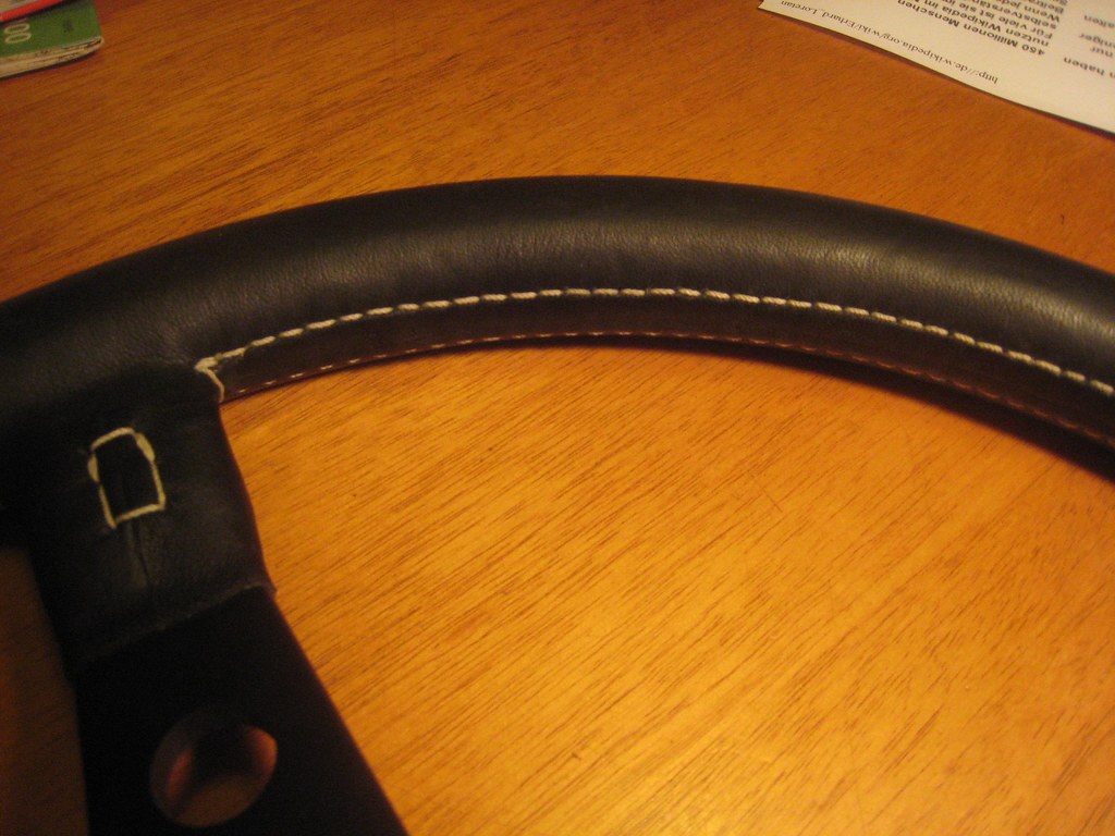

This wheel recovering used Alpina themed green and blue cross stitching. It looks good, but it's not right. Momo stitching never crosses the seam, and they use a lot of glue. The leather transitions on a prototipo wheel are very thin, and require a special machien to 'scave' the leather properly. In preparation for a future recovering, I have been in contact with Yannic and Srennoc, both of whom have had or have this wheel. Yannick on his late Inka B2S, and Srennoc is going to take a bunch of measurements from the wheel on his CSL. For now, I think I will keep it as-is, but dye the stitching black. Edit: I have dyed the stitching black and the wheel looks a million times better. The wheel is really starting to shape up!
The wheel came with a light coating of paint or dye on the spokes to cover the blemishes where the anodizing was scratched. I used WD-40 (my favorite) and a green scratchy pad to remove it and regain the patina, which I prefer. I don't know if it was shoe dye or what but it smelled like women's perfume.
The back side of the wheel is correct, with the Momo on the back, Made in Italy, and no date stamp. The lack of a date stamp places a Momo wheel in the early to mid 70's, much like my wood 350mm Momo indy. Other 380mm Momo Prototipos of the same era, like the "clay regazzoni" prototipo had the Momo logo on the front.

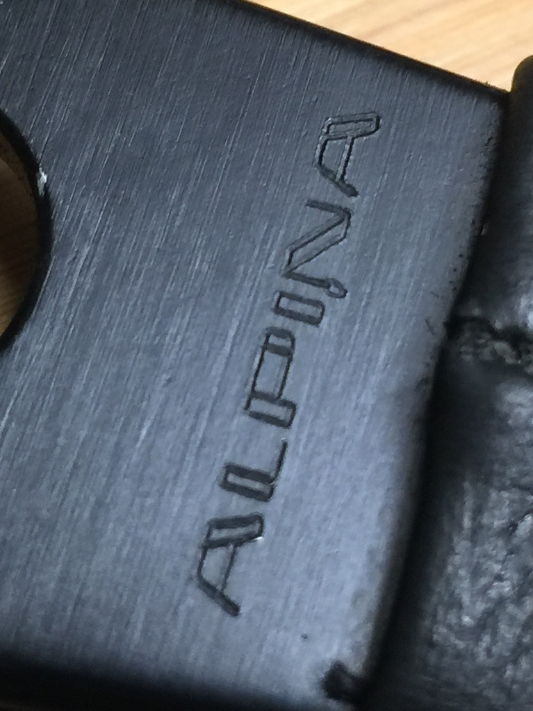

There is a small nick right below the letter N. I was talking to Hans (the steering wheel guy) about this wheel. He saw it and passed because the 'N' looked fishy". I feel confident that it is an original Alpina wheel. I'm going to get the logo measurements and offset from Srennoc to confirm. I'm not sure how the scratch got there, if it was a blemish at the factory or if it's just an unfortunately placed nick. The fact that the momo logo is on the backside and it is an original 380mm Prototipo, leaves me to believe that it is undoubtedly genuine. After finding this already rare Momo, someone would need to carefully engrave the Alpina logo in it. Then restore the wheel and sell it for $350. :D
Closeup...

Nice going on the horn button, it has the carb vs. the newer ITB. The stitch looks like the interlock stich, not the usual baseball stitch, same as on CSL petri's:
bRyDA9MnEv0hd1uMrrRZIRTkVsMK2w2_TX91HGlMQuoGVO4jooJcynC5kayCzw7bZrL9UPQYz-D5s9SEOQqv7Ay3yPC4cqswi8E6ultteEkLUQv0-CCFPjDrz0GVFxHHxJzDi40FUUeQZPygsogq1yxCNtsaR2weaF8XRqKP-789xS9ELVR9MkA2az6-QMKdTMeacgOkRx12oe_2OVXYXyhEWKUyCp-LA3bydzNA0Cxb9lxWGcBZDUwb4QdYAedfHYxQhUN8nB3CX-DOGeeRyJVbrHwG8omNmKZfWpVQ8emCc2rA1rFXjzrzmFImH864pmfVbDYH9Aoy-NiBFcWI4i7jAHPVkwa08WY7AEd201hpkQhMIZA0k0uBMS0wreb5JcADOIwthh0g6fRY_mj-97EdBGRnrzpwfVxTuuIBwwORUF2c1t1Myrh-tqIGpm6Gk68v9TWFfixXPz3I8TedDIuwNE0u1EkH48R1ZtbFk8feY98CRfQJpbL8N23L6-N29DQp8o6vVvWqQ2aEBl85NrJkQSObzVqjXTrsycd3nOAZP-8vVlC5M8uSLfT66bMNKclSeRI1FV-5sAcHpTTfRldwIdfdmzom-BHXWoEL_28xl-n5=w1028-h771-no
Ahh cool, I didn't notice that they switched from carbs to ITB's. :) The recover stitch is an interlock stitch, alternating green and blue. It looks good, well done. However, the original prototipo does not have an interlocking stitch. I've been told that it interlocks on the underside. After dying the stitch black, I may just hand stitch a decorative white stitch on top for looks.

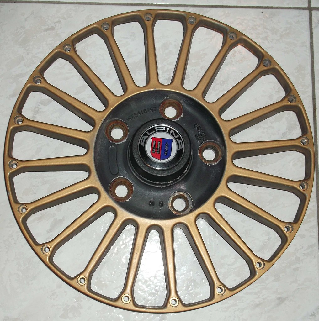

I mentioned in my post above that I sold my momo steering wheel and purchased 'parts'. Those parts consist of four WEDS bavaria faces. Now I got a great deal on the faces, but I will likely spend 4x to 8x the purchase price assembling the wheels. That doesn't include any polishing or refinishing. I'm talking about barrels and lips if I go with three piece (not looking too likely), or barrels if I stick with the factory two piece configuration. The WEDS wheels will not match up to 20 hole BBS Motorsport lips. The WEDS faces rest on the inner diameter of the wheel lip. BBS Motorsport lips are ~4.25 mm too big for the face to properly rest on the wheel.
I'm currently looking into two piece Enkei's as a source for barrels. That will keep me in the $400 range for barrels. If I go with three piece, I'm looking at $800 for lips plus who knows what for barrels.
Even before buying the WEDS faces I determined that the big BBS style fives weren't what I wanted on the coupe. I really love these wheels, but I bought them because I love the wheels not because I love them on an E9. I think I need to buy an e28!

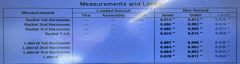

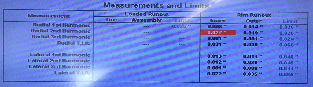

This is the runout for each wheel. All within tolerance. They show up red when outside limit.
Wheel #1
Wheel #2
Wheel #3
Wheel #4 - Bend Identified
Wheel #4 - Bend Fixed

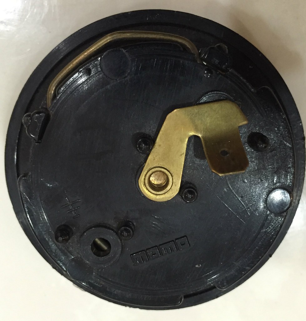

  • Momo Horn Ring (subsequently ruined by me attempting to drill Nardi Holes): $8
  • Momo Horn Ring (try again, different brand that includes Nardi Holes): $7

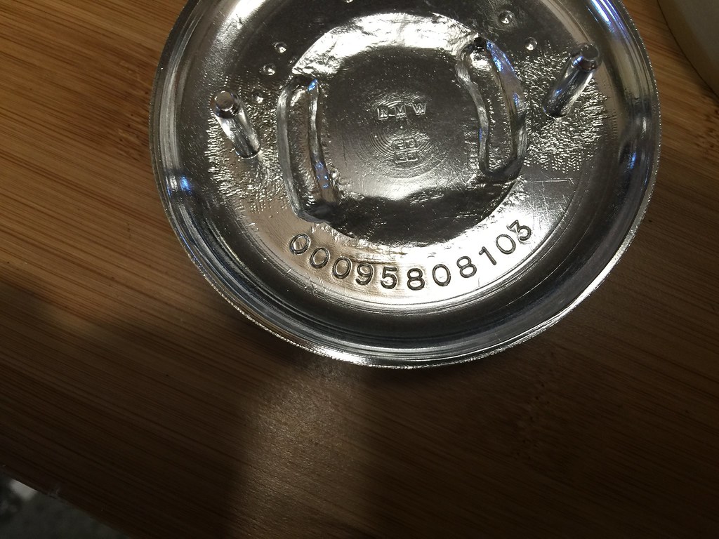

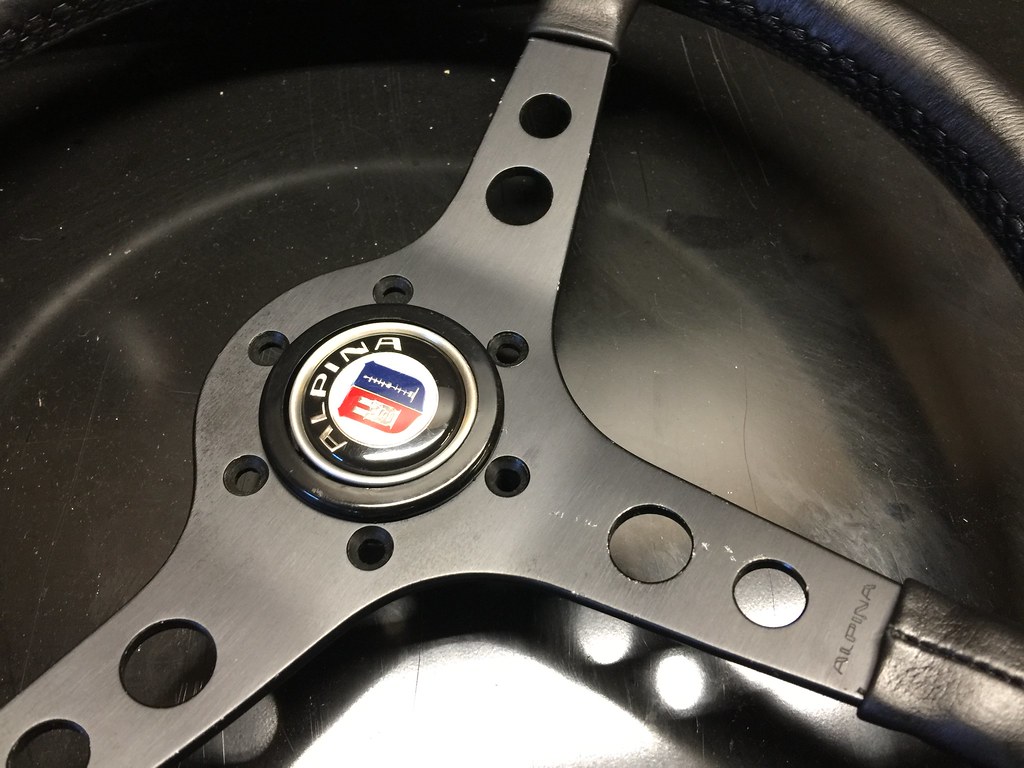

I've mainly been working on my CSI part out, but I did have time to clean up the vintage Alpina horn button that I purchased.
Recap - This is what it looked like when purchased:
The horn button is held in place by three metal tabs that are bent over the plastic horn ring:
Flip up the tabs and the horn button comes apart
Scotch Brite Pad and WD-40:
The Alpina logo is actually embossed plastic, and not your typical "3D Sticker" that you would find with modern-day logos:
Back together:
On the wheel:
