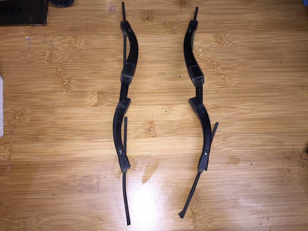

So I've always had this thing for headlight wipers, whether it was a Volvo, a Mercedes, or a BMW. Some people think it's silly, others may understand. Regardless, they are rare and I think it sets the car apart from the pack.
So with that said, a few weeks ago I sourced a bunch of parts. These are all factory E3/E9/E12 parts.
Seller #1: Wipers from Germany:
Seller #1: I bought a used E9 wiper motor, hoping to use it as a 'template'.
Seller #2: I purchased two inexpensive more available Mercedes W116/W123 motors. As it turns out, the Mercedes motors have a larger splined shaft. Probably still usable with modifications, but this is a non-issue at this point. I'll stick them on Ebay:
Seller #3: NOS Wiper Motors from France - some of you may have seen these - Stan, not surprising they have been for sale for a while:

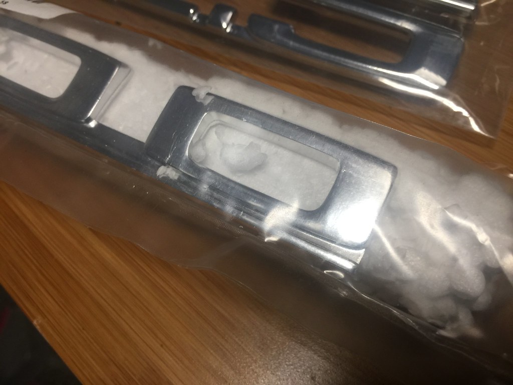

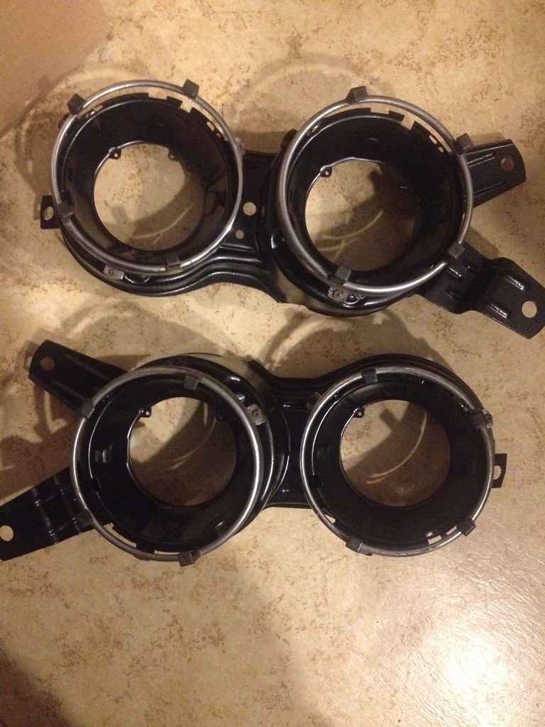

Seller #4: E9 Headlight rings with wiper stops:
There are only a handful of members with such wipers. Nicad has been very helpful, snapping tons of pics for me. The dual wiper pump is NLA, but can be easily rectified with a second VDO wiper pump. The factory dual bung wiper tank is still available from BMW, and it's only $50. That leaves me with the wiring. The gentleman who sold me the rings offered to build a harness for me. I'll probably take him up on it. Before I proceed, a local E9 member has the rings on his E3, and I'm hoping he has the wiring under the hood. I just need to take a look at the car to examine. I don't think he has any intentions of unloading the car so this is a low priority task. I also don't plan on driving in the rain and if I do, I'll be okay if the wipers don't turn. :)

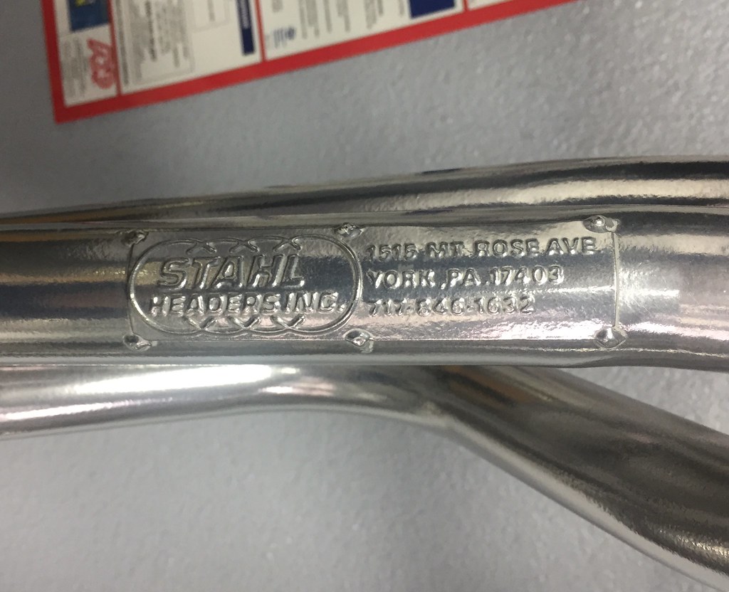

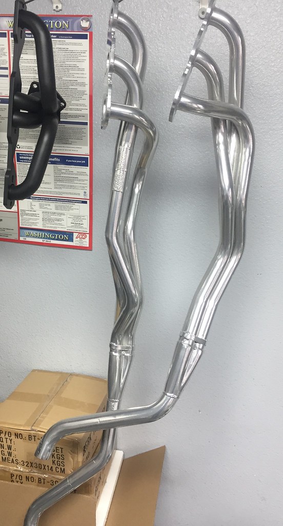

These are so pretty that I felt they were worthy of a post. I traded some CSI parts for a set of Stahl headers. I had them shipped directly to Performance Coatings in Auburn for a coating of "chromex". It's good to 1300 degrees. Not their most durable finish but nice looking. The cost is normally $275 plus shipping but the headers were longer than Brad expected. Total cost with tax was $350. I may coat a spare valve cover for $80.

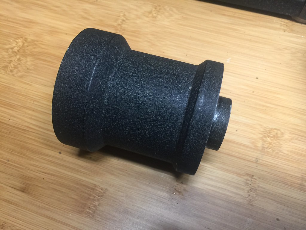

Solid Momo Hub, €75 + Shipping:

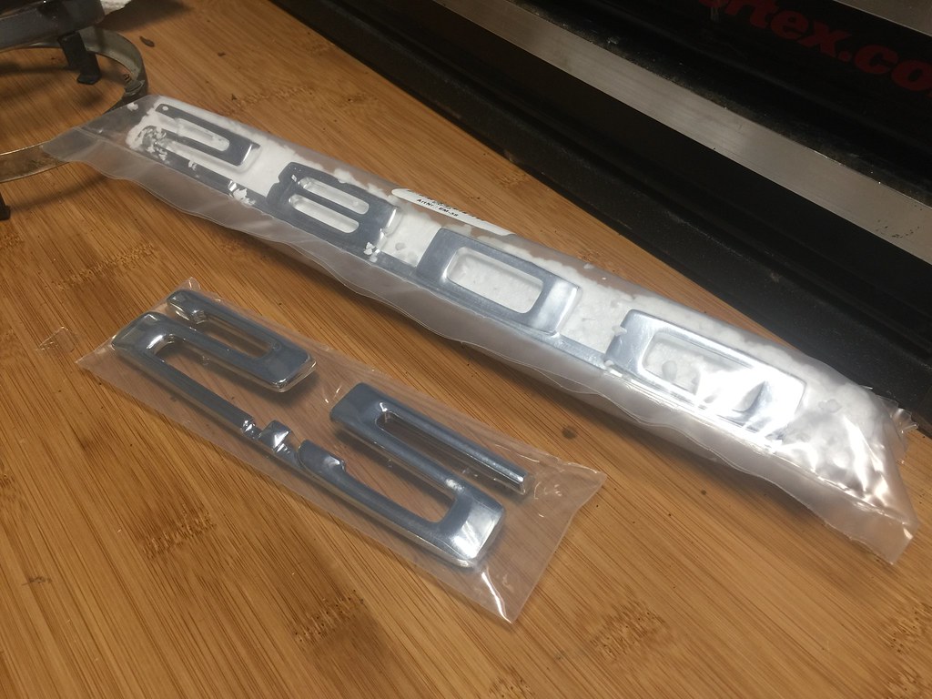

NLA - NOS 2800 CS "2800" badge, €40 + Shipping. I also picked up a NLA - NOS 2.5 CS "2.5" badge that someone may want.

yeah buddy ... gotta love the Stahl header. is the primary tube 1 3/8" or 1 1/2"?
Thanks! They are 1.5". I suspect that most people think that this is too much flow for the 2800CS, but I figure with the high compression 2.8, triple webers, and a cam they should match up fairly well. A little aggressive but we shall see. I suspect that my cam isn't factory, but I haven't verified yet.
its a bit much for anything but a serious firebreather. according to Jere Stahl, you need to be above 240 hp on an m30 for 1 1/2' for optimal - serious cam, very high compression pistons, etc. this is about where korman's stage 2 is ... and they use the 1 3/8" ... they don't go to the 1 1/2" until the stage 3.
Yep I posted that article in the Stahl thread. I foersee a torque-less wonder in my future. In the mean time I have some nice wall art. :) Honestly I'm not that worried about it. An M90 is 218hp stock and I find about one a month. I don't want to swap the motor but I would be up for it if the motor doesn't cut it. My timeline is in years so it's all relative. I guess the real question would be, if I am running DCOE 40's and a larger cam, would 1.5" headers be better than a 2800CS factory manifold?

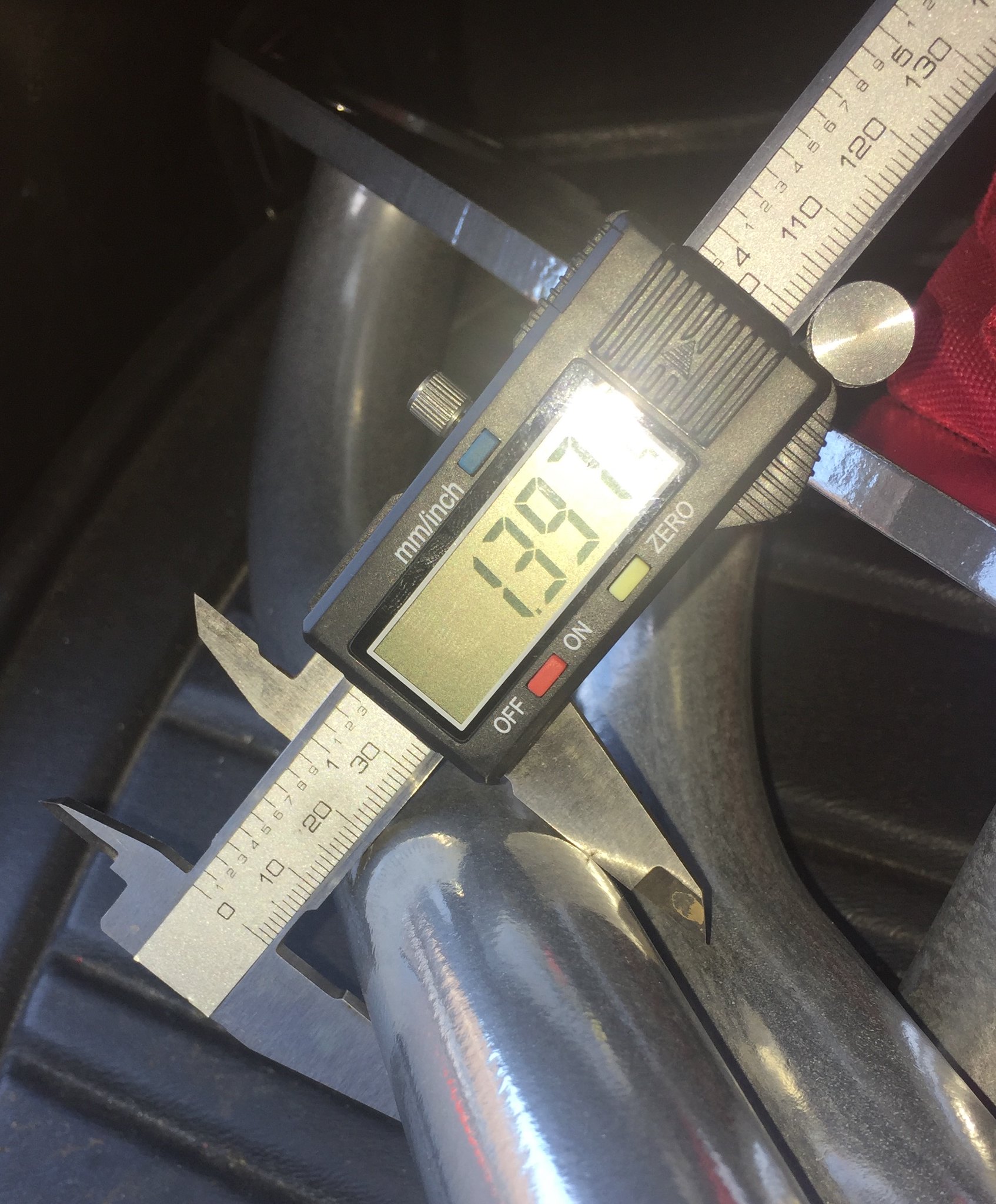

Correction! I was told that they were 1.5", and was going to trade them and run them despite the aggressive primary diameter. I measured them this morning and they are in fact 1 3/8". They should work great with my setup!

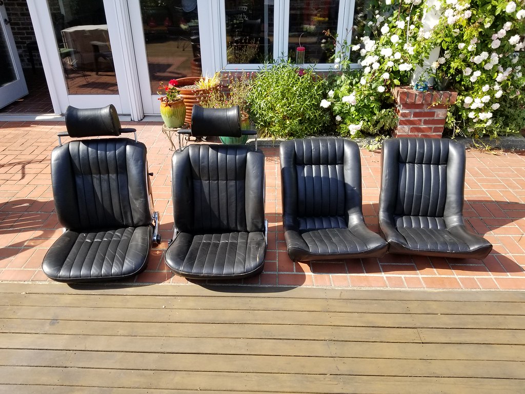

Daddywad's Alpina Strut Bar NIB - $415
Black Leather Seats Front/Rear - $500
Rare Steering Wheel - $160
Box of parts to keep/sell - $20
At this point I have three sets of front seats and two sets of rears, and an extra set of black headrests. I need to go through everything and figure out what internals I want to use. No matter what I'll be selling a rear seat shortly. I suspect that I'll keep my blue leather rear seat as it is in better condition than the black leather that I just bought. I was really after tear free leather. Getting very close to having everything I need for an interior overhaul.

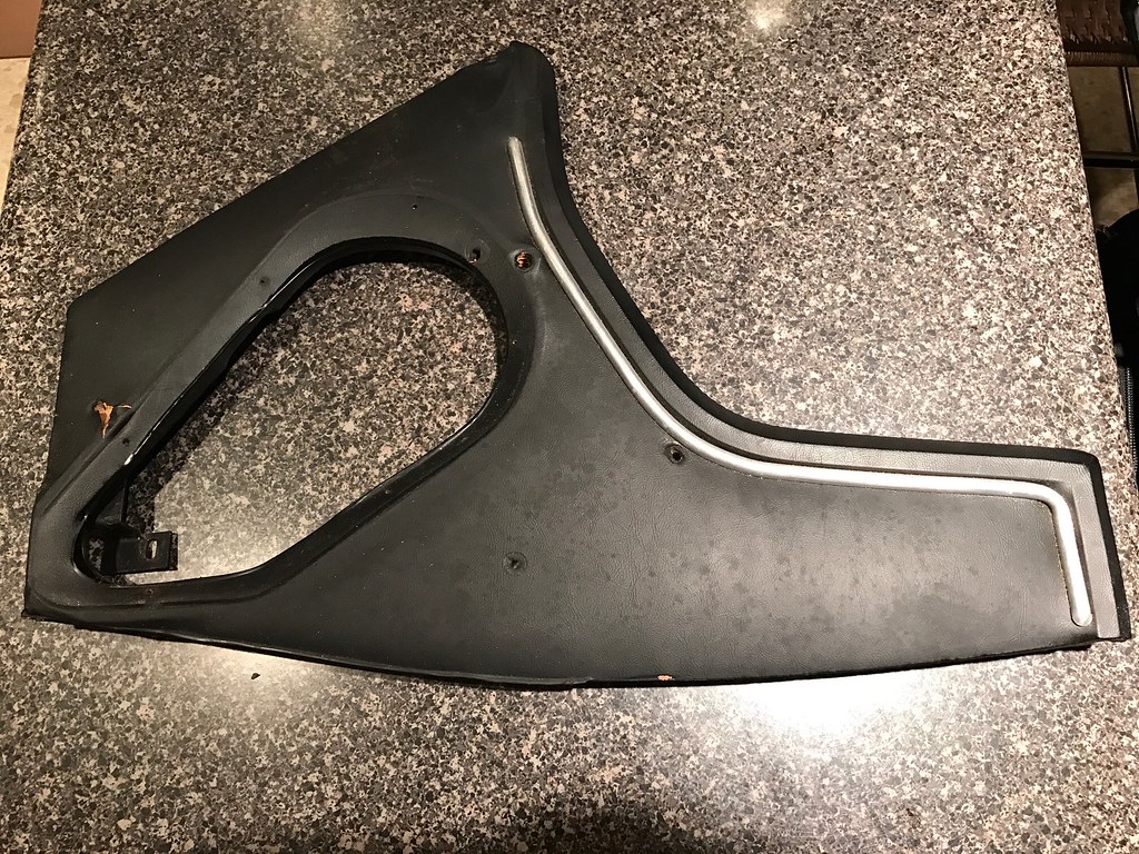

I bought a set of AC Console sides for my car. I don't intend to run AC, but I like the profile of the AC console better. It also means that I don't have to refinish the wood piece down by the shifter. I'll be running a 3D printed gauge plate that I will prototype in September. These console sides will be used for the prototype. - $175

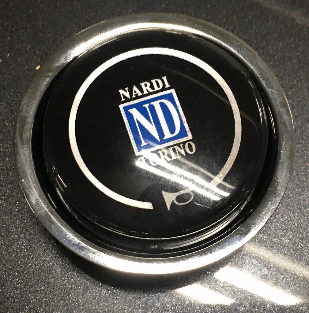

A NOS nardi horn button for $20

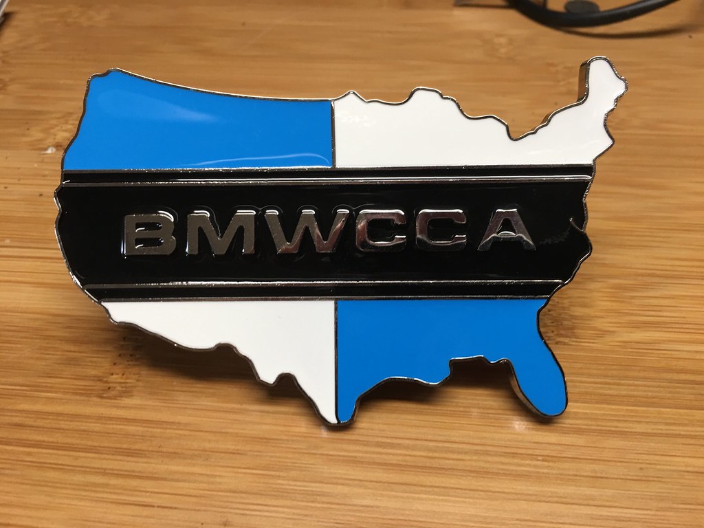

A "No Space" BMWCCA grille badge for $50.

No patina and the originals have very crisp lettering.
Andrew, It looks like the original is enamel paint in a sand-cast plate and the repro is cloissonné in a chromed casting. Old school versus current technology. Leave it to you to have both...
