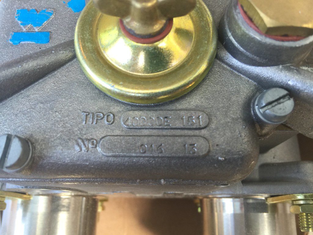

I purchased an open-box unused Redline Triple Weber DCOE 40 kit for $900 plus shipping. I didn't need it, and initial setup will be a headache, but DCOE's have been something I've always wanted on a car, going back to my 16v VW days...
In other news, I confirmed that my car has the original 2.8 block. The Webers may be a bit much for this block. I plan to keep the 3.0CSI motor from my parts car since nobody seems to want it. The block and head didn't affect my estimate on breaking even on my parts car. This will also give me the option to work on a motor and keep the other one going.

That's a lot of carb for a 2.8. I'm running 32/36's and a 300* cam, and off the cam I have too much carb. Damn these puny engines.
You had 16V VW days? I had 16V VW days! Did we just become best friends? :mrgreen:
I also have 32/36's. I'm pretty sure I have an aftermarket cam based on the conversation from the previous owner. I will investigate this summer. Either way I'll find an engine to fit the carbs. :) As mentioned I hope that it is my 3.0 CSI motor with 10:1 compression. I'm quite a ways away from inspecting that one though.
I'm secretly disappointed that Inhave the original block. That means I need to store it somewhere. :)
the 40 model triples are fine for a 2.8 as long as they are choked at 32 or 34mm max. My VGS racing manifold that holds my triples was orignally for a 2.8

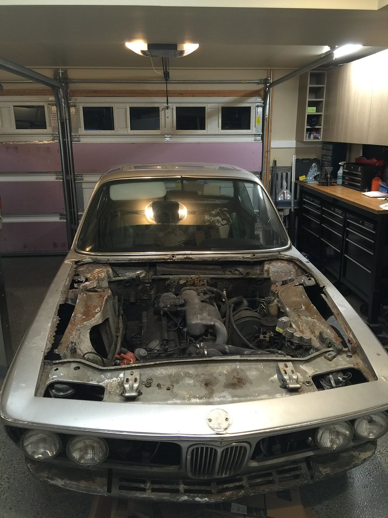

I'm wrapping up a month-long dining room remodel effort and the drywall goes up this weekend. Hope to get more coupe time in and sell some CSI parts. I also plan to remove the rocker covers from the project car to inspect. I've already run an inspection camera down the inside, but I'd like to look at the outer rockers also.
