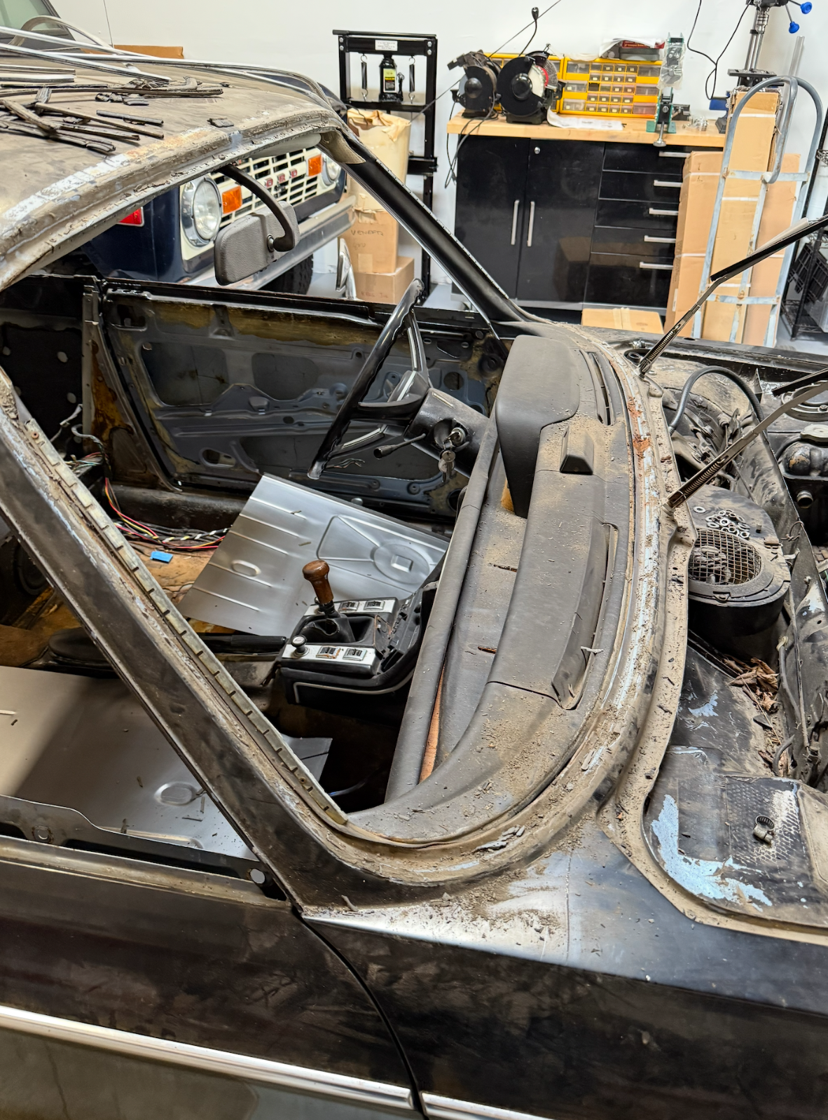

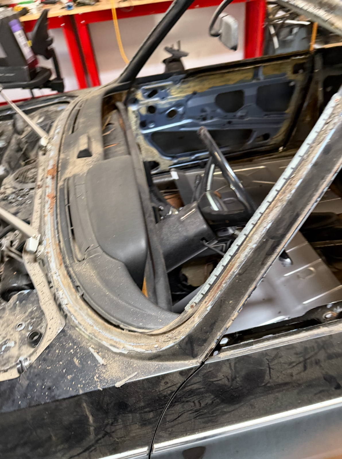

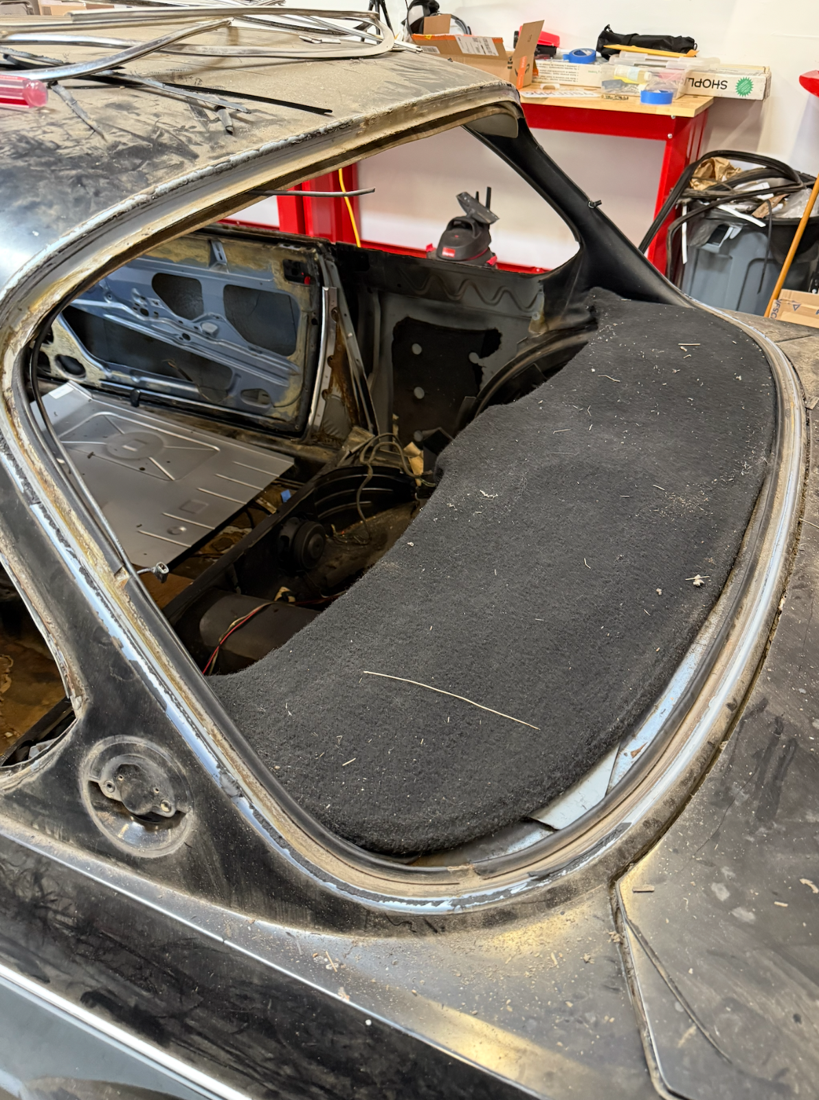

Pulled the front and rear glass out of the car today. I was praying that there would be no significant corrosion at the corners (my E24 was just starting to rust there when I pulled the glass 18 years ago)..
To my great relief there were only two very small areas of surface rust, oddly, right in the middle of the lower windshield area. Nothing in the corners, and nothing at all in in the back!! Yay!!! Dash will come out inthe next few days and then all of that stuff is off to join my Scheel seats to be re-covered.

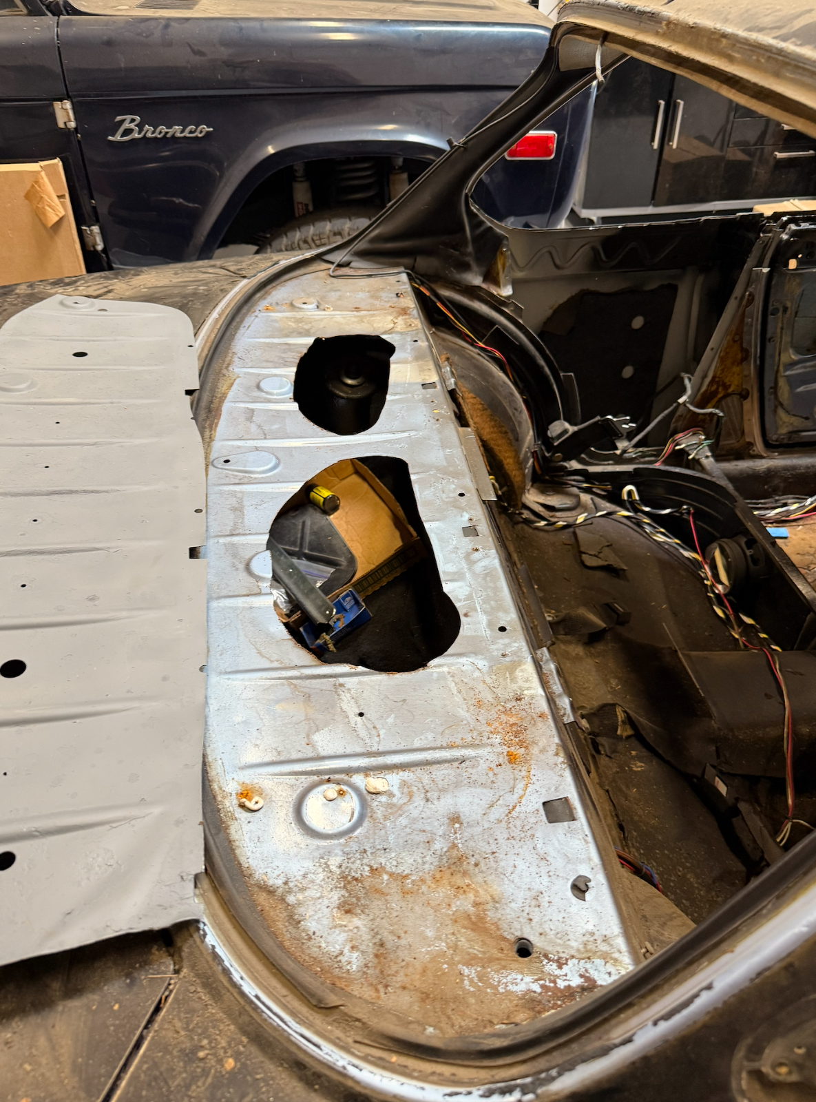

The package tray was a less good surprise. Apparently some PO had hacked holes for speakers. and I mean HACKED..
Bizarrely, some other PO had, apparently, cut out the package shelf from another car at some point, and had stored the patch under the old package shelf.. So I'll have a bit more welding to do!!

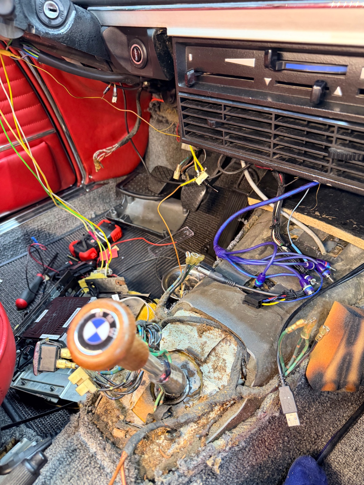

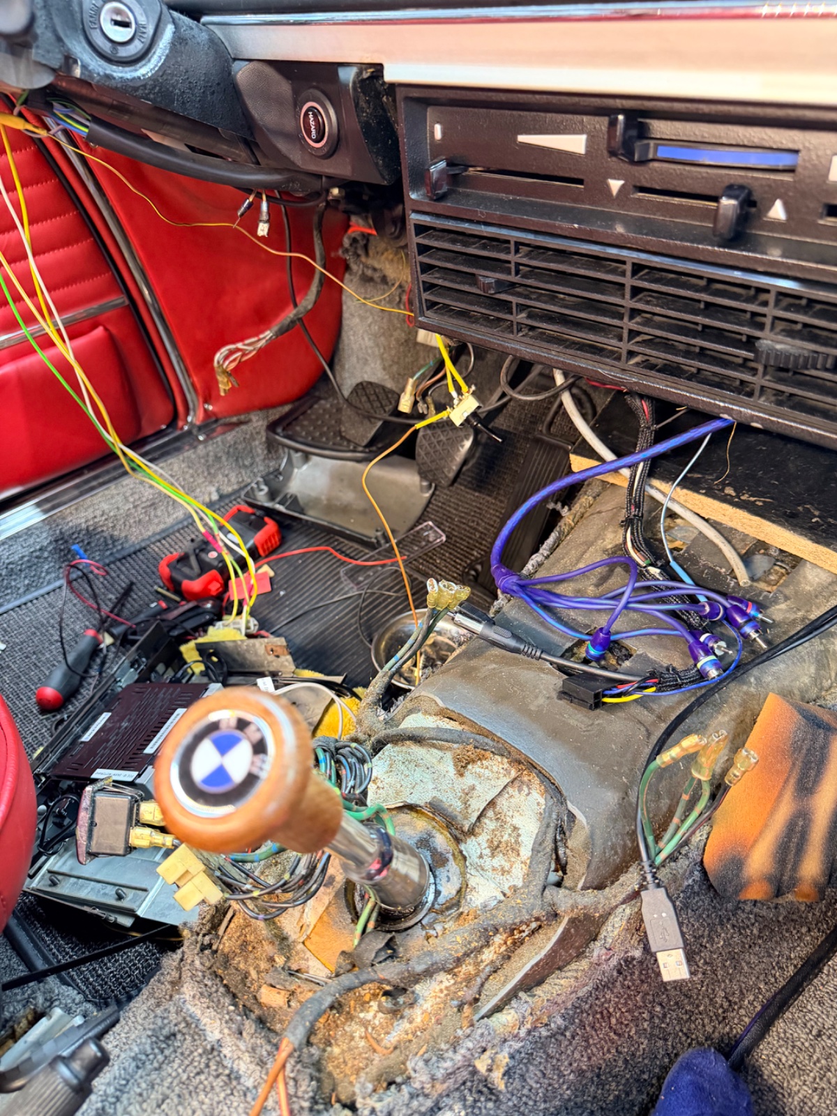

There was a great deal of extraneous wiring, apparently associated with various aftermarket stereo installations over the past 53 years. It was with great satisfaction that I tossed all that, along with the crappy aftermarket cassette player in the trash bin. Looks like the console was butchered to hold a 1-DIN radio, so I'll have to decide what, if anything, to do about that (surprised that it is pot metal, and not plastic!).
Trying to bag and label everything as it comes off, and also photographing and labeling aIl the wires before I disconnected them. I removed the steering wheel to make room on the driver's side. I think my next move will be to remove the instrument cowl, and then try to remove the upper dash pad.
Some interesting quirks I have observed.. The fan and temp controls are ... unusual .... The temp control was not connected to anything, and the fan speed control was loose. Both seem to be odd electro-mechanical affairs. Very odd too that the wiper speed is controlled by a switch on the console. Seems like a strange place to put that...
