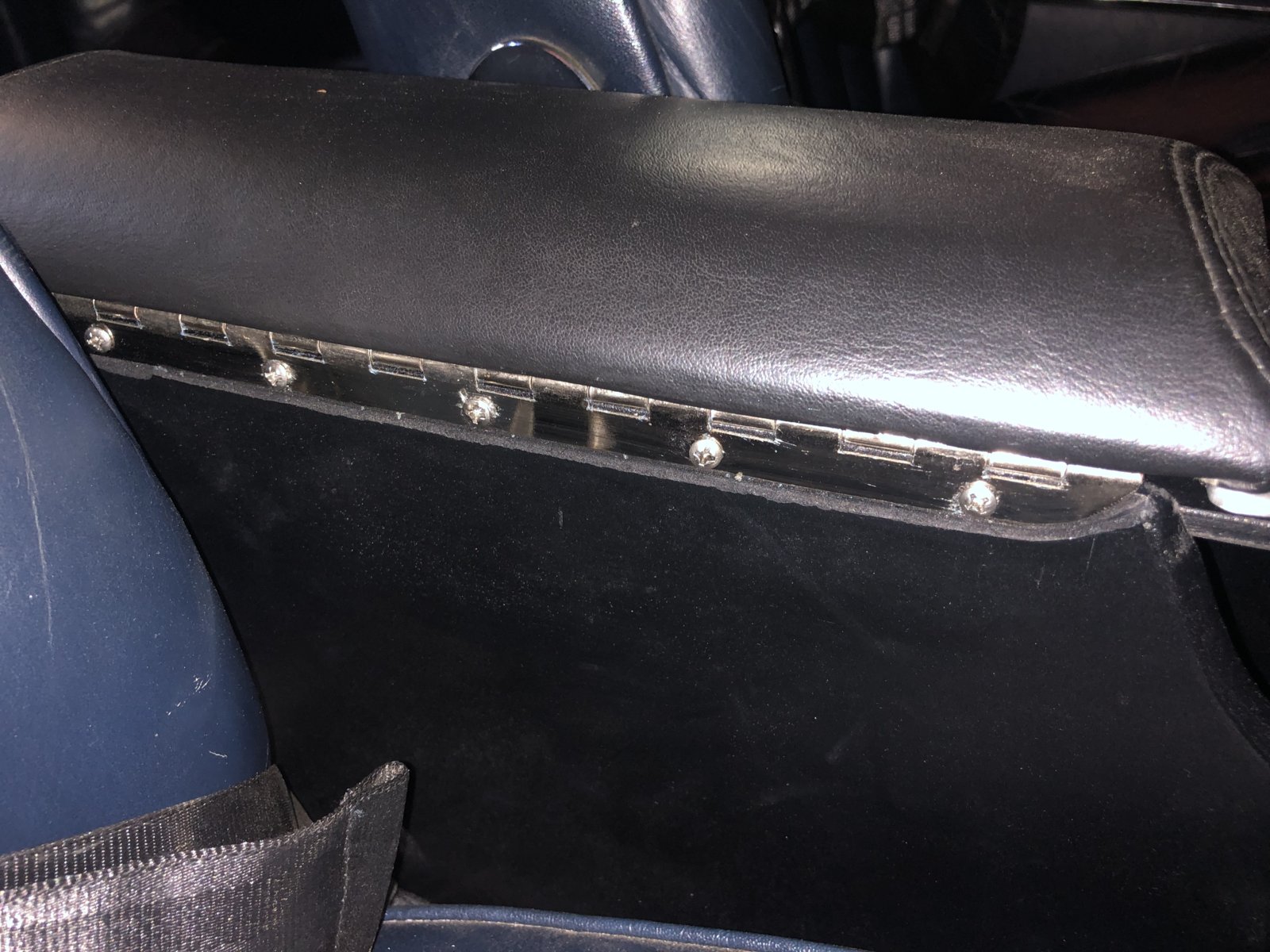

Had to mechanically fasten the hinge of Athena’s “Anton” arm rest console because the thin milled strip fractured the length of the hinge. Only issue, the screws now interfere with the ‘sliding’ cup holder so it’s always extended. Will probably remove the cup holder card all together as I rarely use it.

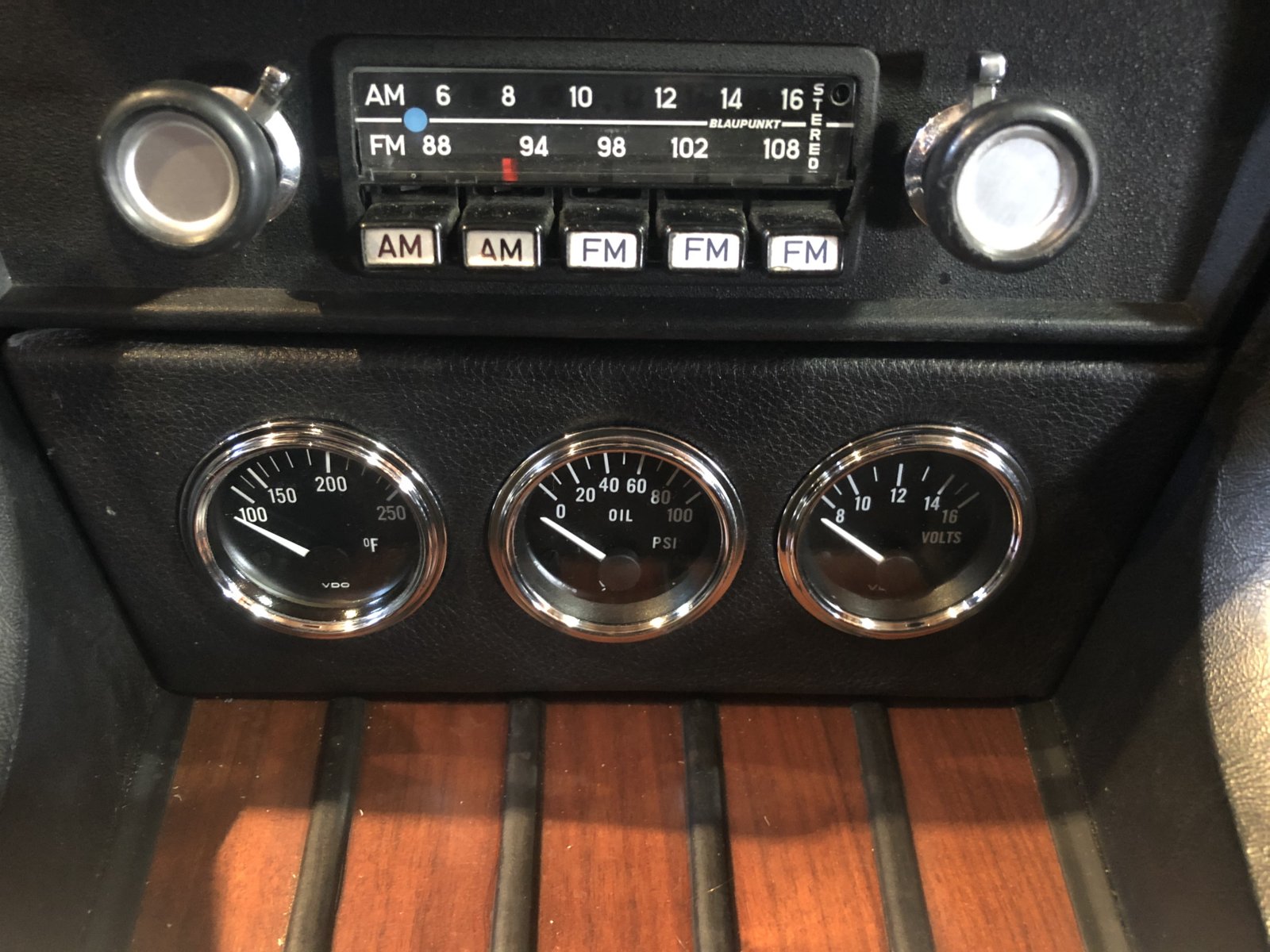

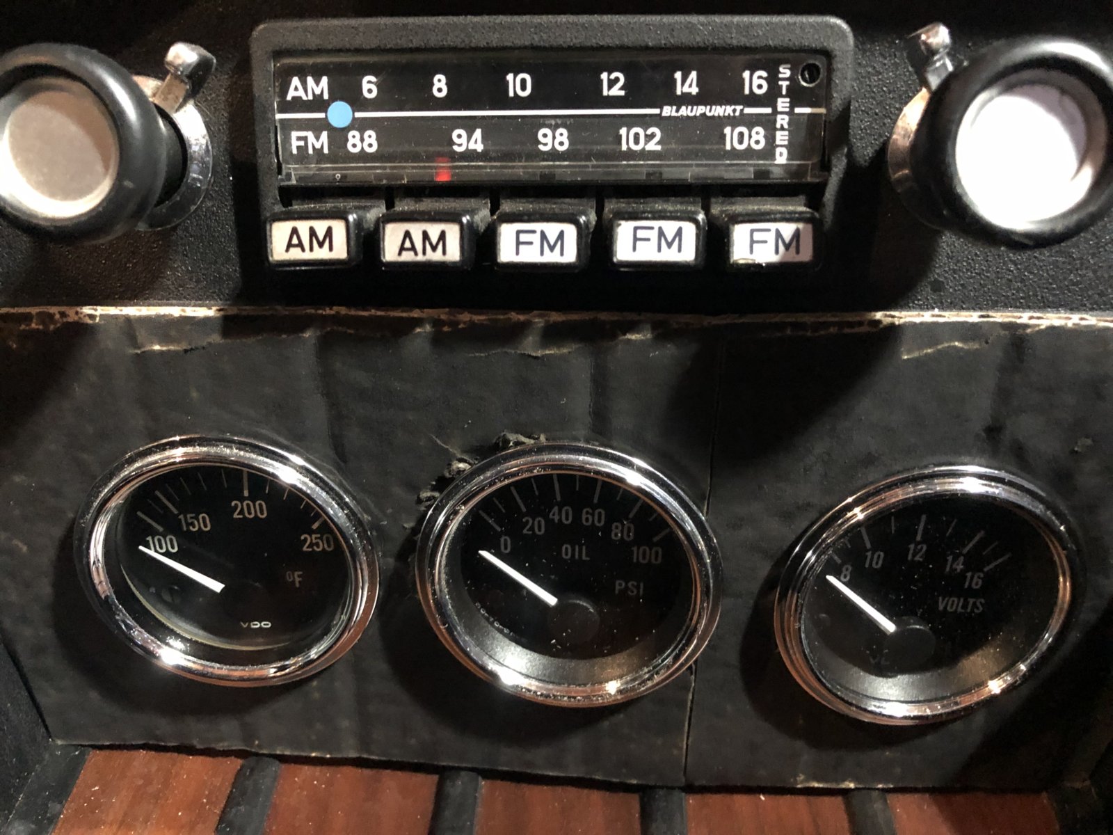

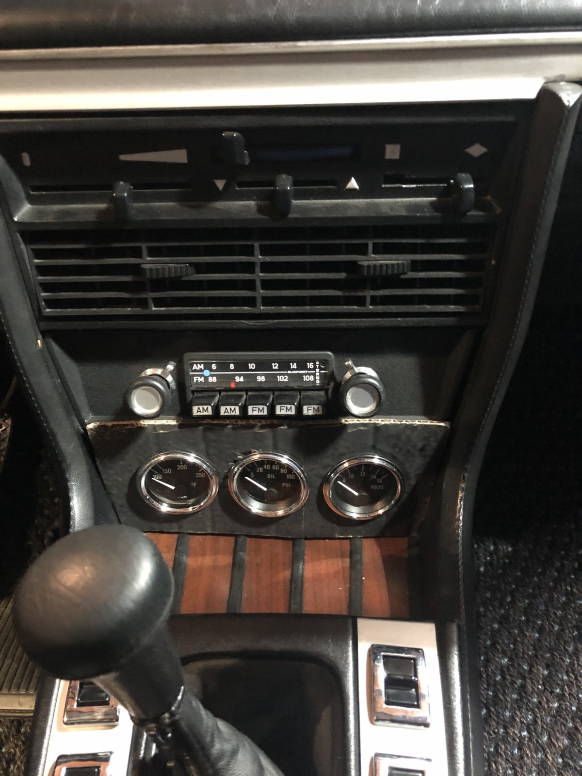

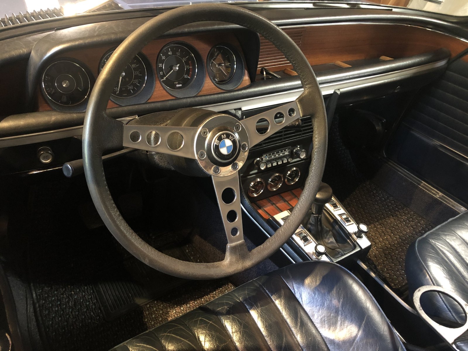

Upholstered the 4mm plywood accessory gauge panel with leather over neoprene. Everything fits great & tight. Plan to do Oil Temperature, Pressure & Voltmeter. Same as I have in the 1997 M3. I'm an electrical wimp & will have the gauge senders & wiring professionally done.

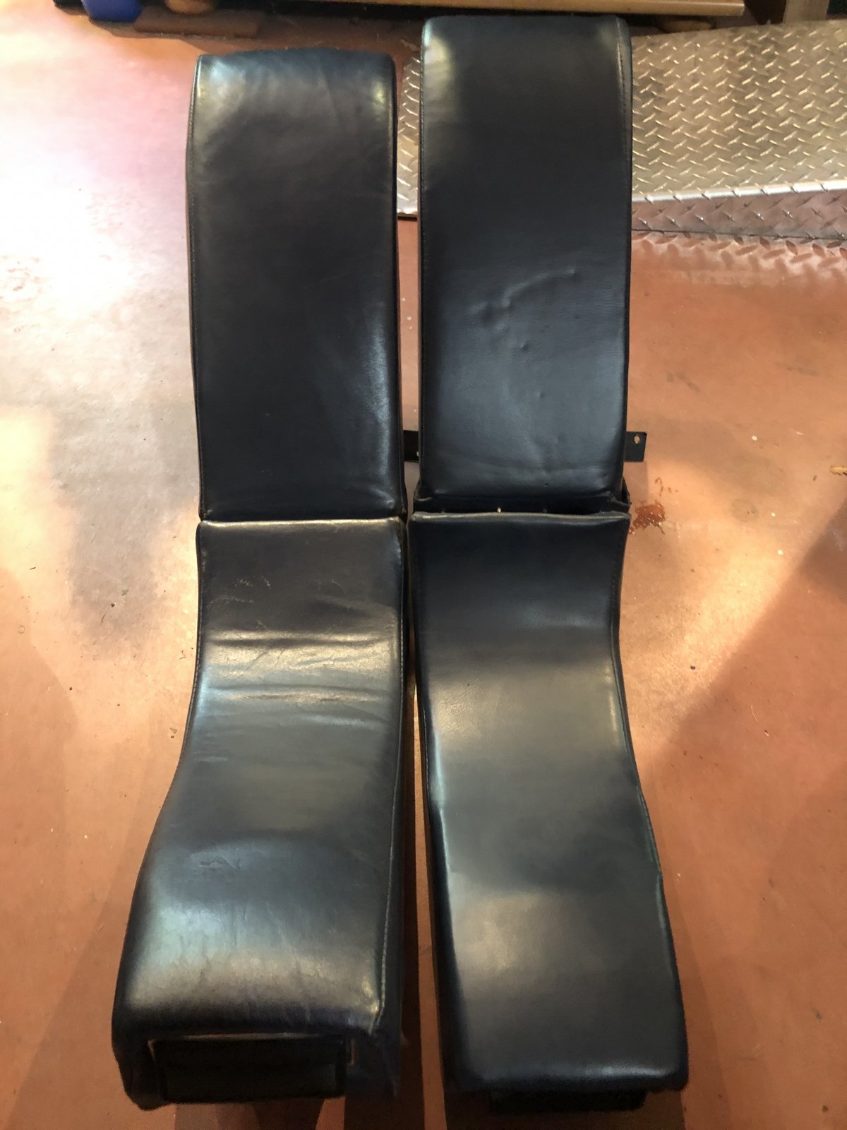

Removed the old beat up center rear armrest with a reupholstered one I bought from a guy selling a set of dark blue rear armrests on E9 FB Group.
Removing the old one wasn't difficult, toughest part of reassembly was putting in that confounded screw under the front of the lower armrest because of the front center console.
Andrew, it appears that the new/used one you bough is shorter than your beat up original. If so, did you end up with a larger gap at the top?

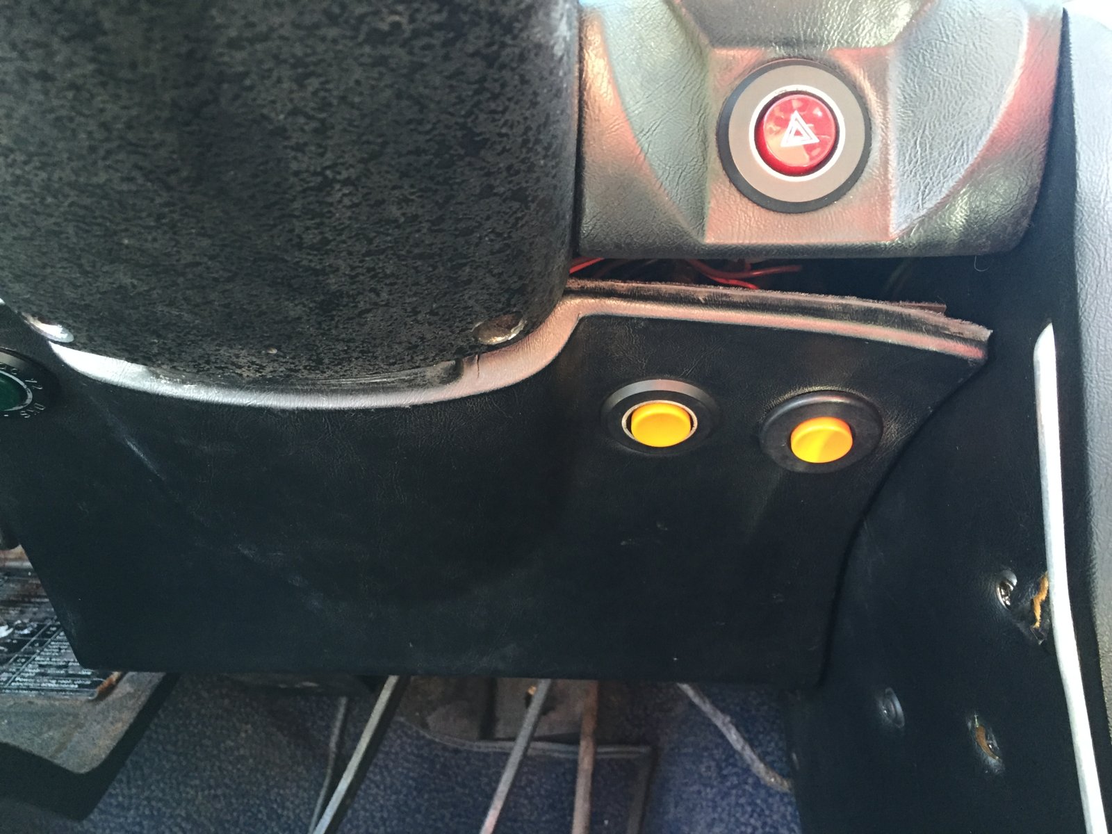

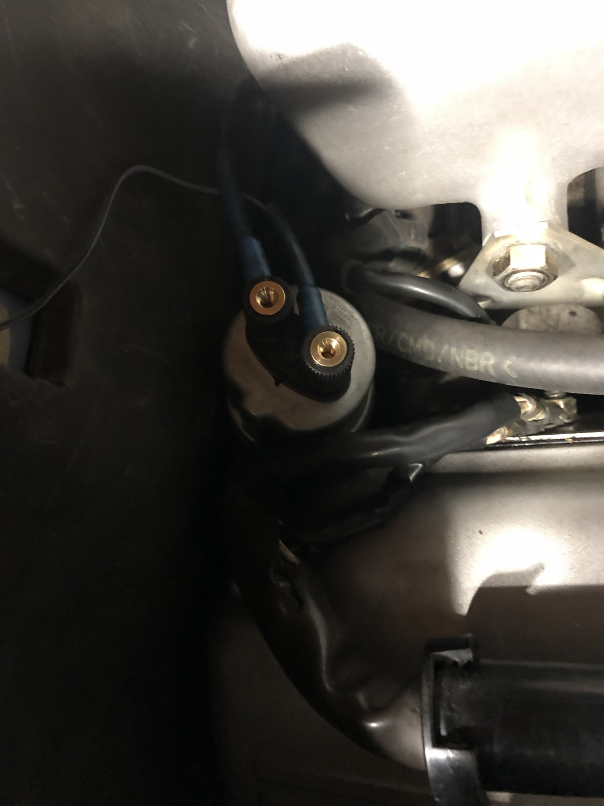

Last weekend when driving to the Castle in the Clouds. Athena’s heat wouldn’t work.
in 2016 VSR installed an electronic heater bypass valve. It has worked flawlessly since it was installed. Until October 3, 2020 when it was really needed, it was so cold & foggy the chill went to my bones.

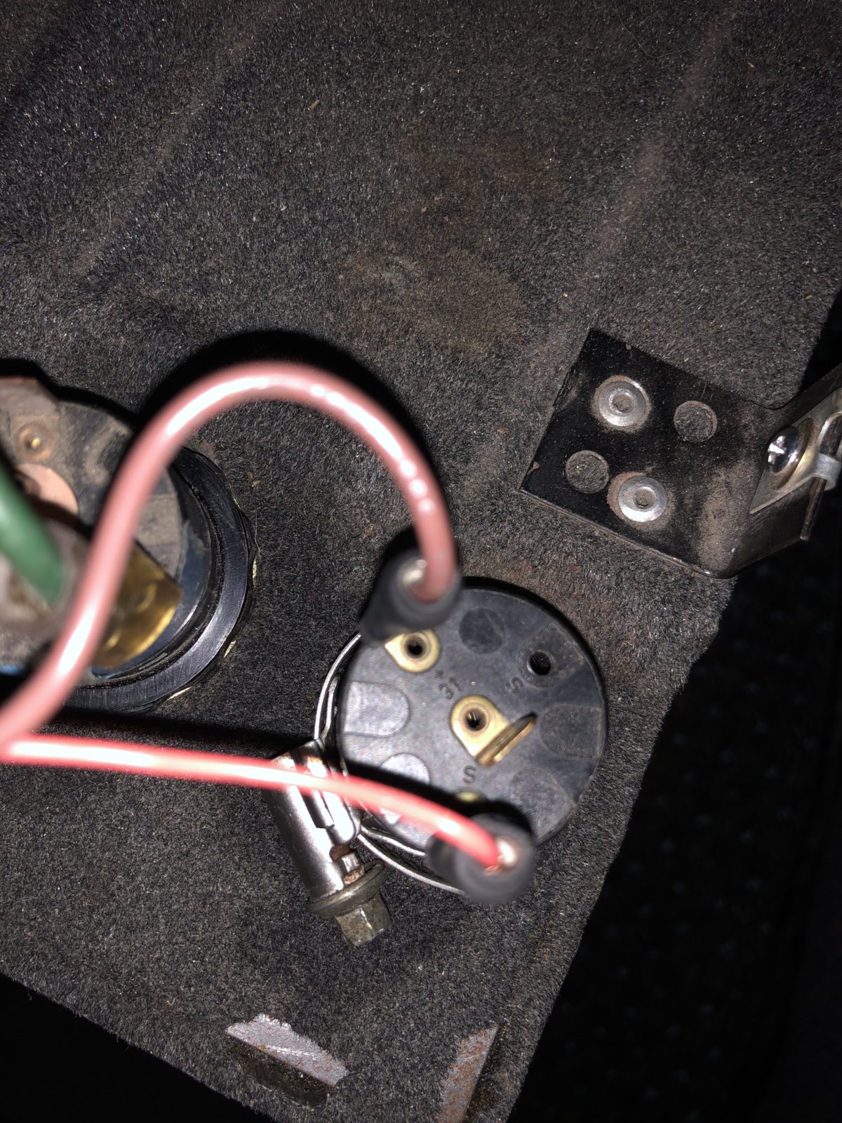

Sunday October, 4th I decided to troubleshoot the no heat condition. I removed the lower dash panel I had repaired over the Winter. Consulted the photos of switches before dash the repair. Everything was properly connected. So I replaced the switch, still nothing.
So then I pulled out the Voltmeter, it showed no keyed power to the switch. I “rolled the fuses” making sure they were all fine. Still nothing. I checked all the “in-line” accessory bus fuses which were all fine.
Feeling defeated, I made an appointment with VSR to diagnose.
I arrived Thursday October 8th at 11:00 am, by 11:15 the issue had been diagnosed & was being repaired. The keyed power wire had broken in the insulation above a small zip tie. By 11:30, I was on my way home.
Drove Athena to my old neighborhood in Connecticut to attend a Cars & Coffee at Dragone Classics new facility in Orange off I-95. Saw Friends & family. Chuck Moss with his E30 M3, Duncan Irving with his 2002 & my 93 year old uncle with his 1932 Franklin.
Discovered the heater-bypass-broken-wire-diagnosis did not fix the no heat problem unfortunately.

After a month at Autowerkes Maine in Freeport, Athena is back home.

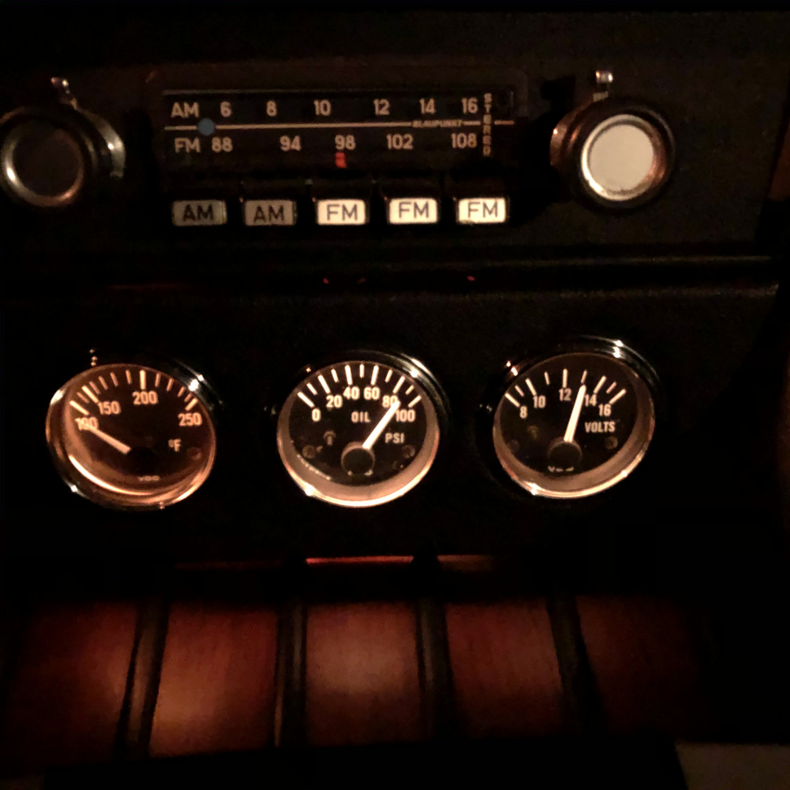

The 2 main projects were wiring the auxiliary gauges and a 'chirp' when accelerating in 1st to 3rd. When diagnosing the 'chirping' they found the rear sway bar end had ripped the outside CV joint boots. The 'chirping' was found to be the centering "pin" on the back of the the transmission was dry & getting scored causing the 'chirp'.
The other sway-bar issue was the front passenger side bracket had cracked in half. Instead of replacing the broken bracket, it was welded & reinforced.

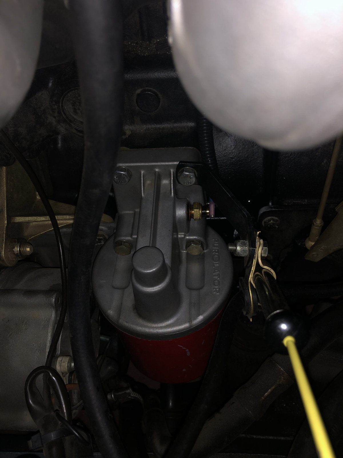

The gauge senders were a bit more difficult than anticipated. Due to lack of space, an "adapter block" was needed for the dual pressure sender to barely fit at the back of the engine. Finding one proved to be the toughest part of the job, taking 2 weeks to locate. The oil filter housing was drilled & tapped for the oil temperature sender.
Gauges look great. I had to get my sender adapter from the UK. Also had to use the right thickness crush washer so when tightened up the sender threads were straight up. You’ll love the gauges on your road trips
