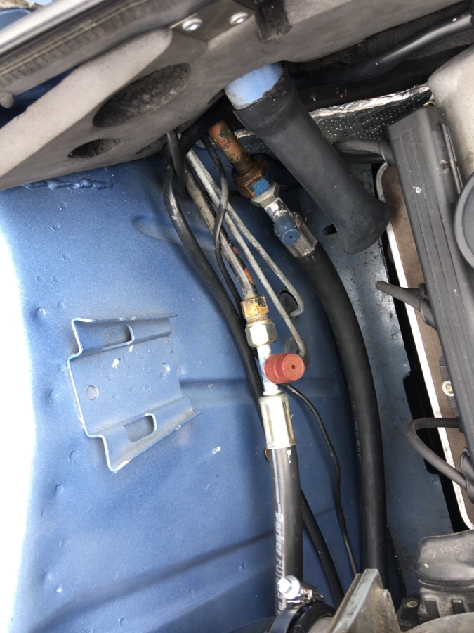

Got the AC hooked up finally. The new Sanden compressor blows nice and cold but the engine temp climbs dangerously close to the red when sitting in traffic. Gotta figure out what that is. The condenser fan runs though...

Bo, temps that climb when stopped is usually radiator related, you may have a partial blockage, an infrared heat gun can tell you if this is the case. Hot temps at top and cooler at the bottom hose exit. Our 2800 would do this but we had the original mechanical clutch and putting a modern clutch solved our problem. Driving provides more airflow and sitting puts more stress on the system. Does the condenser fan kick in when temps get high? Your 74 has the radiator temp sensor which helps. I am going to add this to my coupe one day.
Really good info. Thank you Chris.
The condenser fan kicks in as soon as the compressor kicks in.
Without the air conditioning the car runs cool, mostly at about 4 o’clock on the needle. Tstat is a 72 degree one. This would lead me to believe that the car radiator is working fine.
Bo, condenser fan should kick in with AC off when temp gets too high in your radiator, a feature of all 74s. At speed a rad can be fine, sitting in traffic not so fine, usually caused by a blockage.
And with the ac on, the engine works harder and the condensor is hogging the cool air that otherwise would be available to the radiator which can expose a weak radiator, especially in traffic.
The radiator is a new "Don Laurence special" one. The fan and cooling system are all new as well. And the condenser and fan are new from Nostalgic air also.

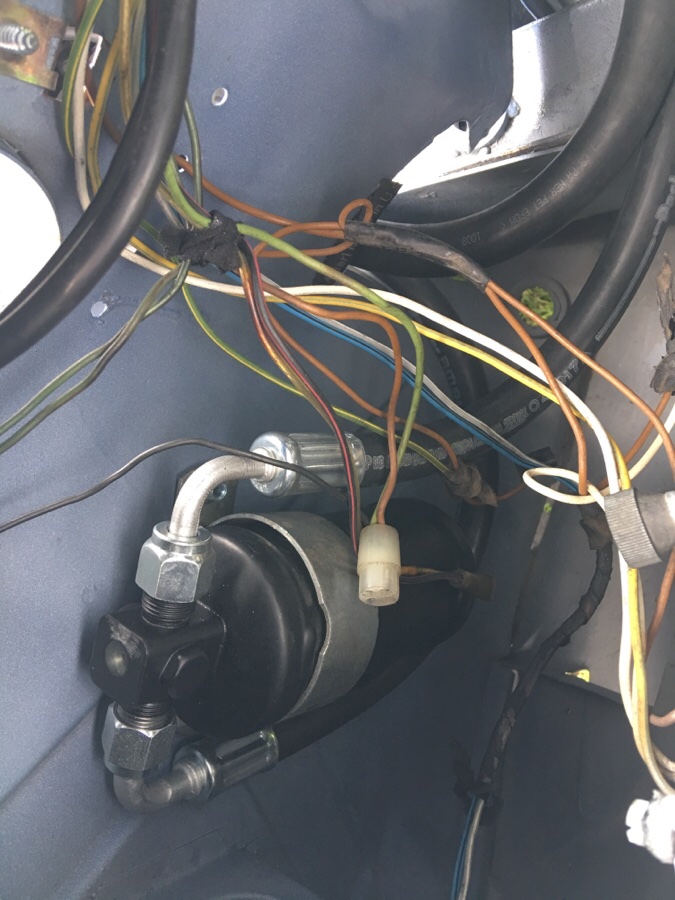

The condenser fan is wired using the original circuit so it is activated by compressor clutch turning on and triggering the relay above the battery. I'm not sure how it also gets triggered by the radiator temp however... I have not looked at that part of the circuit.

I think Don installs the fan sensor in the lower passenger side corner of the radiator, other places could be a dual sensor in place of the normal sensor by the t-stat housing.
