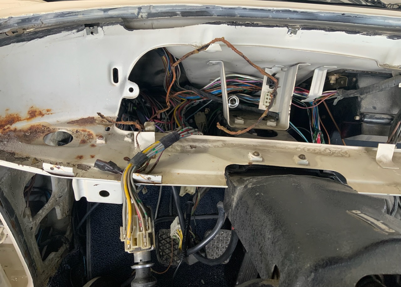

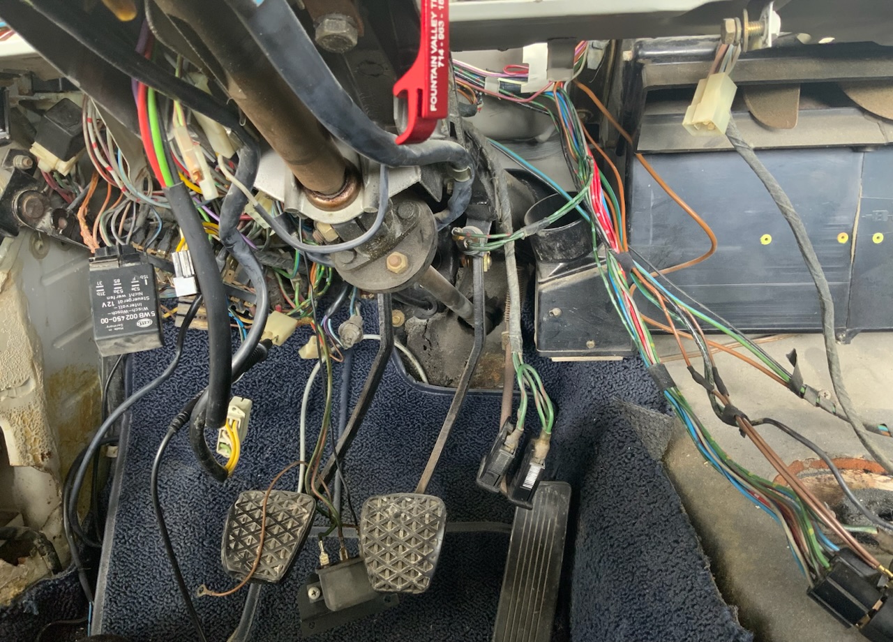

Trunk is done so I am tackling the dreaded wiring issues under the dash. Everything works except hazard and turns and I have several melted ground wires. I added a ground to one of those wires, replaced fuse #4 and wunderbar, they both work. This was after opening up a lot of the harness. I will replace melted grounds where I can and assess the others. Even with the dash out it is very hard to get to some of them like the main load shed relay which is nearest the firewall which has a ground wire issue. You can see one of the melted brown wires.

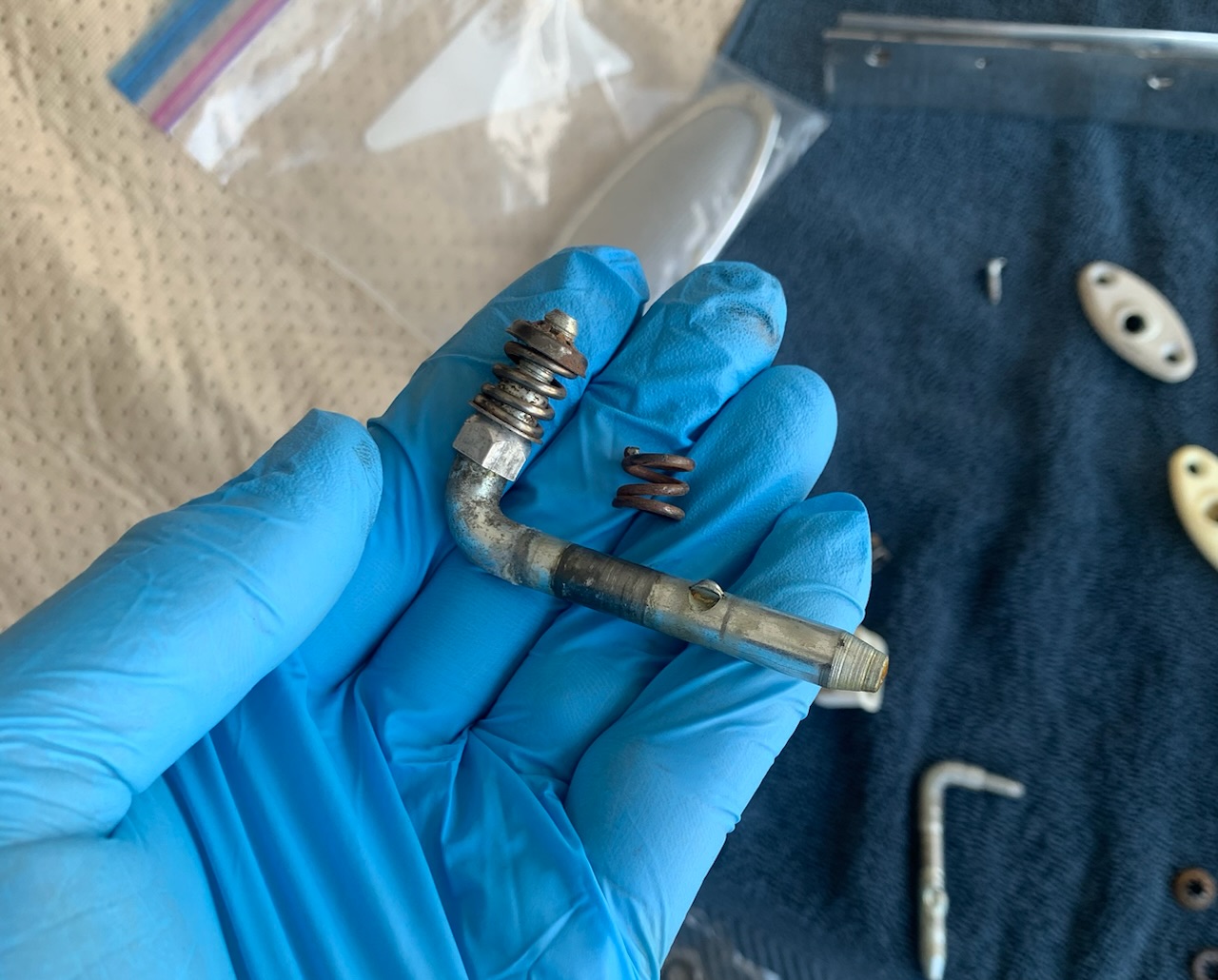

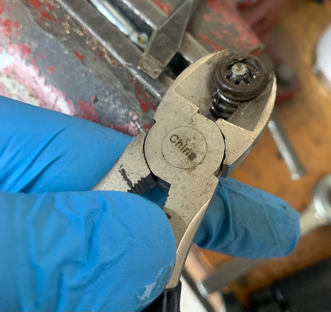

Got my visors mounted using Frankie’s alu bases which I painted SEM Ranger White. I used a 2002 spring as it is shorter and on one I threaded the post for an m6 nut, the other one I kept that terrible spring clip/cup. Tip: to remove that cup I put the post in a vise and used wire cutters and a screwdriver to pry and leverage the cup up. Headliner is in along with dome light and mirror. My coupe came with no header panel or visors and dome light as a result so back to original. Time to reinstall trims above the side windows and then the upper door seal.

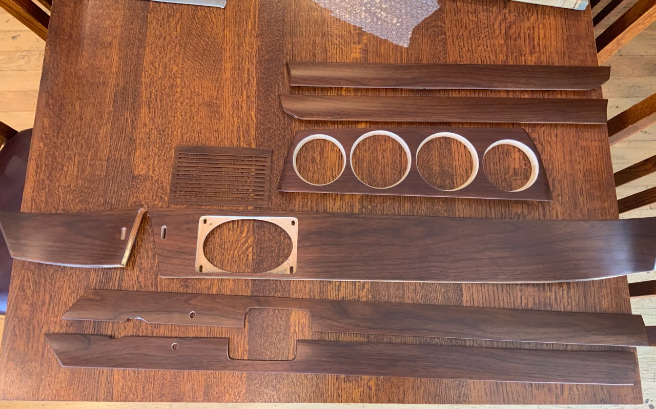

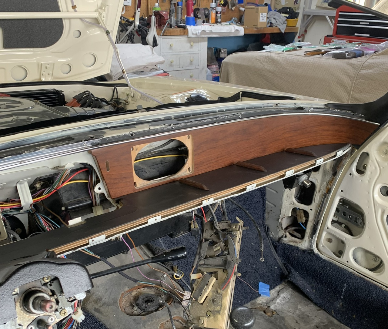

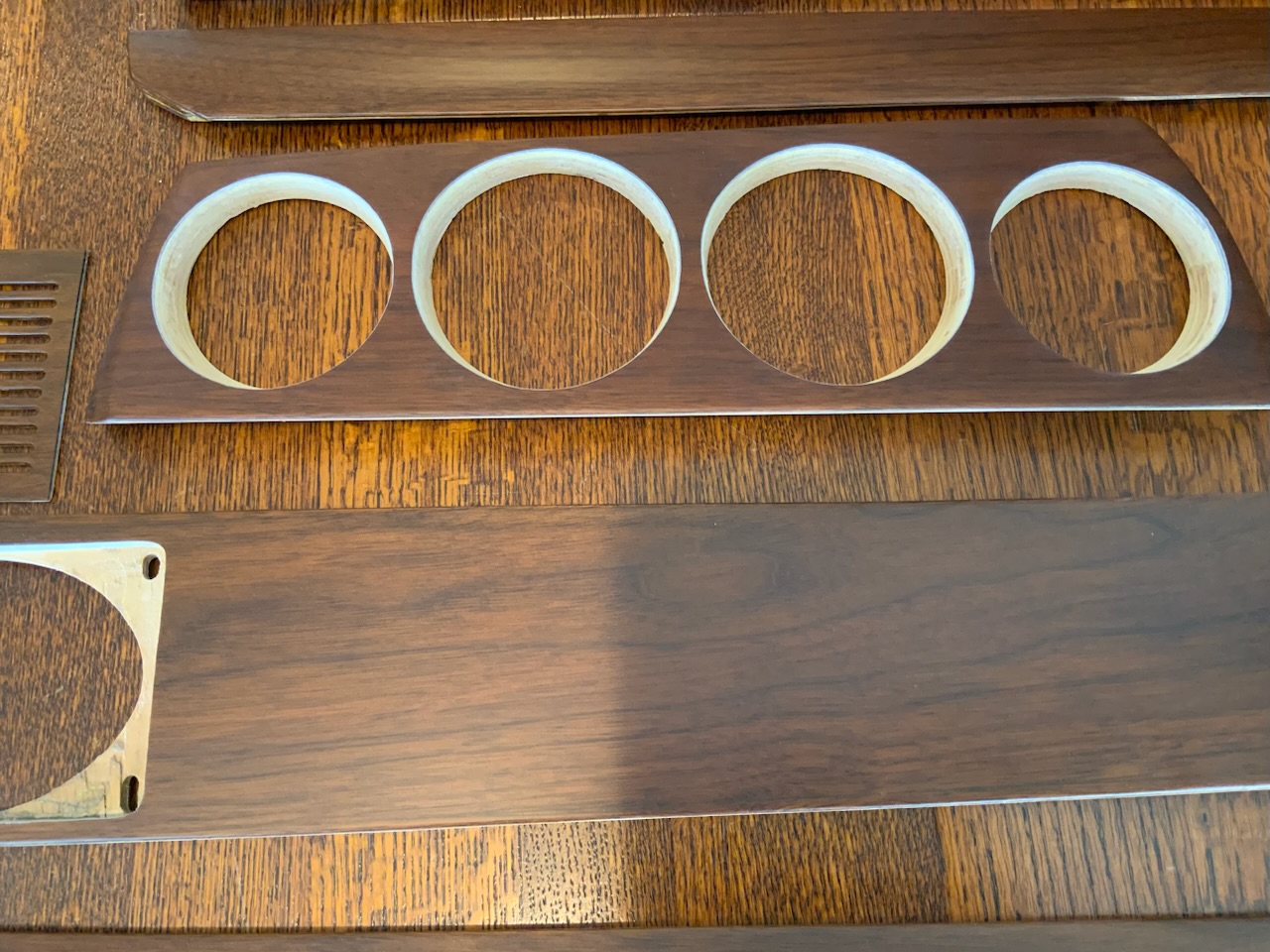

After three weeks in Europe I needed to get back to work on the coupe so I tackled the dash shelf. I had installed the wood to the shelf but could not get it to fit on to the metal dash itself so I removed the driver side wood, test fit was good, so I had to redrill holes for the tiny screws that holds the wood to the shelf. Another three hours of frustration that now fits fine, nothing is easy.
I also painted the rocker covers which look brand new and installed the rocker trims. I was able to reuse the plastic clips but I would never use new ones, they just don’t snap on like the originals. And I used OCCoupe’s method to paint the steering column cover and the a/c panel with chip guard, it came out great.
