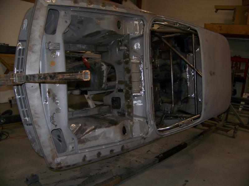

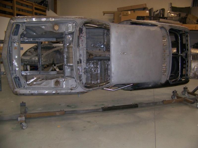

The tub is undergoing final welding and preparations for her final blasting. Once that is complete it will be time to start putting her back together.
Below are some shots of her on the rotisserie during final welding.

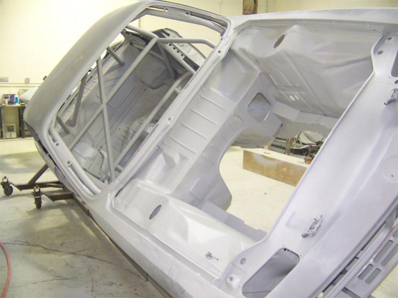

New years is brining some progress on the car. The engine is on its way from Korman to Bend and should get there this week. The car is back at Redstone from the blaster. It has also been powder coated in the engine compartment, interior, and trunk area. They have also begun shooting primer on the exterior in preparation for mounting fenders, etc.

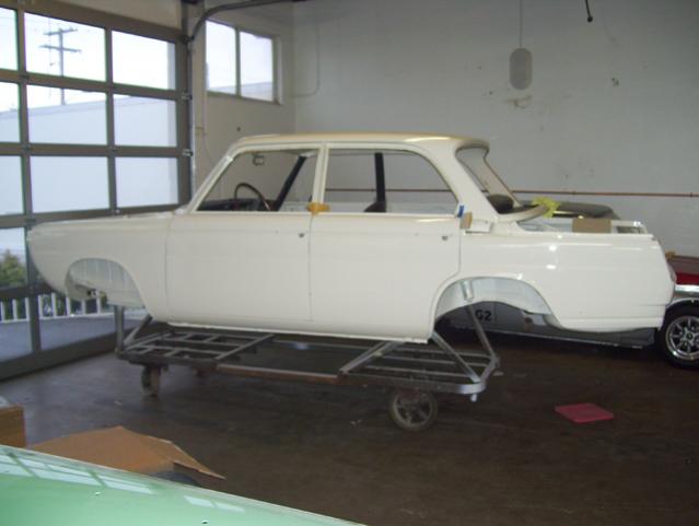

My other BMW project is also moving along nicely. While not an E9, it is a fun car. It is TiSA #193, which is being rebuilt as a street car. It is back at the shop from the paint shop, and ready to begin assembly.

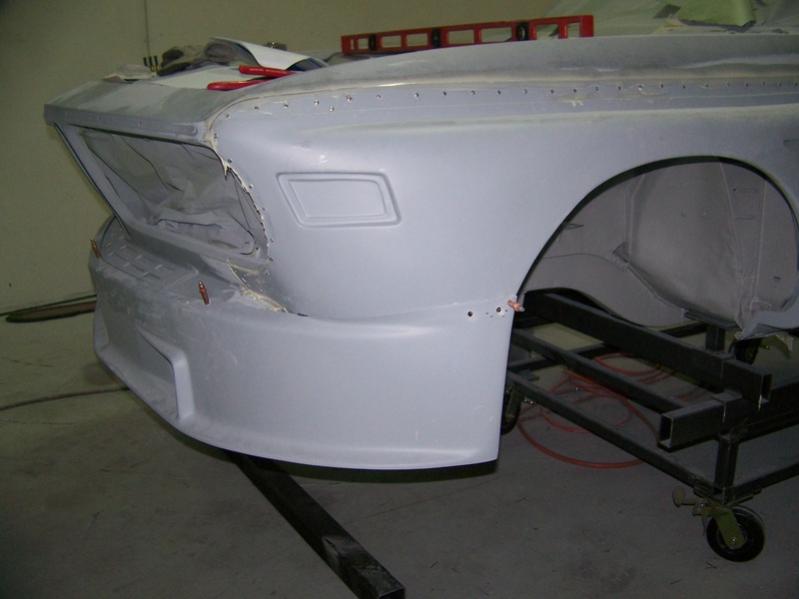

Fenders and Air Dam
Redstone has begun hanging the front glass fenders and air dam. These parts came from Zap Racing in England, and are very high quality. I asked them to mount the air dam with Dzus fasteners to facilitate loading and unloading from the trailer. We will be cutting out the brake ducts later and adding tubes to carry the air to the front discs.
I also had them spray a slightly textured gray paint on the interior floors to help hide some of the wrinkles that still remained after straightening the tub, and also for better traction for my feet.
Won't be long before they are spraying color.

Photos of front end with fenders and air dam:
Raer Fenders On
The car is really starting to take shape.

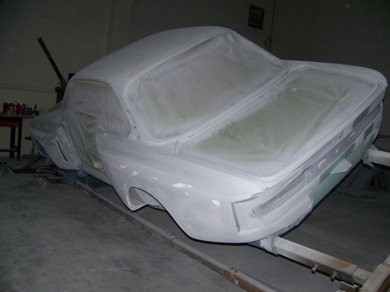

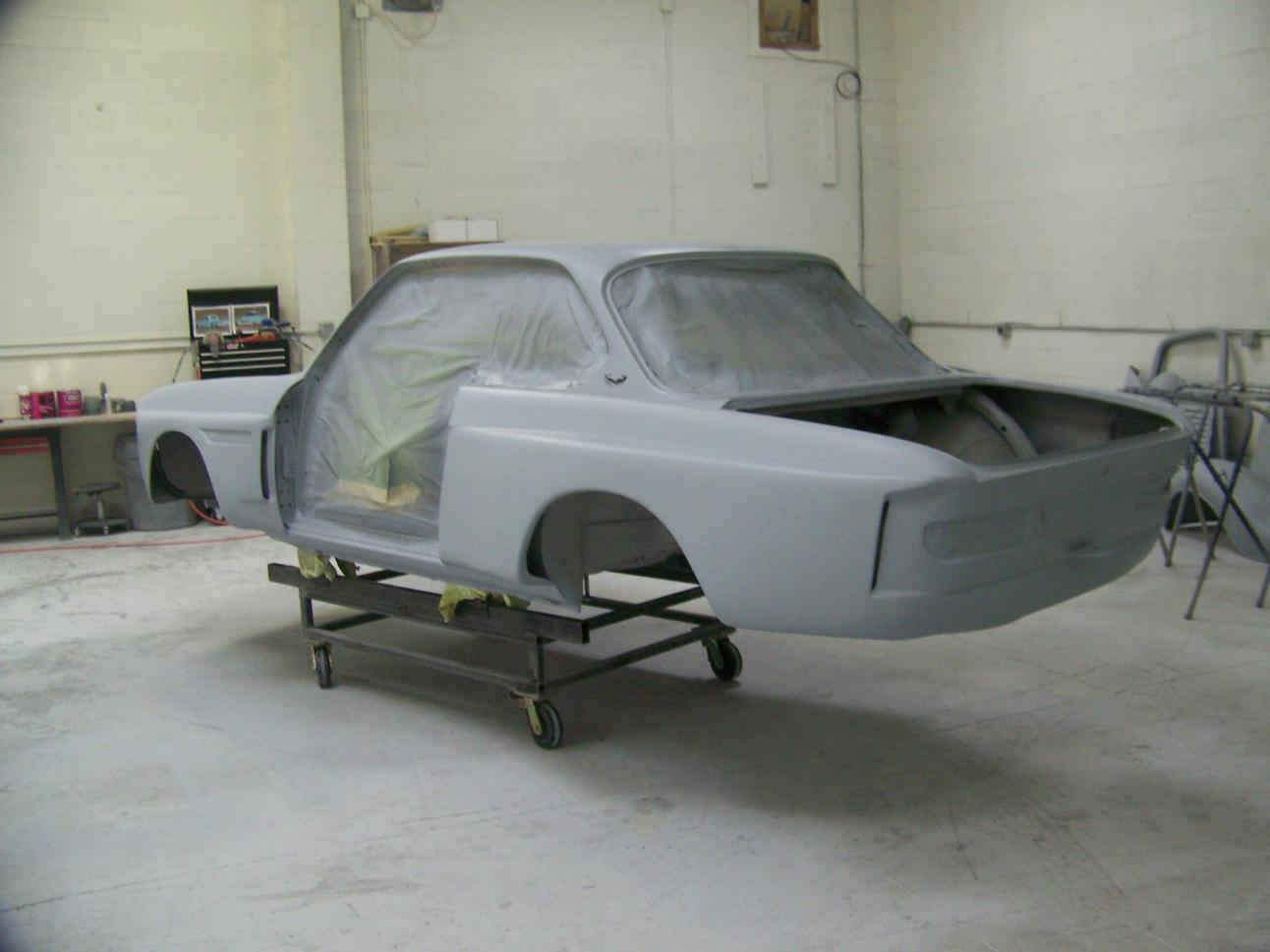

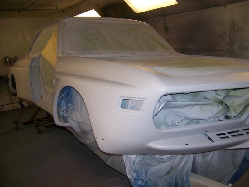

We Are In Primer!!
Body work is finally complete and the car is in primer. :-D
Here are some images of the fenders before primer, and the primer on:
Here are a couple of whole body shots of the car out of the spray booth. They have begun final sanding in preparation for shooting color. We will shoot Inka as a base with black and Alpina green highlights:

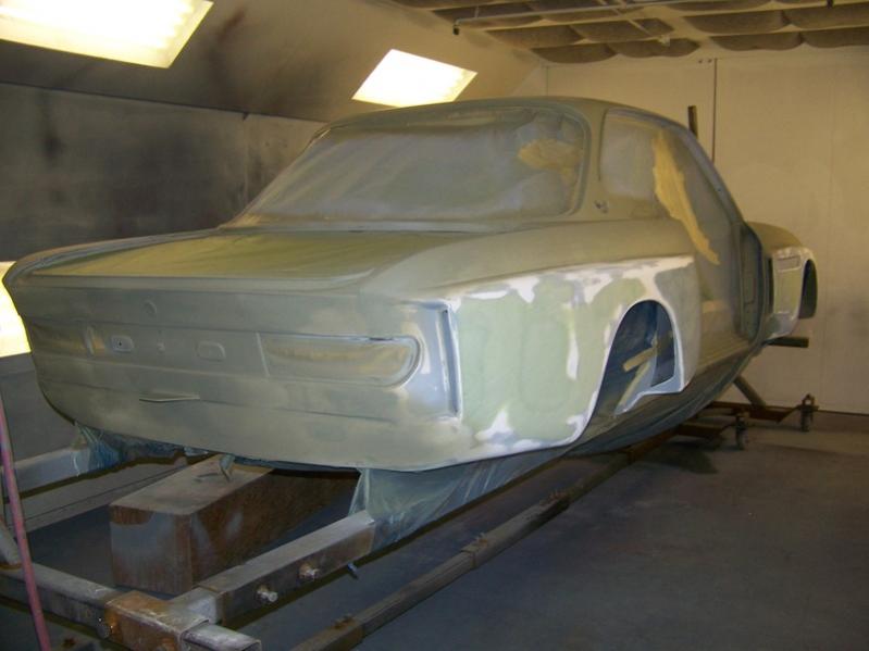

All Primered and Ready for Color
Redstone has completed shooting primer on the car. They will be block-sanding her, fitting the doors, and shooting color this week.
GMT has been busy ordering parts- wiring loom, gauges, and other miscellaneous bits and pieces. Our goal is still the Sonoma Historics the first weekend in June.
