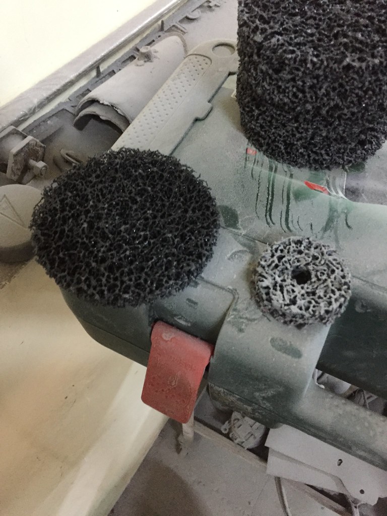

these discs make short work of the paint and the paint makes short work of them.

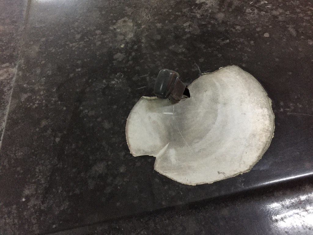

the doors and boot lid are no longer aluminium I will change them later. but the engine lid is.

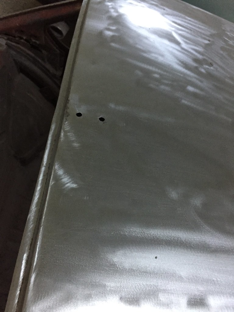

I am glad to uncover these two holes

Your doors skins are an easy fix to put them back to aluminium - but you will need a few extra aluminium re enforcements glued to the new skin by the door handle - I can send you pictures of that if you go down that route...
MM
Hi Marc
Thank you for the PM.
I do want to go back to aluminium doors so any info about those would be great.
Is the aluminium shielded from steel to prevent galvanic corrosion? I also own a classic range rover that's how I know.
