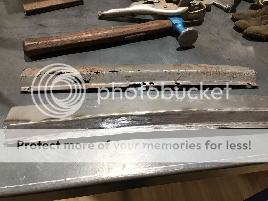

The water channel that is hidden inside the top of the rear wing was totally rotted out on the LHS, as you can see from the pictures a new section had to be made.
The curvature of the channel was going to be a problem to make as it was quite extreme so I made up a wooden buck and used that to form both halves of the channels.
These took a while as the was a large amount of shrinking required.
The 2 halves were mated up and tig welded together – all I need to do now is braze in the waste tube.
Whew, that was a lot of shrinking. You worked that like an artist with clay. It always fascinates me when metal is manipulated in such as a way as to demonstrate just how plastic steel really is. Looks great!

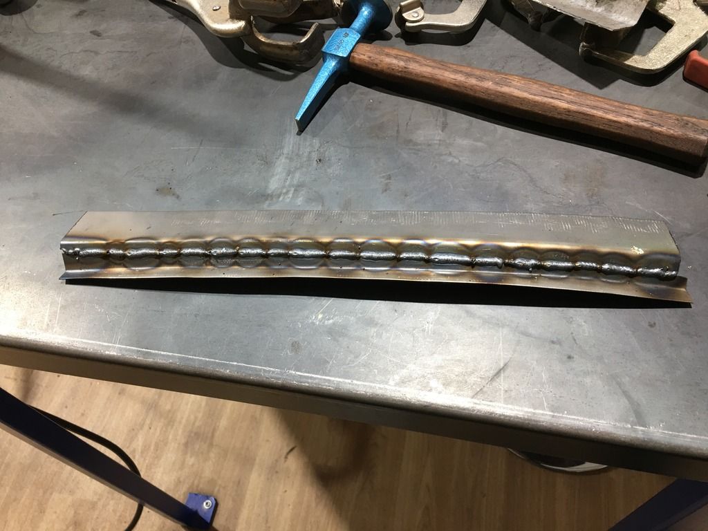

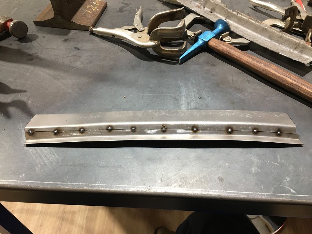

Section made up and cut a few 1mm slits into the up stand and the edge/ not the roof steel where the curve is required.
Bent the new section over the old section and griped it in place to get the correct radius and welded up the slits.
Ground off all welds
Offered it up and it was apparent that it also has curves on 2 planes!

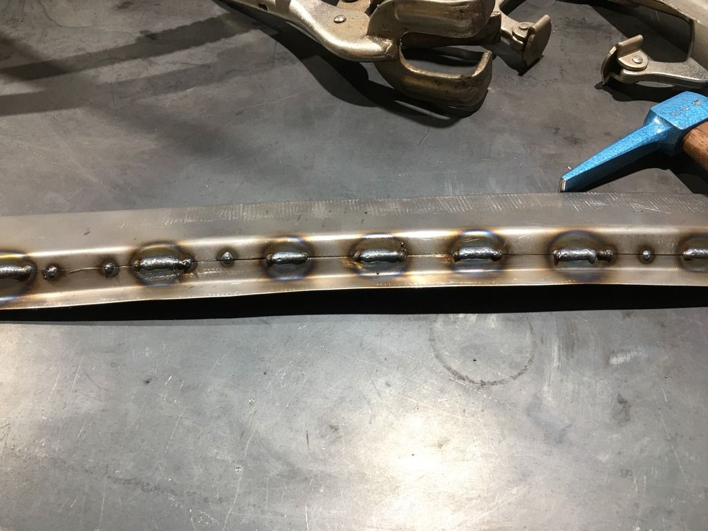

To get the correct curve / radius, the steel that was to be welded to the existing roof needed stretching – so after couple of deep, and edge stretches, the section was an exact replica of the old section.
For the eagle eyes – you will see the welds I did there are a few pin holes – will weld these up when I weld the section in….
Hi Mark,
I would shape the piece in a different way. Your dilemma is that after folding the two edges, you have a straight profile: the middle section between the two folds needs to be reshaped from straight into a bit of a "rainbow" shape. And shrinking devices usually don't offer such throat depths/space.
I would start by making a cardboard template of the middle section as it's 2 edges are sections of a very large circle. copy that middle section on steel, and add the top (roof) and bottom (gutter) flange. Cut it out. you now have a 'three-lined' rainbow. Making the folds is now more difficult (vs your approach) as you can't use a press brake and must do it by hand. Use a soft (wood or aluminium) mallet to bend the edges over a steel form. I usually take a thick bit of construction steel and give it a curve a bit smaller as the large 'rainbow ' radius, and a nice round edge (matching the car's radius) to use at a dolly. The roof flange needs to stretch a little; hammer it out or use your stretcher. The bottom gutter flange needs to crimps a little. Usually it needs a bit of both hammering and stretcher / hammer and shrinking.
Big advantage is that you don't need to shape the center section. There are also no slits to weld shut and grind flat. The radius of the inside corners remains nice as you bend it over your self made dolly. Should you cut and weld, then it's really difficult to flatten any weld blobs from the an inside radius due to restricted access for an angle grinder with flap disc.
mind you, there are probably other ways to do it, and perhaps i'm overlooking some aspects. So anyone with tips/ corrections: I'm happy to learn .

Thanks for that – its great to see how we all do things. I will give it a go!
also
I spoke to my metal shaper guru who has made body’s for Bugatti’s etc etc and he told me I was a DICK HEAD…..
And the way he would do it was as follows…..
Make a card template of the roof section to just to the edge.
When cutting out the steel out allow 10mm extra overlap where the section drops dover.
Bend over the 10mm with hammer and dolly as it on a curve
This 10mm section can then stretched and shrunk to get the desired profile.
Make another L section and because it’s a L section this can be easily stretched and shrunk to suit.
Scribe in the two sections and weld the two sections, and as its on a flat, there is less distortion- easy to grind and planish.
He says that doing it my way (slits) does not give a perfect curve on the edge of the roof- more like a 50 pence piece (English currency) it’s a coin shaped with 7 sides!
Good job I have only tacked it on!! - looks like some more work - both ways!

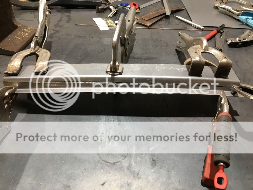

The 2 sections made and clamped onto the old section to ensure I have the correct profiles and ready to weld.
Sections made and spot welded..
Small 1 inch welds to keep distortion down - I also use my airline to blow cold air onto the weld to keep the whole sections cool
All welded up
Weld ground off and planished - offered up and it was slightly out but a little bit of work with the stretcher and all came back to how it should be...
