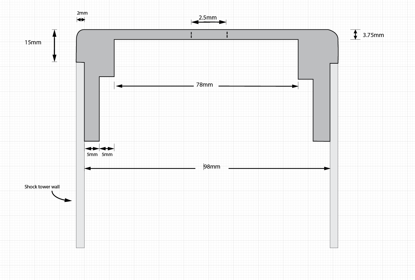

So do folks envision welding up inside the shock "tunnel" from under the car where the inside lip is (where the 5mm label is in Bmachine's drawing) or just welding around the perimeter that can be seen from the trunk? Or both?
@Stevehose described his process earlier. Post 112 shows the result. No welding from inside.

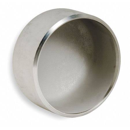

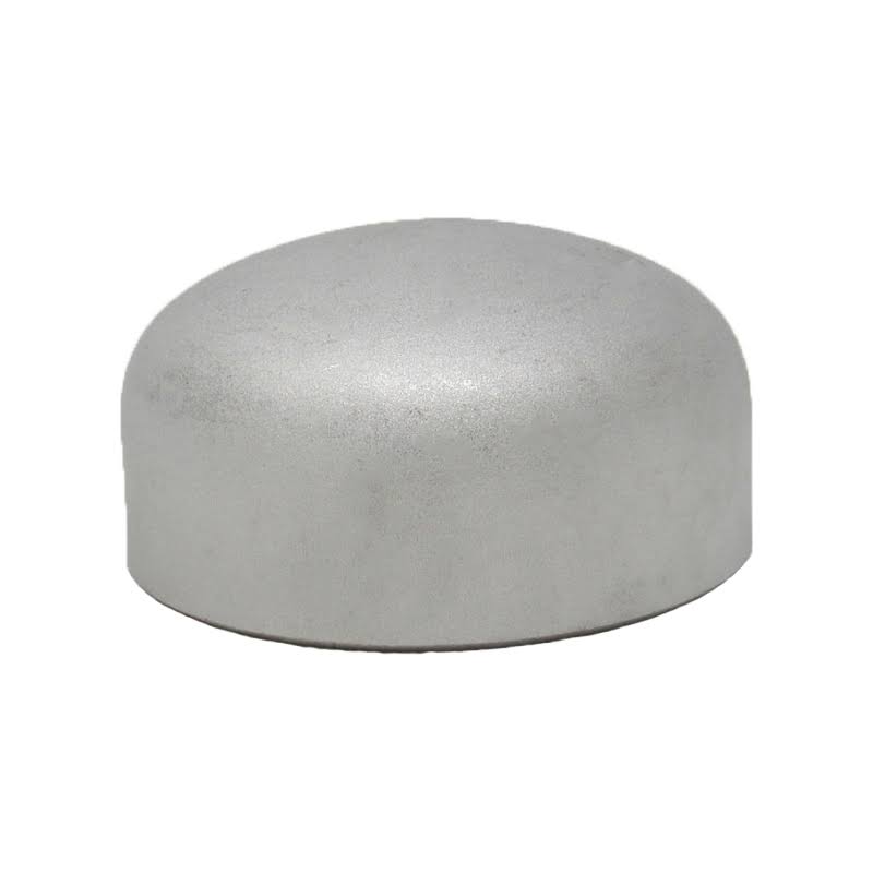

Before I build anything. I like to see what is out there. A cap doesn’t need to match the exact profile of the strut top. It just needs to touch in the center and wrap around the edges.
I don’t have my spare strut top handy, and my trunk is full of goodies. I do have my elephant skins handy, and the diameter appears to be right around 4”.
Google 4” steel pipe cap. There are many to chose from. Avoid stainless and galvanize zed for obvious reasons.
Note, some of these are stainless but I liked the profile.

I like the domed one. It's nice because that doesn't have corners to promote stress cracks and would distribute the force evenly but it could change the height of the shock top unless the existing mount is cut down a bit, which some people thought would be tricky to get right.
Getting the right diameter might be a bit of a search as well and if we're fitting this over the existing mount, would body stiffening or battery mounting struts still fit over them? Just another point to consider. But the price could be almost trivial if we find the right one.

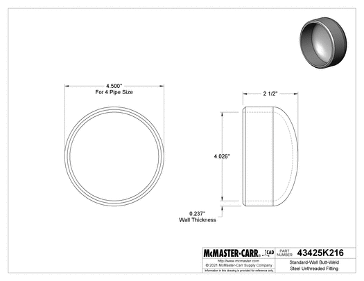

McMaster-Carr has one that's not too tall, but like the other schedule 40 pipe caps, it's got walls that are 0.237" thick, adding almost half an inch to the diameter. However the thicker mild steel it's made from will likely be strong enough to last, but as it's a pipe fitting, its ratings are meaningless in this use. It is intended to be welded in place and so has a tapered edge to facilitate that.
This one would put the shock 1.12" (28.45mm) higher unless that much was removed from the stock mount.
$40.95 plus shipping.

So the profile would be something like this:

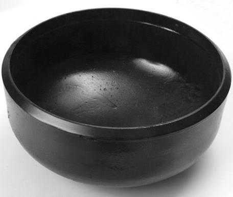

In Markos's photos the bottom or last is the one to get.....and is the one I used. It is what is called a "Slip On" welded fitting and as I said fits over the tower with about 1.5 mm clearance. The other cap is called a "Butt Weld" fitting and is designed as it says to butt up to the tower end and then weld. Obviously this can't be done due to different diameters. These fittings are forged and thus very strong. Schedule 40 is rated at 150lb. which has an operating pressure of about 1400 psi. :)

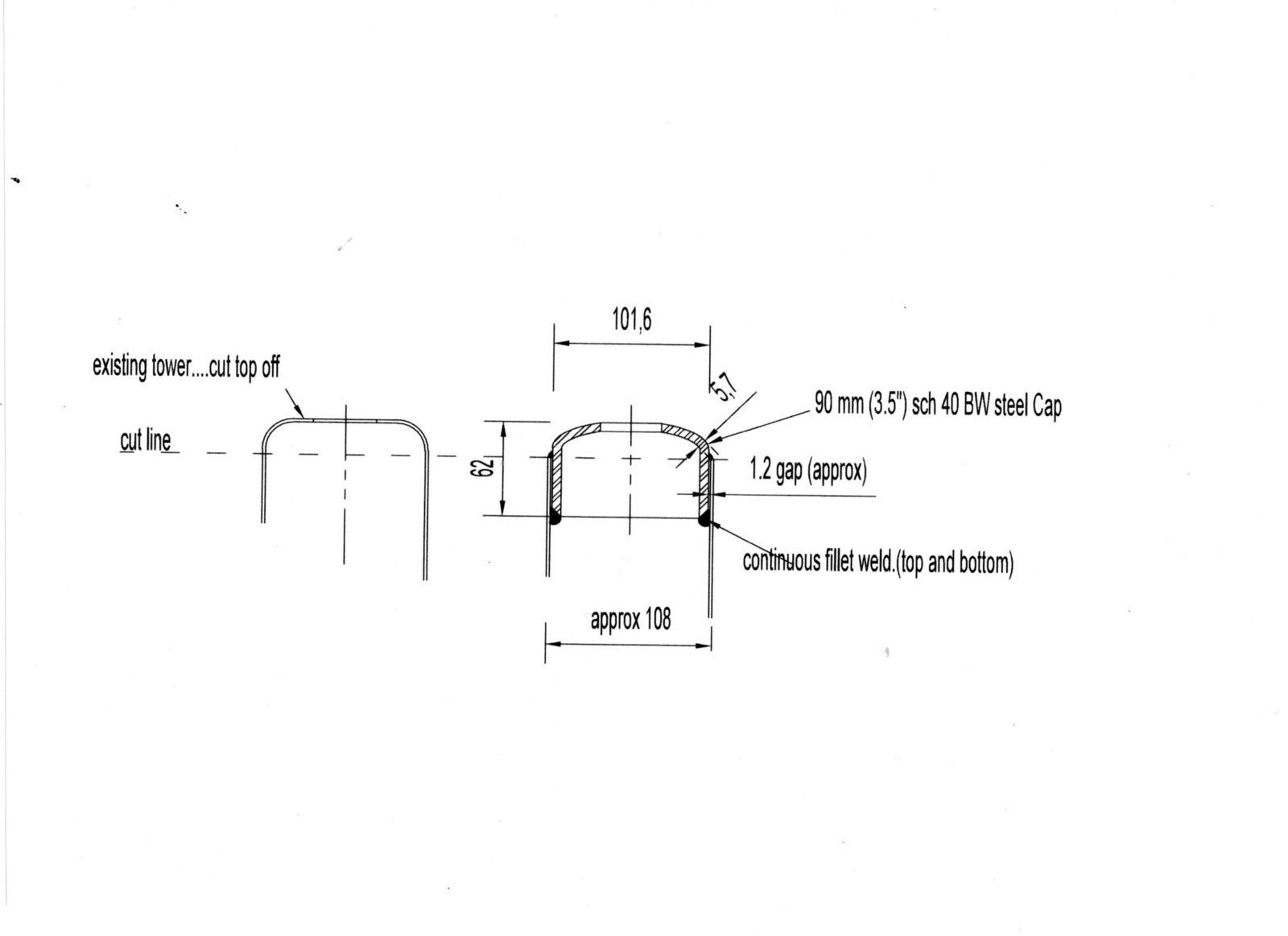

Continuing on here........attached is a sketch using a 90mm or (3 1/2" in the old world) sch 40 BW cap. welded internally. I am not sure exactly the OD of the tower I measured mine around 108mm. I would assume the material thickness would be no more than 2mm....so the cap should just slide inside.
The only mods you would have to do is cut the top of existing tower and bore or water cut a suitable size hole in top of cap to suit shock fitting. To me this seems the cheapest and neatest solution for those not wanting to do an external mod. :)

A couple of observations: earlier in the thread Stevehose mentioned that the ID on his tower was about 98 mm. If the wall thickness is 2 mm that would imply that his tower OD is 102 mm. When I measured mine it appears to be about 104 mm. And you mentioned that yours is 108 mm. It seems odd that we have three different measurements for what must have been a part that was made on the same press.
The bottom line is it looks like we cannot assume that all one size cap will fit all towers.
Also on your drawing, it looks like you need to do add fillet weld inside of the tower, from underneath of the wheel well. That will probably be very difficult to do. The plug weld solution from @Stevehose would be an easier way to do it.
