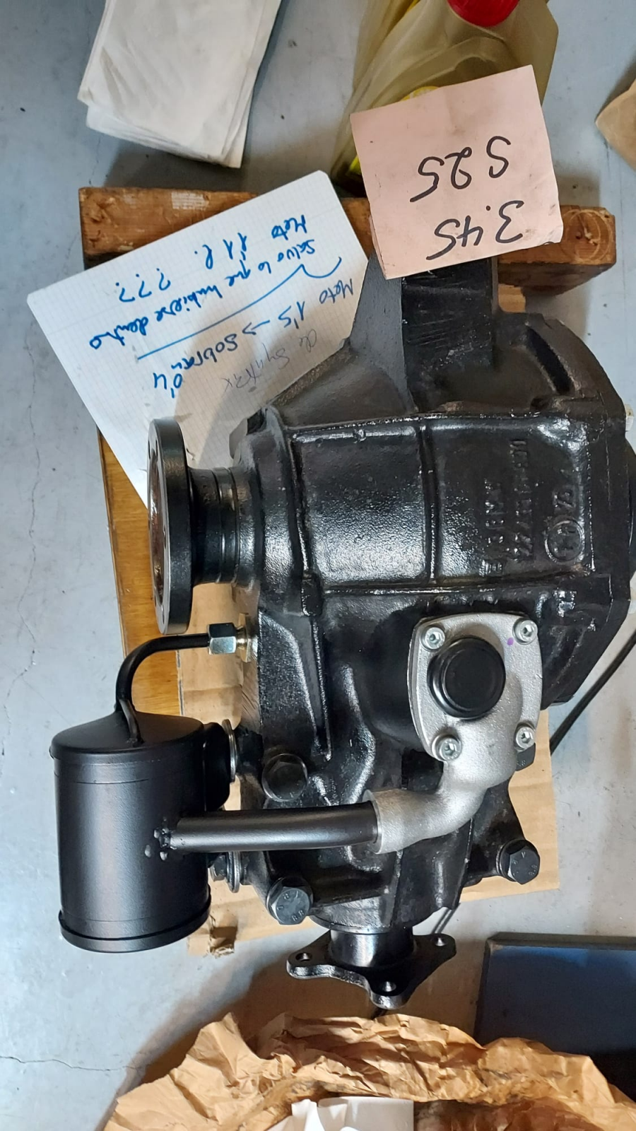

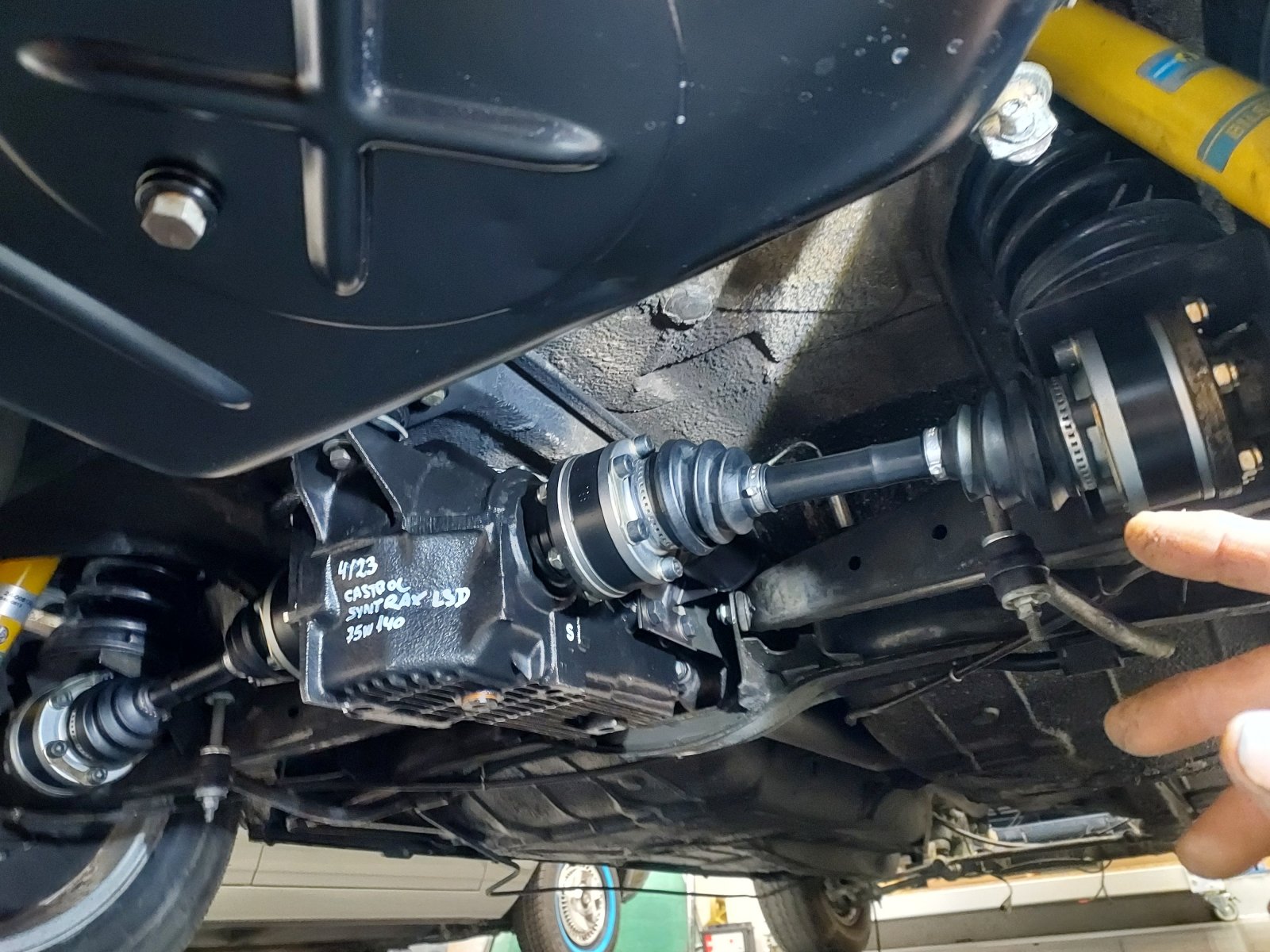

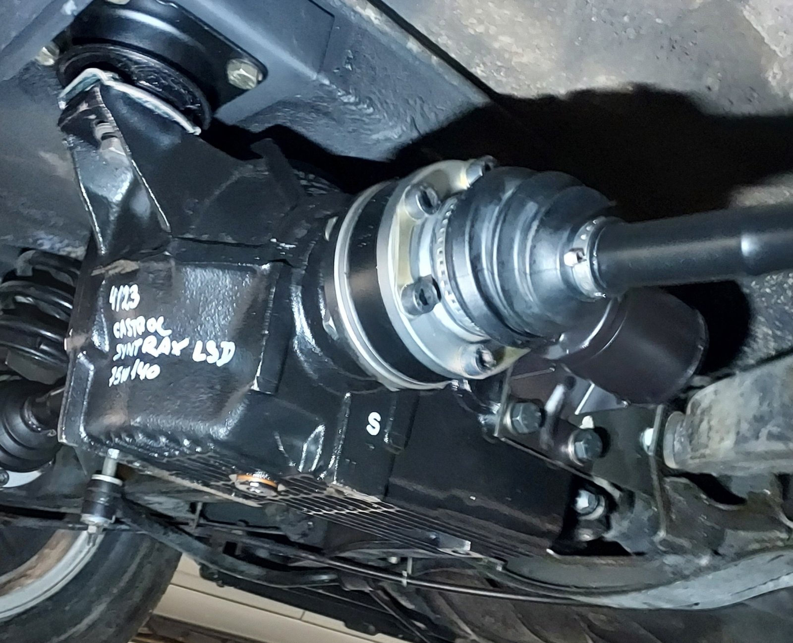

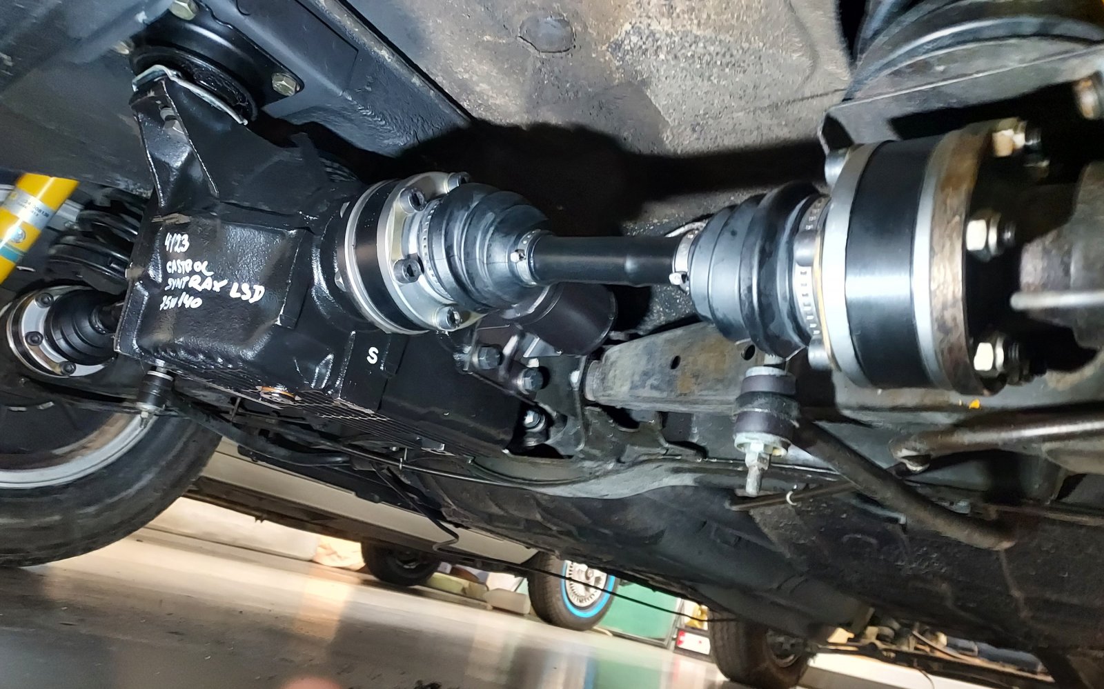

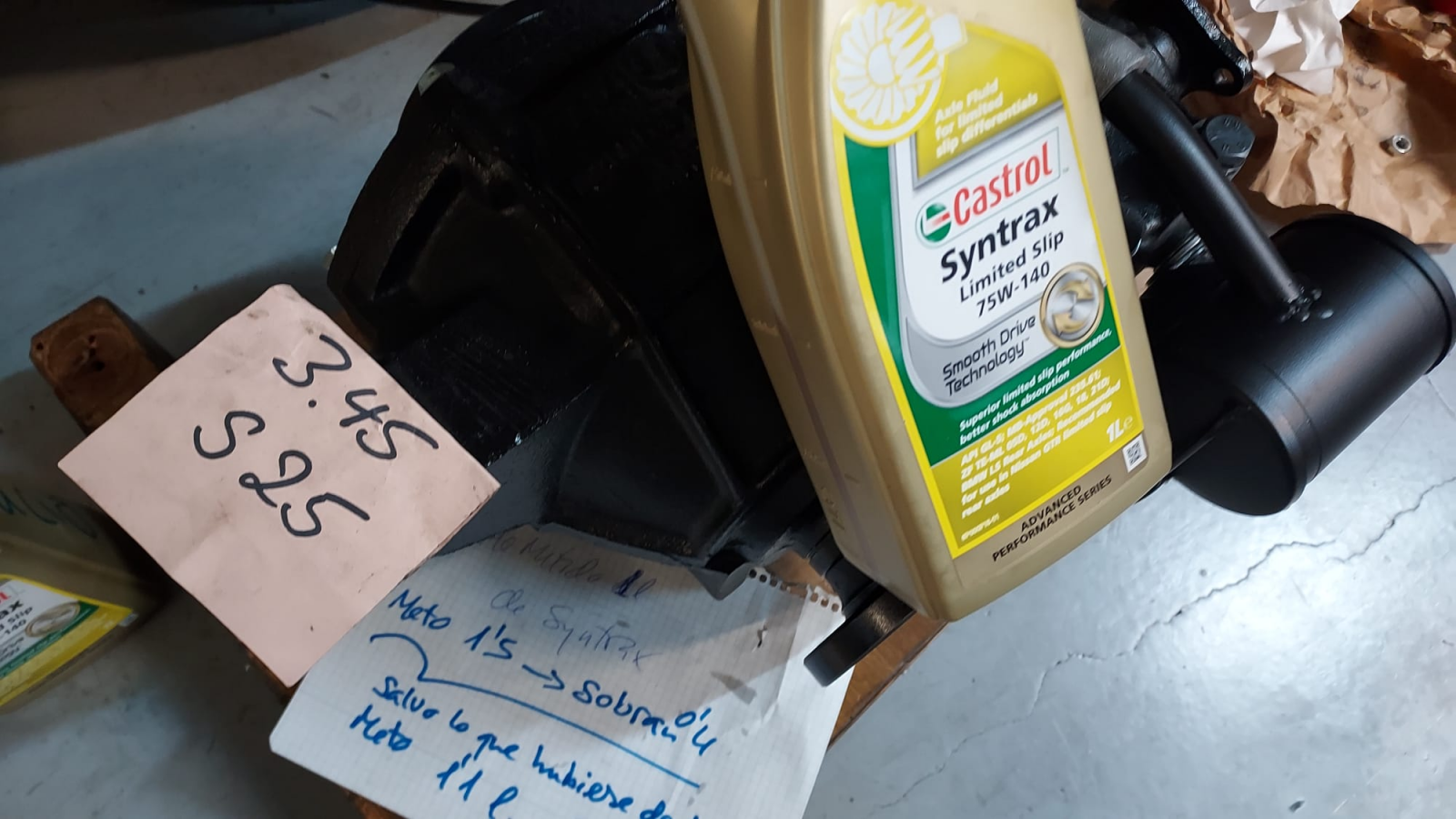

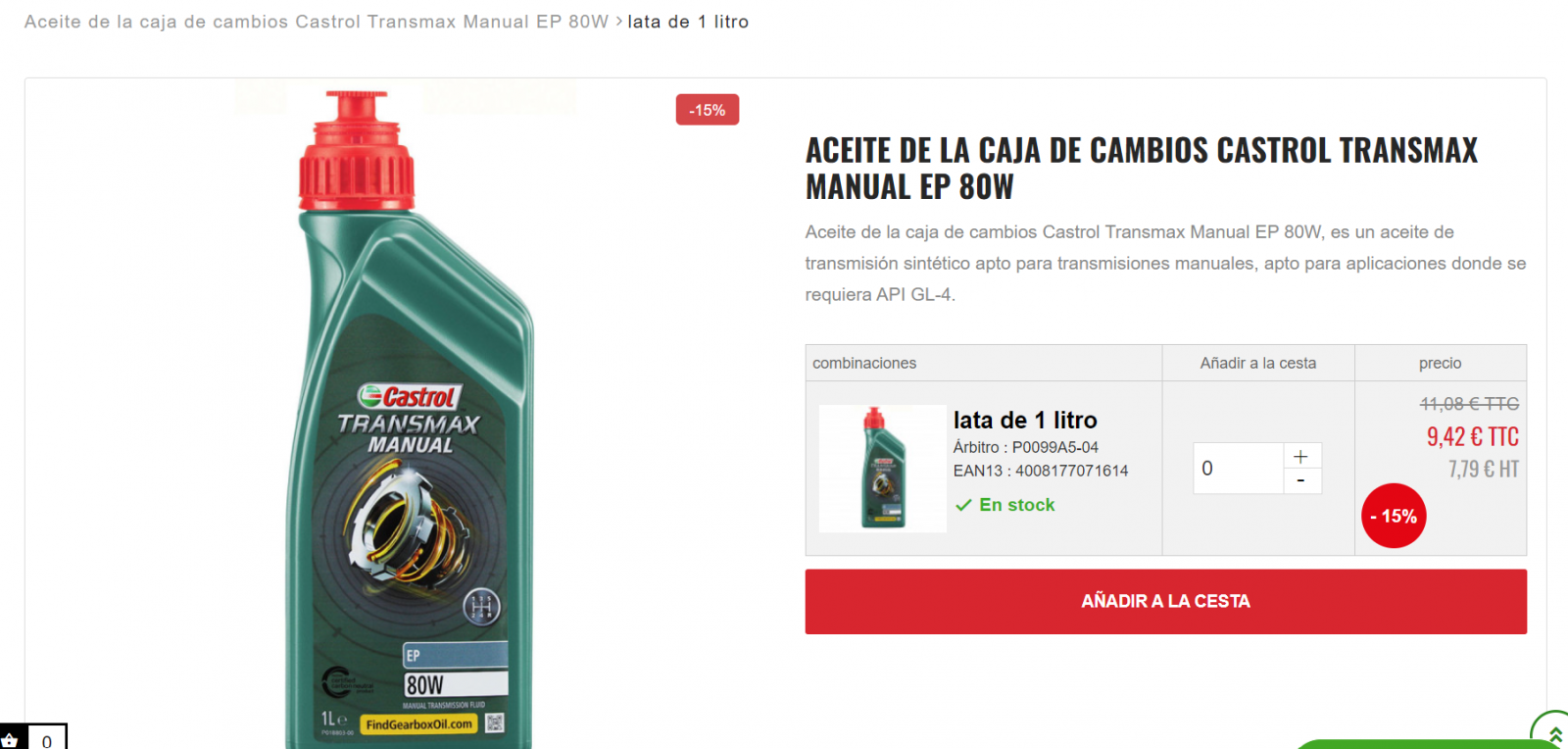

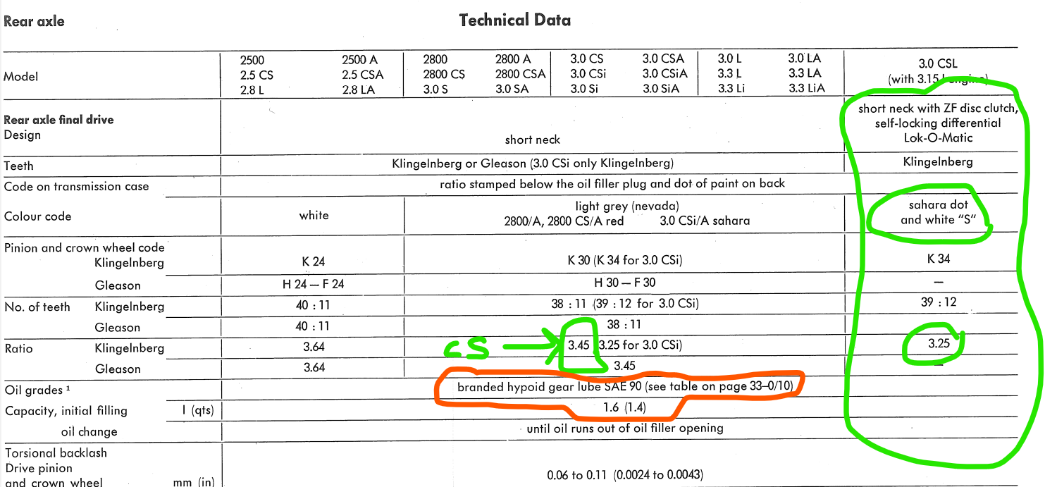

as to the Diff oil, being an LSD

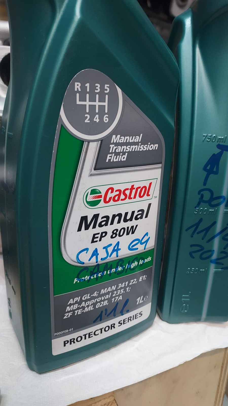

i have to check my ratio, but this is what the manual says
i can not recognize the castrol ones with their old denominations, most similar is B SAE 90, but what does that mean, no idea if GL5 or different
what i have is:
full synthetic, GL5, 75w 140

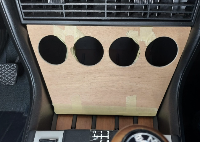

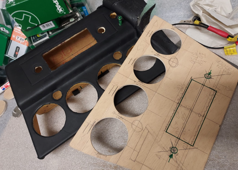

so anyone against 4watt bulbs in the instrument panel ?
any specific advice before i install it next week ?
appreciated
hello, if you want more brighter bulb with less than 2watt use led bulb that will be really bright, and there is white, red or blue and yellow color available, choose you color any color you choose it is brighter than regular bulb, and to me 4 watt is better since at night for me original 2 watt bulb I can not see a dam thing, defiantly needs brighter bulb.

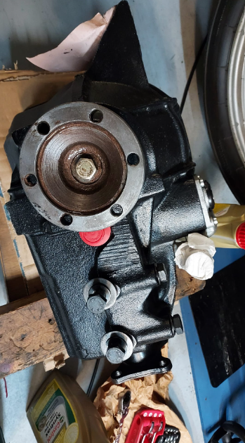

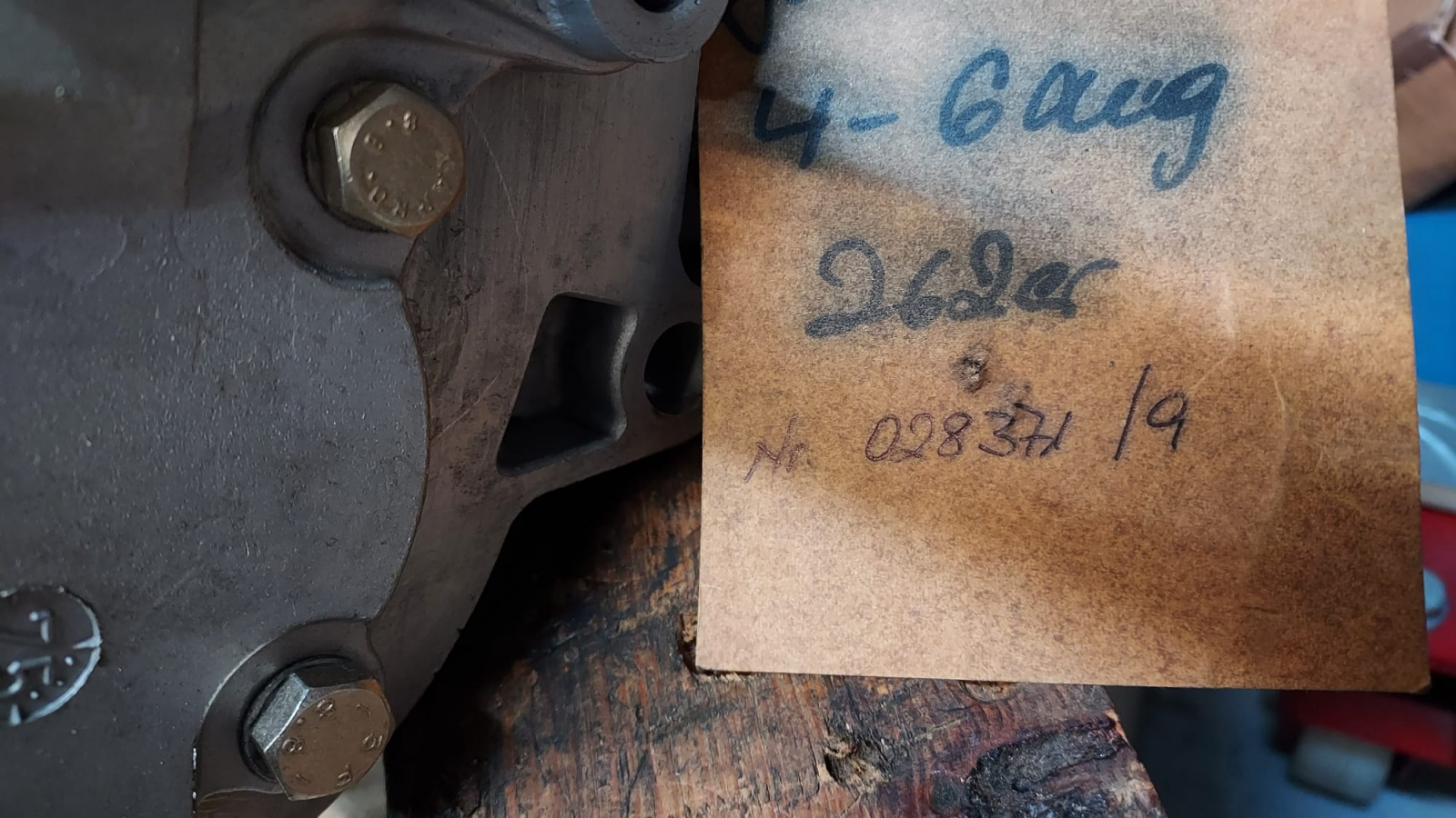

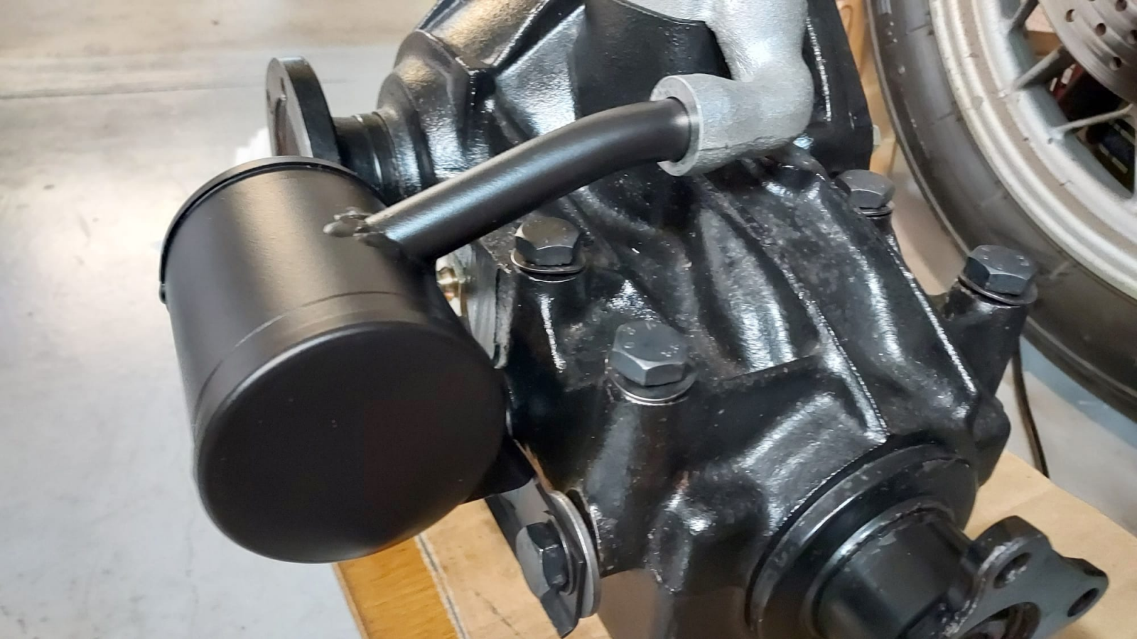

now considering the DIFF,
this is a LSD: 3:45

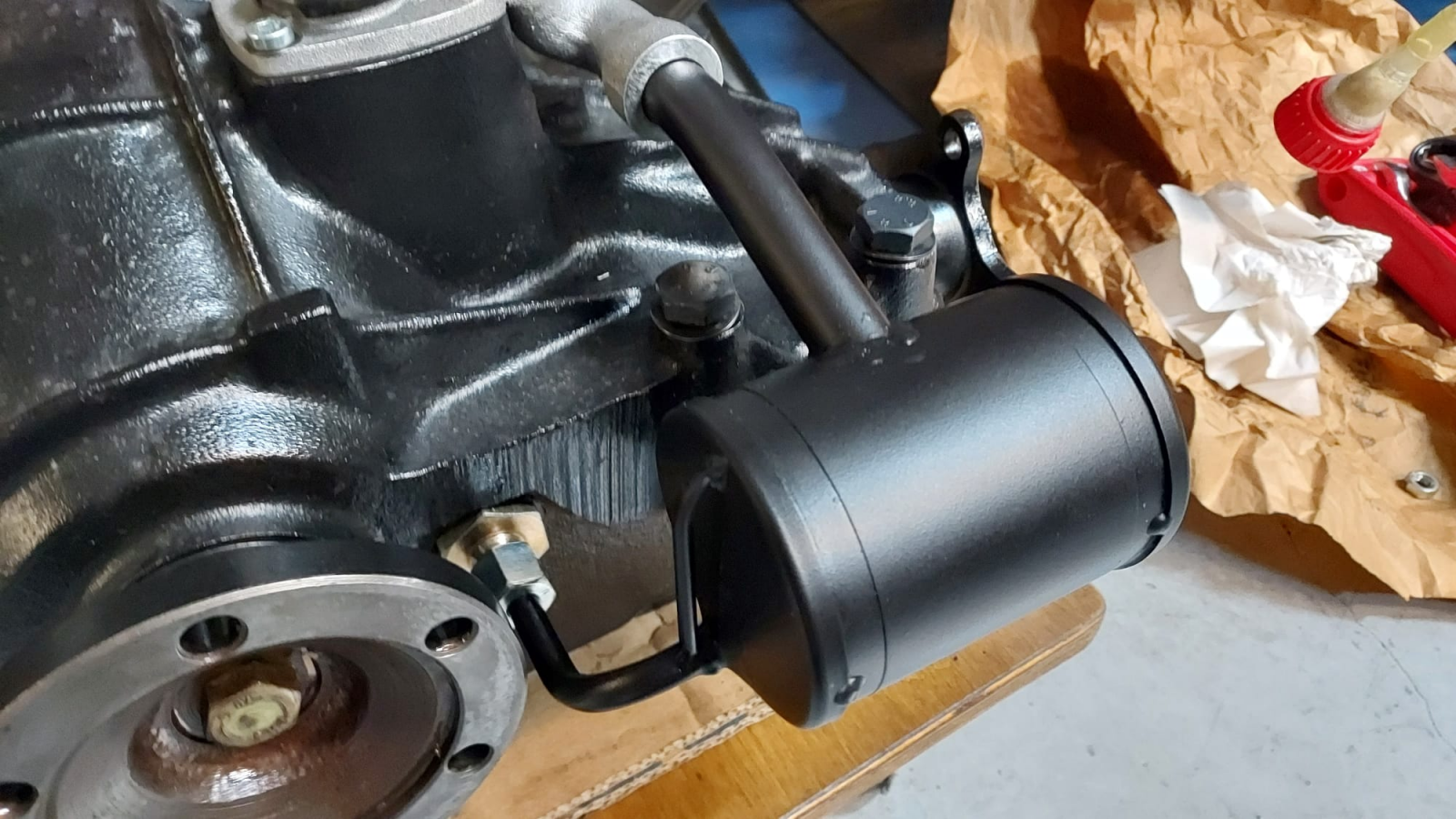

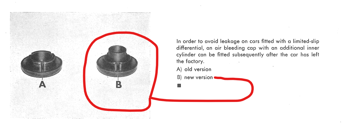

i mentioned the expansion/cooling can
i ask the question, considering the can, do i have to add more oil, or just level the oil to the refilling hole as usual ?
