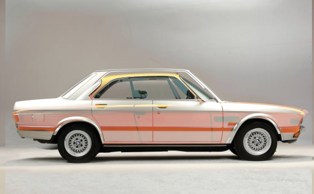

That's the one I've seen online, what a sexy machine and clearly no expense spared and yes very complicated but oh so very worth it.Look up the MKO company that crafted an e9 onto an M5, simply amazing, but also incredibly complicated.
If I remember correctly, they 3d scanned both cars to first merge them in cad before cutting up any metal.

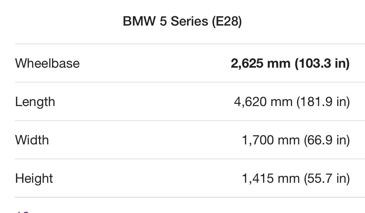

If you were to execute a “body swap” I think an e28 would be far “easier”. They both have the same wheel base. The suspension is very similar (e28 rear nearly identical to e3). They both share the M30 and Getrag 26X drivetrain.

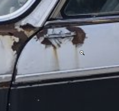

One thing that denotes it as a CSL is the rust on the door skin at the base of the left rearview mirror.
If it was a swiss CSL, then it could make sense as they were required by law to have steel doors. Otherwise not..

- "Similar" wouldn't be good enough; the donor car would need to have a wheelbase and track width that was within a couple mm of the e9's
