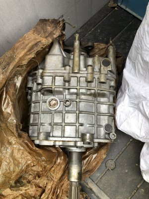

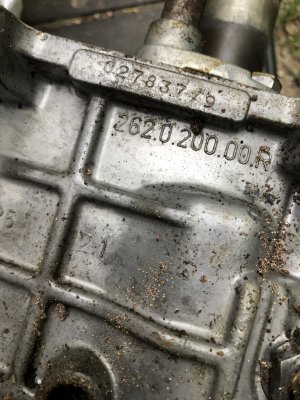

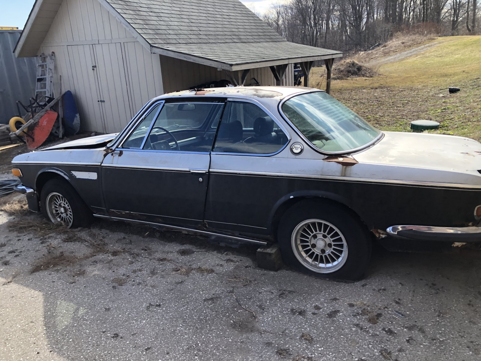

OK, here is a brain teaser. Can somebody enlighten me and give me a realistic dollar figure on what this car could realistically sell for as whole as it sits with and without the Alpina wheels or if I was to part it out what kind of money should the major parts sell for? I'm still not decided on what to do with this relic.
I saw a CSL with papers sell for 36K (GBP) a while back. This isn't a CSL and not sure what papers you have. Your wheels are desirable though. I'd of thought 10-15k AUD would pull it up as a parts car, given all of the parts need a lot of work. Price may be lower in your region as E9 parts easier to come by?

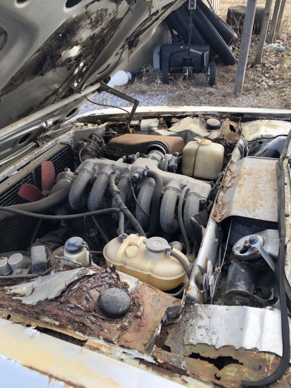

I do not see any value in the steel sheet of the car; anything can be fixed, but for a restoration to be economic, I'd personnally skip your car and purchase another body to start with if I were in the market. Which kinda means the VIN is 'dead'. For 25K you won't even have your body fixed to a rust free condition. A decent rust fix at a reputable shop will cost you >50Kusd. For 40K you buy a decent car here that looks OK from 10 feet, and actually runs and drives ok for another 5 to 10 years. (think @Belgiumbarry 's car; it runs better than most e9's, and that for under 40K!)
So what remains is engine, trans, axles, interior, vehicle trim, glass, wheels etc .
-Engine: I'm no expert at all, but I would be hesitant to put any value to it as it been sitting for quite a while: if it's seized then the main block could be dead i think, leaving you only with the old Csi components, which are quite desirable upgrade for anyone with a 2500, 2800 or carbed 3000.

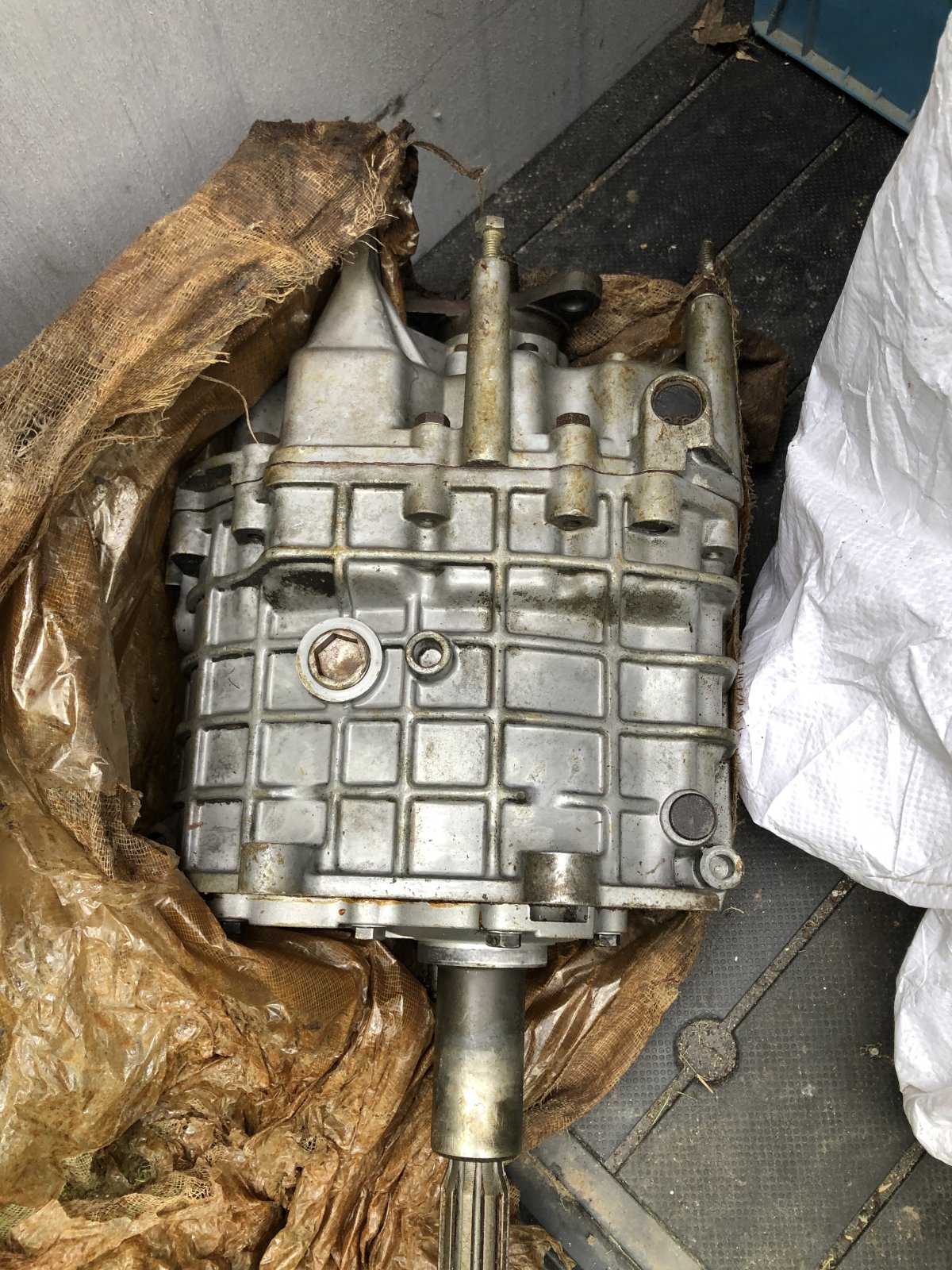

- transmission in the car: you did not tell us if's a 4 spd, 5spd or automatic. So no idea of value. The fresh one you have is a 4 speed, and would fetch between 500-1000 usd if it runs smoothly.
- axles: your rear disc brake setup is a desirable upgrade for anyone with a 2500, 2800. Most or all of it can be reconditioned usually.
- We haven't seen pics of the interior, so that makes is difficult to judge the value of that component. Could be between 500 usd for all crap parts (allowing only rigid steel /alu parts to be reused and possibly smaller plastic switches etc) to 20.000 USD for a pristine full interior: seats, doorpanels, dash, center console, headlining.
- Vehicle trim: chrome trim looks like salvageable, so does most of the anodized outside trim parts.
- glass: looks decent. Is there delamination of the front windshield? do the windows have the original 'securit' branding?
- wheels; discussed already.

trans in the car: no clue, the other one 500-1000 usd.

I think you hit the nail right on the head here, all very valid points that have all gone through my head. Sell the car as whole for ???? and have one lump sum of cash and car or endless project out of my life. Part it our and sell and ship parts all over the glove...for who knows how long...which I actually don't mind doing, but then I'll have a decaying parts car sitting around I can't do anything with other than sell parts and take forever to recoup my money.
In my mind the E9 is still one of the sexiest BMWs ever produced and I hate to see this car die, if only I could commit time and money to restorod this piece of art. Restoration is out of the question, I've done enough rust work in my life to know when to not throw good money after bad.
I make up my mind to sell the car then when I go and see it at my friends place I then can't get myself to pull the trigger because I love the car. One thing I know for sure, I will not sit on it for 18 years like the guy before me.
I actually don't know how many speeds the transmission has but since the spare is a 4 speed I assume the car is 4 speed as well.
Interior is all there but in very rough condition, Carpet it dead. Door panels are good, wood is restorable, buttons look to be good but I'm not counting on them actually working.

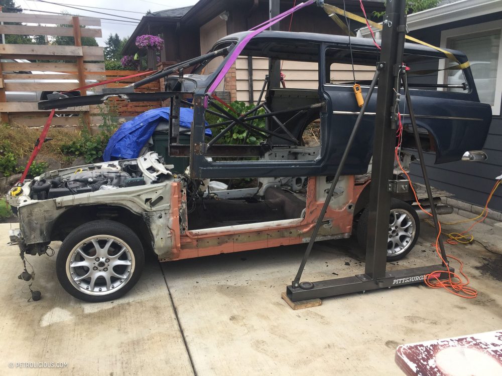

Inspiration:
you know what they say, a picture is worth a thousand words, this picture is worth many thousand words. I like how the old body is brazed and you you're using the rocker panels and door pillars. this is a great way to integrate the old body to new chassis. I still haven't sold the old girl yet in the hopes that I find the inspiration to go through with the project. Thank for the pic
