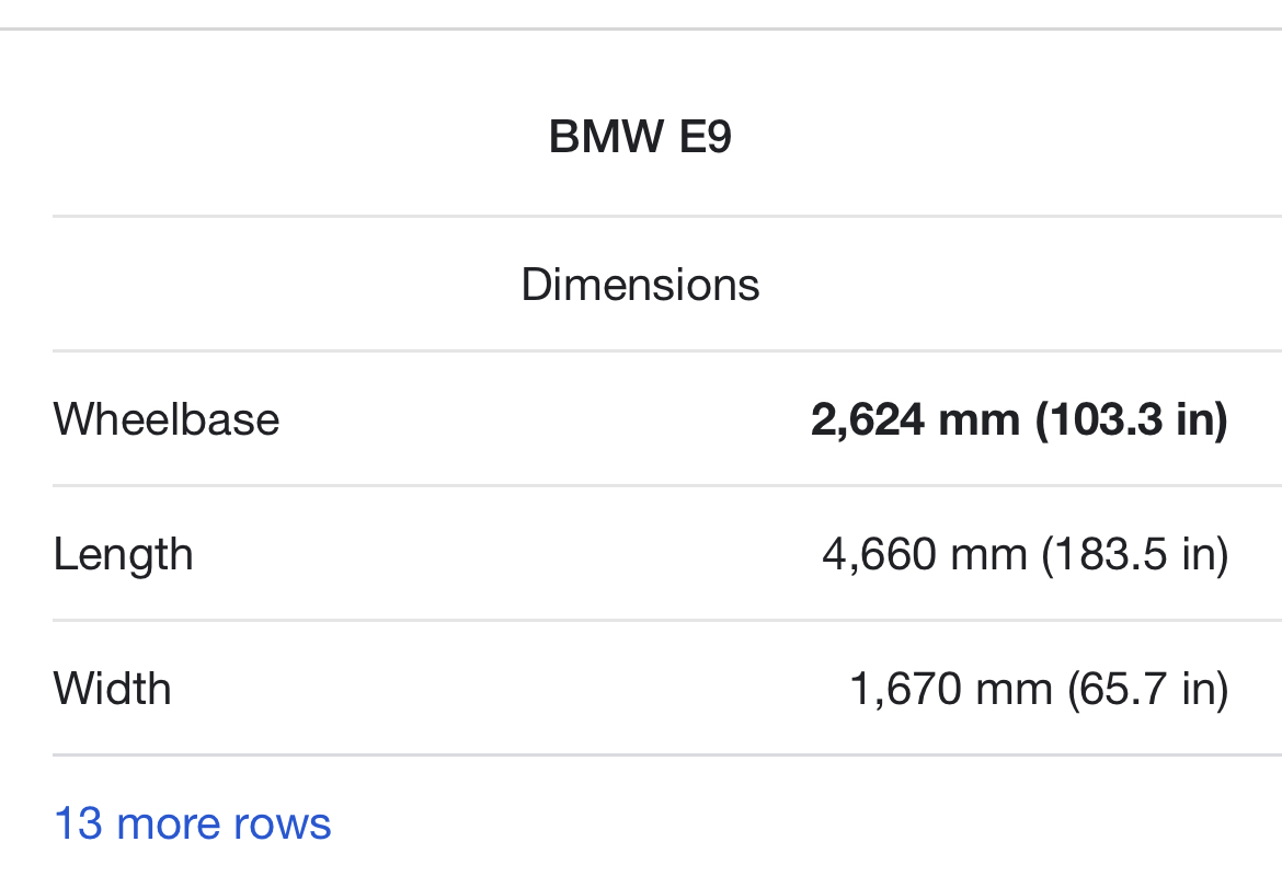

That's kind of the concept and vision I have but the execution will not be this easy, there are many know and unforeseen issues waiting for me. The first hurdle I have finding a donor car with the same wheelbase which only the e28 seems to have, which is already too old and most of them are also rusted out. At this point any BMW donor car will have to have its wheelbase shortened which is a huge undertaking on its own. I have not found a solution to this problem yet but it maybe what stops me from starting.lol

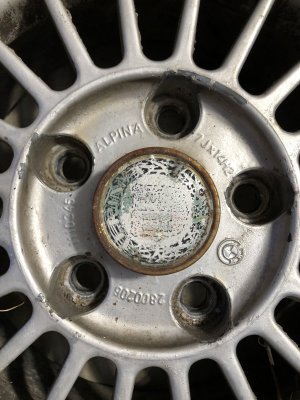

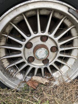

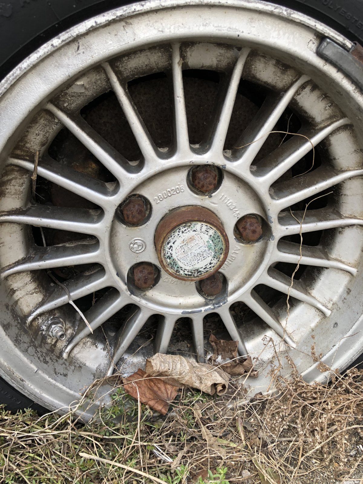

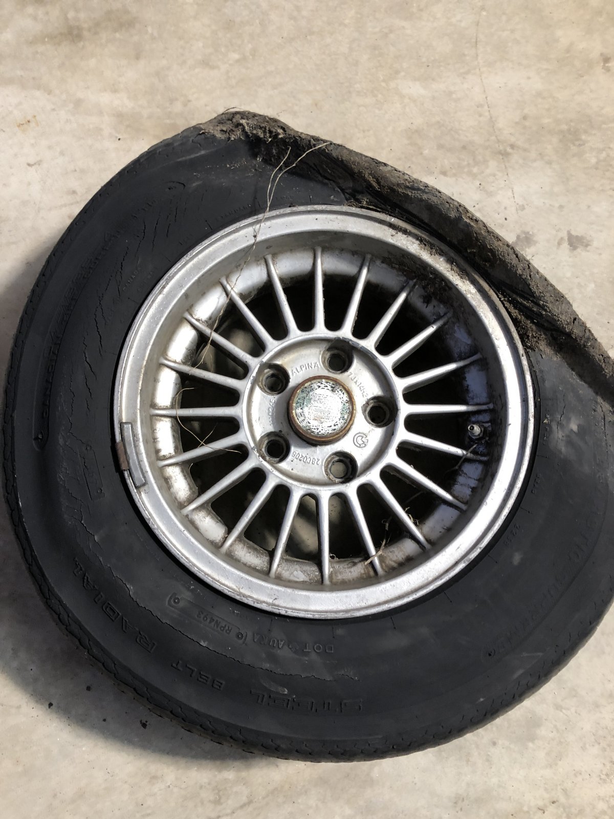

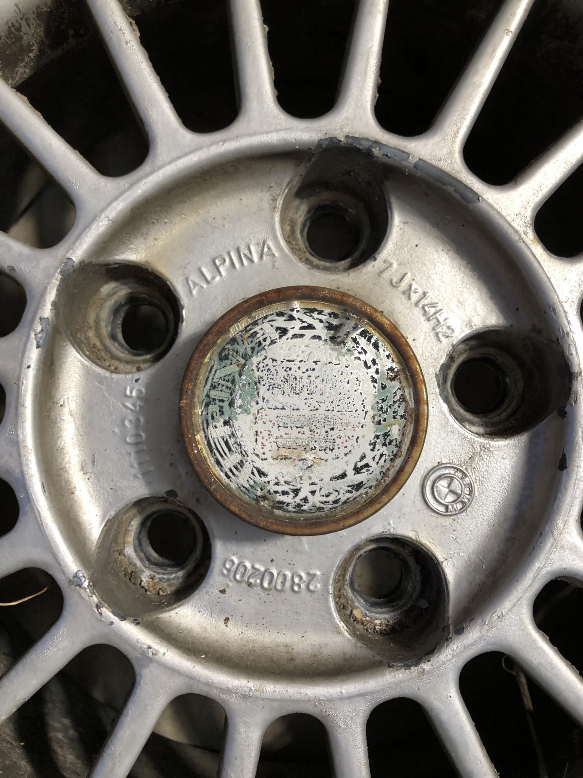

The wheels appear to be five hole CSL Alpina, worth around $2,500 in their current state. $3,500 to $4,000 restored. Looks like you have all four but pulled two to get it rolling. Post a closeup of the lug face.

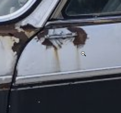

Also the headliner appears to be black (a CSL specific feature). Make sure it isn’t a CSL before you start cutting it up. Not seeing much if any rust on the door skins, which were aluminum on the CSL.

If you were to execute a “body swap” I think an e28 would be far “easier”. They both have the same wheel base. The suspension is very similar (e28 rear nearly identical to e3). They both share the M30 and Getrag 26X drivetrain.

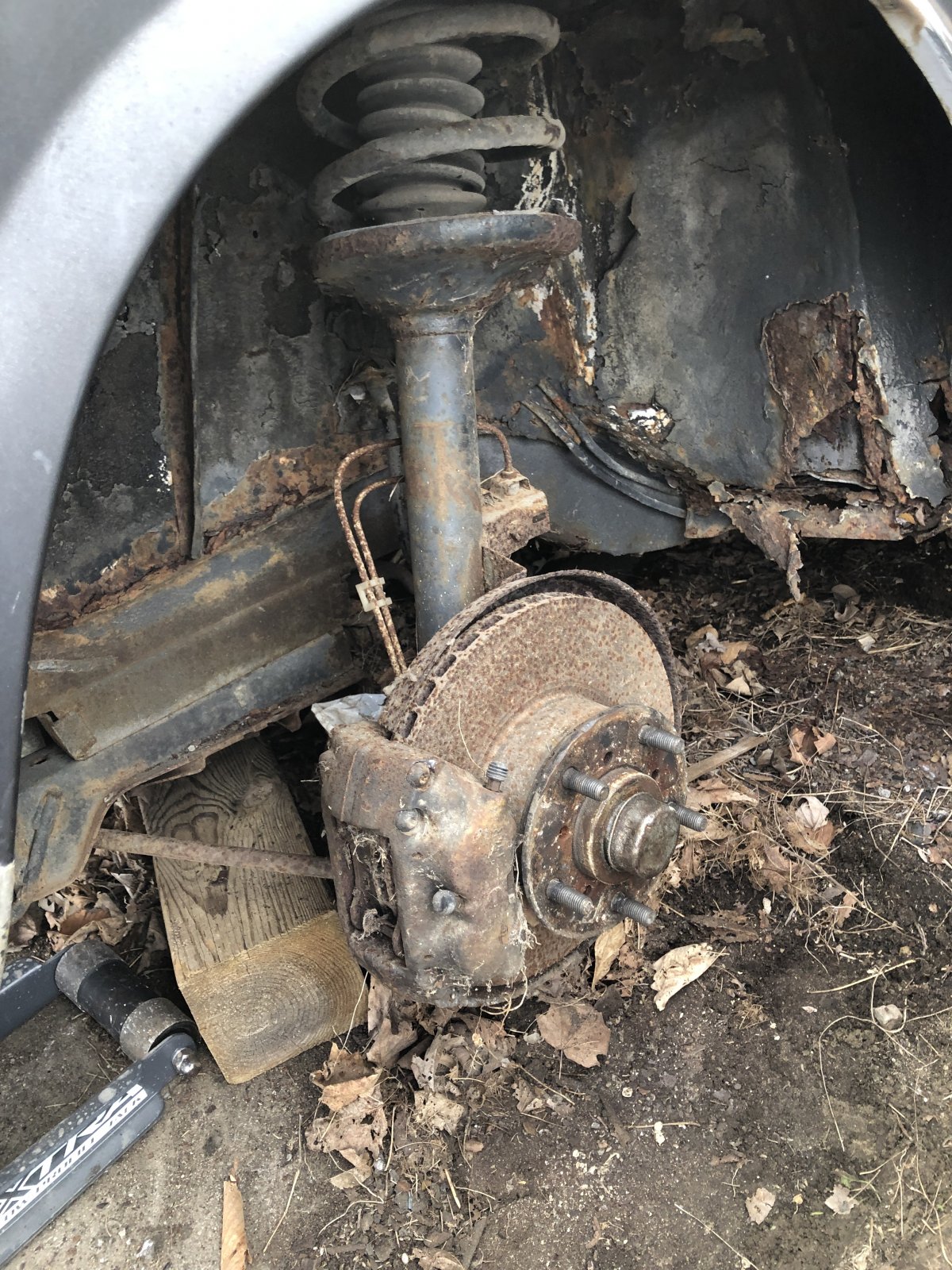

The picture of the e28 overlapping the e9 is genius, a picture tells a thousand words, thanks so much, it's much appreciated. Yes the wheels are Alpina, I can take some close up pics of the bolt pattern with the faded alpine centre caps, the wheels and front spoiler are at my house, the car is at my friends place I'll have to stop by and get see about the headliner at some point. I don't think it's a CSL but you got me all intrigued now.....imagine it was. lol Just looked at some pics I took and the drivers door has rust on the bottom.......not a CSL. what I did find interesting when I took the wheels of that the rear brake rotors are vented, was that normal back in 1972? Would the VIN on the ownership do or do I need to get it from the car?

Please check the VIN before any drastic actions are taken. And pop at least a single wheel off and check the date codes on the back of it...

You are correct, that is my post from when I first got the car earlier this year, it's been sitting outside for 18 years enduring our long and cold Canadian Winters. It is currently sitting outside at a different location with yet another winter looming, but I figure one more winter outside won't make a huge difference in the rough shape of the car. I'm approaching this possible project very carefully before I dive into a possible nightmare of a project whether I restore it or restomod it.

Take a picture of the BACK of the wheel...there will be production dates there. Just open the hood and snap a picture of the VIN plate and the stamped number on the firewall inboard of the VIN plate...also look at the title. That VIN will tell you/us everything...
fwiw: the Alpina wheel in the pic alone is of 3rd gen (German government approval number 2800206 or -208 is on it): A full set is worth more then the body in my view. Someone out there is surely to buy the set should you be in need of cash. check out the wheel FAQ for more info.

Others have picked up on a few things that seem to point that way but has anybody also noticed that the fuel lid has peeled and it looks like it's made of alloy....
I love your optimism, maybe I'll just let that brew for a while and dream that I am actually sitting on a CSL.....lol
yup, all fuel caps are cast aluminum.
One thing that denotes it as a CSL is the rust on the door skin at the base of the left rearview mirror.
If it was a swiss CSL, then it could make sense as they were required by law to have steel doors. Otherwise not..
