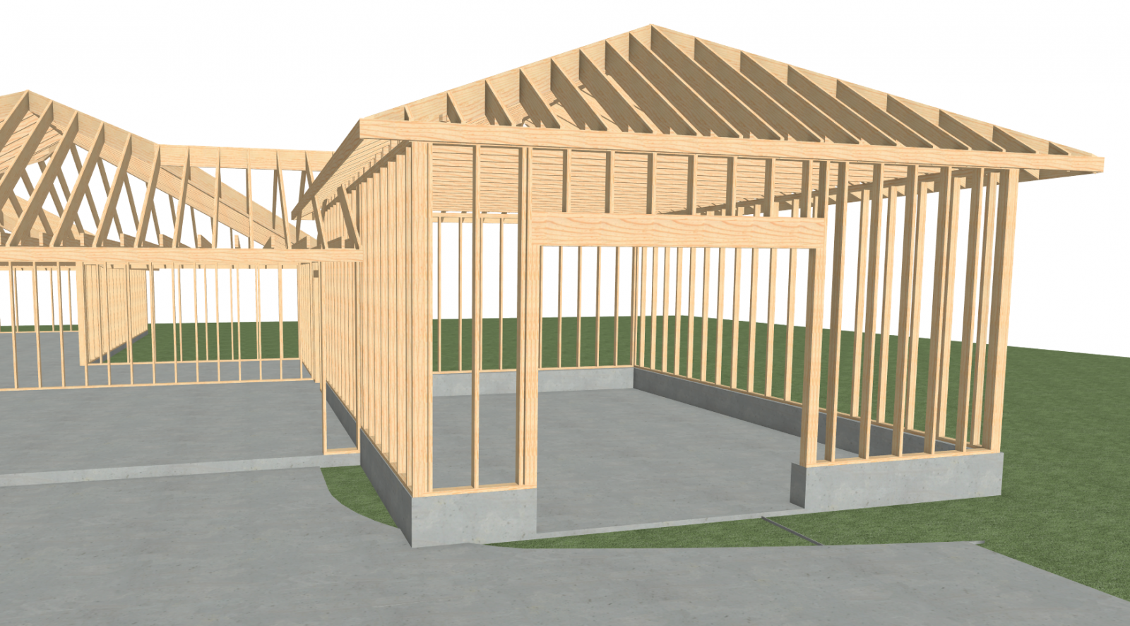

I've maxed out the size of the garage for what's allowable by the Mrs. re backyard space and the setback from the property line on our wedge-shaped lot. Looking at the cost of permitting, I've actually taken a few inches off the length and width to reduce the square footage from 506 square feet to 499 since the city construction permits are charged in increments of 100 square feet. I've got 11-foot ceilings planned to get more vertical space though my Max Jax lift won't need all of that. I used it successfully in Austin with a 9-foot ceiling but it was tight.
A split AC unit is in the plans, it does get hot and humid here for a moment or two. Fortunately, the new garage will be on the north side of the house with an east-facing door that will be insulated. My Austin garage had a west-facing door and the previous owners put in a glass and aluminum garage door.
Can you say "Greenhouse"? Sure, I knew you could. And sunlight reflecting off the driveway into the house added to the load. This resulted in afternoon temps 25+ degrees above ambient and on 110° days, that's not a good environment for working or storage. I erected a large Galvalume-coated steel carport that shaded the west side of the house and most of the garage door which brought down the temps significantly. It was a lot of work (There are 10 massive footings through the driveway to keep it from sailing away in a storm. Each one of those white bags holds a ton of soil, yet to be moved behind the fence in the backyard.) and a $12K investment, but we got that back in spades when we sold.
I'm not sure Jacksonville would allow such a large surface area in a hurricane zone. Certainly, the insurance company would charge a premium for it. We get a discount for having an all-hip roof here.
Garage is likely going to feel huge! My new e9 garage is only about 275sf. It’s enough to restore the car, but will be tight. All that garage length will allow you to easily toy with the motor and stage parts while the car is on the lift.

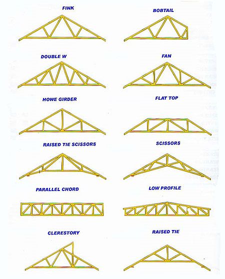

Another option for the ceiling would be to use raised tie trusses (if you aren’t stick framing the roof).
Mini split sounds like a great addition after you complete your final inspection. .D
I know that when you take cars apart the space needed expands by about 3X so I'm sure the garage won't feel like it's big for long. I also hope to use the space as a photo shooting space after the dust settles on fixing the car. I have so many boxes of parts taking up space now.
I debated about the ceiling structure quite a bit. I thought of doing a vaulted ceiling, or maybe using trusses, but two things, well three things pointed away from that.
First, the current location for the main heat pump compressor for the house is right in the middle of the new garage bay wall so it will have to be relocated to the far side of the garage slab. Before the garage is built. I was thinking I could run the power and refrigerant lines under the slab, but an AC guy said that wasn't a good idea. So that leaves running them up the wall and then through the attic and down the other wall to the unit. So a raised ceiling would make that trickier. I'm thinking I'll have to build a boxed channel where the walls and ceiling will be, move the unit, and then pour the foundation and build the garage. Easy Peasy? Hmm, maybe.
Second, I was thinking of making the ceiling beefy enough to be able to handle pulling an engine with a hoist. I've got a nice section of I-Beam that a chain hoist could run on, but that adds further to the weight to be supported. Can trusses handle such a concentrated load? Five hundred pounds for a full dress motor with trans attached? I haven't had an appointment with a structural engineer yet to address that question.
Third, I've read different things about possible delays in getting trusses made and the possibility that they may actually cost more than stick building a roof. Now that timber costs have fallen to almost pre-pandemic levels and building demand has slowed somewhat, maybe that's not as big a concern. I wasn't going to store anything in the attic, so that's not a factor in the decision.
I've been thinking of installing a split unit after final inspections partially to avoid the required Manual J (heat load) calculations and making it one less thing to wrap my head around. I could simply run some conduit to a box on the wall from the breaker box, that might be a good way to avoid dealing with the insulation for a later installation.
