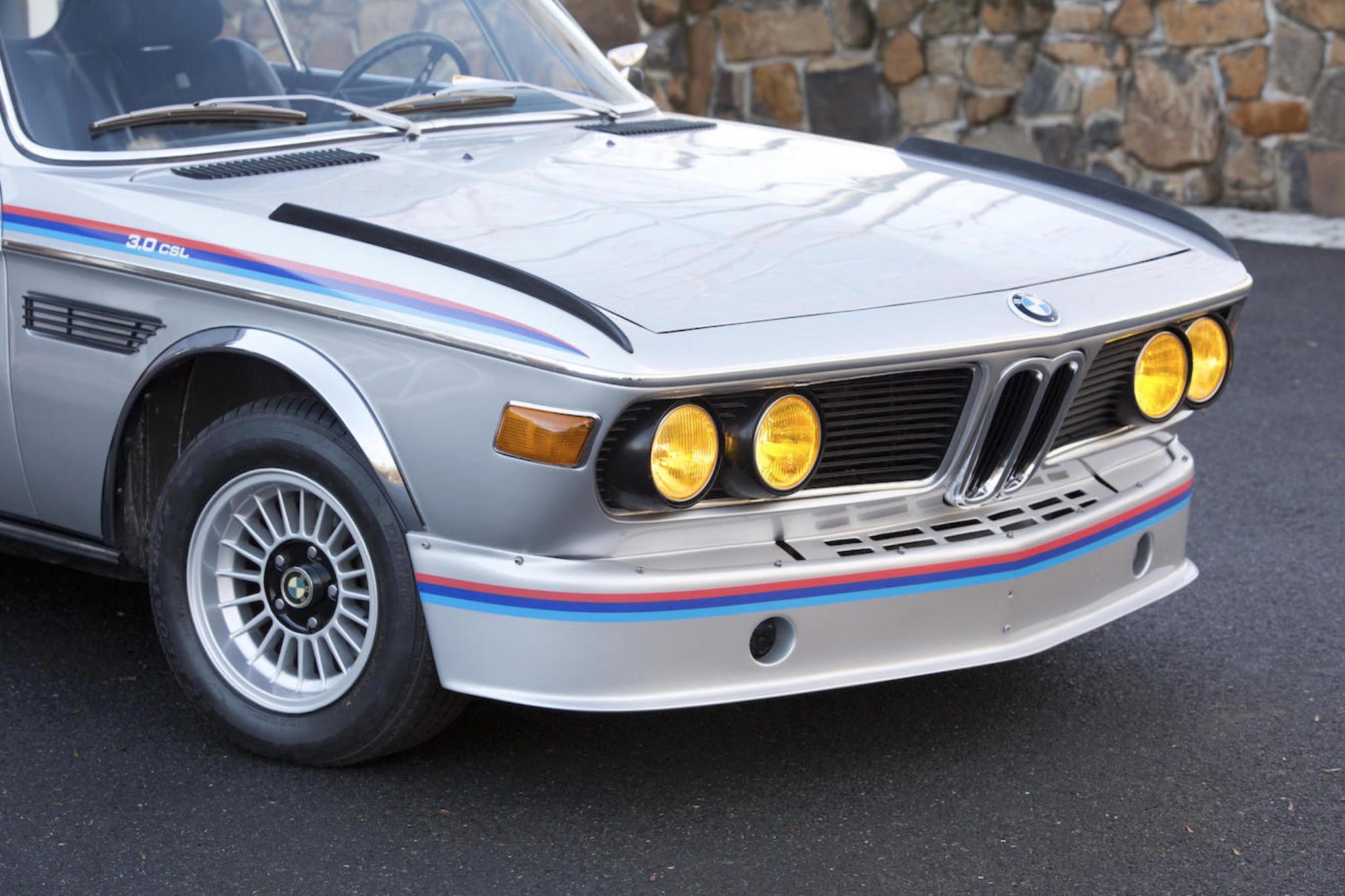

Nice update! Your bumpers look great. I assume that they are just throwing some primer on to avoid surface rust as they clearly stated that more work needs to be done. What what is the plan on the euro bumper conversion? The front bumper and rear mounts looks quite a bit different on a US 1974 with bumpers compared to that of previous years. Given the visible grinding and cleaning up front it looks like they intend to address the holes. The same goes for the big holes int he back. The holes will be especially visible up front if you go sans bumper.
I believe the intent to do the bumpers properly but I am not sure if they understand all the nuances so please educate me so that I can let them know. In terms of primer etc. I also assume they know their business when I comes to painting or at least I hope so. There is some thought to not putting on the front bumper but covering the holes properly and perhaps putting it on at a later date. I think he looks so much better without it. Don’t you?

I will snap some photos of the front bumper slot measurements this weekend. Once posted, perhaps someone else can provide verification.
Don't fill up the front bumper holes. You NEVER know that one day you may need to sell the car and I think 90% of E9 prospective buyers prefer a front bumper (I know I do).
For the record, my recommendation is to fill the US 1974 portion of the bumper holes and reproduce the narrow bumper slot that we are all used to. If you look at Scott's front end, there big holes for the 1974 bumper shocks.
I can tell you unequivocally as between bumper or no bumper I personally prefer no bumper but not by a large margin. I intend to hold the car for the rest of my life so I should do something that appeals most to me I suspect. It’s not finally determined. I suppose that even if I take the bumper off and cover the holes that at a later date for some money we could revert back
