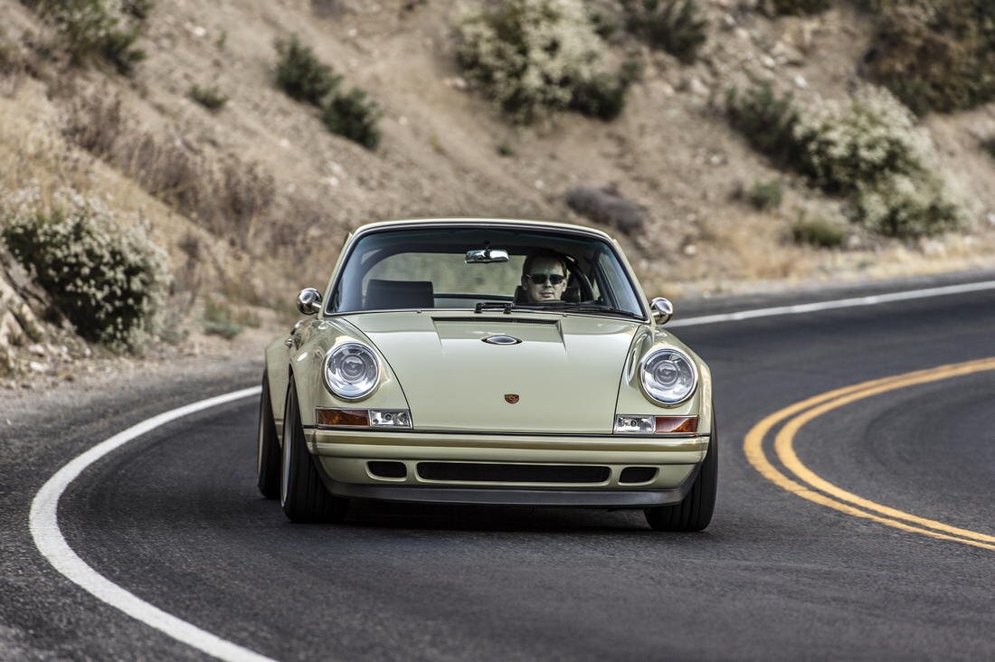

At the risk of going in a completely different direction, I do LOVE the look of this http://singervehicledesign.com/works/ which seems oddly period correct in a way while looking much cooler. From Singer's page:
  • The primary lighting is radically updated using state of the art Hella Bi-Xenon headlight units developed for the P1 Prototype race cars, these have been incorporated into newly developed headlight housings.
  • Lightweight polycarbonate clear headlight lenses replace the original glass items.
Thoughts?
Thoughts?
Oh no you didn’t just send HID retrofits to THE Daniel Stern. Never mind that they are oem on a $600K carbon fiber Porsche. Daniel knows best. ;)
If you really like that look, perhaps go with OEM ellipsiod lenses. A few members have converted, or considered it anyway. I believe that @nosmonkey was working on a set.
That's a much larger diameter setup that will not come close
to fitting on your car. It's also got some fairly serious
technical problems not worth going into detail on unless
you're curious, because this setup only fits certain
Porsches. There are similar, properly-engineered lamps that
fit applications requiring a 7" round lamp (such as a BMW
2002) but not for the smaller 5-3/4" round size your car takes.
