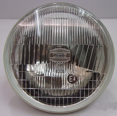

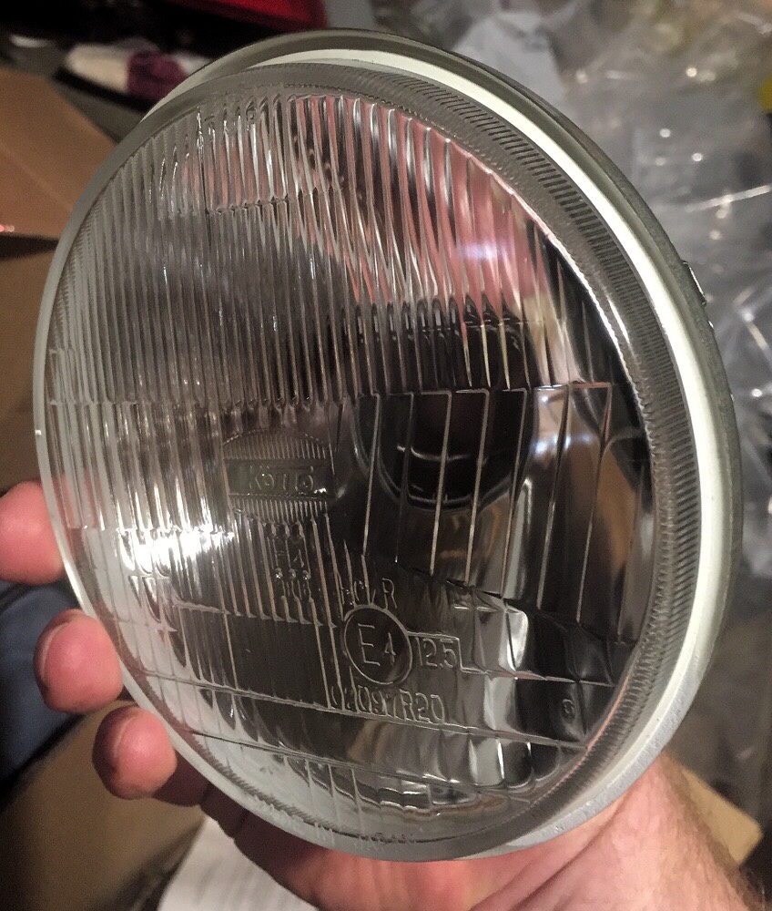

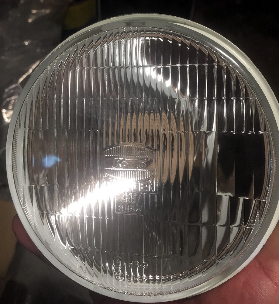

I just talked with Daniel. That guy knows his shit. He was very helpful. Based on the fact I don’t drive terribly much at night and I’m not a slave to keeping things all German or original he recommended this late. He said it is kind of cool because it is flat and is much more efficient and what it does with the light. He claims to be one of the few distributors for this brand in the United States and offer some slightly less than MSRP
Thoughts?
Koito low kbsl14
high kbsl16
$316
$78 for bulbs

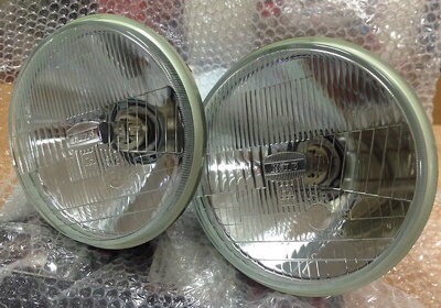

Scott, checked my invoices from VSR who did the headlamp conversion in 2014. Mine are Hella H4 Low with City Light and H1 High. Unfortunately there are no part numbers.
Believe mine were purchased at rallylights.com
City Light Low: http://www.rallylights.com/hella-5-3-4-round-h4-e-code-headlamp-with-city-light-hl66021.html
H1 High: http://www.rallylights.com/hella-5-3-4-round-h1-high-beam-headlamp-ece-each-hl71157.html
Hope this info is helpful and doesn't create more confusion.
Much cheaper and they look fine to me. They say they are only for off-road in competition use in the description. Is that correct? I like the flat portion of the lights he suggested but think it might look completely out of place. Do you agree?
