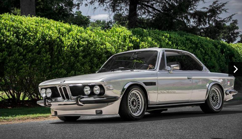

Prefer front bumper. This is Duane Sword's coupe which has the Alpina style air dam. Notice it sits well below the bumper. I'd avoid redesigning or customizing the bumper, it's an un-needed expense.

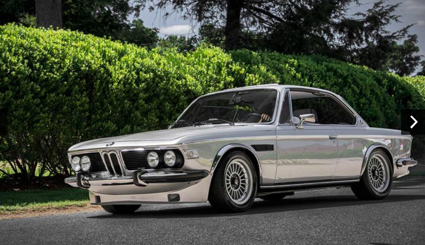

Gorgeous but not a fan of the black rubber strip. Breaks up the lines in my opinion but you love the silver bumper. Gorgeous car
Like I said, you can set it up to accept the bumper but just not mount it, that way you always have the option to put it on when you want. There will be holes (two on each side; two slats in front) but that will be somewhat less noticeable because of your black paint.
either is nice Scott , but imho there's a "look" to achieve
without bumpers you go "racy look " and demands rolled fenders, wider wheels, spoilers , lowered...etc...
with you keep it as factory and stays nice !
what i wanted to say , on a complete stock coupe it has no sense of just deleting the bumpers....
Thank you. I think we are going to go this route leaving the bumper off for a period of time to see how I like it later have the ability to install it. Thank you
I think filling the bumper holes and making it impossible (without cutting and painting) to mount a front bumper might reduce the value of your coupe, or at least reduce the number of interested buyers if it ever would be for sale.
I really like the front bumper, but it's just my opinion.
EDIT, just saw your post above. That's a good choice.
Another thing I thought of, in what shape are your front and trunk badges? If worn.. yeah you know;)
