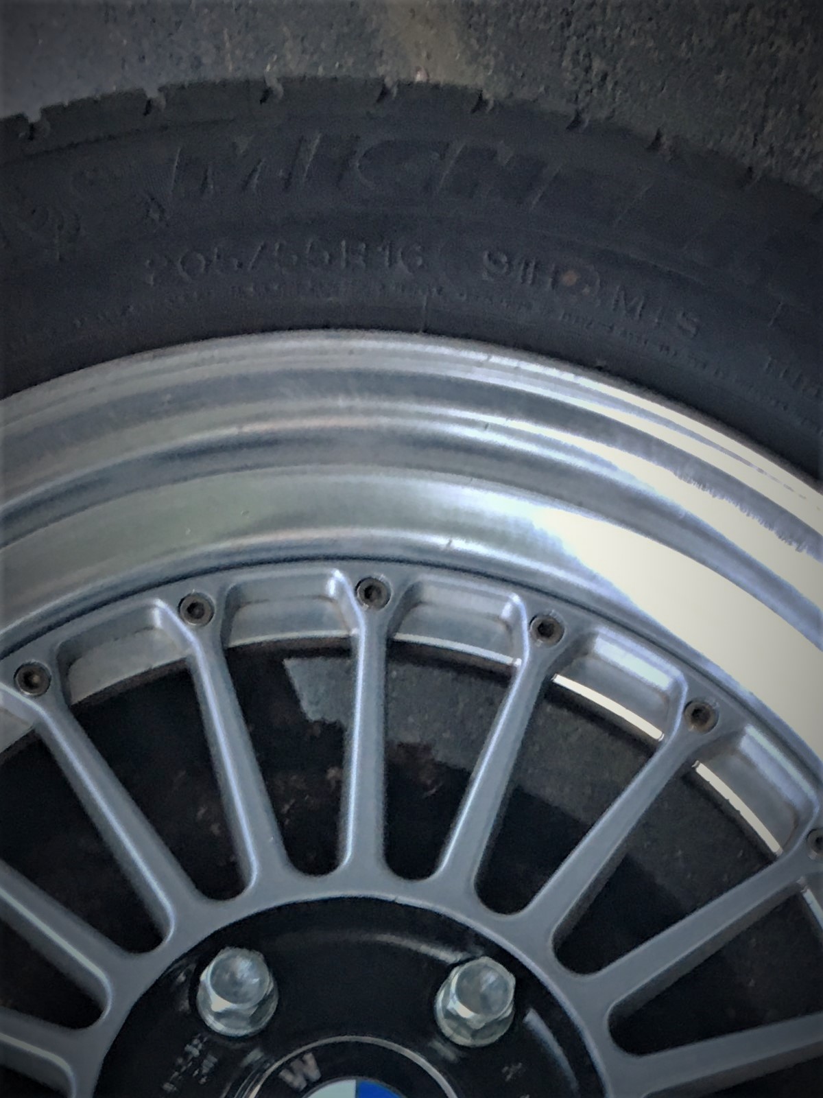

My car isn't lowered, but it doesn't have US spacers either. Perhaps I haven't been over a bump large enough to replicate normal cycling the suspension of a lowered car. I haven't heard anyone else mention that fender rolling is required with 7" ET11 wheels. I suspect that your need was due to the geometry issue that you had with your front suspension. If you were wearing out your outer tires up front, that means that the top of your tire was pushed outward towards the fender.
Sorry to deviate from painting (and more), but Scott - I suggest that you cycle the suspension with the car on the lift and floor jack under the tire - before rolling your fenders. I personally don't think that you will need to roll your fenders at all. I like stuffing big wheels under cars but I wouldn't roll the fenders on a classic car unless you need to. I will need to roll my fenders in the future to. I'm not thrilled about it but it doesn't seem to hurt value whatsoever. For me that means my car will hold it's $3K value. :D
My fronts:

Unfortunately or fortunately the fenders were already rolled based upon prior advice on getting lower springs alone needing to do so. As a result of rolling the fenders unfortunately as you can see from the last video some restoration was needed to be done. I believe it has been completed and have been told of the additional cost yet.

Glad you pulled the trigger on the BBS RS wheels. They should fit just perfectly with zero rubbing; especially w/the fenders rolled.
