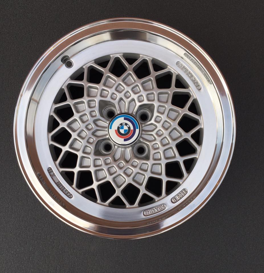

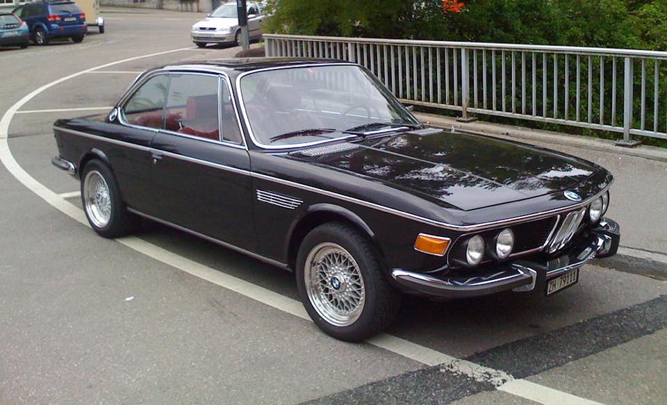

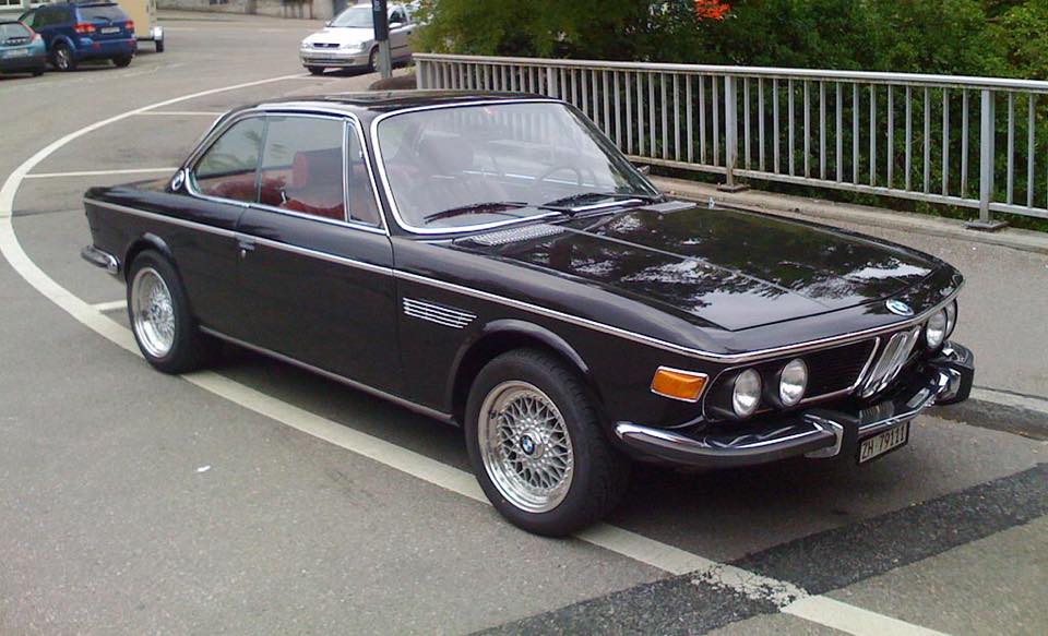

Scott, On the center cap question, I've used the BMW center cap on my RSs, which ties nicely with the roundels on the car. Here's a black coupe with that setup (not my car).

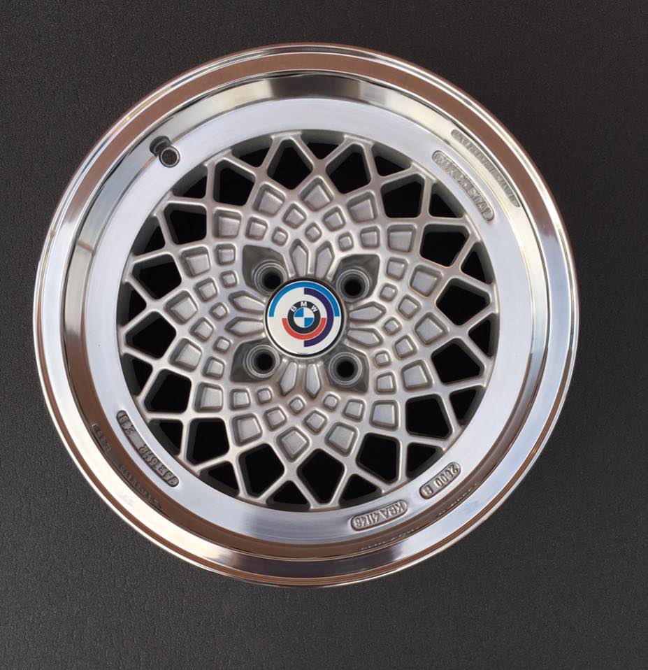

For a change of pace, Powderwheels KG sells a Motorsport center cap from the 70s which is also quite cool. Here's the cap on a different wheel.

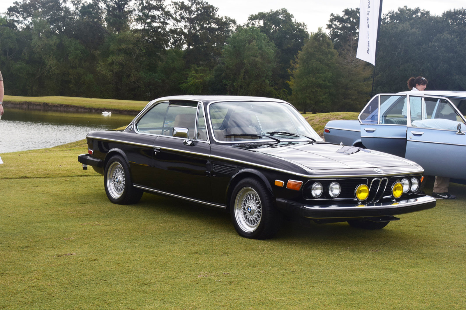

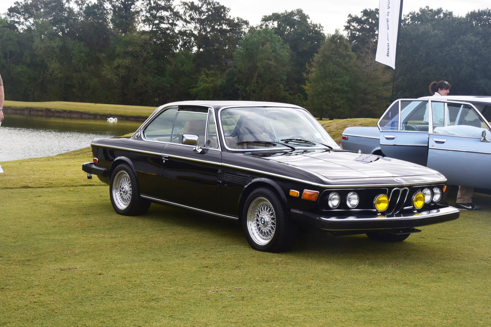

Scott, Like you, I haven't used a front plate for years, even though Ohio requires them. My coupe came with a fold-down license holder, so I just keep the plate folded under (made possible by my diving board bumpers). If I get stopped I'll just use the "That darn plate just keeps sliding down, officer" defense. Then I'll pay the ticket. On the center caps, if you scroll through the Powderwheels KG site you may find a good shot of those Motorsport caps on a car, as they have a lot of installed shots on there. That's where I found the black coupe shot. Here's a shot of my coupe at O'fest in New Orleans, sporting the BMW center caps (and folded license plate).
