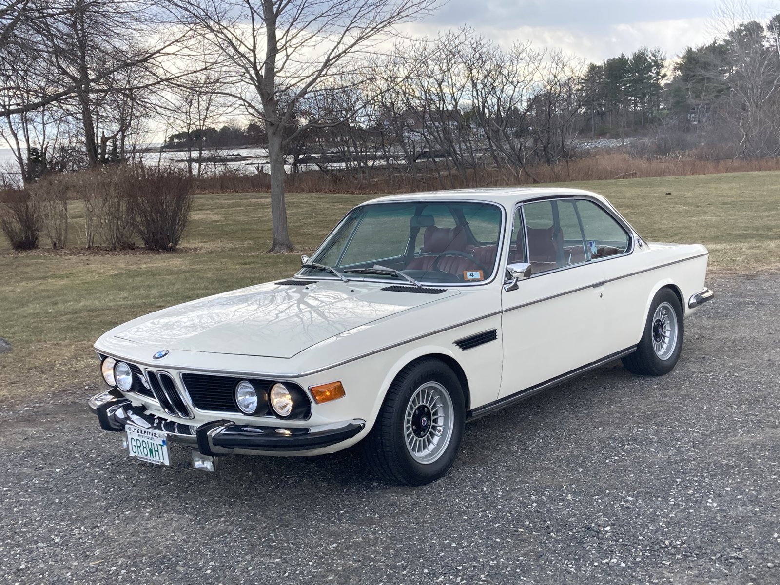

Finally got the interior all together the day before NY
and did a NYD drive with about 30 other various cars...

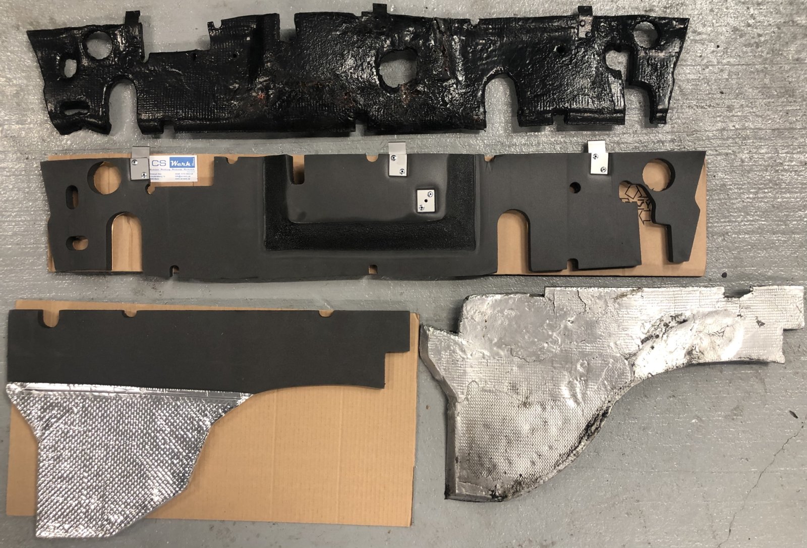

Looks great Steve. Christoph makes his repro parts better than the originals. I replaced my trunk floor panels with his and after seeing your pics whished I had also bought his firewall insulation. I bought the overpriced BMW original insulation and the foam has teared at all the corners of the hanging clip fasteners.

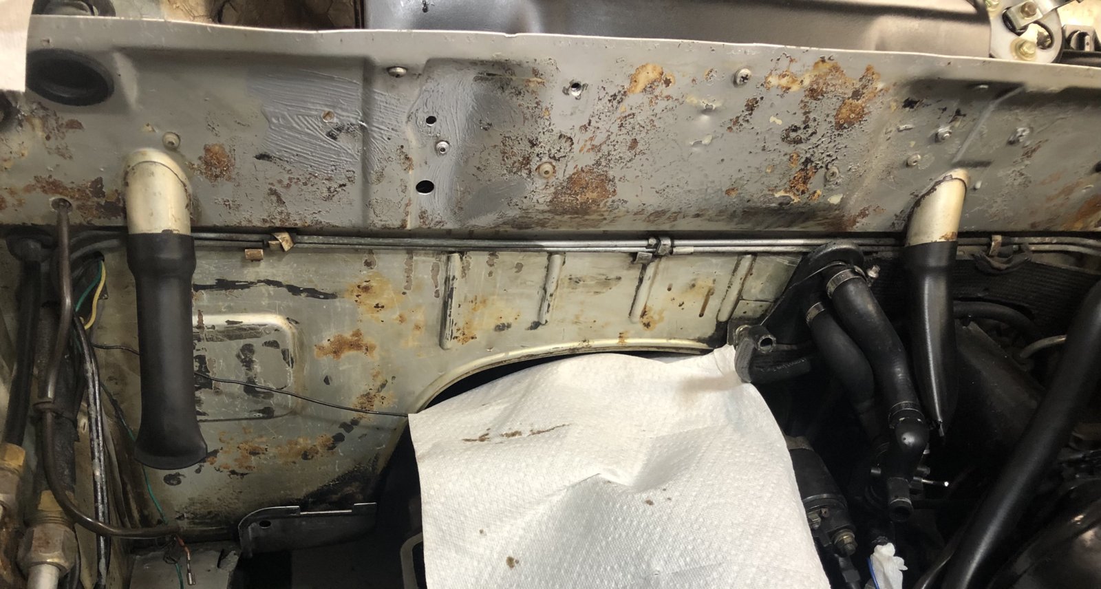

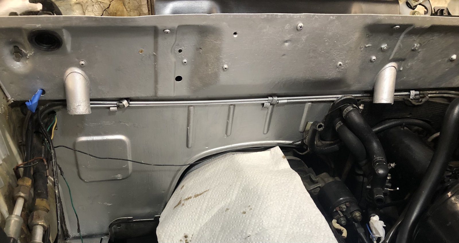

Finished my firewall rehab, cleaned up and painted with POR-15 high temp as prep for my new insulation from cs-werke:
then installed the new pieces, some cutting was necessary to clear the a/c hoses on the left and the heater hose, no biggie. My old pieces were held together with several layersof spray paint over the years:
much appreciation for people like Christoph who make repro parts for our cars.

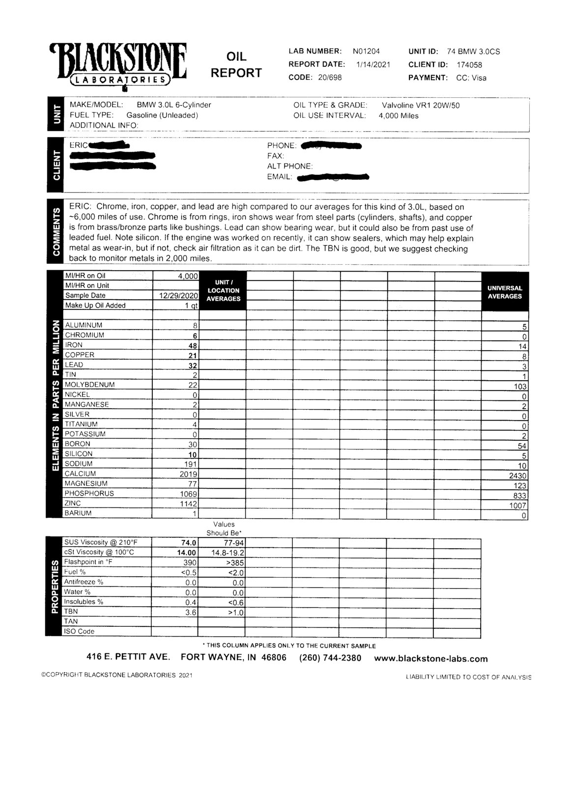

Blackstone oil analysis. @Ohmess mentioned this in some oil threads and I was curious. Good news is no gas or water in the oil. Bad news is ring and bearing wear. Posting it here in case anyone else hasn't done that and may be curious. It was $40.

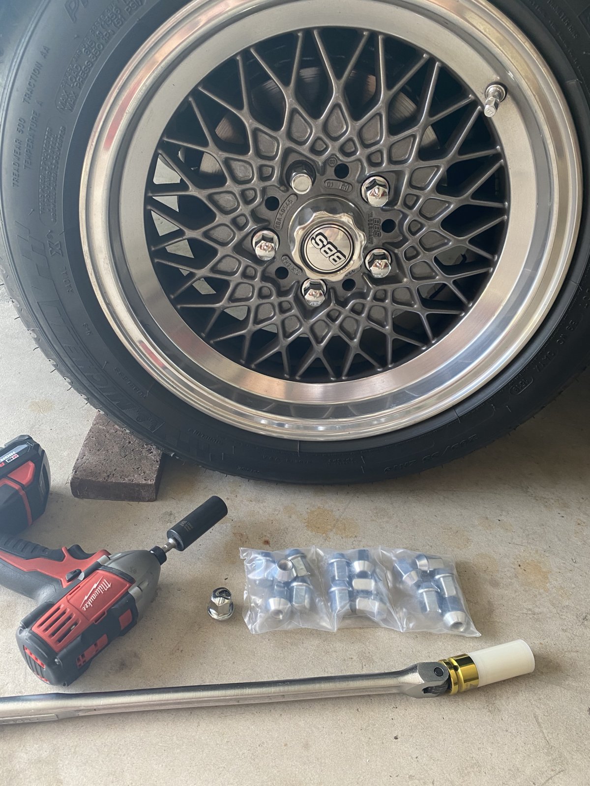

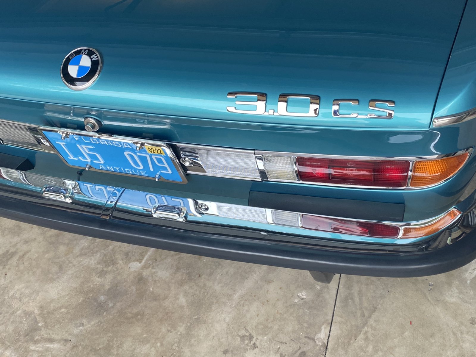

My Korman engine now has 6000 miles on it ,so I'm just doing the mundane stuff like installing chrome-plated brass trunk badges (3.0CS) and the CoupeKing Alpina lug nuts. The nuts fit the BBS Mahle wheels perfectly and replaced the cheap chrome already coming off EBay variety.
Drew, many Mahle wheels use a bolt with a rounded seat used by MB and others and the center is much thicker requiring longer bolts. You have a traditional lug nut but have you checked the seat for the nut? Are your studs long enough?
Chris--All of the lug studs were replaced and cut to a certain length by the shop. They have 3/4" of thread beyond the tapered hole in the wheels. The EBay nuts turn 11.5 turns before hand tight. The Alpina nuts have the same 11.5 turns. After making that 260 mile trip to the Naples car show, I noticed that all 4 wheels were still on the car when I pulled into my garage yesterday. Drew
Super, I forgot that you shared that a while ago. Just wondered about shape of lug nut seats.
