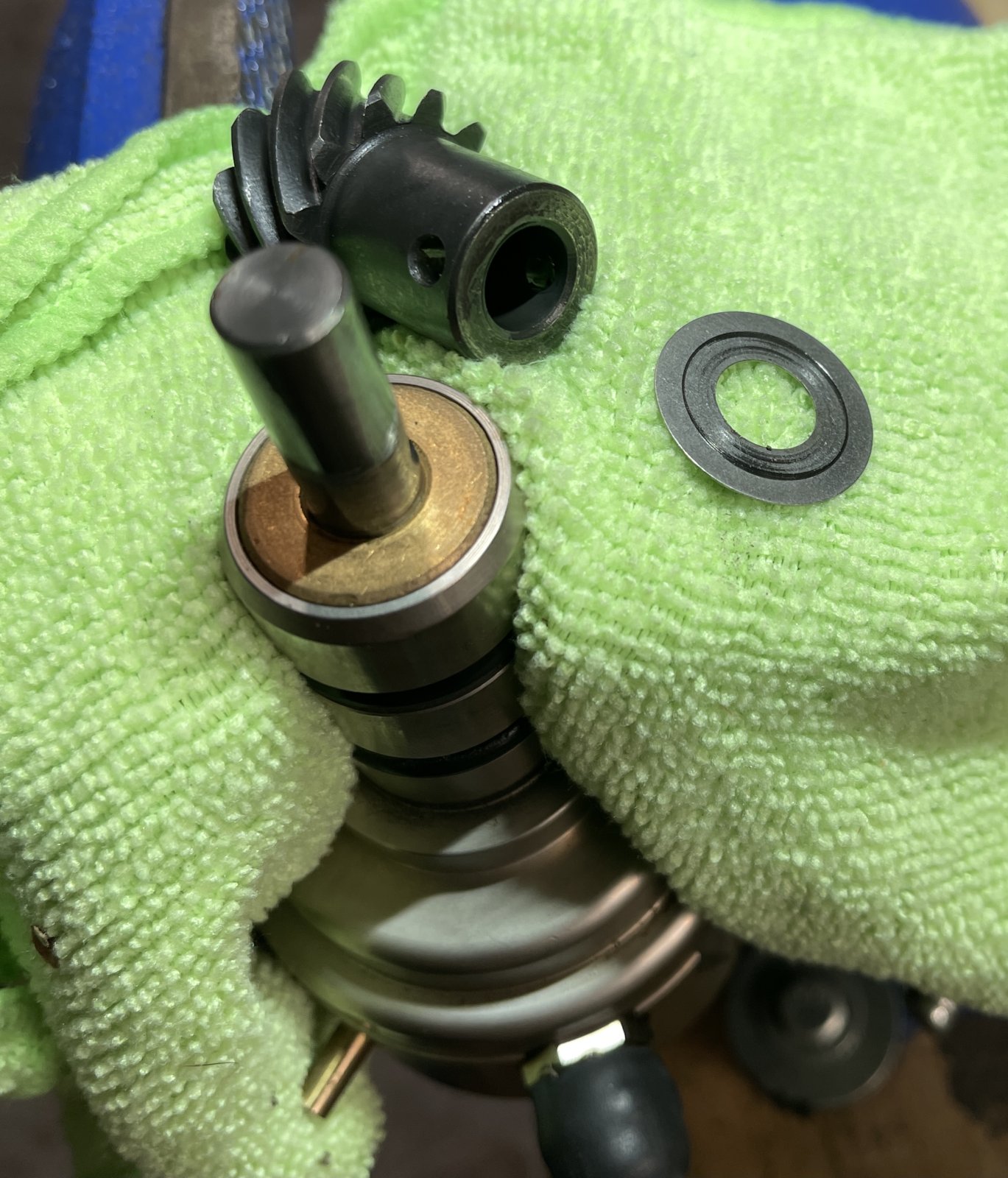

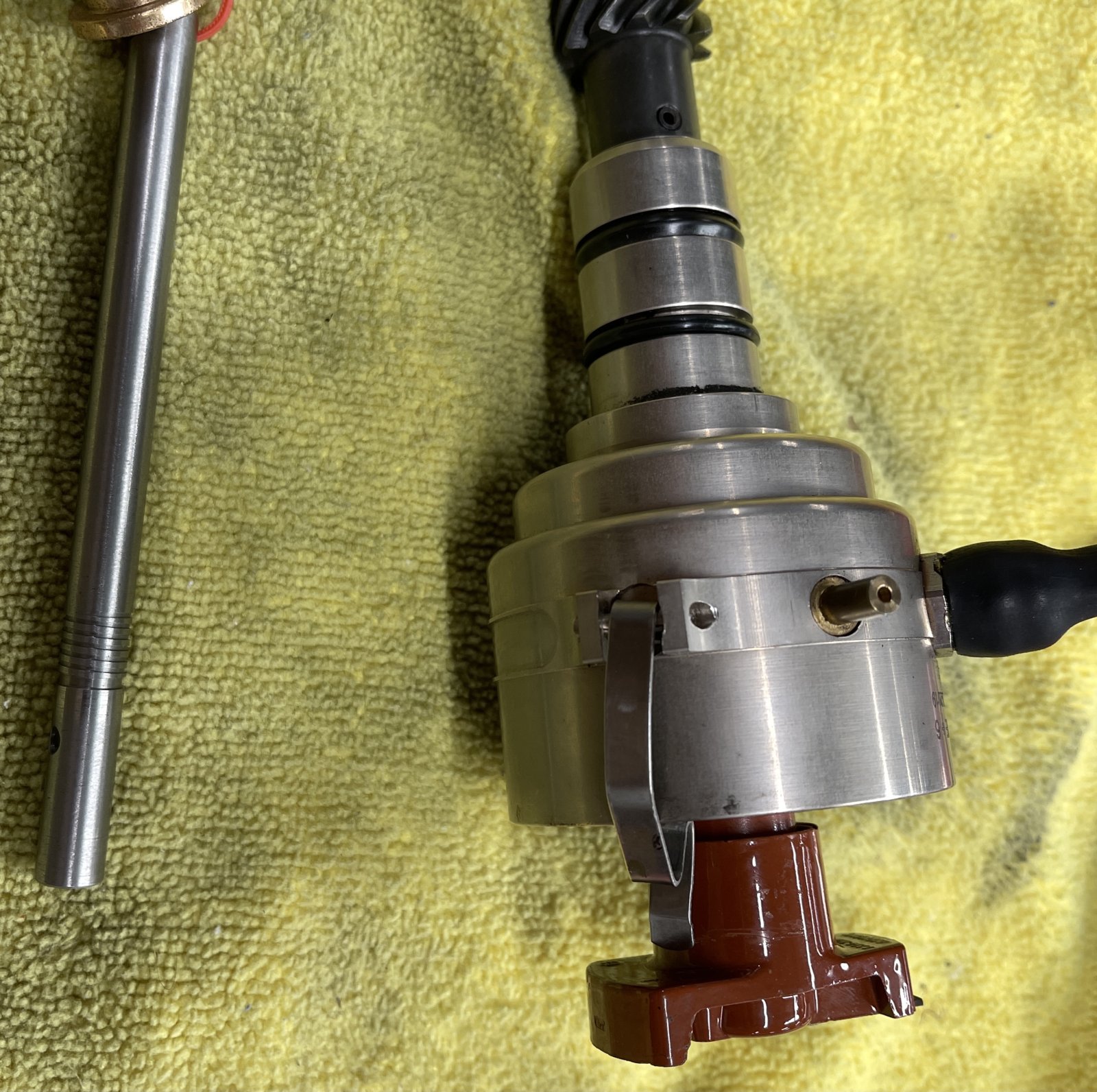

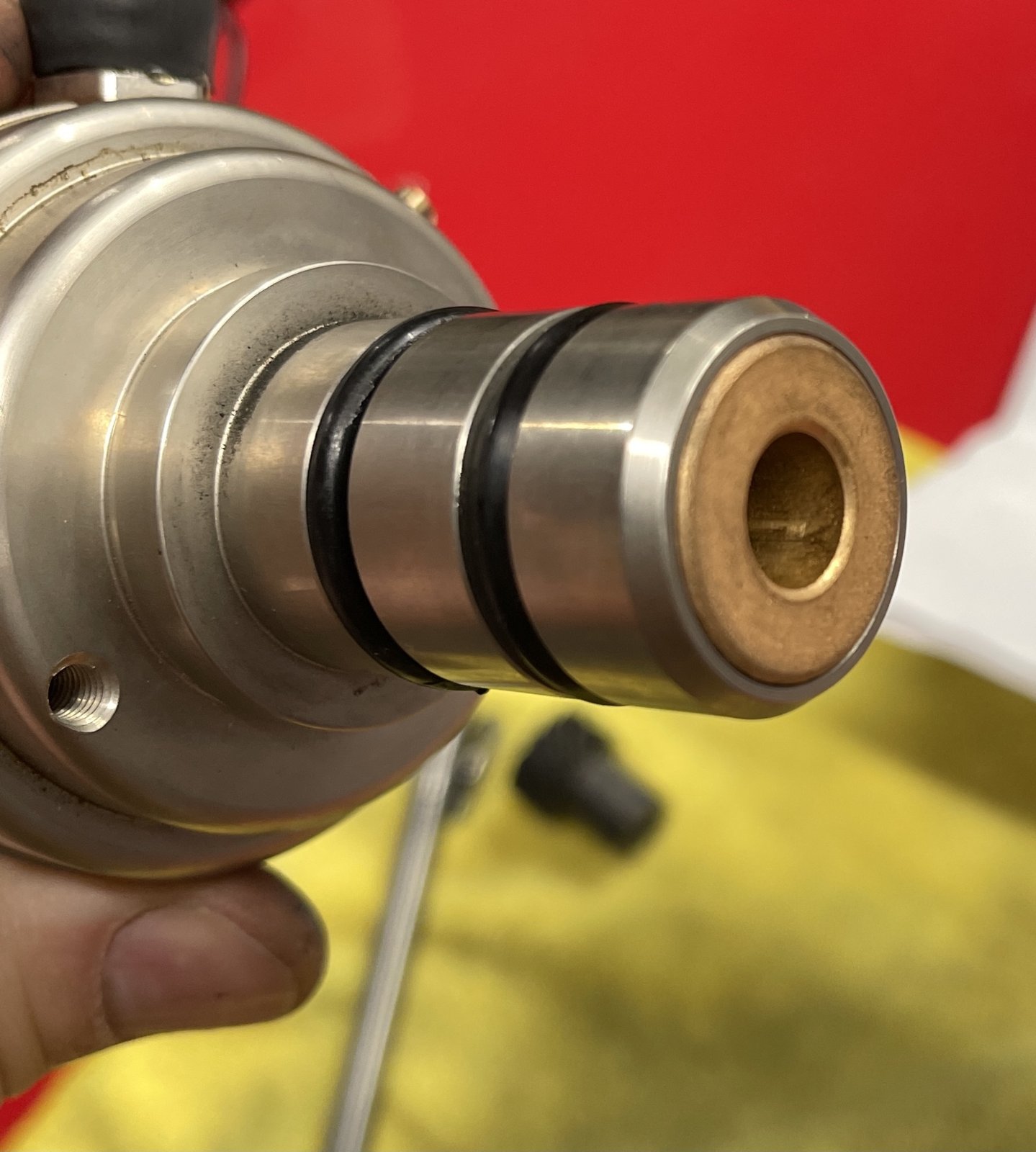

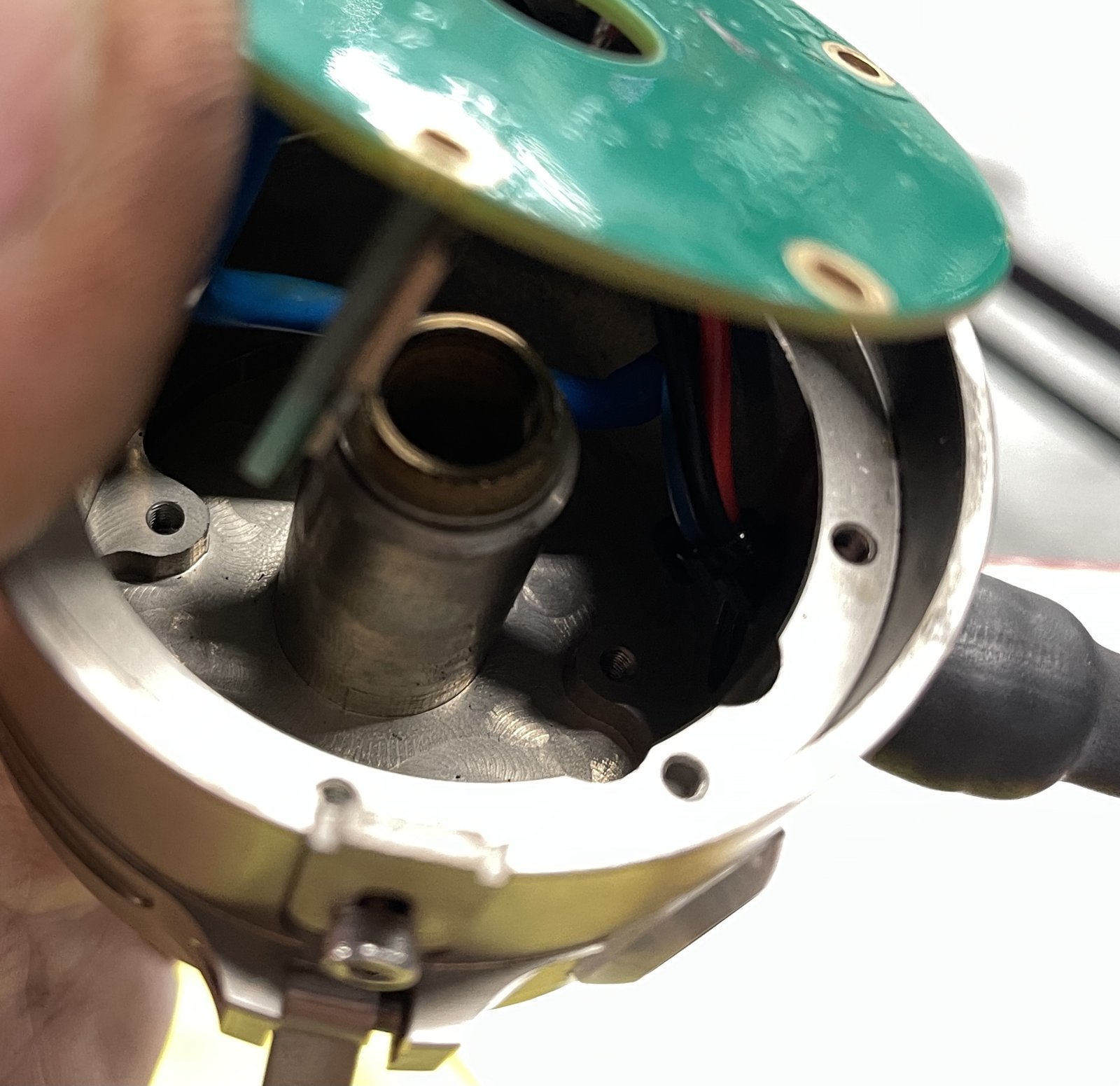

I cleaned and rebuilt my 123 distributor with the @m5bb lathed shaft mod. I also took the electronics out to inspect for oil intrusion-fortunately none in there or in the bushing.

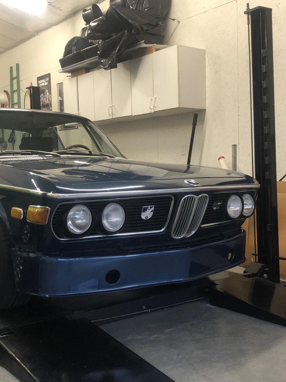

Managed to not avoid a section of steel highway guard rail cable which bounced off a couple of cars before slapping my front air dam. Happened at “highway” speed and made a God awful noise. Thankfully, no damage to painted car surfaces, but the air dam will need minor repair, a repaint and another protective film.
Air dam painted and installed, protection film affixed. Going to run boy racer sans bumper for a bit.

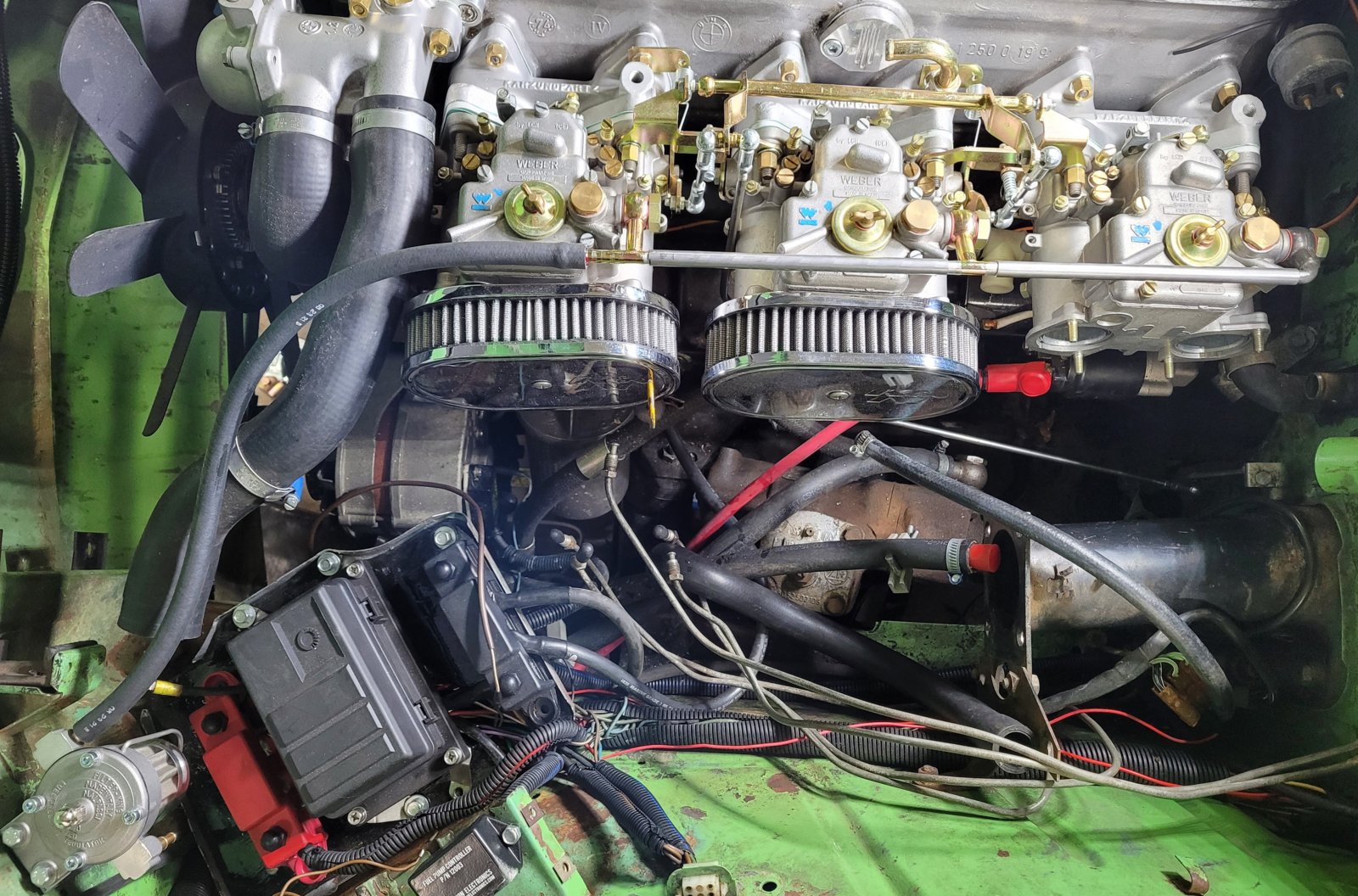

I designed and test fitted a fuel rail for the triple Weber side drafts using Weber banjo fittings and some appropriately sized tubing. Never did like all the rubber fuel hoses and clamps much less the stainless steel web-wrapped hoses. Next up is to braze it and have it yellow zinc plated.
I'm using a Malpassi Filter King filter/pressure regulator mounted over the battery tray where I've mounted positive and negative distribution blocks and an auxiliary, contemporary relay/fuse box.

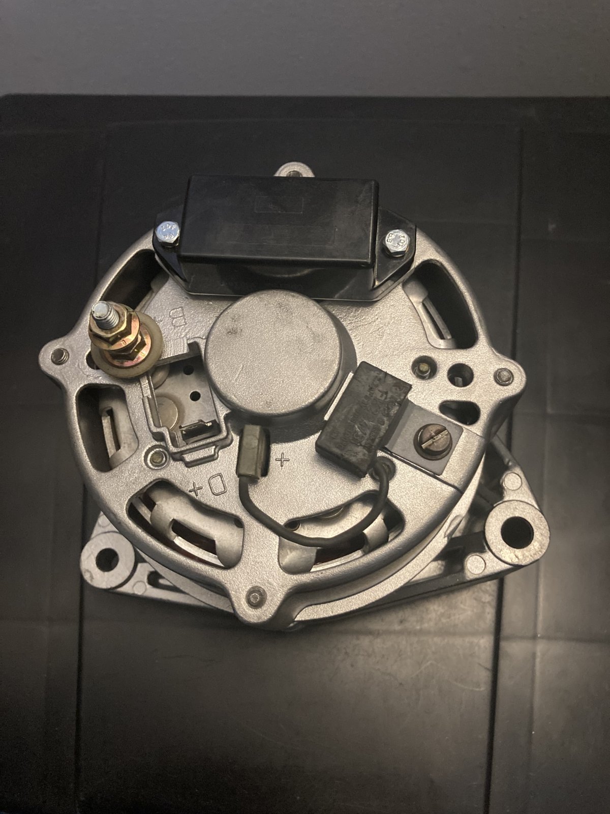

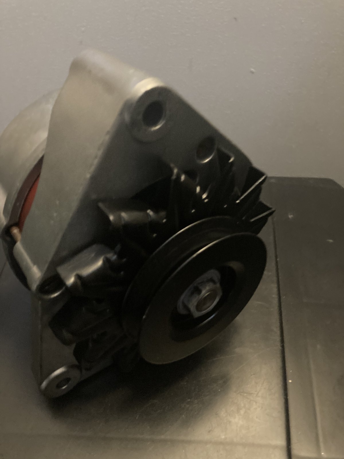

Most of you know that when I was at the Legends of the Autobahn the alternator in the coupe seized up. It was the luckiest bad luck I ever had. A couple hours earlier and I would not have been able to show my car. A couple hours later and everyone would have left and I would have been stranded. Thanks to @Ohmess and Tom Baruch my schedule was slowed bu only a few short hours!
Anyway, I found a place local to me who rebuilt the alternator with the internal regulator and boosted the amperage to 70 A - $175
