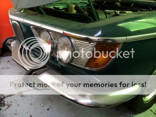

I inspected a 2000CS that has been sitting for 15-20years for a friend. It was stored inside and supposedly run periodically. It will need some reconditioning but it would make a nice weekend driver. It's been freezing out so I didn't get a chance to take it out. If my friend doesn't make a deal for it beforehand, we'll get back out for a second look when it warms up next week. He doesn't want too much info out, so here is a shot of the front end:
**** UPDATED 12/20****
It sounds like my friend has made a deal on the 2000CS, but they will not complete the sale for a couple of months - long story. He is not worried at all that it will be sold in the meantime because 1) the seller and buyer have been friends for ~30 years and 2) very few people know the car exists. We'll go check it out again soon, so I'll update this story when I get better photos.
