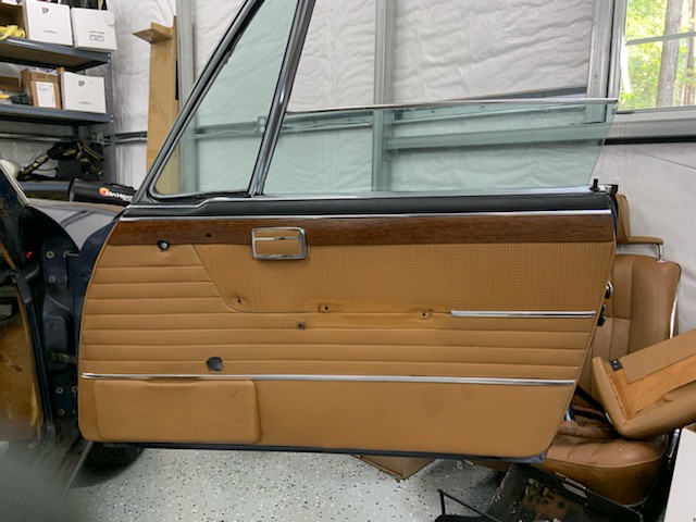

I replaced a stripped driver side rear window transmission.
Fun job, I've gotten pretty efficient with replacing these, it's the third one I've done on that window.
Ah you are the man to talk to about refurbishing my rear windows. Work but are VERY slow.
