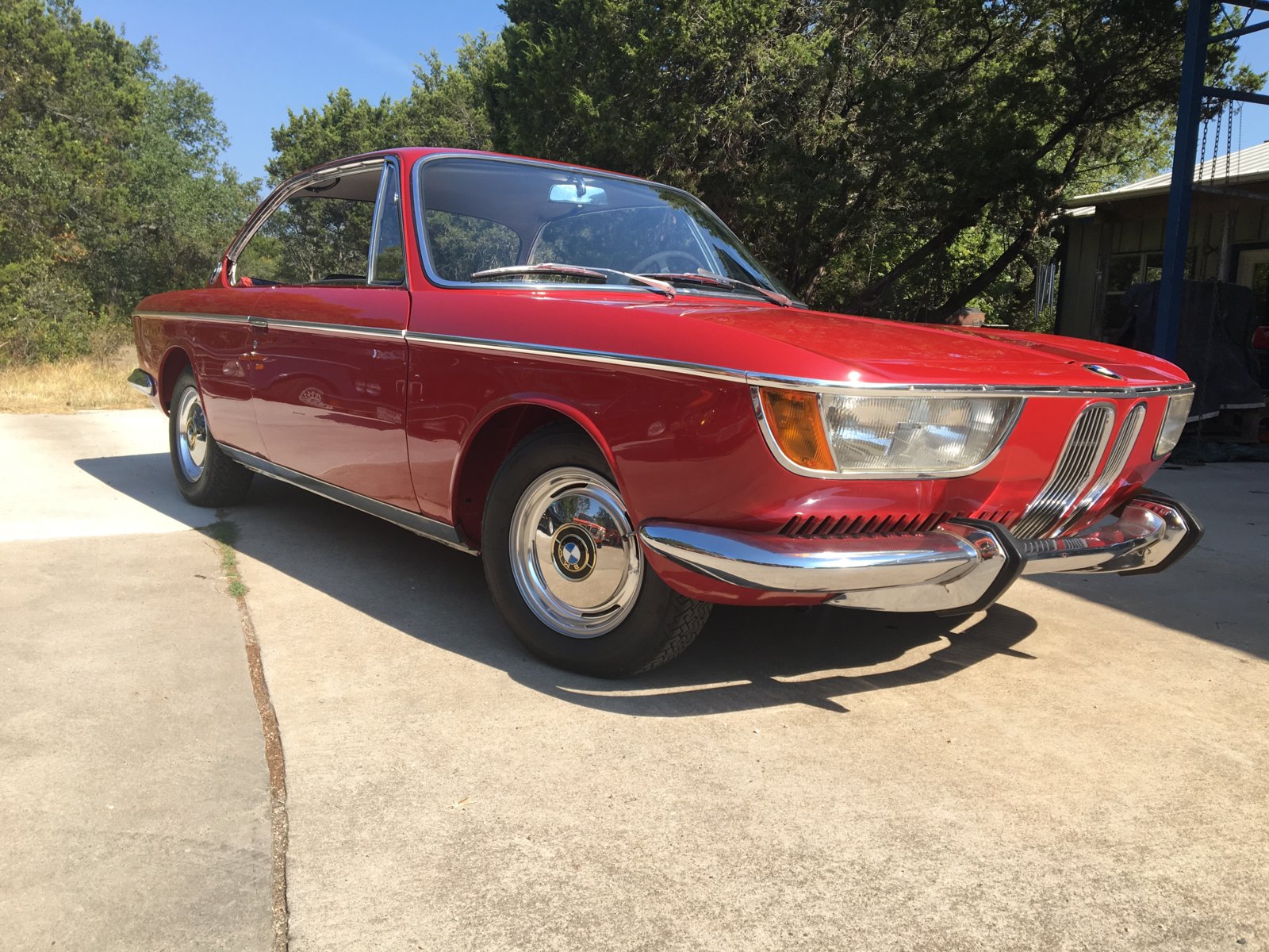

Also got my Lokari inner wings installed...very tight fit but I guess that the point!
Congrats Ed! Must be a great feeling beeing able to drive it again! And it goes without saying, you've done a beautiful job.
Drove it on a shake down in the hills around Barney’s place. Runs beautifully, temp was perfect, rear brakes could use an adjustment, no funny noises, so it’s looking good. Waiting on a few window felts and squeegees, but they are on the way.
